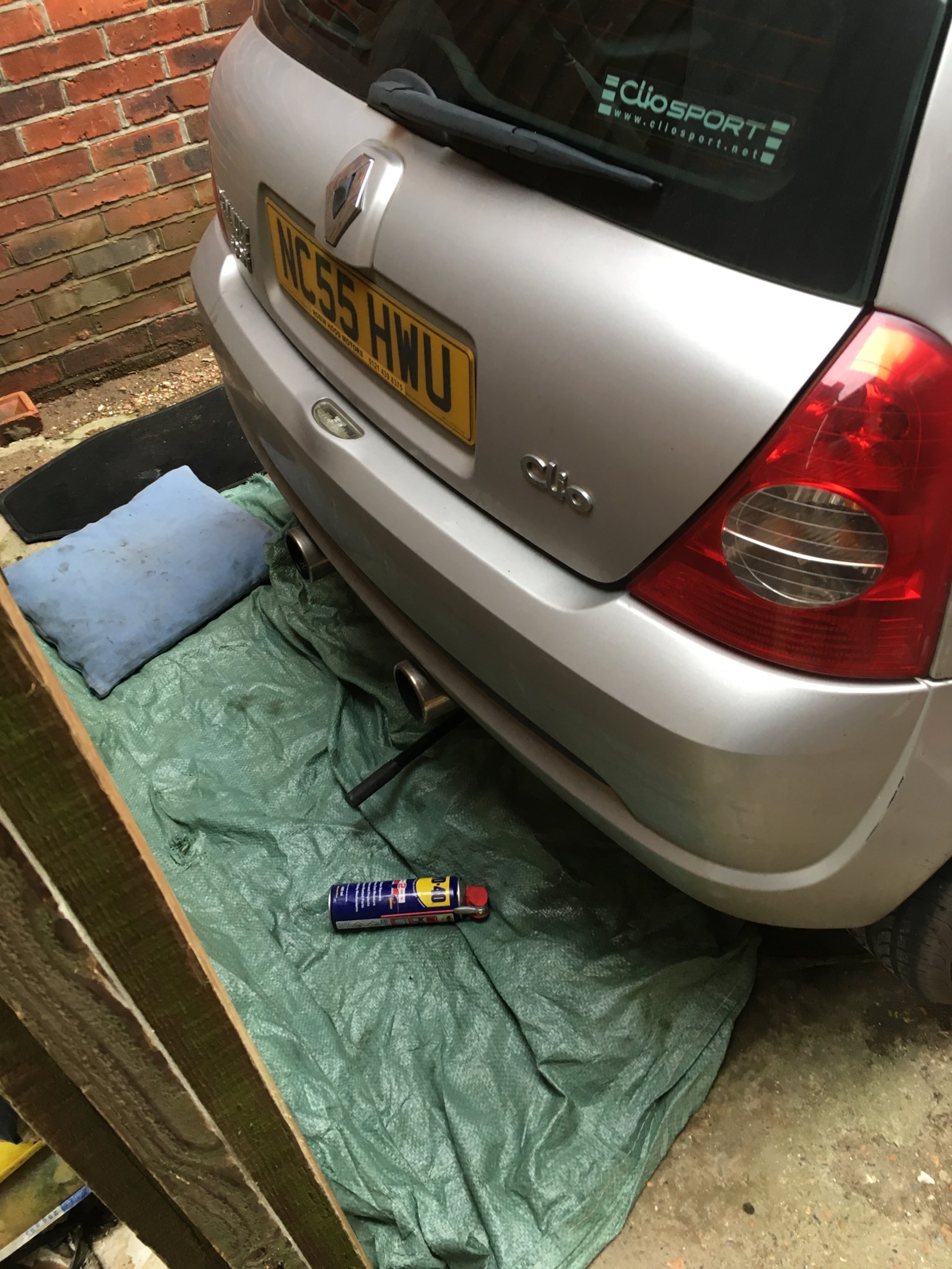

Just about to fit new springs and am a little worried taking out that bolt as o/s has snapped before. Although this time round I have an impact gun so should be okay, but is there any technique to tackle it the safest way? Loads of wd and small bursts on the gun? @Typhoon

As above mate, bit of WD to soak it and then bursts with the impact gun. Don’t do it back up with an impact though!
Also, as @Louis' pointed out, heat if you’ve got a heat gun. Either way will work. If you’re using the impact gun though, don’t hold it down for one big long burst. Also, if at any point it feels like it won’t budge, use a bar to tighten it back up one turn before loosening it again.

Buzz it out. Spray with WD. Buzz it back in. Buzz it out a bit more, more WD. Repeat until it comes out. Most come out first time with a decent buzz gun.
Well.. I expected the bolt to be a bit more resilient than that, the impact got it within seconds haha. The hardest part was the space I had to do it, would of been a 15 minute job otherwise!
