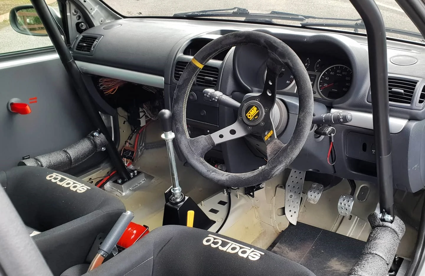

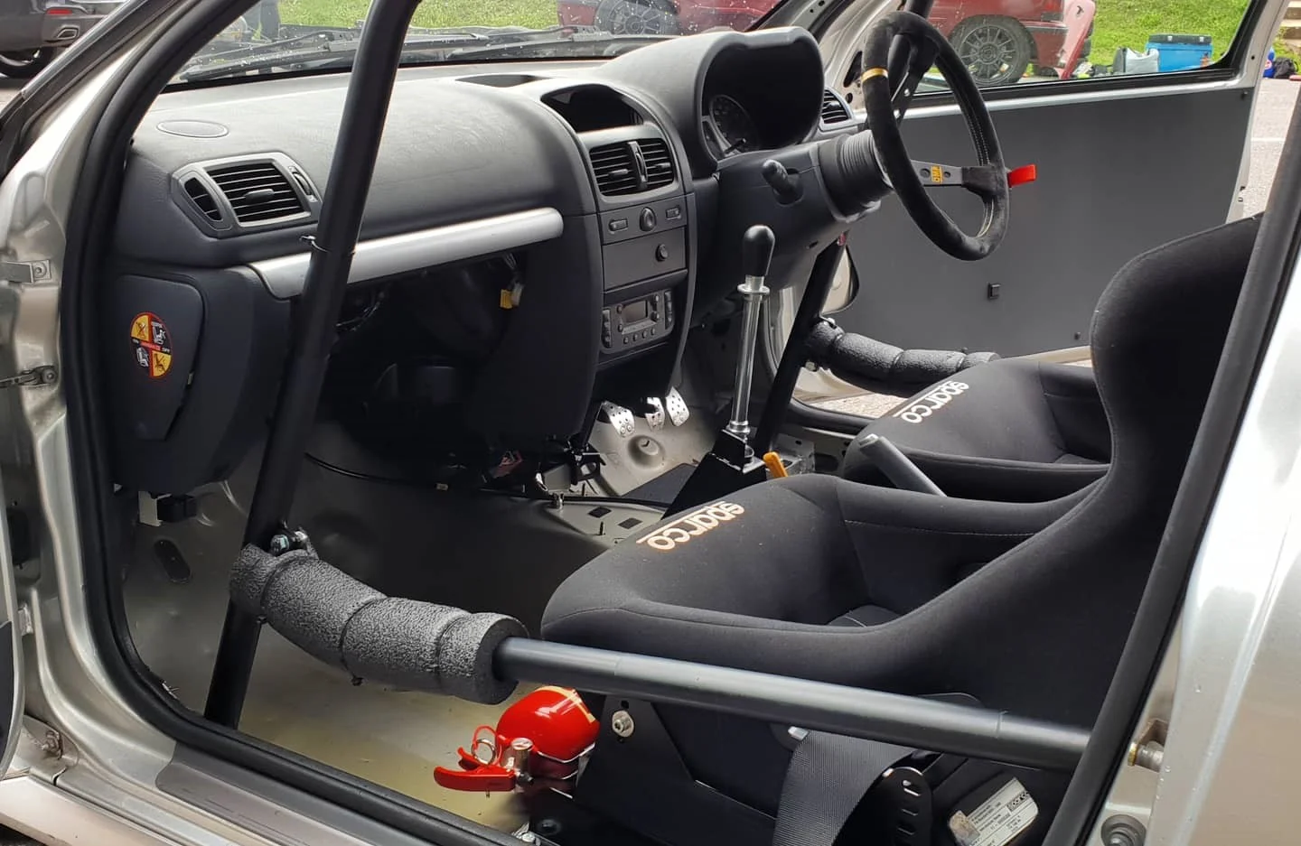

Had a rush on with the car really after not touching it since February prior to Spa I mean Covid and had to go about removing the old brake system and remove the ABS pump etc. I fitted all the new lines and a Tilton bias valve, had issues with one of the T pieces where the female bits were too deep (never had that issue before) and leaked fluid so we ground them down. Re-fitted them and hay presto, no leaks. Fitted a flat floor for the drivers side and re-fitted the fire extinguisher.
