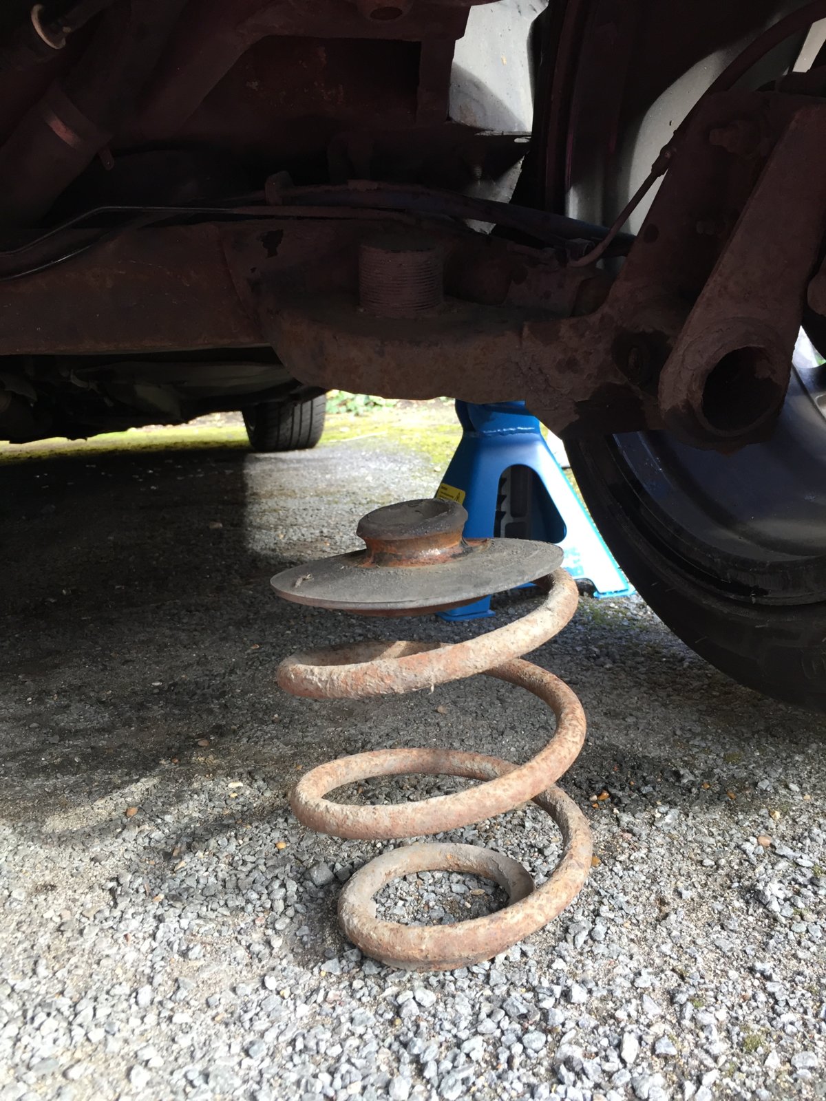

Just removed the old rear springs from my new to me 182 to find there are only rubber spring seats at the top, none at the bottom. Is this correct as seems odd to me. If this is the case are the bottom ones a separate part number from the top as they must be a different design. I will need to order new all round as top ones have also seen better days.

The reason I asked the question though is if you look at my pic, a previous owner has bolted something to the spring seat. It’s quite large & annoyingly my fancy new Mark fish springs won’t fit :( or the rubber seat. Sod’s law the bolt holding it from underneath is a 9mm hex of which I don’t have the socket for. Have ordered one but not fancying my chances of actually getting it off as it’s looking pretty
old & rusty.
I’m also concerned as to why it’s been added in the first place.... Pulled a set of ktec dampers of the back & no idea what the springs were as totally rusted with only a black bit left on them. Any thoughts appreciated as I’m stuck until I get this sorted.

Thanks. That makes sense. If I get it off will the seat underneath still have the raised bump needed to hold the spring in place or when these things are fitted is the bump grinded down to create a flat surface?
JamesBryan
It should still be there, that thing will be hollowed out inside to accept the raised bump.
