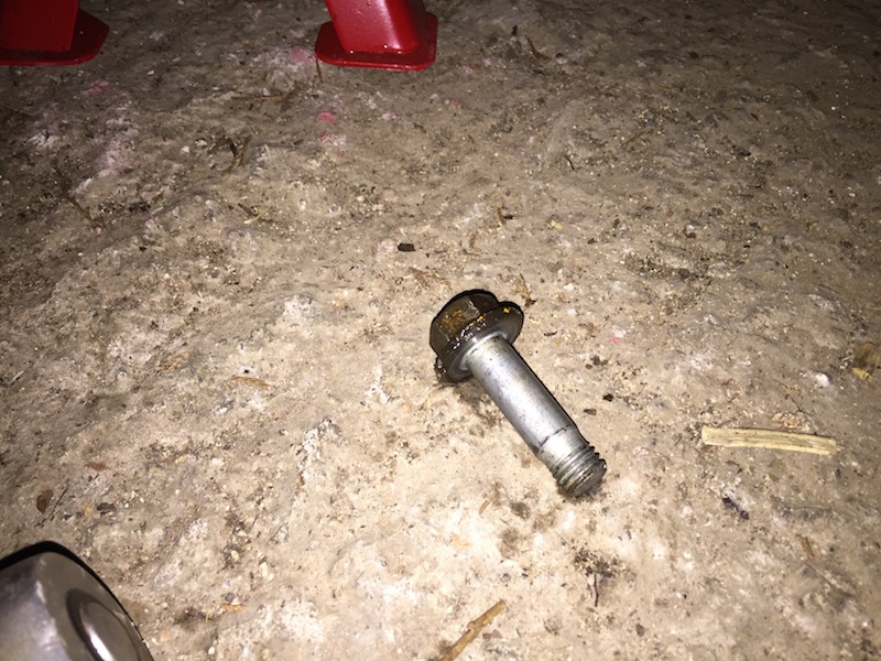

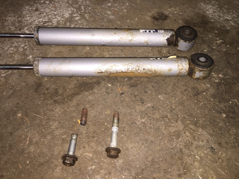

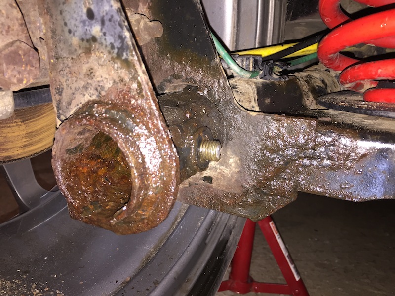

Whilst undoing my rear shocks the drivers bolt snapped off almost flat with the axle. I have attempted to drill it out, even with a hss drill bit this was useless.
I now have a car that is off the road, and need to get it back working.
Can anyone help me with ideas please, preferably without replacing the rear axle as I wouldn't have a clue!!!

Start drilling with a really small bit and work your way up, eventually when you pull the drill bit out and spin the drill bit in the correct direction it should spin out.
Loads of WD40 soaked on it first too.

I started with a 5mm hss and it didn't even begin to cut in and then snapped in half!!
I must add I'm doing this lay on the floor.
Would welding a bolt or similar on it work? Along with lots of wd40 and heat work? There appears to be some red stuff on the thread so I'm guessing that's some sort of threadlock.

5mm is far too large.
Start with a 2/3mm bit and work your way up.
Drilling will also heat it all up.

Cobalt bits aren't too expensive if you come across hulk steel. A bit brittle so you have to be careful but put two fingers up to hardened nonsense.
  2014 Clio 200t edc
I went to screwfix who told me I needed hss drill bits, the bloke who did it used cobalt so that was a fail on my part (screwfix) from the start. Glad it's back now though. Much better apart from a bit of scrubbing at the front on turning hard. Think it's the et40 wheels so need some spacers. :(
