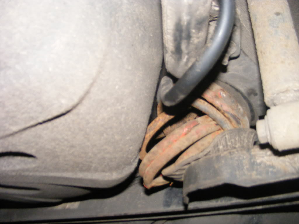

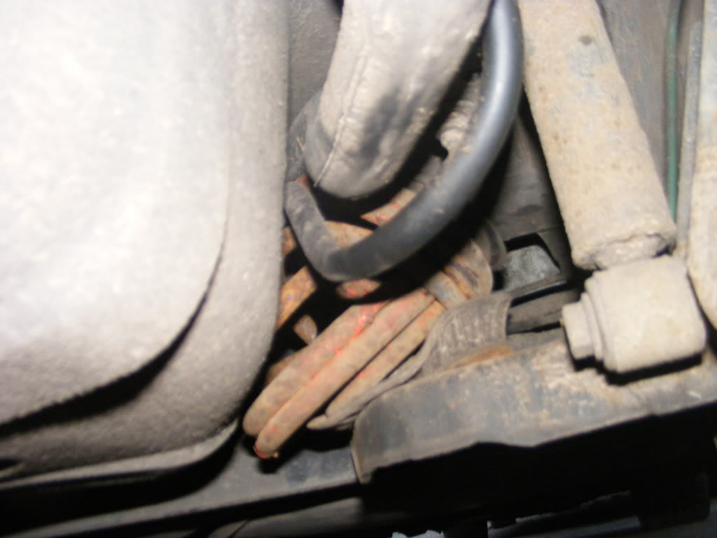

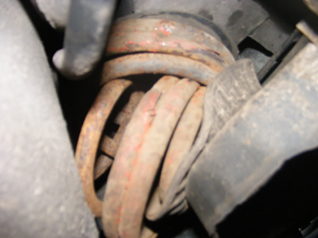

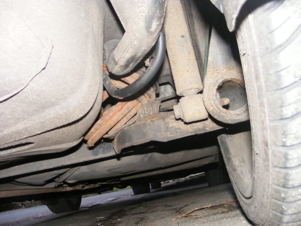

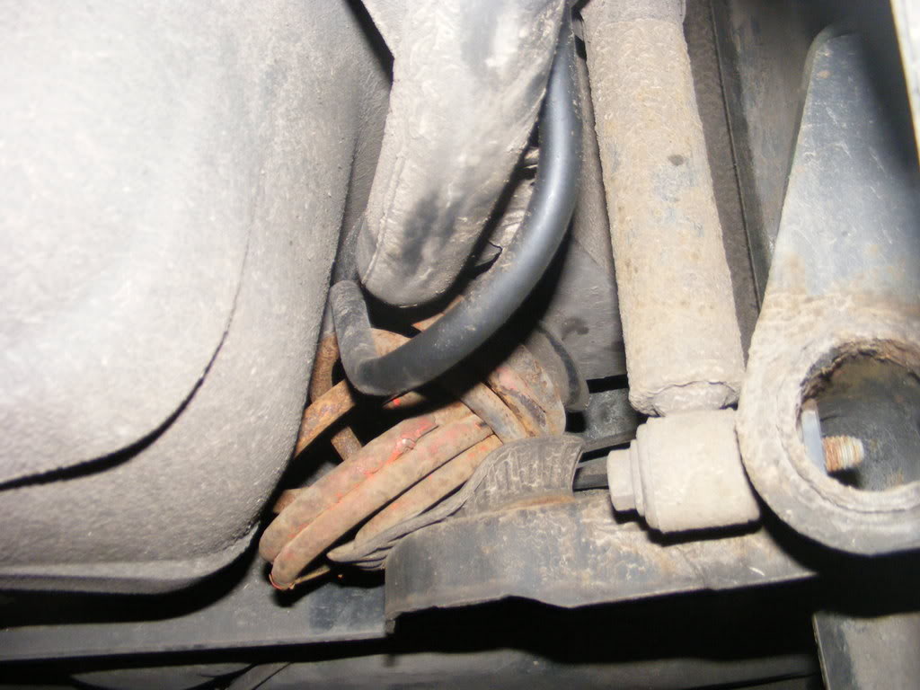

Driving home earlier and my car was thudding everytime i went over a small bump in the road, seemed fine on straights though.
Just gotten home and can see that my rear suspension on the driver's side has collapsed, the passenger side looks fine, but the drivers is ruined.
Can someone let me know what i'm going to need to get it all fixed up, and roughly how much i'm looking at spending on it to get it done.
It was lowered on a GMAX Suspension kit roughly a year ago.
It looks so good on the positive side of things lol..But needs to be fixed ASAP.
Pictures below showing damage.

From looking at those pics just looks like the spring has failed to me, if it's not broken anything thats all you'll need.

What's that thing underneath the spring that appears to have been crushed?
  mk2ph1 rsi 106rallye
broken spring. if you have the recite and was less tan 12 months ago id try to get them changed under warentee. most come with a 12month gareentee.
the bit thats crushed will be the rubber seat that will be fine with the new spring is fitted.
