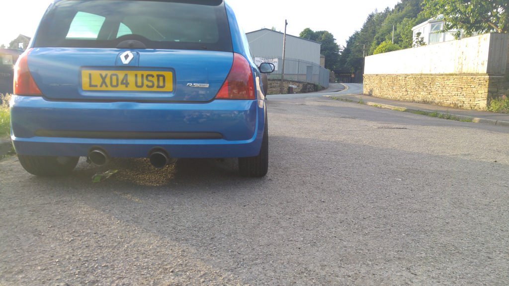

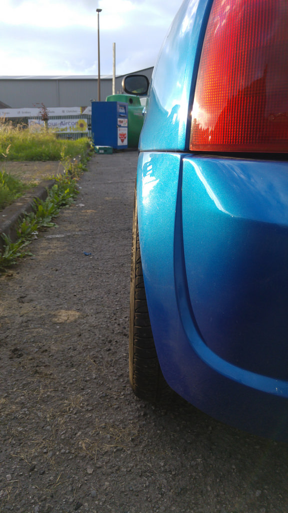

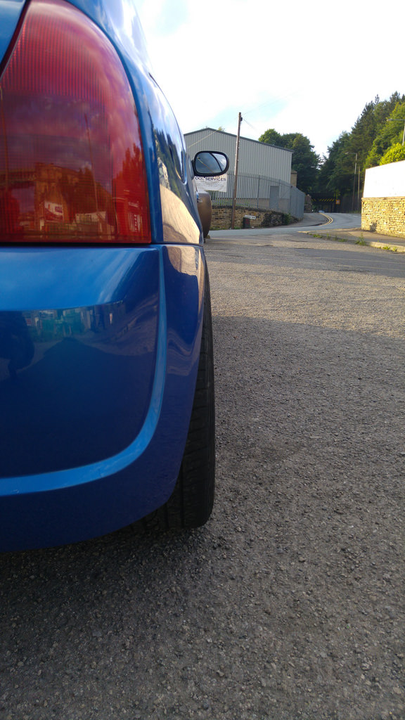

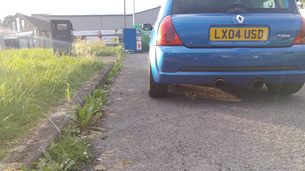

The right wheel sticks out a bit more than the left! It's only by about 1mm but we both noticed it. Quite annoying.
Swapped the wheels over and its still there so its not the wheels. Used the same stub axles as the one that was provided with the new beam. Stub axle spacers the same. The rear beam lined up perfectly with the carrier holes so don't think that's bent.
The ONLY thing that is different from left to right is I used the new beams disc on the right. And my old one on the left. Would a mismatched disc really have that different tolerances? Pics below. Hard to get pics of it.

Any ideas? Discs are different so im thinking its that but would that really make that much of a diff?
