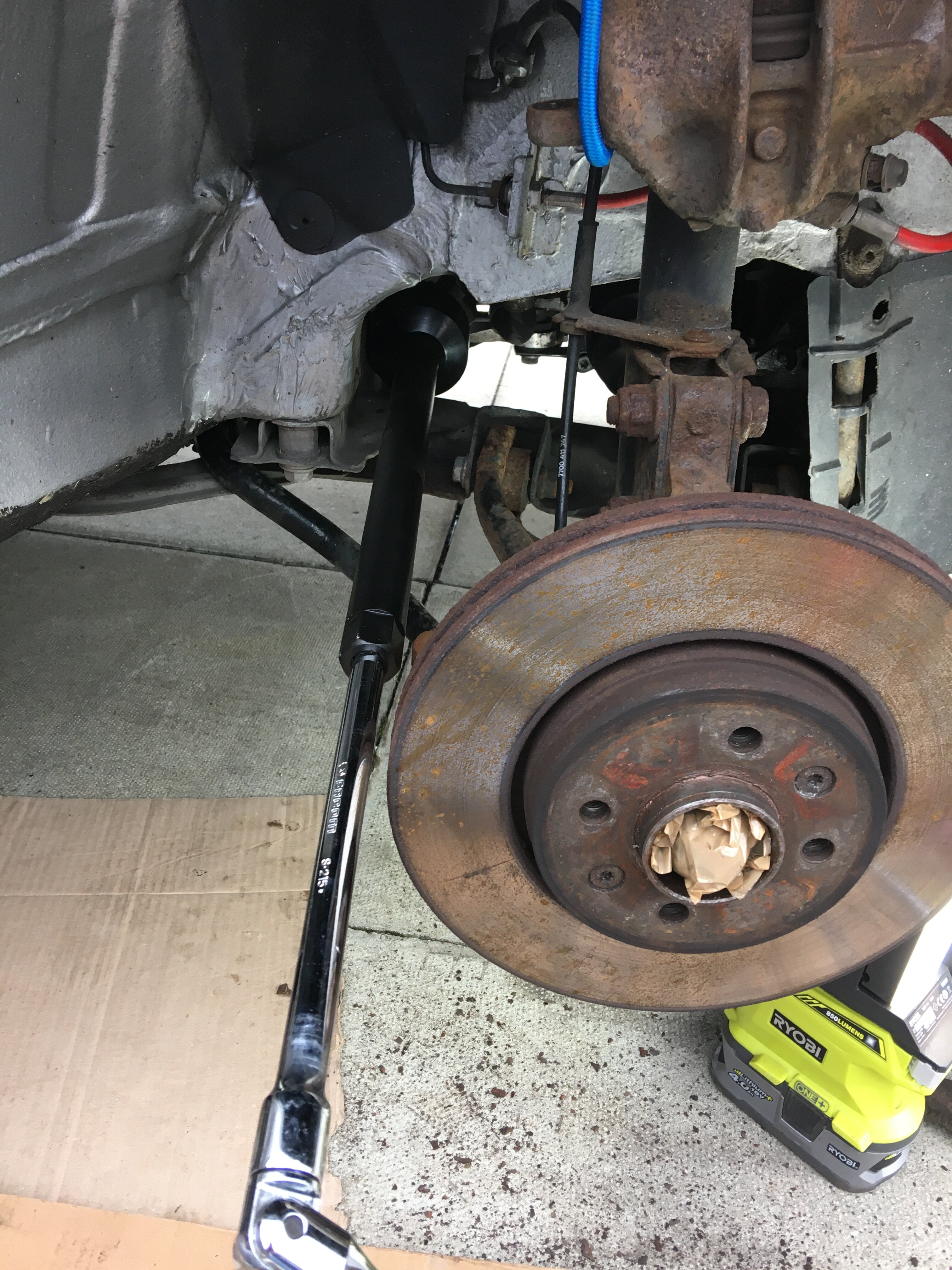

Have to say the ARB Bushes weren’t quite as bad as I’d thought they would be! Done them on jack stands with the help of guide on here. I had to cut half the foot off a g clamp to make sure I had enough room for mole grips but must be able to be done without. Think I done it quicker than the rack bushes too!

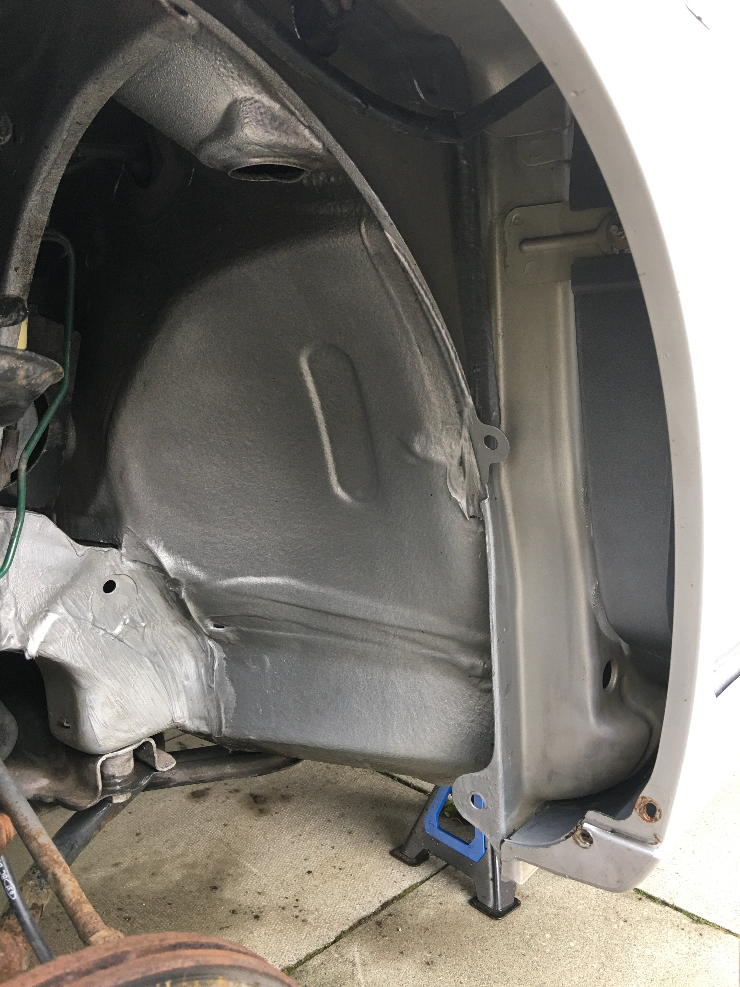

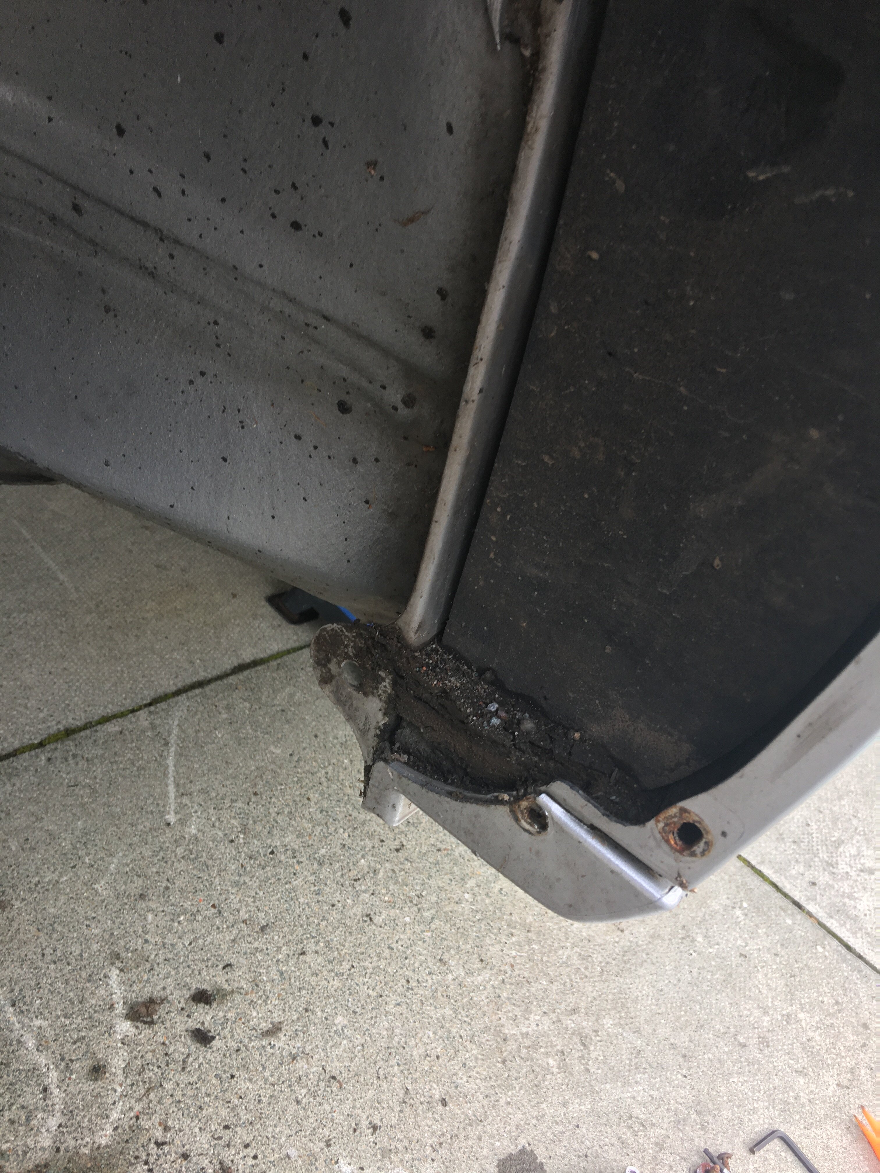

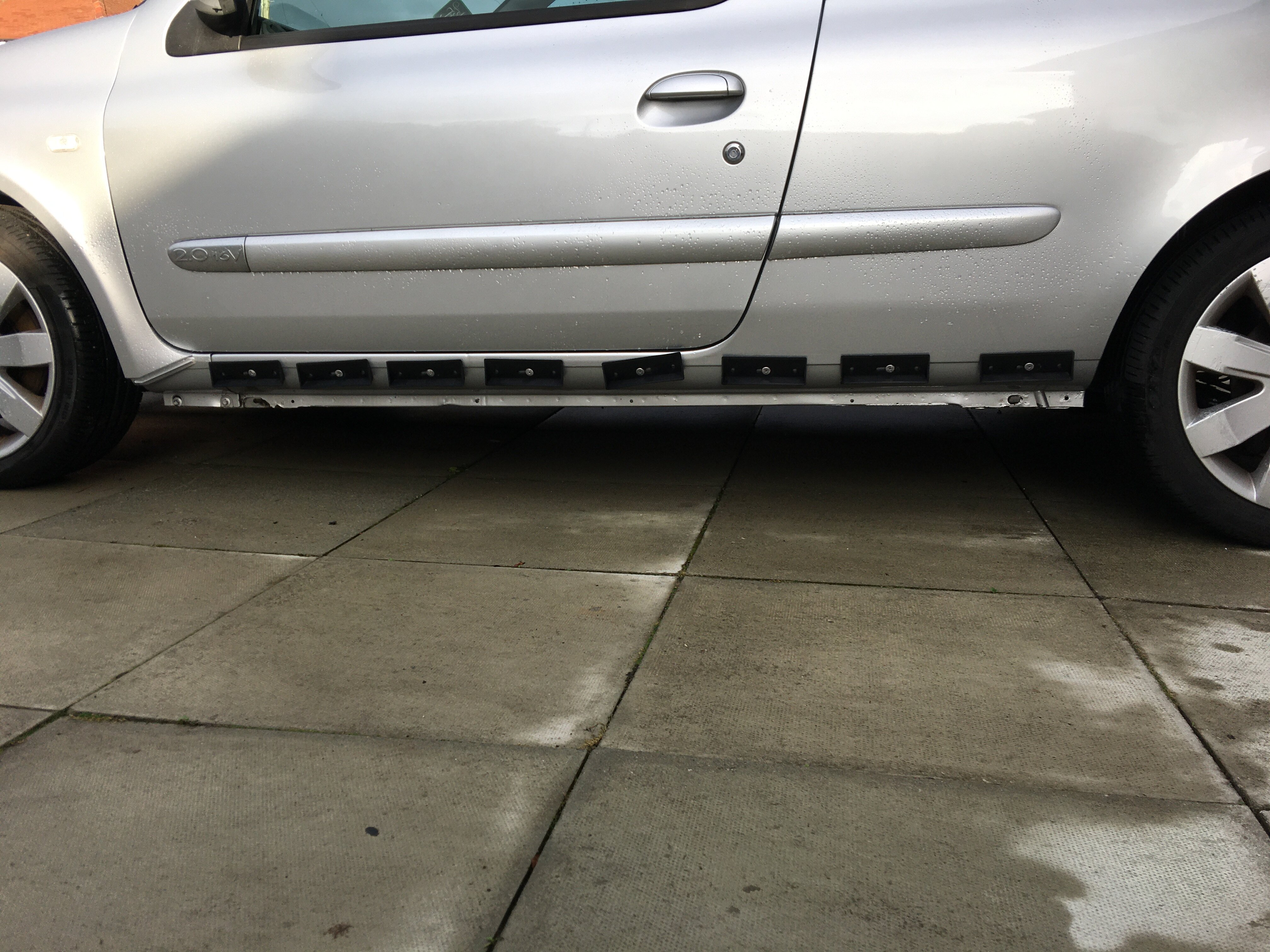

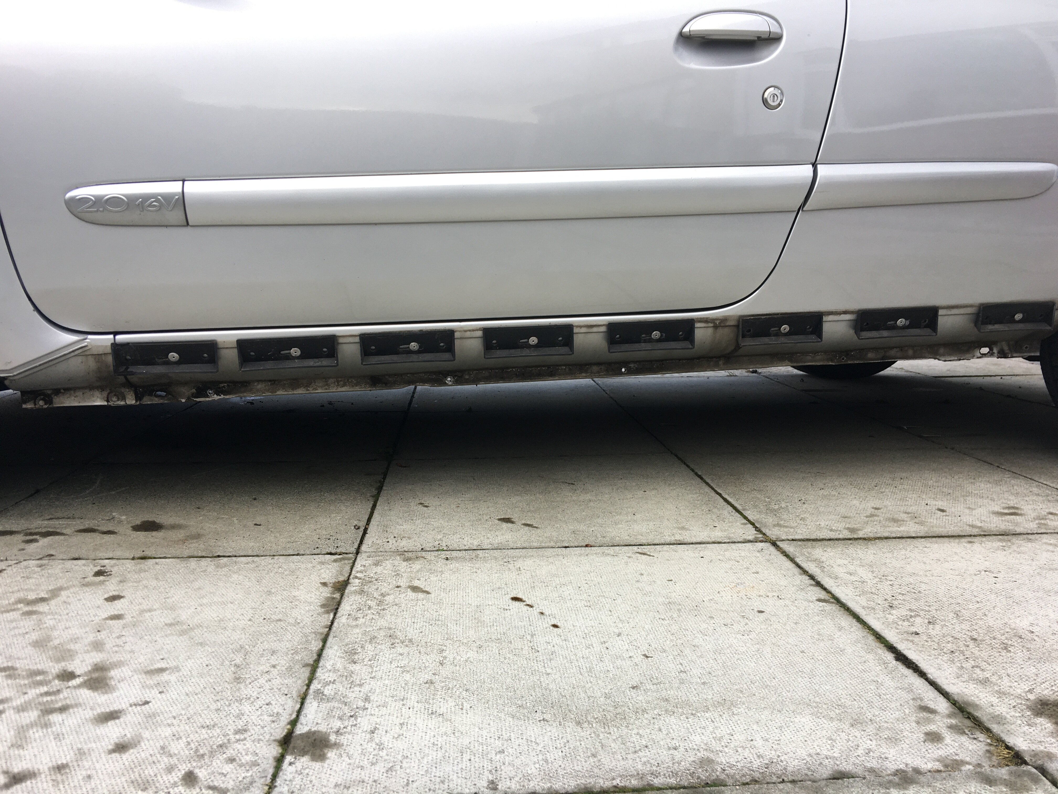

Next up was cleaning out the front arches and sills. Definitely worthwhile, so much compacted dirt between the arch liners and side skirts. The arches, arch liners, skirts and sills were given a couple of passes with BH Surfex HD and AF Oblitarate, liners coated in AF Dressle. Any rust was ground back and treated with some electrox and hammerite. Sills were given a coat of dynax UB on top for good measure.

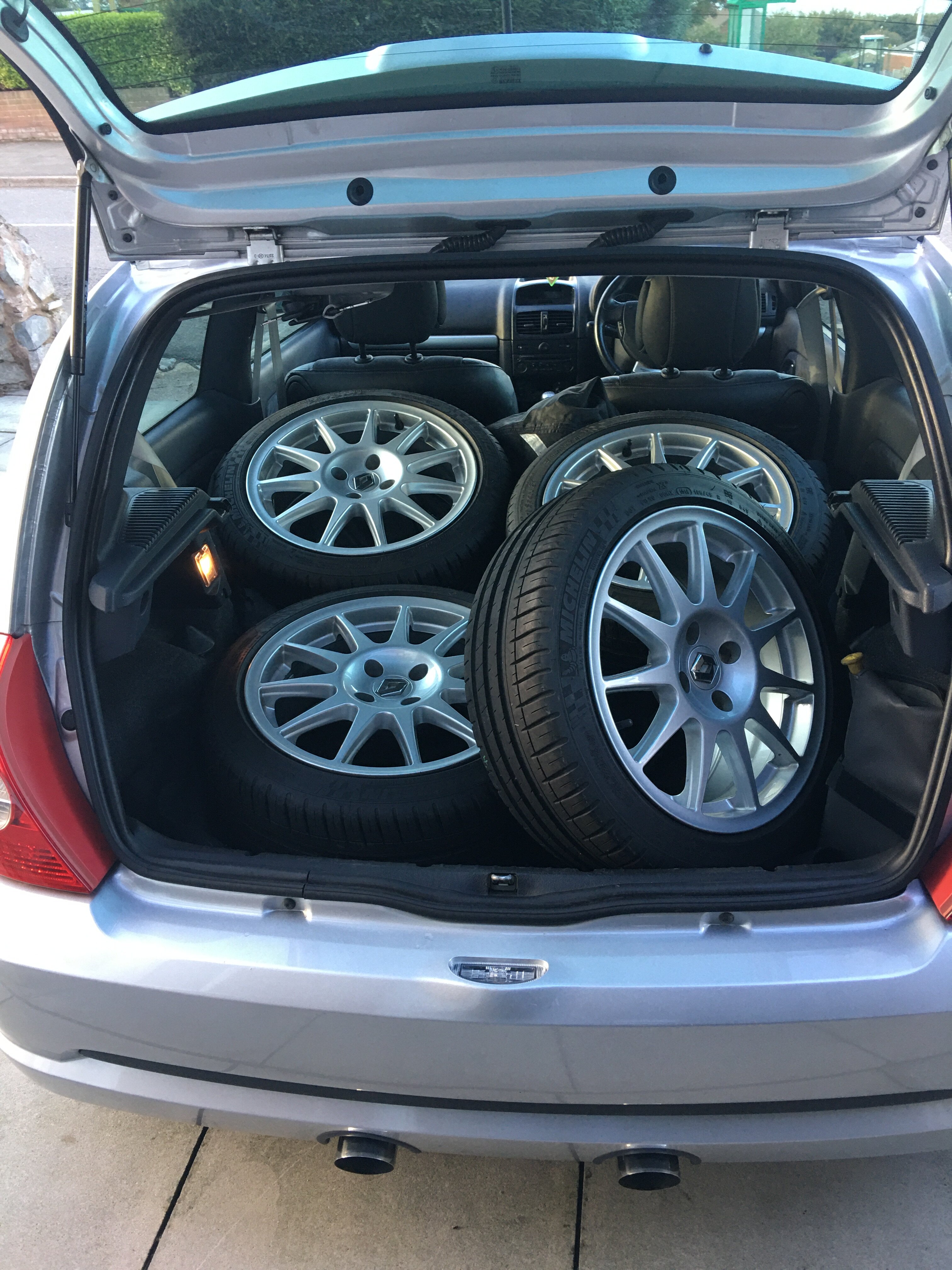

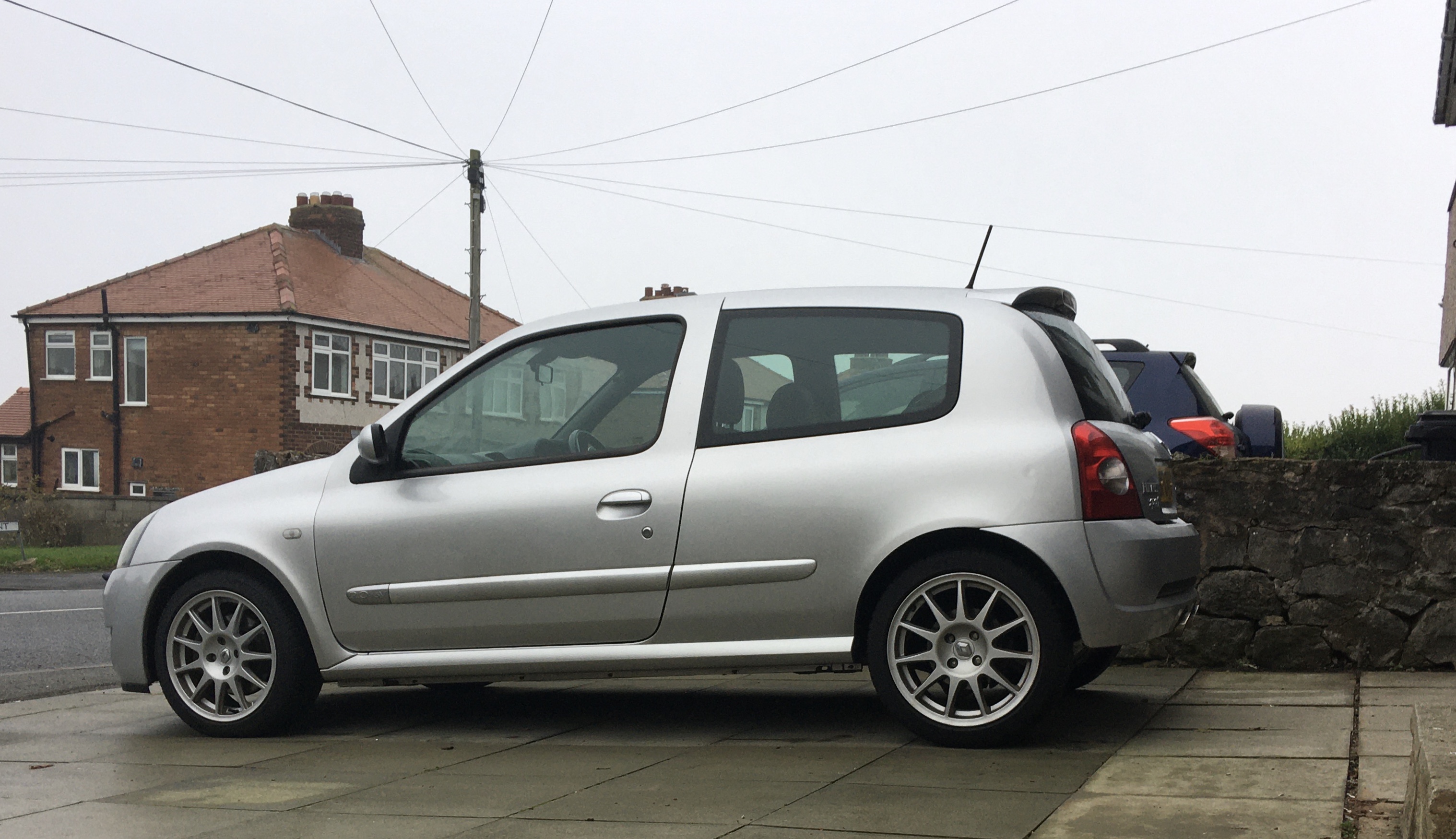

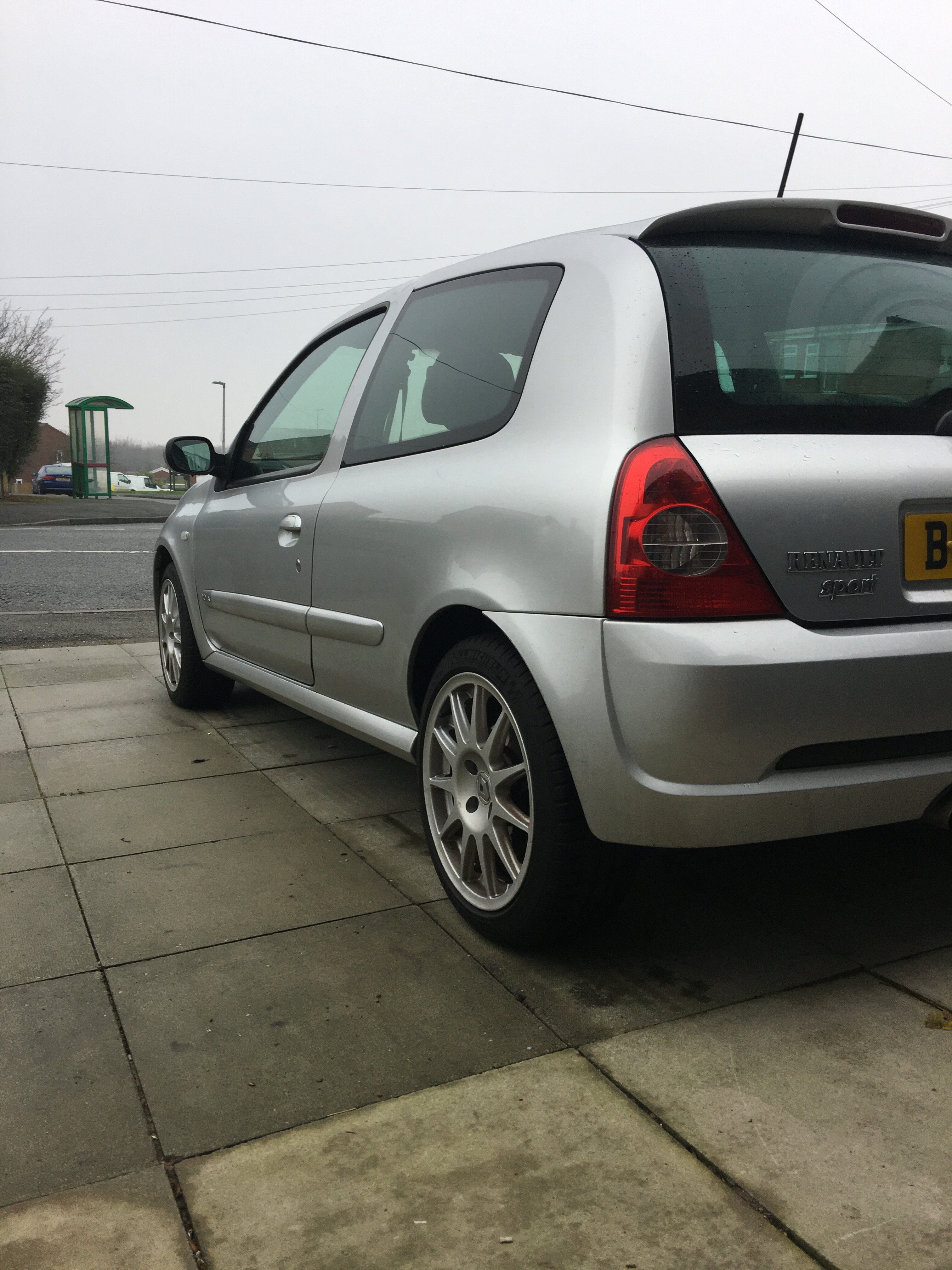

Ive been keeping a look out for a set of turinis since ive had the car as the standard wheels look a little tired to say the least. A few weeks ago I found a set of 172 cup turinis on ebay in good condition with ps3’s all round for a reasonable price and local to me! Couldn’t say no!
Pics are from before sorting the sills out. Really need to take more pictures in future!

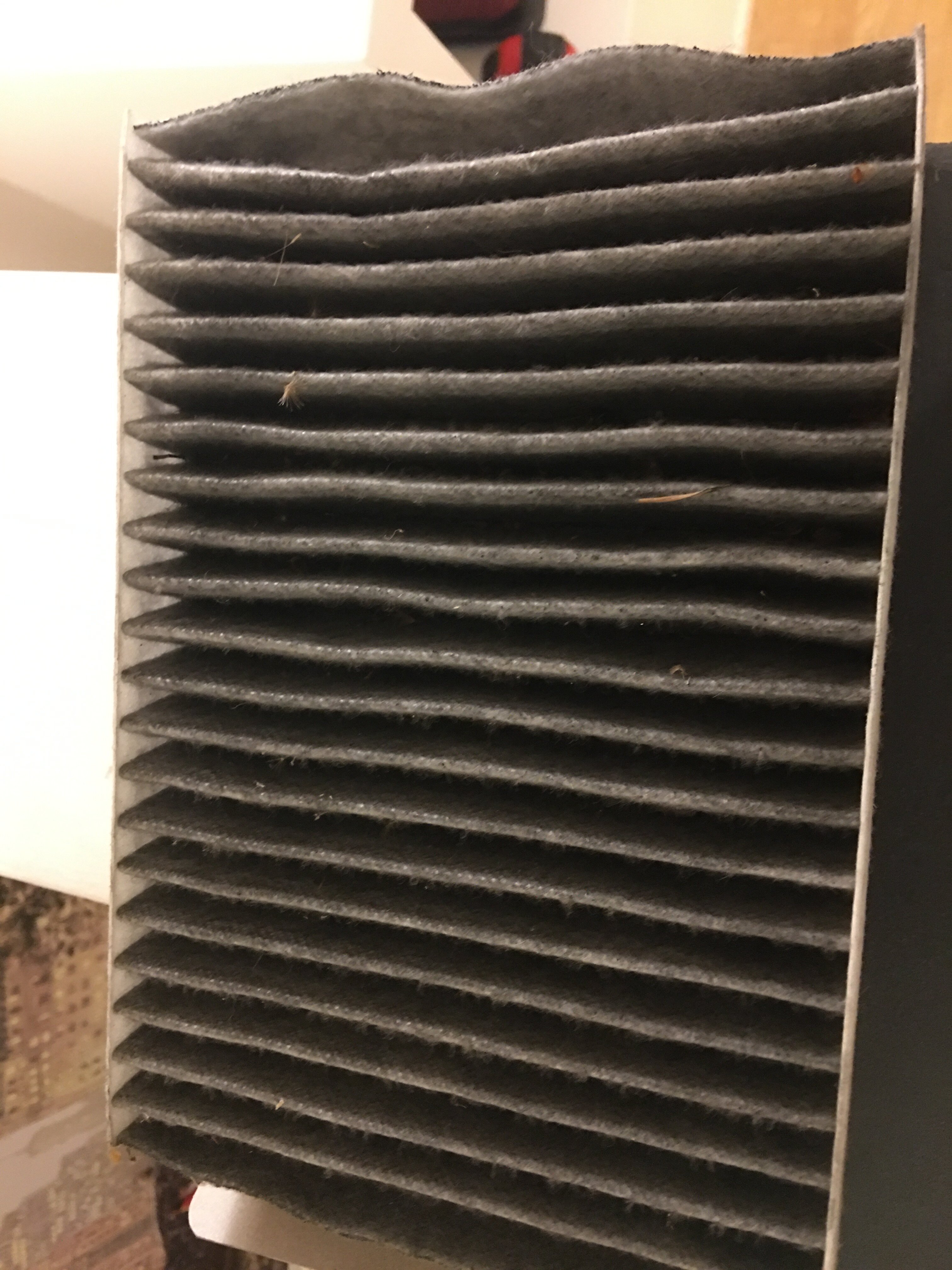

Cabin filter changed, not the worst but worth doing for a few quid.

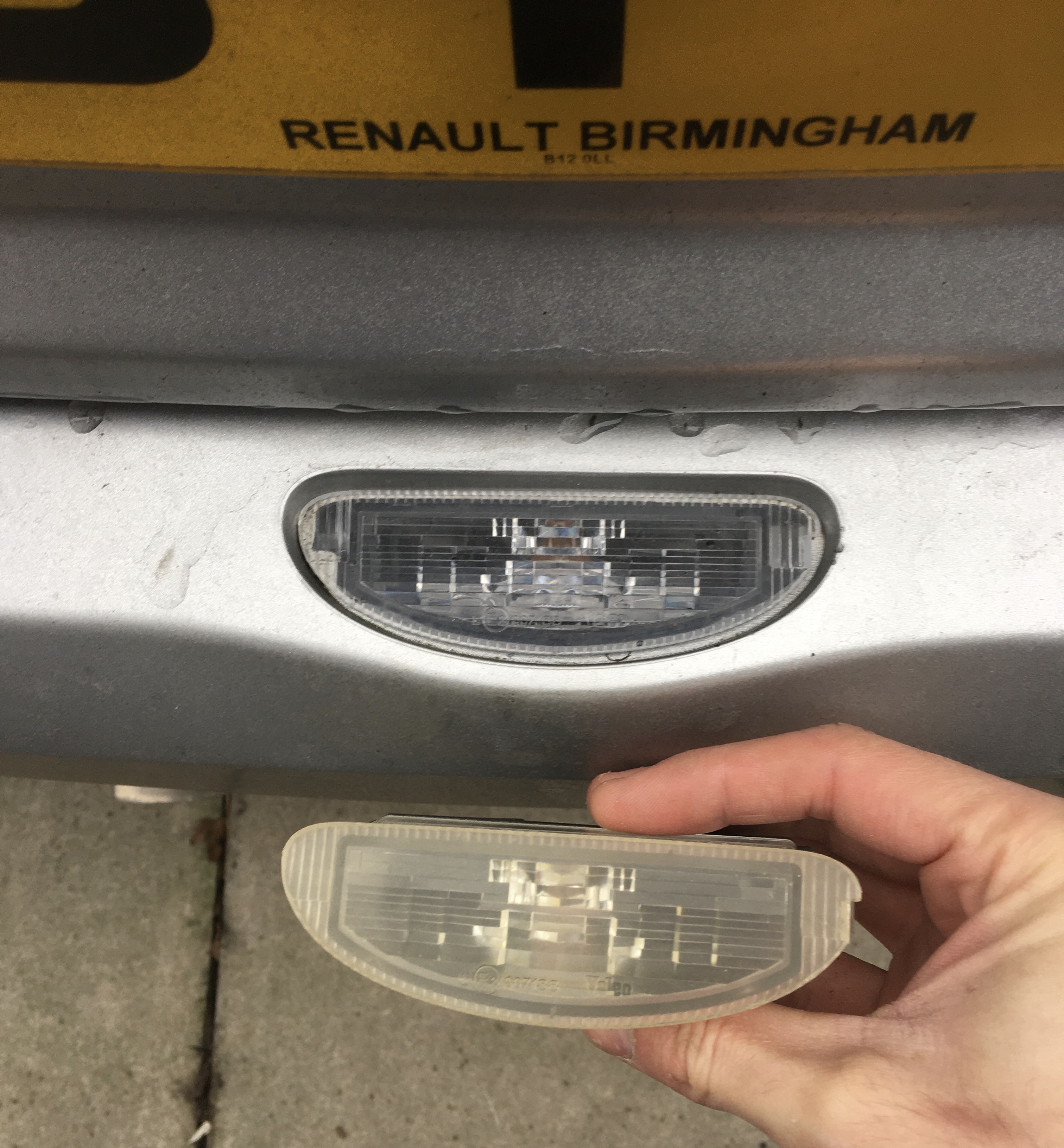

Obligatory number plate light swap

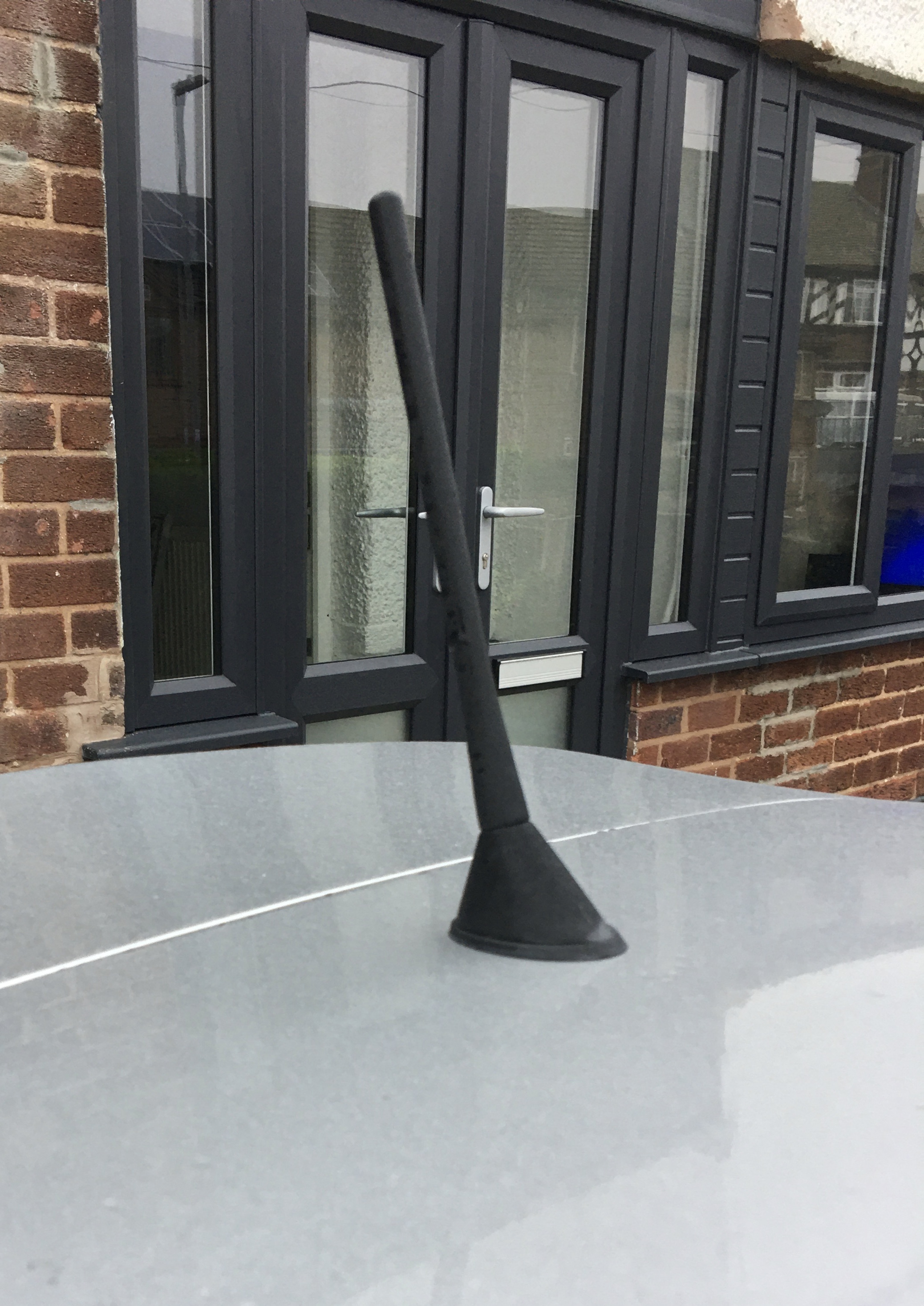

Latest gen Fiesta aerial. About half the size of the Renault one, no difference in signal and looks OEM.

Nice and great colour/wheel combo.
Titanium is so hard to photo. It either looks so bright and white silver, or brown 😂
It really is! Probably the best silver I've seen, a lot more flake in the paint than most silvers you see I think. Looks better in the flesh anyway.
Show off!😂 Think I've seen these on your project thread before, stance looks perfect! Makes me want to address the arch gap on mine, perhaps some springs in the future. And something better than my 3yr old iPhone for taking pics😂 2nd pic really shows off how bright and metallic titanium is.

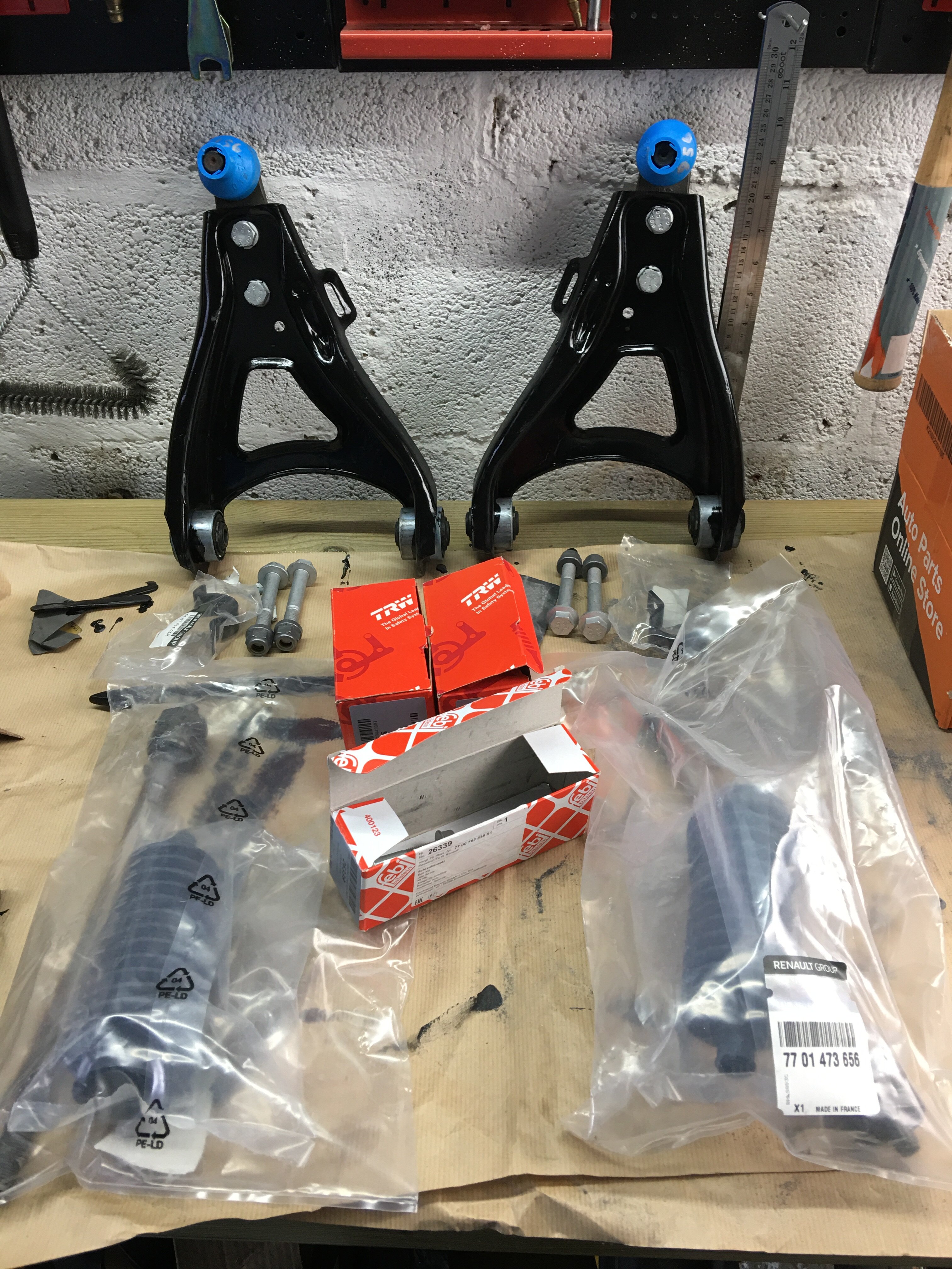

This week ive been carrying on the front end refresh, had a collection of parts building up for a little while now so it was good to finally get them all fitted!
Genuine - Wishbones
Outer ARB Brackets
Tie Rods
Febi wishbone and ball joint bolts
TRW Track Rod Ends (1/3 of the price of genuine and make OEM from what I can find on here)
The wishbones got a coating of BH epoxy mastic before fitting just to give a little more protection. I give all the bolts a wire brush and a coat of plusgas beforehand, but wasn’t going to f**k around so the big guns came out.

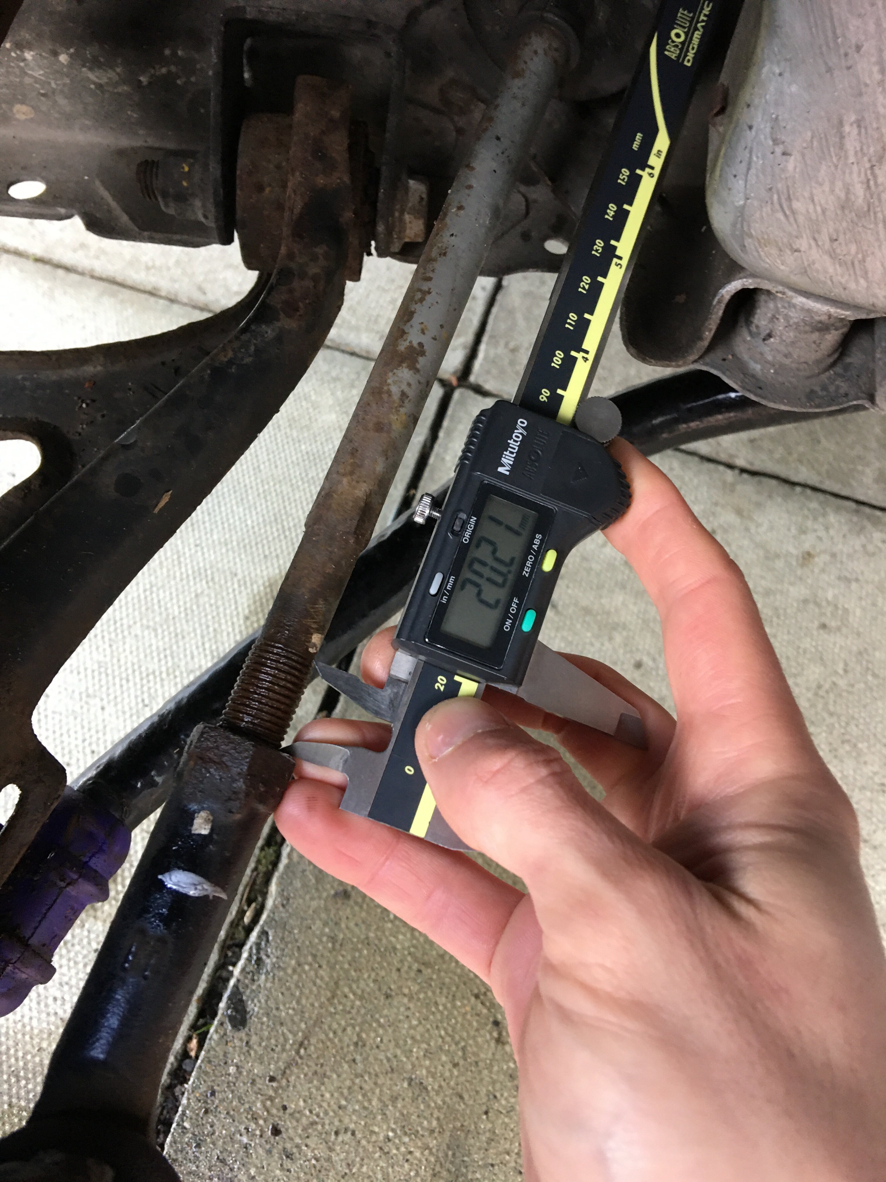

Threads measured up for comparison.

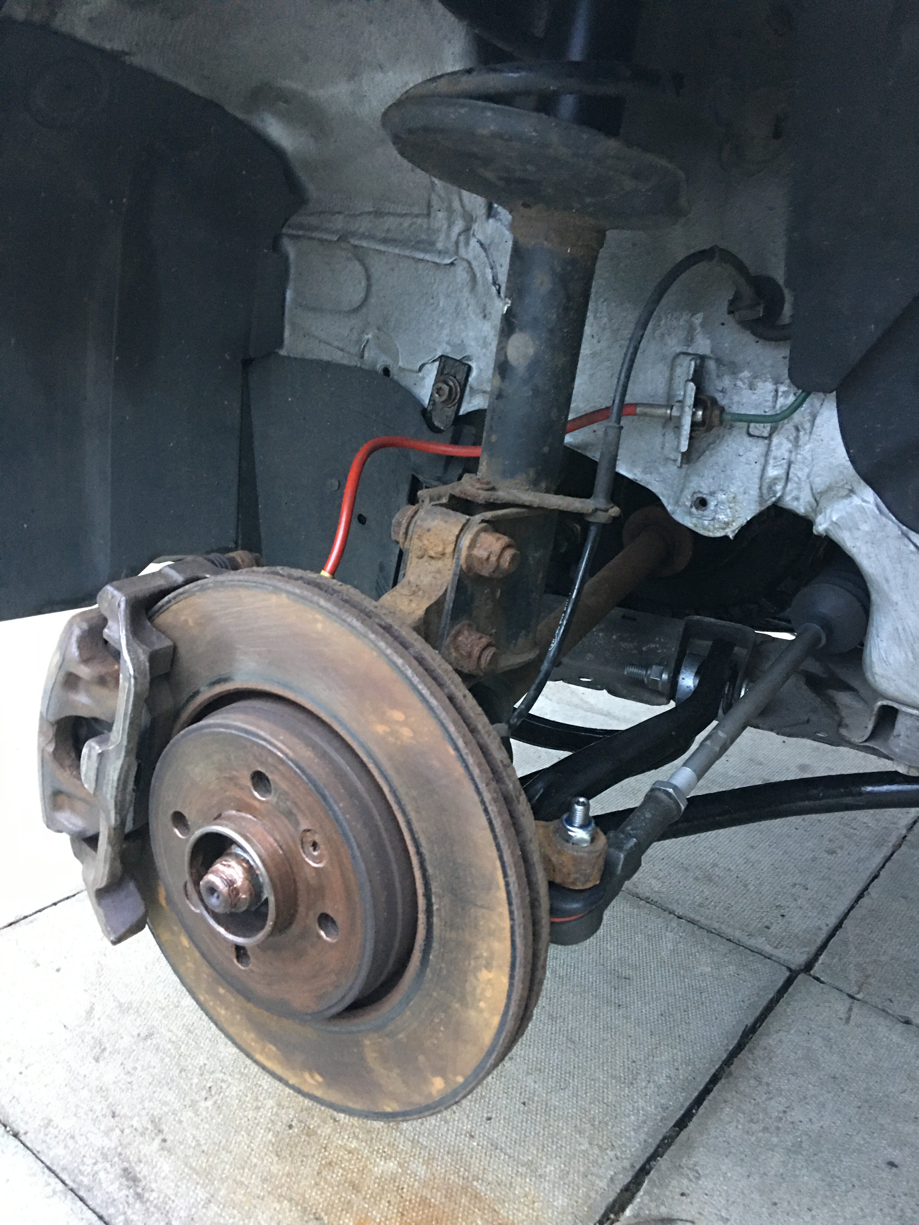

Safe to say they the tie rods were due changing.

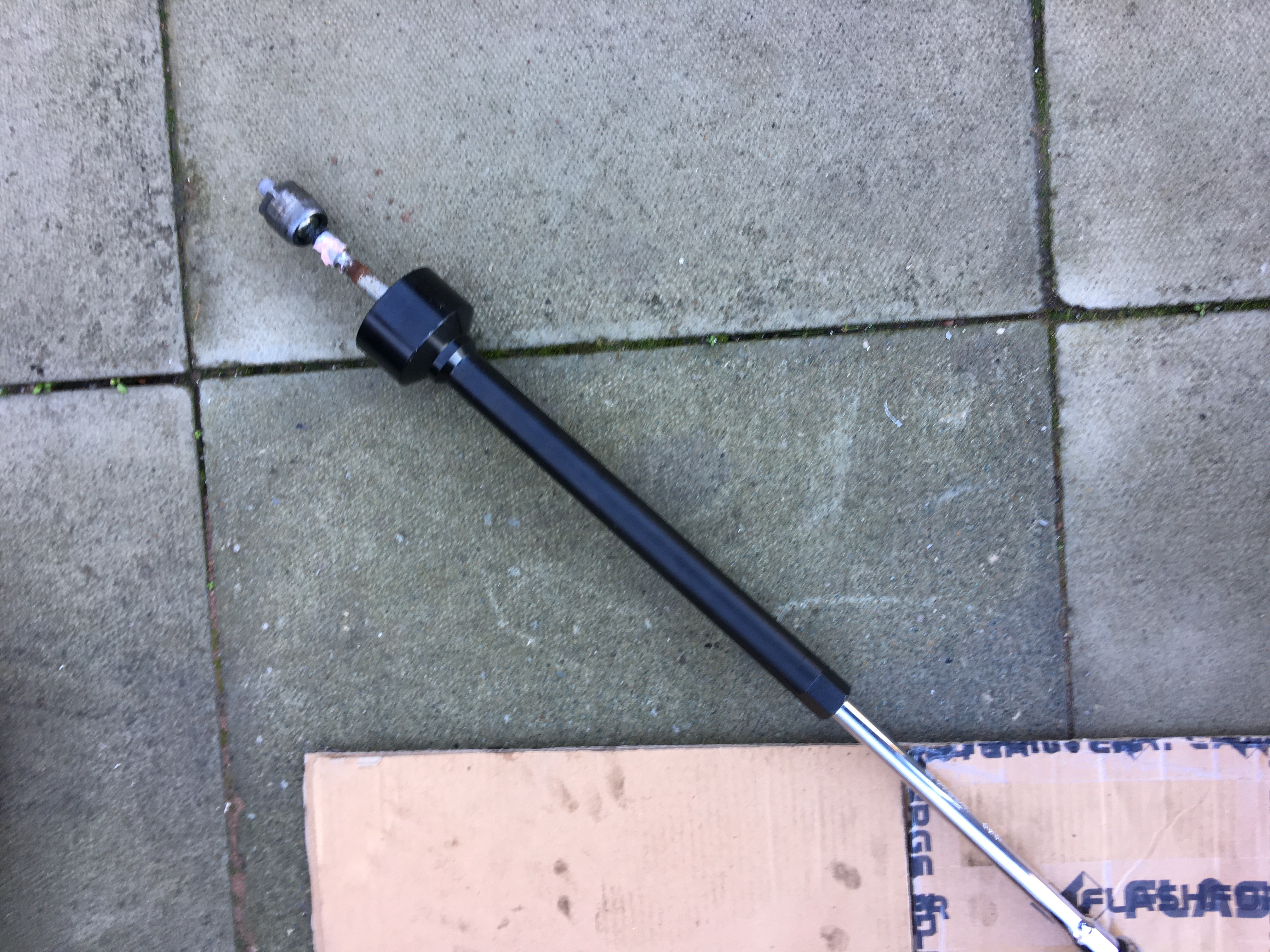

Got a tie rod tool off amazon, makes the job so easy.

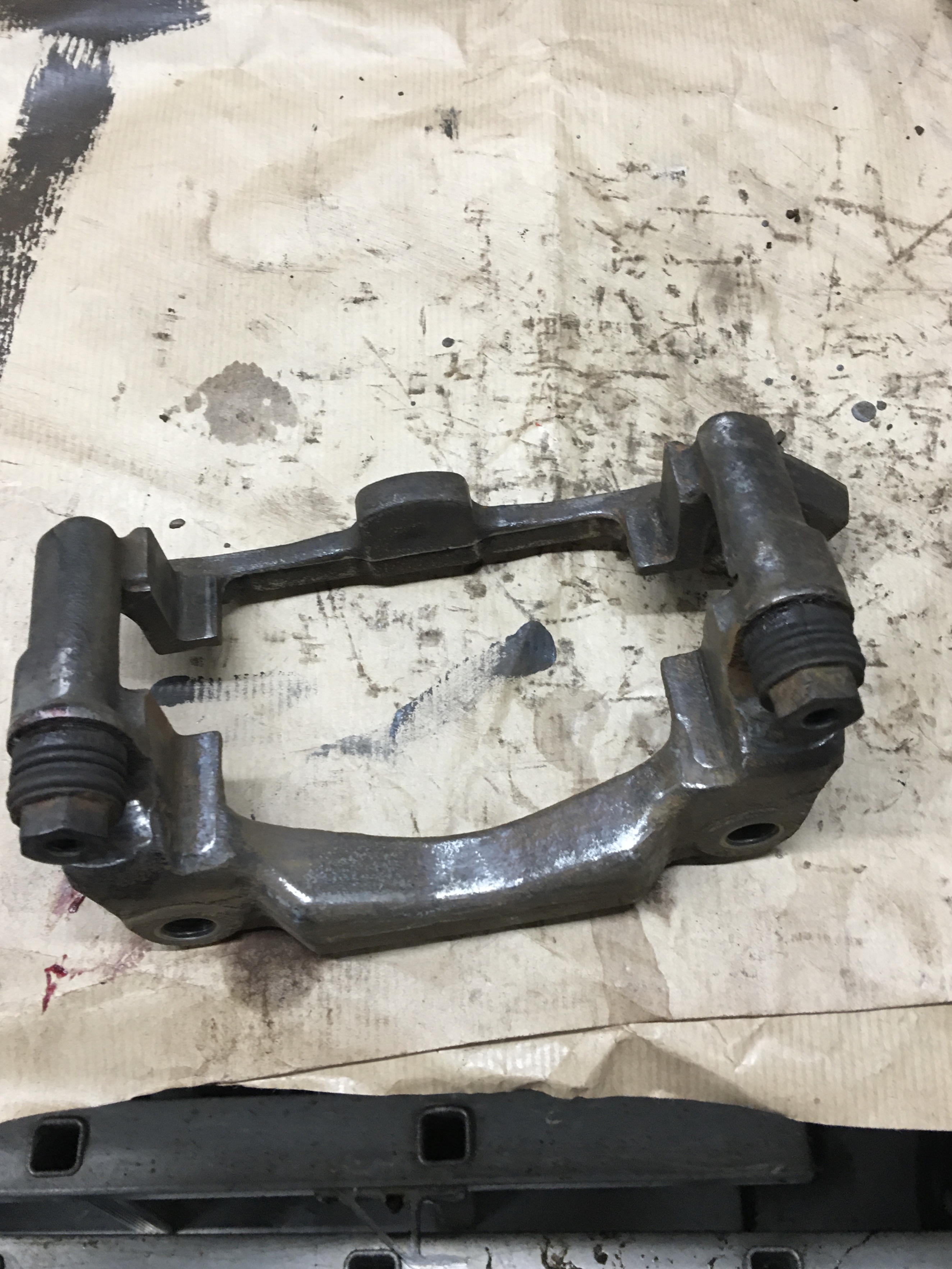

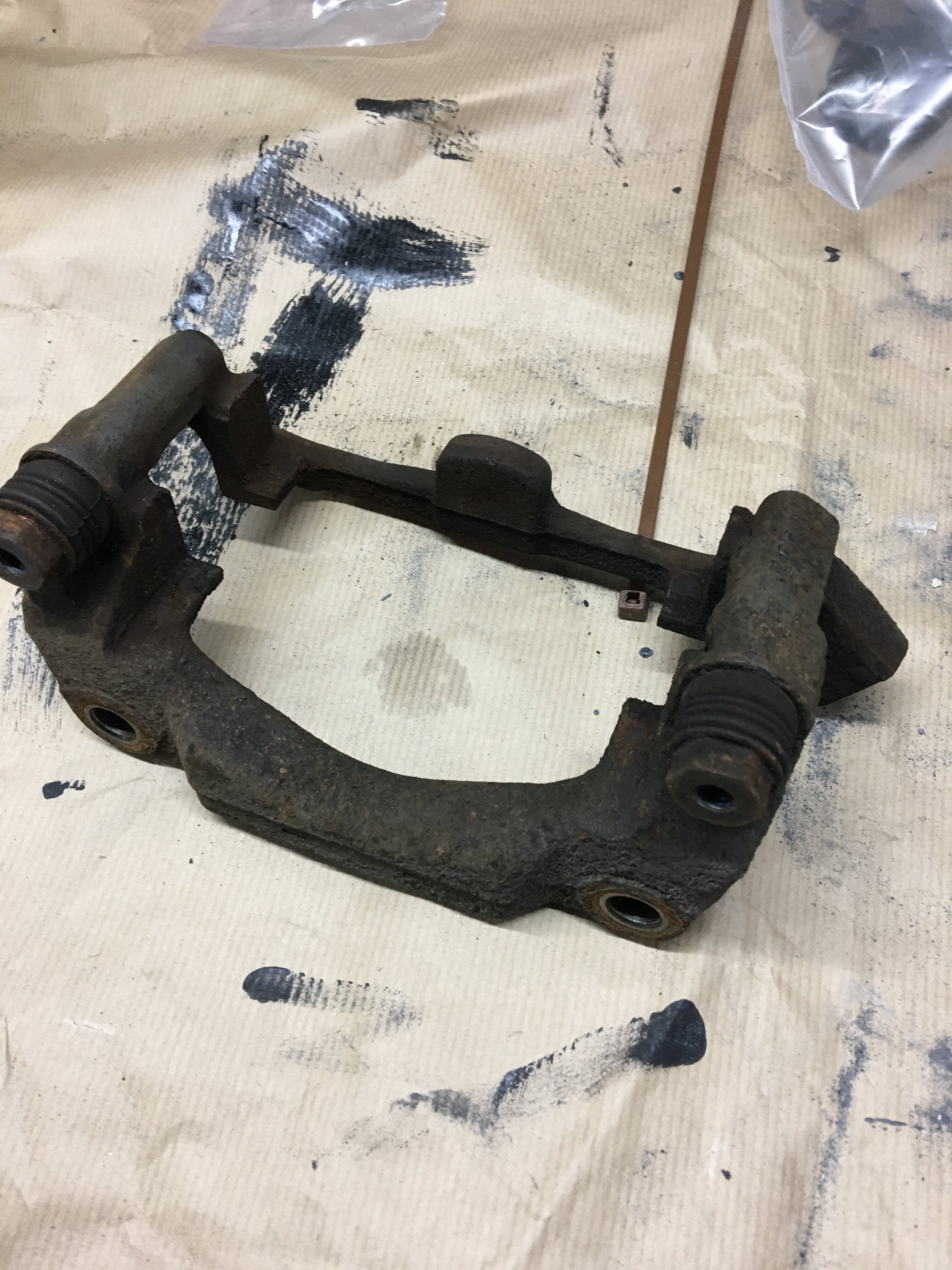

Gave the callipers and carriers a clean up in and out just to get rid of the worst of the pad deposits and rust for now with a wire brush and dremel. Pads cleaned up and sliders cleaned and regreased too.
All back together looking a little better than before!
Took it out for a quick drive up the road and its definitely made a difference. Sharper and abit smoother if that makes any sense. Alignment seems ok but il have another look over everything tomorrow and get the alignment checked.
