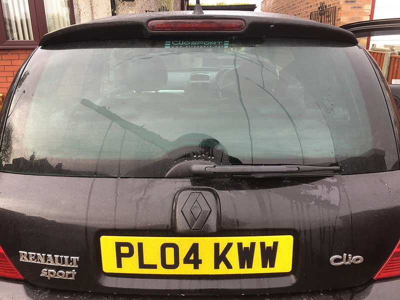

Just remembered I have this photo, which shows what I'm on about.
So as you can see, it wipes 3/4 of the way it should, then goes back past the resting position wiping the top of the boot lid then back up to resting.

While we're on the subject of the rear wiper... as mine reaches the apex of the rotation it loses contact the rear window towards the end of the blade. So rather than the normal shape of the wipe from the rear wiper I get something similar but flat at the top. Its not a major issue or causing visibility issue but it annoys the hell out of me; any ideas anyone?
Mine does the same . I think thats normal, I know what you mean , its annoying lol
And mine... but only since my wiper arm got stuck whilst cleaning the car, then snapped when putting it back down.
I tried a new non genuine arm, then another genuine one, genuine blade, then changed the motor itself and it still does it...
Heres an old picture of mine at its worst during the winter months, it reminds me of the batman symbol or something, hate it!
