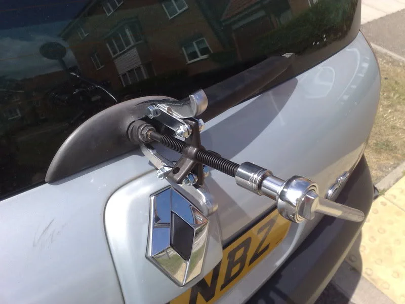

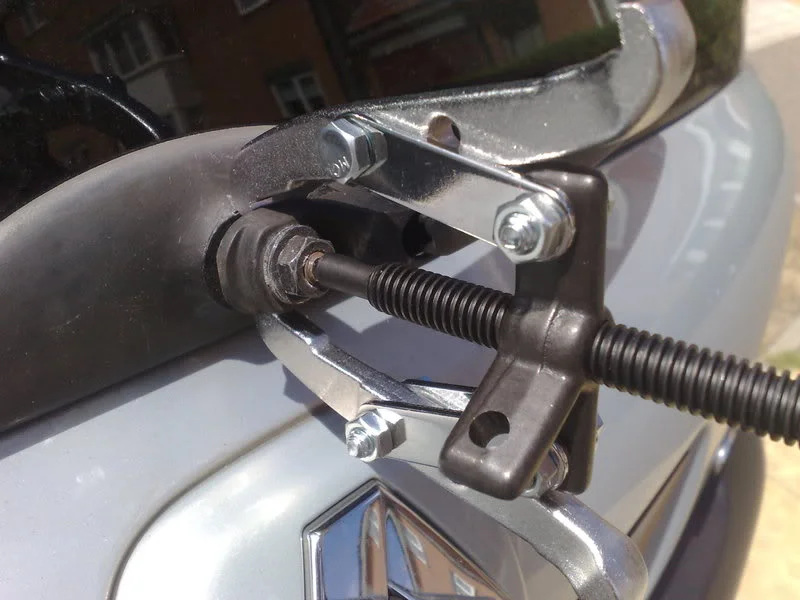

Right, i've bought the tool from Screwfix, and taken off the blade and the cover....
Looks like this at the moment, been tightening the long black bit, but its just not budging the wiper arm.... it just seems to slide out of place all the time!
Am i doing something wrong?

I tried doing it with the nut off, but it kept slipping aswell, so i put the nut back on it for some extra grip! Didn't happen!

unscrew the nut further so it holds the tool in place
and you need some plus gas/wd40 or similar on it

Nope, didn't work either!

loosen the nut right to the end so the black point on the tool sit in it, tighten it till it creeks abit then loosen it an put it on a side ways angle, from vertical to horizantal, then do it again and it should slowly start to prize off, it will take some force tough as they are fastend on with tiger glue stuff.
I tried that just now, but its taking chunks out of my wiper! LOL

Strap sum balls on son! pullers should pi$$ it, make sure the legs are down behind the wiper as far as poss, loosen nut till its on a few threads and tighten the pullers down, it should pop off well easy if your doing it right.
Youve gota stop them from turning though, so get someone to hold them still for you if you cant do it.

Well if i take the nut off the arm that im tightening keeps sliding off when it gets too tight
  172
why does it?the nut shouldnt be touching any part of the gear puller,its better getting a 3 armed 1,holds itself aligned then
