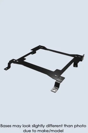

The Subframe is the metal base (seen in the ebay link in my post above). It is specially designed to fit the floorpan of a certain car.
Sidemounts attach the seats to the subframe. These are Recaro side mounts -
The majority of decent seats will be sidemounted as it gives better support and also allows you to change the angle at which the seat is sat.
Cheaper seats are base mounted and do not require side mounts. This Sparco base mount subframe bolts directly to the seat -

Oh so the subframe fits to the car floor and the side mounts fit the seat to the subframe. Really wish i could have fixed seats instead of reclining lol. One of each would be wicked but look naff wouldnt it?
