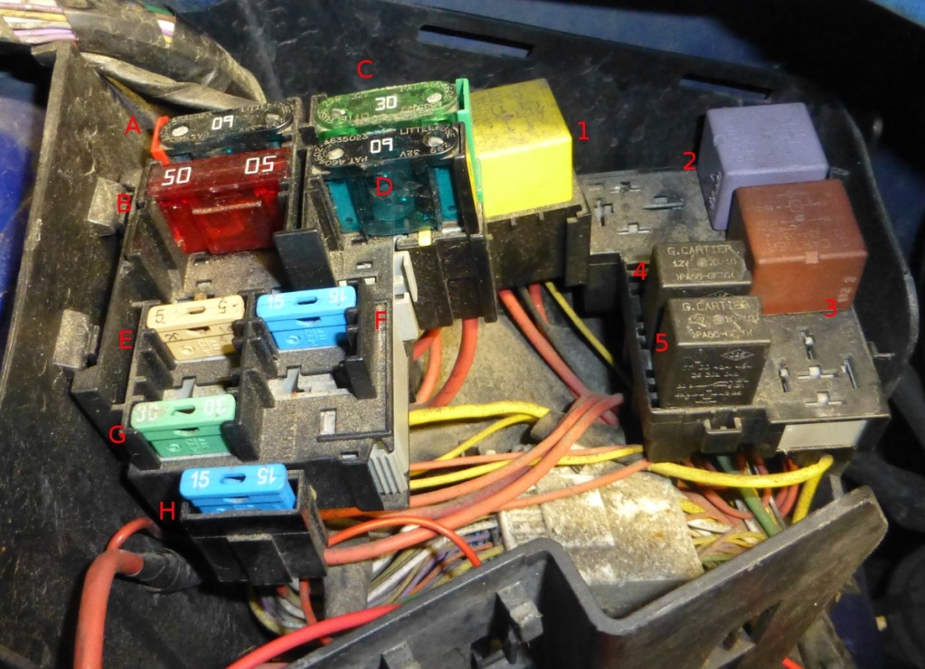

Hello there, thankyou for your reply, can you tell me which relay is the Immobiliser relay please as there are several relays, thanks again Graham. Les
I can't actually remember exactly which one it is but in the fuse box there are three small black relays which all look the same. By removing them one at a time and looking at the dash you should be able to tell which one is the immobiliser one. They are interchangeable so swap them around or buy a new one if you find a duff. They look like 4/5 in the photo.

Hello, GrahamS. Checked the Relays and found that one of the thinner wires that goes to the first Relay had been soldered together and taped up. Although soldered they had become dry joints, so thankyou GrahamS mate it running ok. Les
