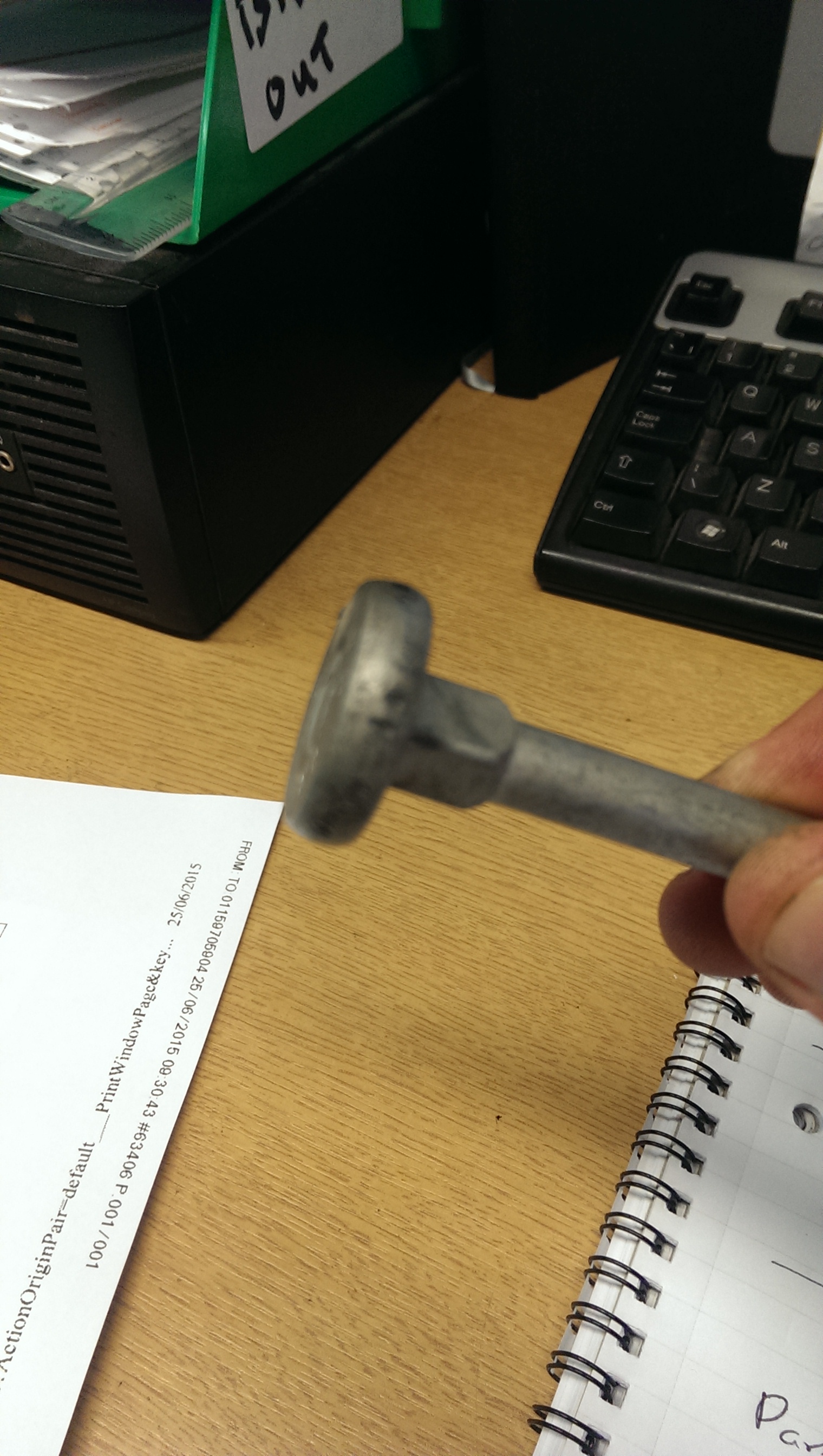

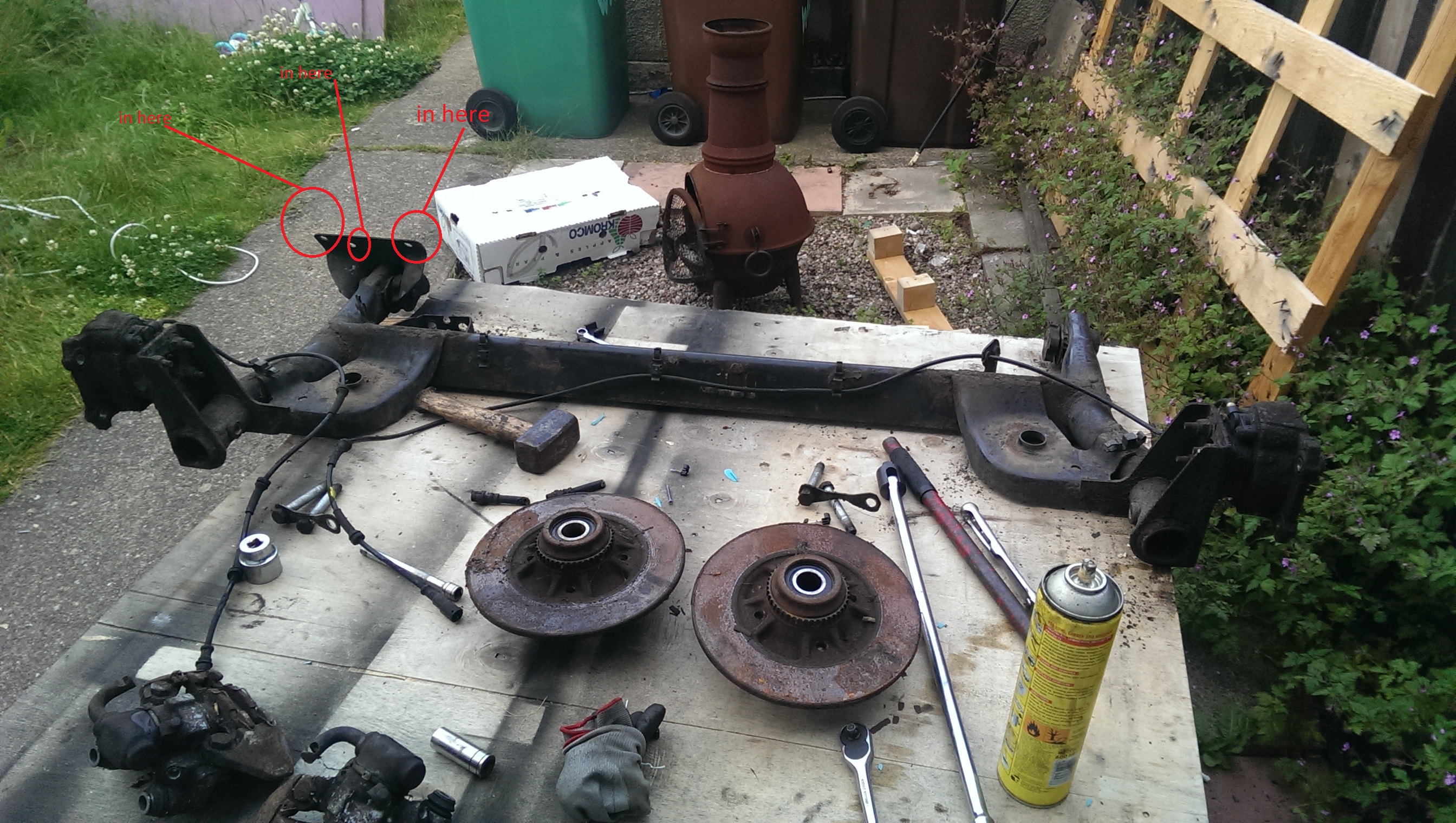

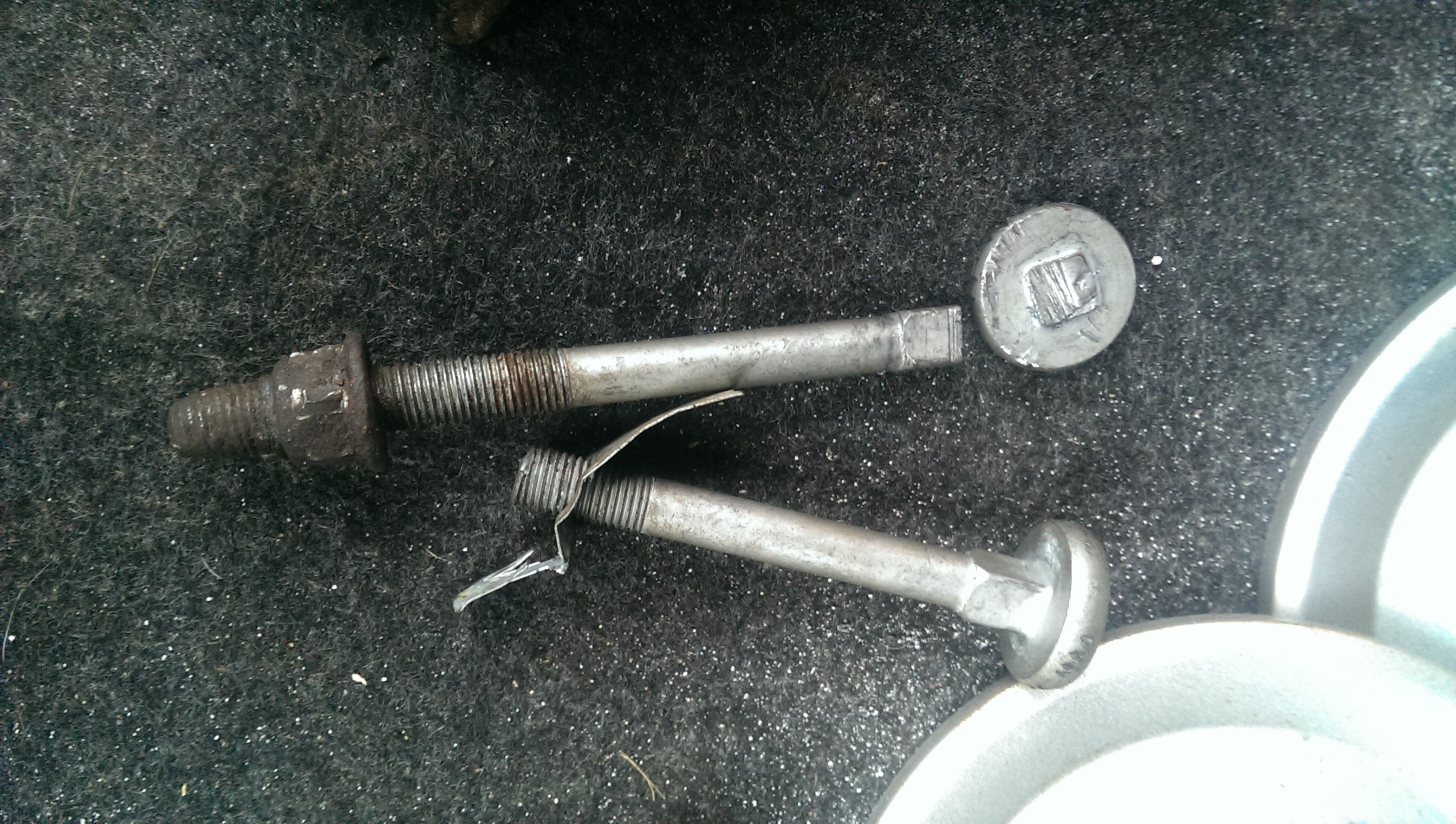

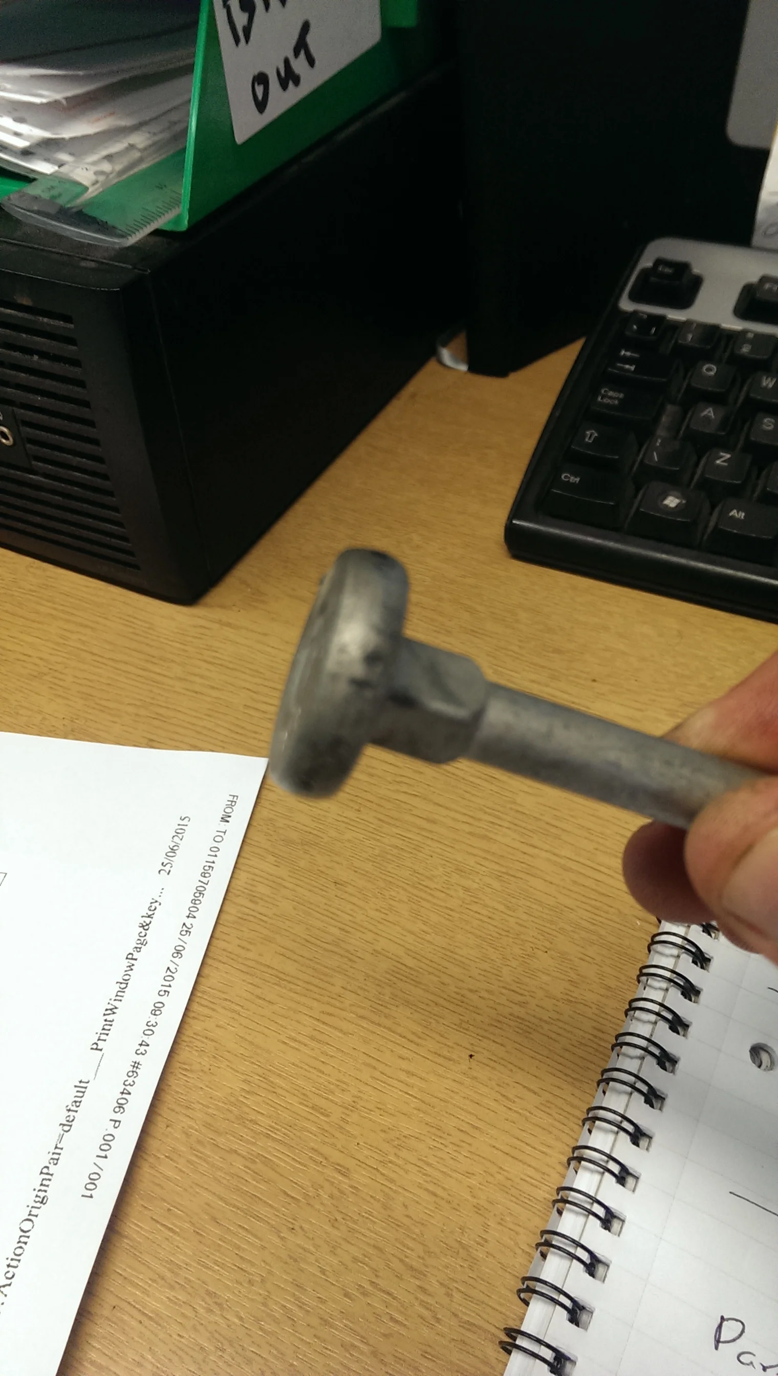

i followed this guide but struggled with the drivers side bolt coming out the rubber bush as the bolt was long it was hitting the fuel tank when I tried to get the whole bolt out, resorting me to remove the whole bracket which now im struggling to get replacement bolts for.
cheers :)
  Renault Clio Sport
they are coach bolts with thick circular head,10mm thick x 130mm long its the spring clips im struggling with the bolts I can find easy part no:7703015200
  Renault Clio Sport
here is a pic
