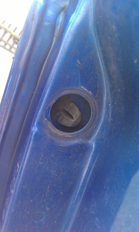

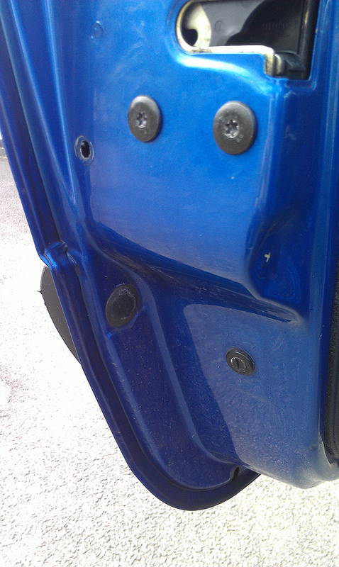

FIRST LOCATE THIS RUBBER GROMMET AND PULL IT OFF.
IMAG1026 by Reed Hopewell, on Flickr

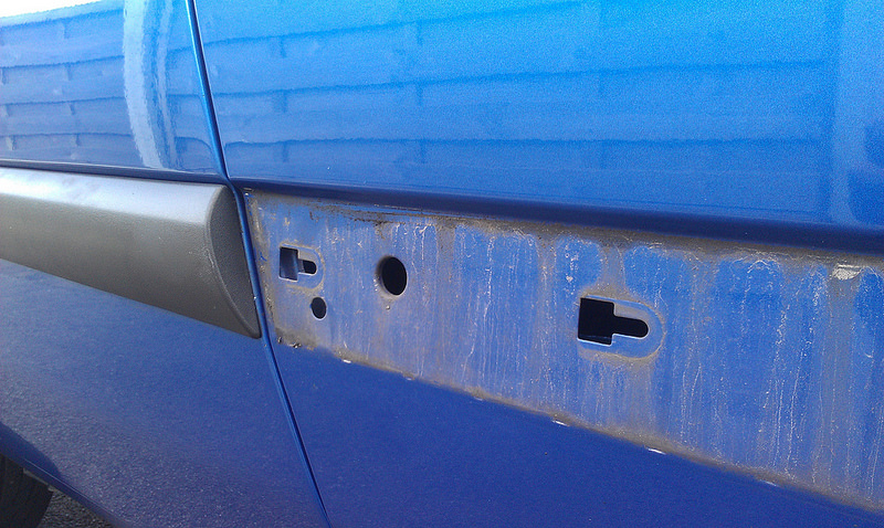

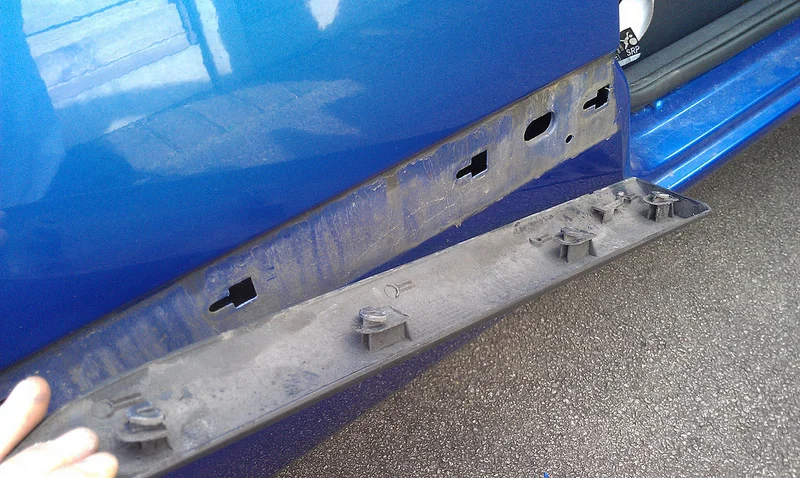

NEXT USING A SCREWDRIVER, PULL THE CLIP BACKWARDS TOWARDS THE BACK OF THE CAR.
IMAG1027 by Reed Hopewell, on Flickr

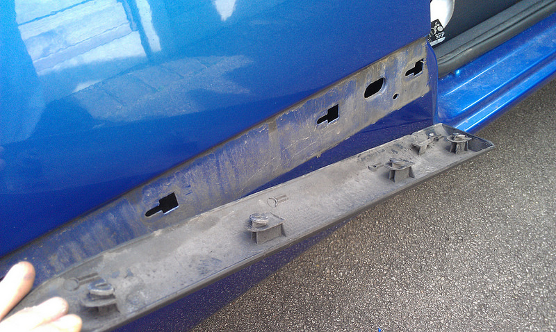

THEN REMOVE EACH STRIP BY PULLING AND PUSHING SEVERAL TIMES WITH FORCE AND IT SHOULD POP OFF. FOR THE FRONT PULL TOWARDS THE REAR AND THE BACK STRIPS PULL TOWARDS THE FRONT.
IMAG1025 by Reed Hopewell, on Flickr
IMAG1030 by Reed Hopewell, on Flickr

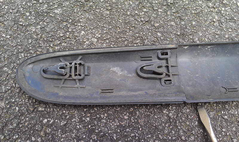

TO REMOVE THE BULLETS, POP THE 3 CLIPS OFF BUT BE CAREFUL AS THEY BREAK EASILY.
IMAG1024 by Reed Hopewell, on Flickr

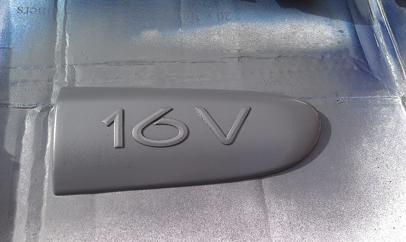

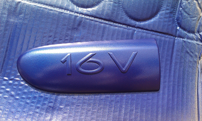

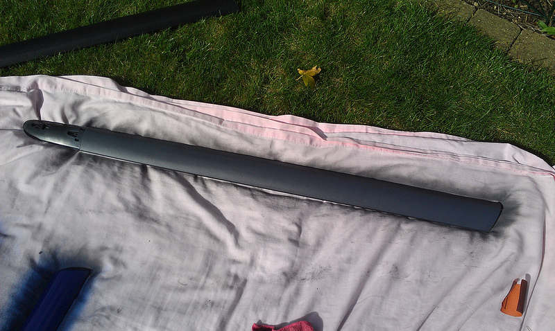

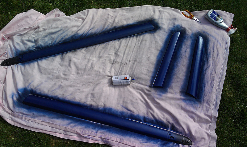

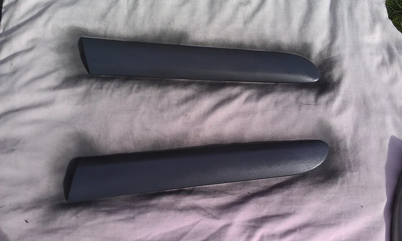

SPRAYING THE STRIPS
USING LIGHT COATS APPLY THE PRIMER, COLOUR AND CLEAR COAT. THIS IS WHAT IT SHOULD LOOK LIKE.
IMAG1029 by Reed Hopewell, on Flickr
IMAG1032 by Reed Hopewell, on Flickr
IMAG1034 by Reed Hopewell, on Flickr
IMAG1031 by Reed Hopewell, on Flickr
IMAG1037 by Reed Hopewell, on Flickr

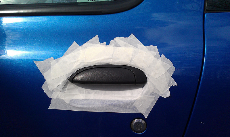

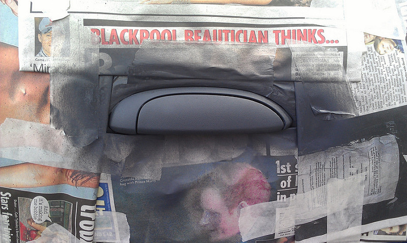

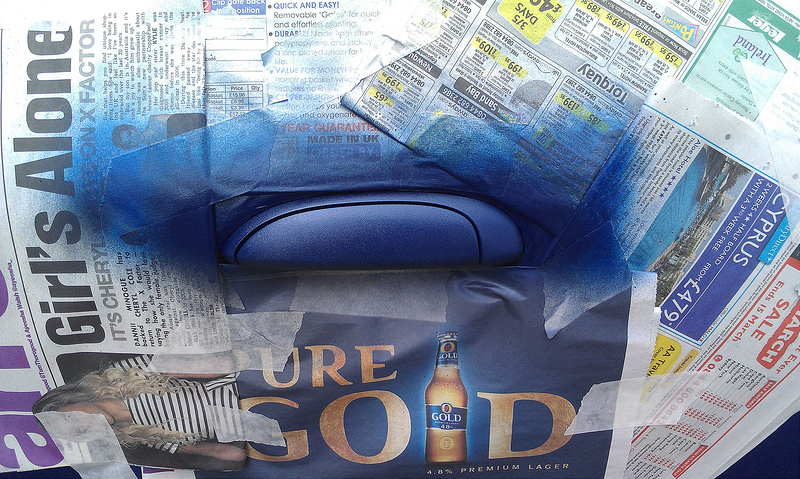

SPRAYING THE DOOR HANDLE
MASK AROUND THE DOOR HANDLE AND REPEAT THE PREVIOUS STEPS.
IMAG1038 by Reed Hopewell, on Flickr
IMAG1040 by Reed Hopewell, on Flickr
IMAG1041 by Reed Hopewell, on Flickr

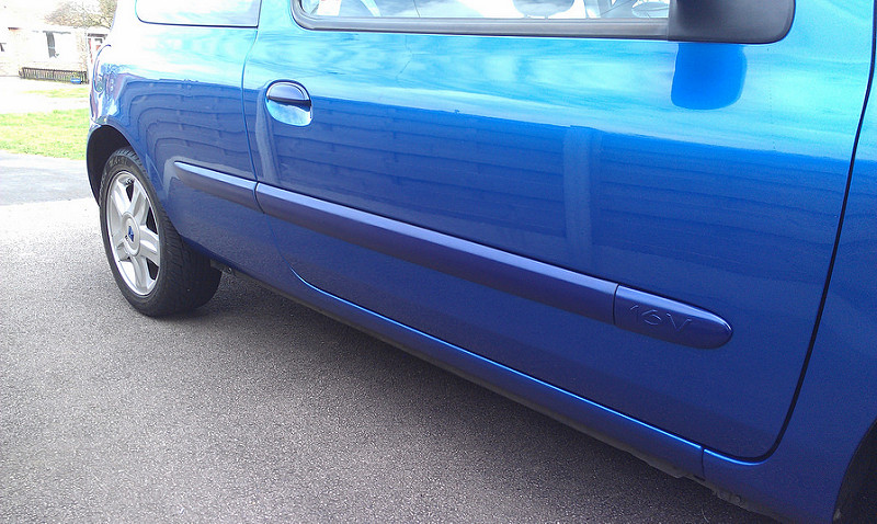

THE FINISHED PRODUCT
IMAG1045 by Reed Hopewell, on Flickr

I would highly recommend removing the door handles before spraying.
I would also apply a couple coats of clear coat.

Colour match isn't the best tbh mate.
What colour primer were you told to use?
