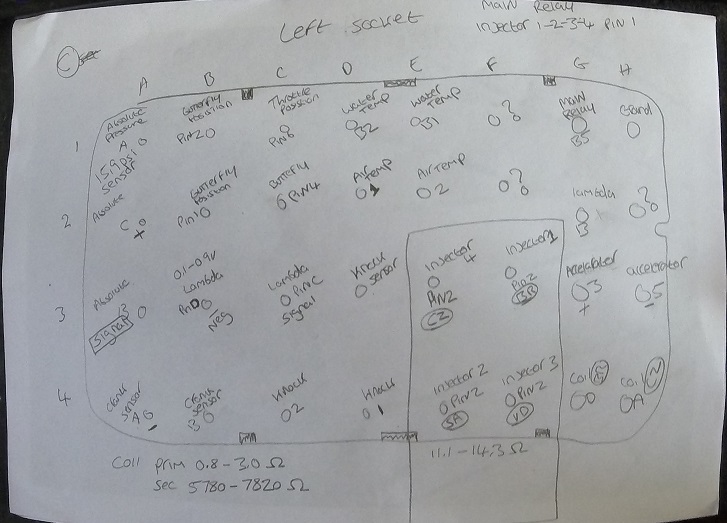

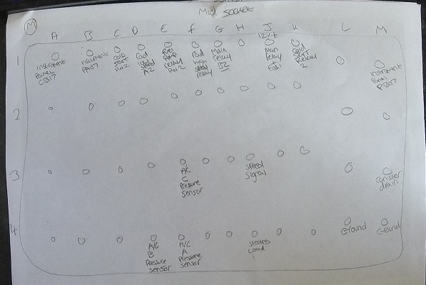

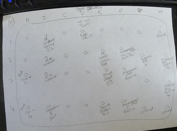

Hi qtron. Do you know if the ECU gets its 12V supply from the HCU? Rather, as no data at the OBD, I guess the ECU is dead or gets no dc-supply. What pins on the ECU connectors should be checked for dc plus or ground? Kind regards Haavar
