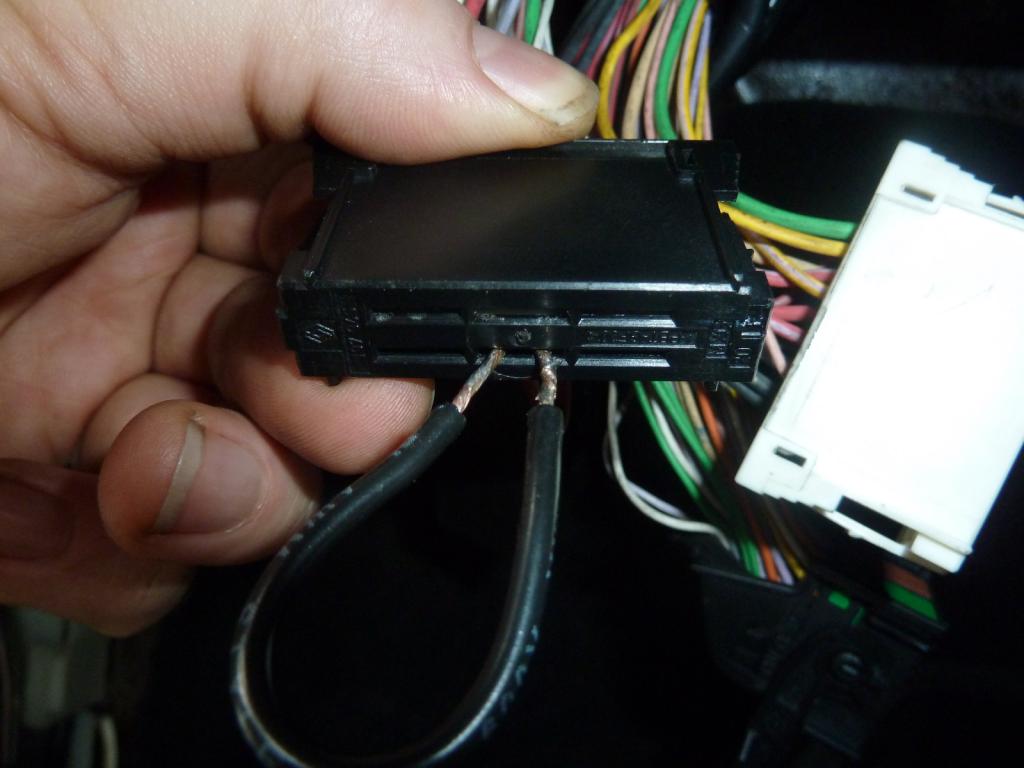

Okay been doing some more research and sounds like the next thing to try is the UCH. Found a fantastic thread about it, but I'm just wondering where the hell is this? Be good to be able to test it first as seen here...
Taken from this thread...
http://www.cliosport.net/forum/show...2-UCH-investigation-solution&highlight=window
