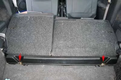

In the boot, remove two 17mm bolts from either end of the cross member at base of back seats - these bolts go into the floor pan and will probably be rusted on the ends, work them out a bit at a time then some WD40, work them back in and out - better than stripping the threads or shearing the bolts.
Remove the cross member.

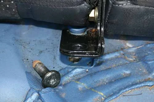

Remove the Torx 40 bolt in the bracket through to the floor pan at junction of the 1/3-2/3 back seat split, comments same as above, when this has been removed the bracket swivels back and the seat backs can be removed in tandem.

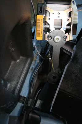

Remove the bottom inertia reel 17mm bolt.
The seat belt and reel can now be removed.
