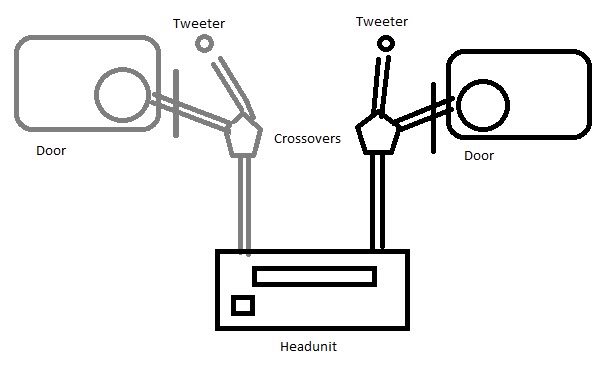

I might have a go myself but if I get stuck that's good to know, do I need to use the old wiring loom or can I just feed the new wires back through to the door ?
This is how it'll need wiring:
