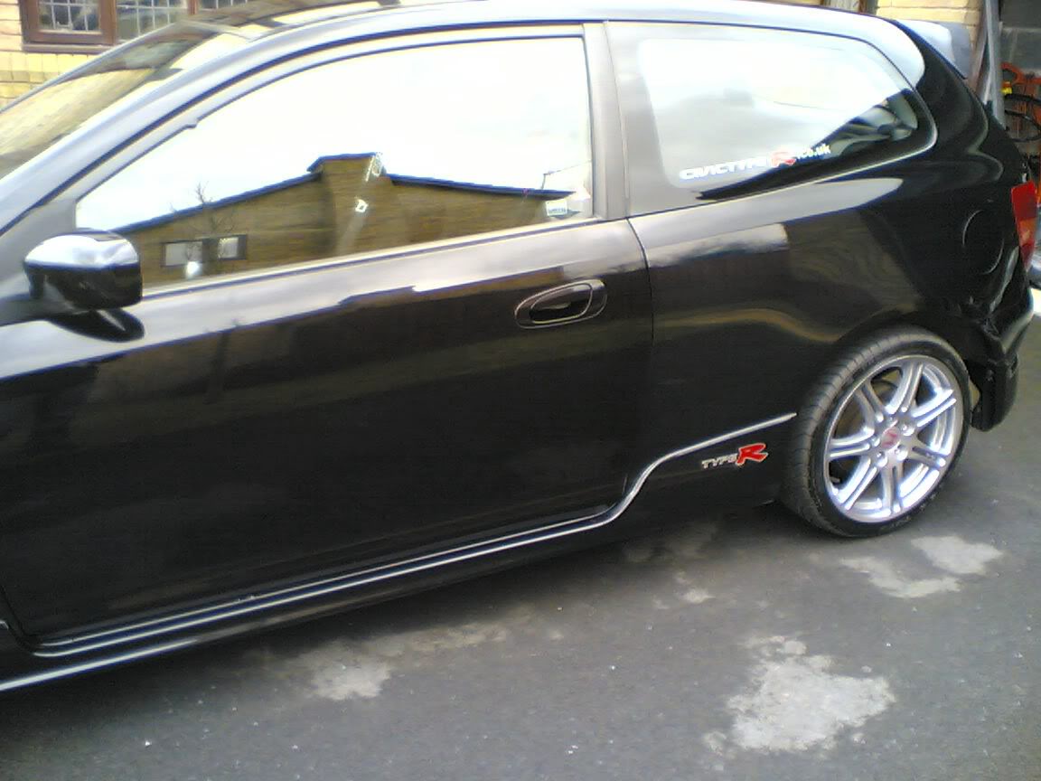

to give you an idea of how good it is, take a look at my old car and check out the difference between the rear 1/4 and the door (the door is the bit i had polished and waxed)!
