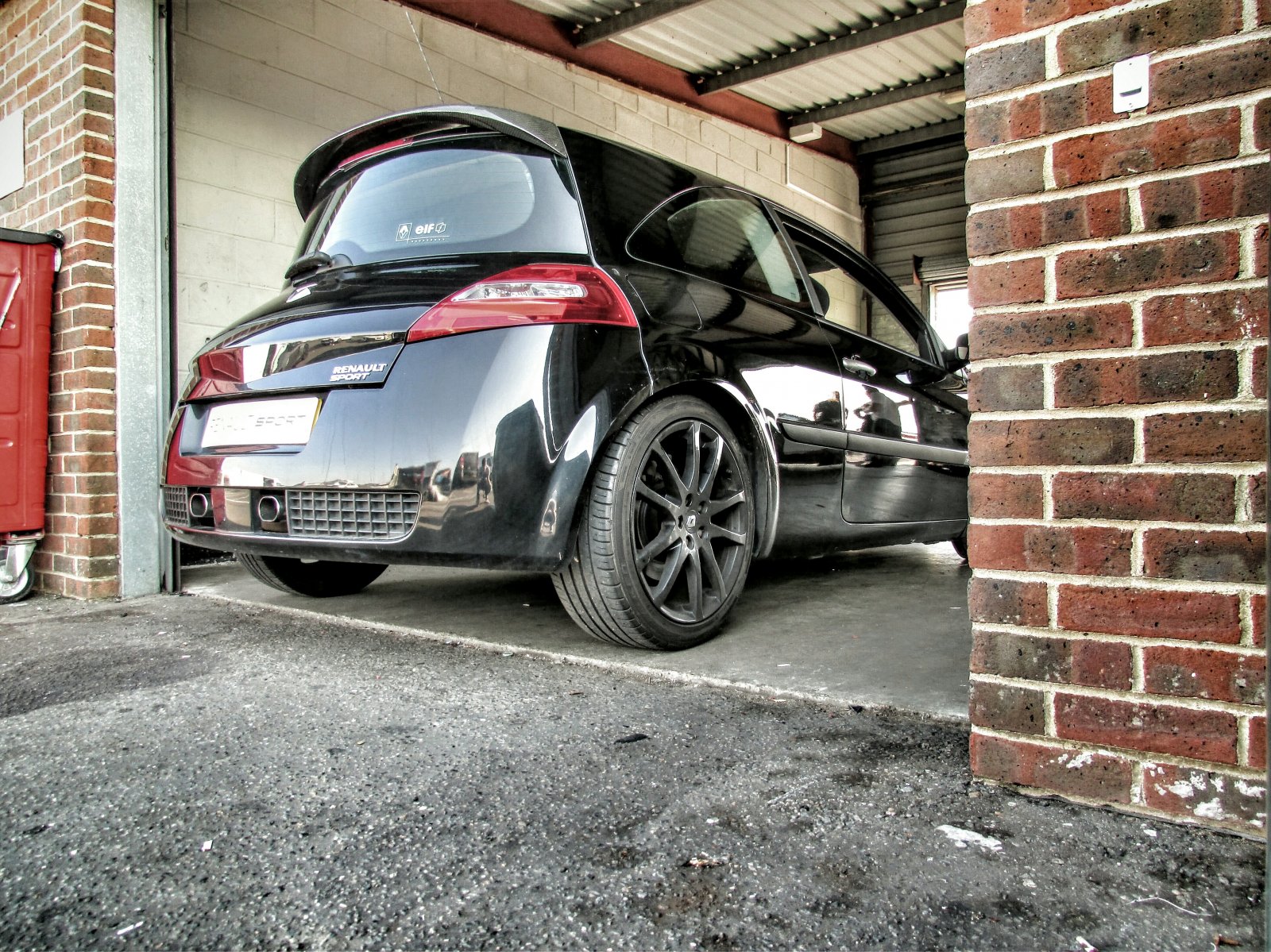

Looks great! How are you finding the coilovers?
Thanks Joe, means a lot coming from a fellow Megane owner. So far, I had my first half decent spirited drive last night. I haven't played with number of clicks on the settings but how they are now it feels soft enough to ride out the roads, at speed it absorbs the bumps quite well. Not hard enough to make the car skip if that makes sense, I can imagine some people #becauseracecar cranking up the stiffness on the damper setting to have a car bounce everywhere. Early signs they feel good, progressive and not crash. For the price they're worth it.
With the 2 degrees negative and 10 minutes toe out it has great turn in, coming out of corners you just squeeze the throttle and it's effortless power coming out.
Joe#
Sounds like you're happy with them, I find mine just as good on the road as when I had H&R springs fitted. I have mine set to 3 clicks from soft front and back for the road which seems to work fine for me.
Have you got any other plans?

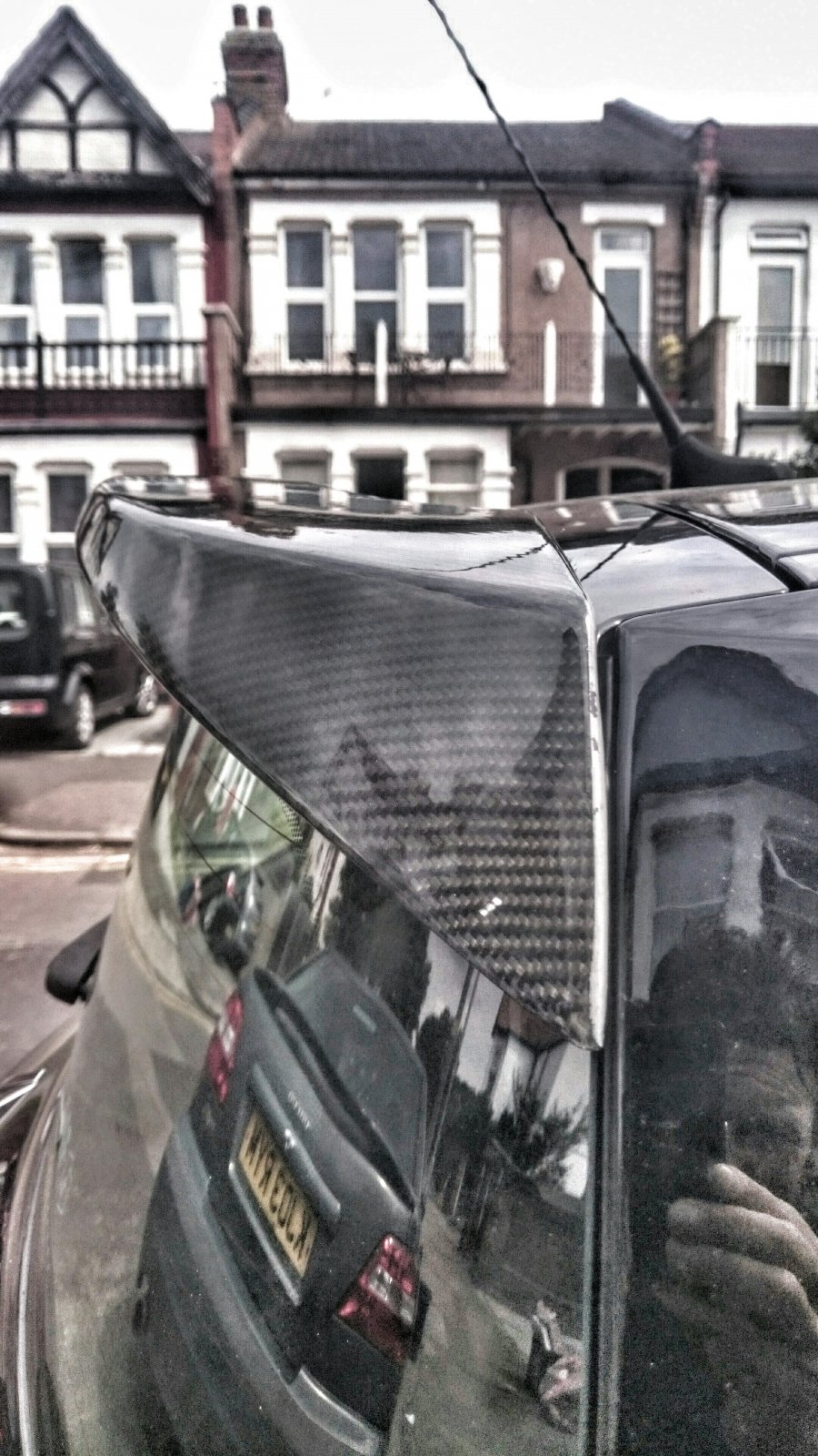

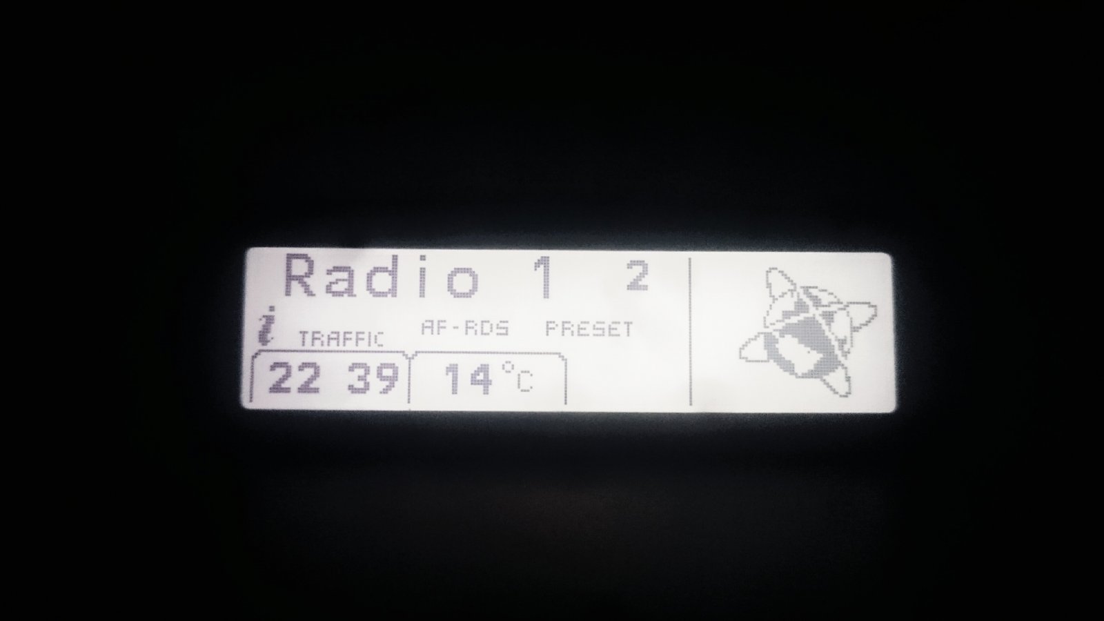

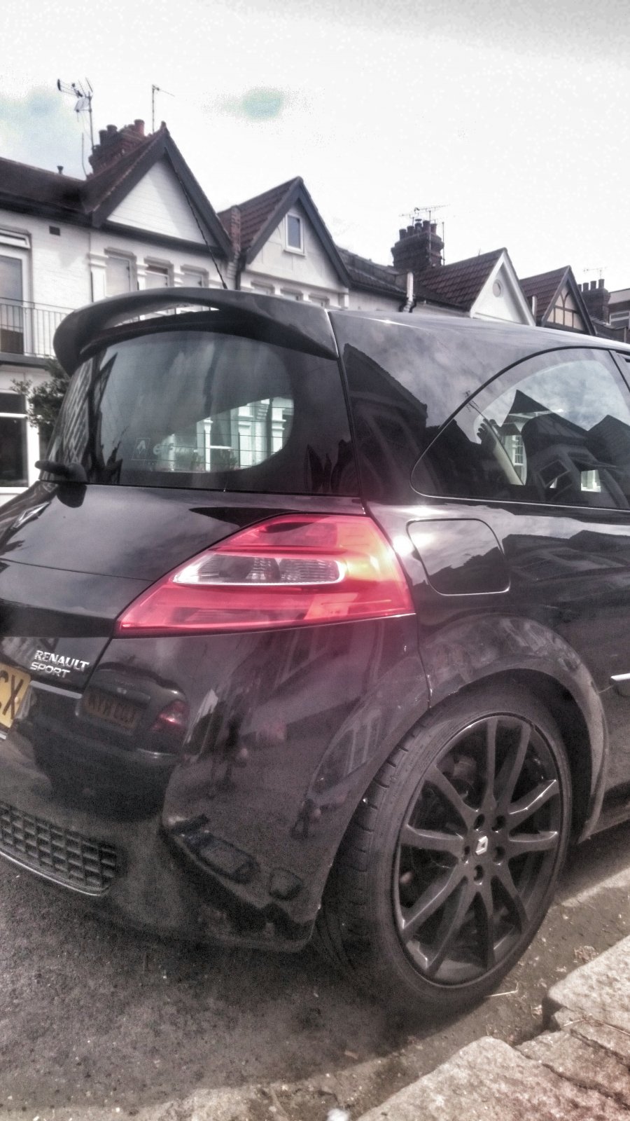

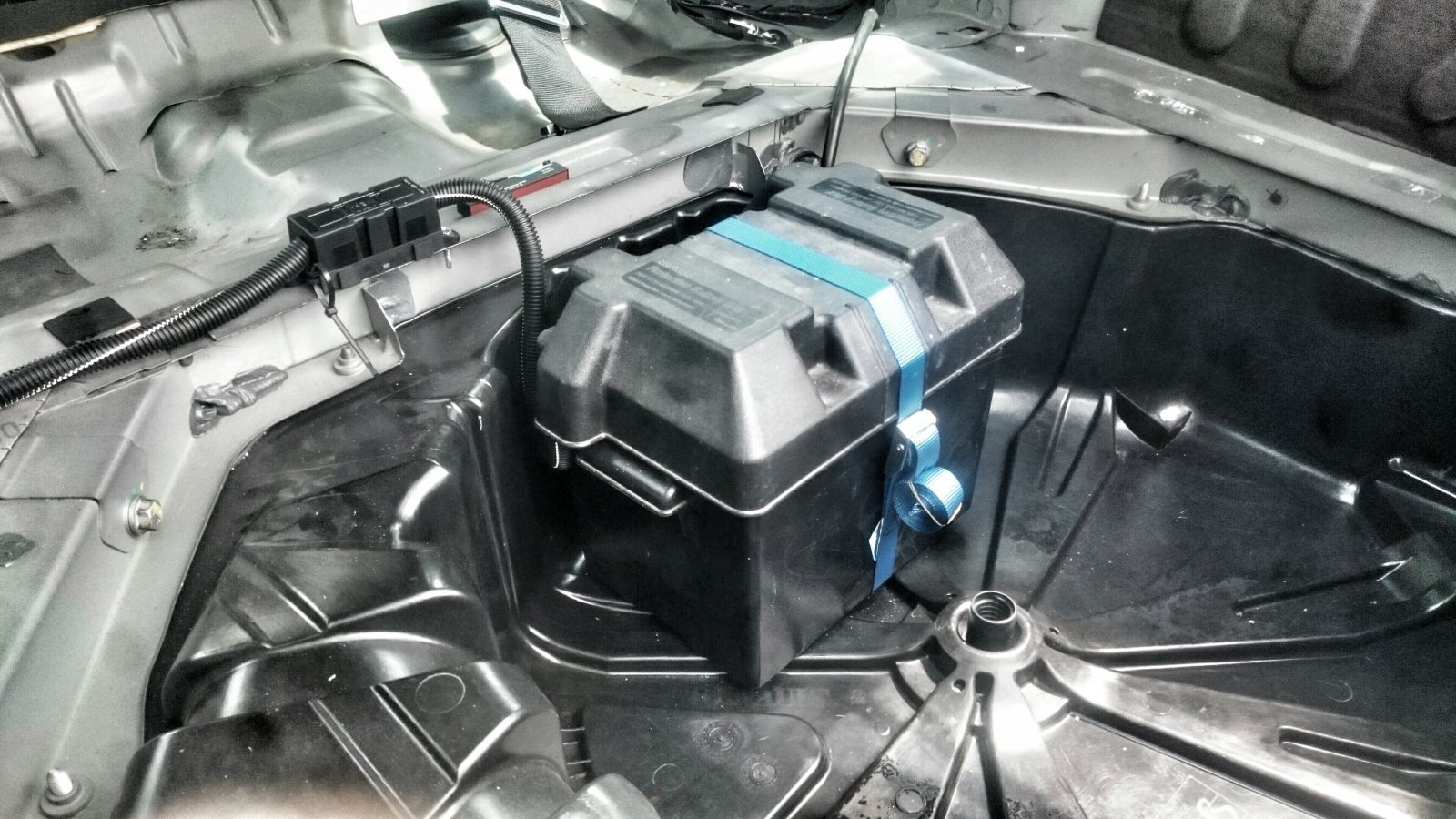

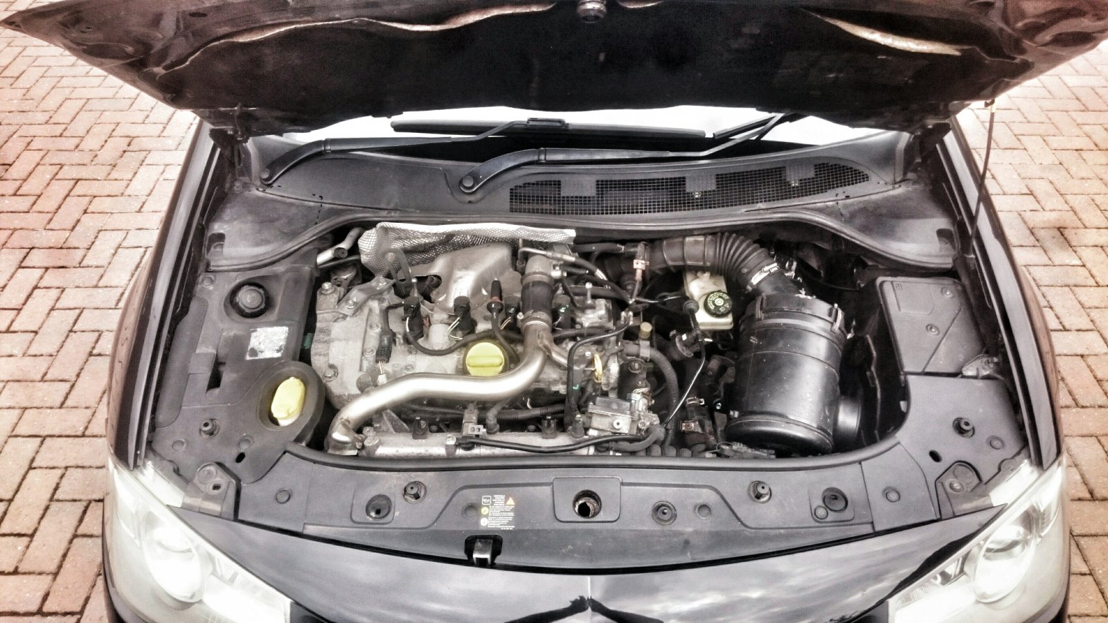

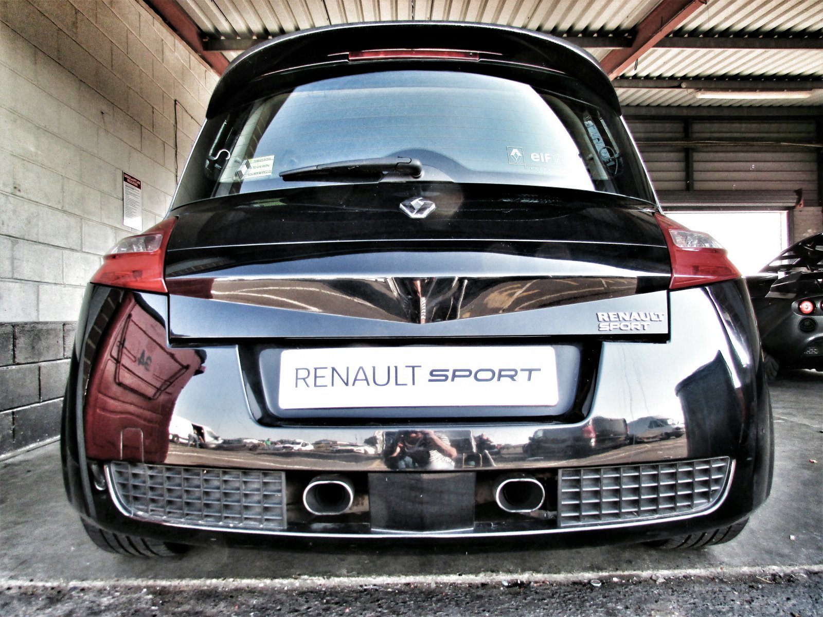

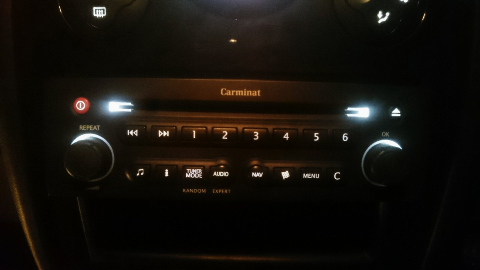

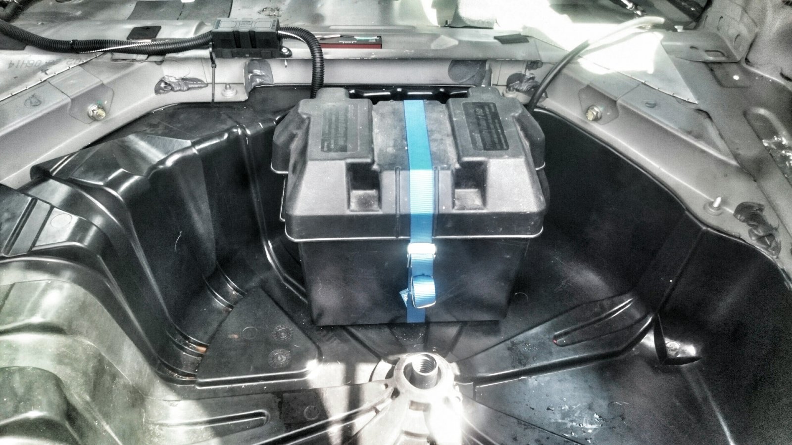

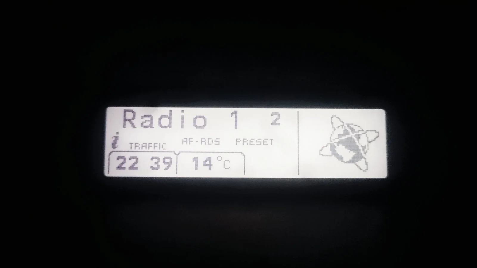

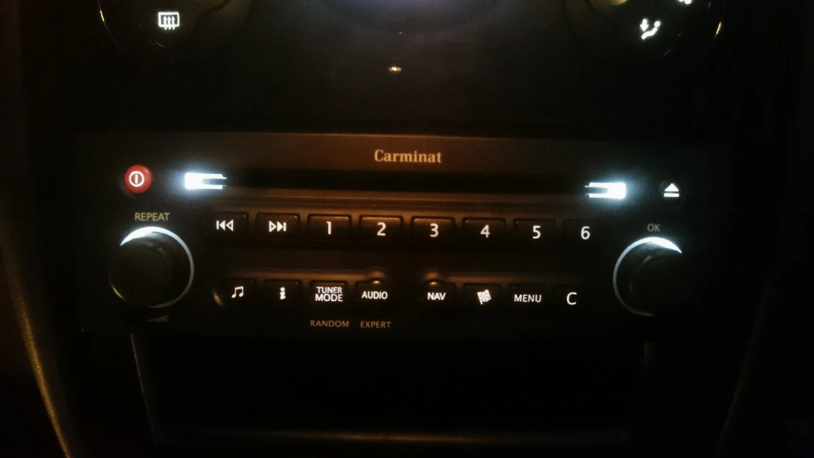

Few bits done, battery relocated to the boot, ditched the restrictive OE airbox and replaced with a R21 Turbo airbox. It has the same base as the Clio V6 box with the 100mm outlet, the difference being the inlet pointing at an angle. Since the install I've bought a phase 1 Clio 172 airbox to utilise the lid so it'll be a straight pipe. Also found out the Megane has built in sat nav so the usual Update List stereo I thought would work.... Doesn't, so I bought the Carminat headunit off Ebay. Bought a carbon R26R spoiler of a friend for 50 quid so I drilled and fixed that.
Ricardos
  LY 200 EDC
Some nice pics there mate!
Also CF R26 spoiler for £50?! Bargain of the year!

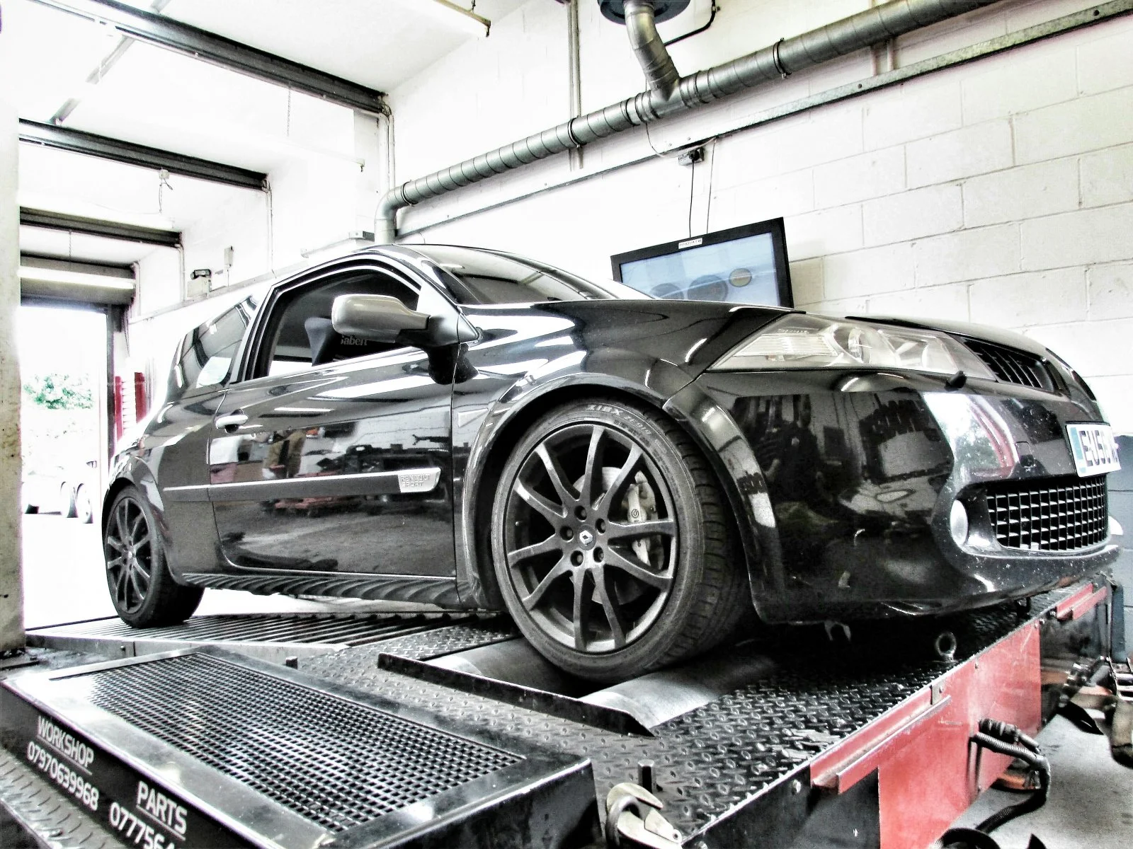

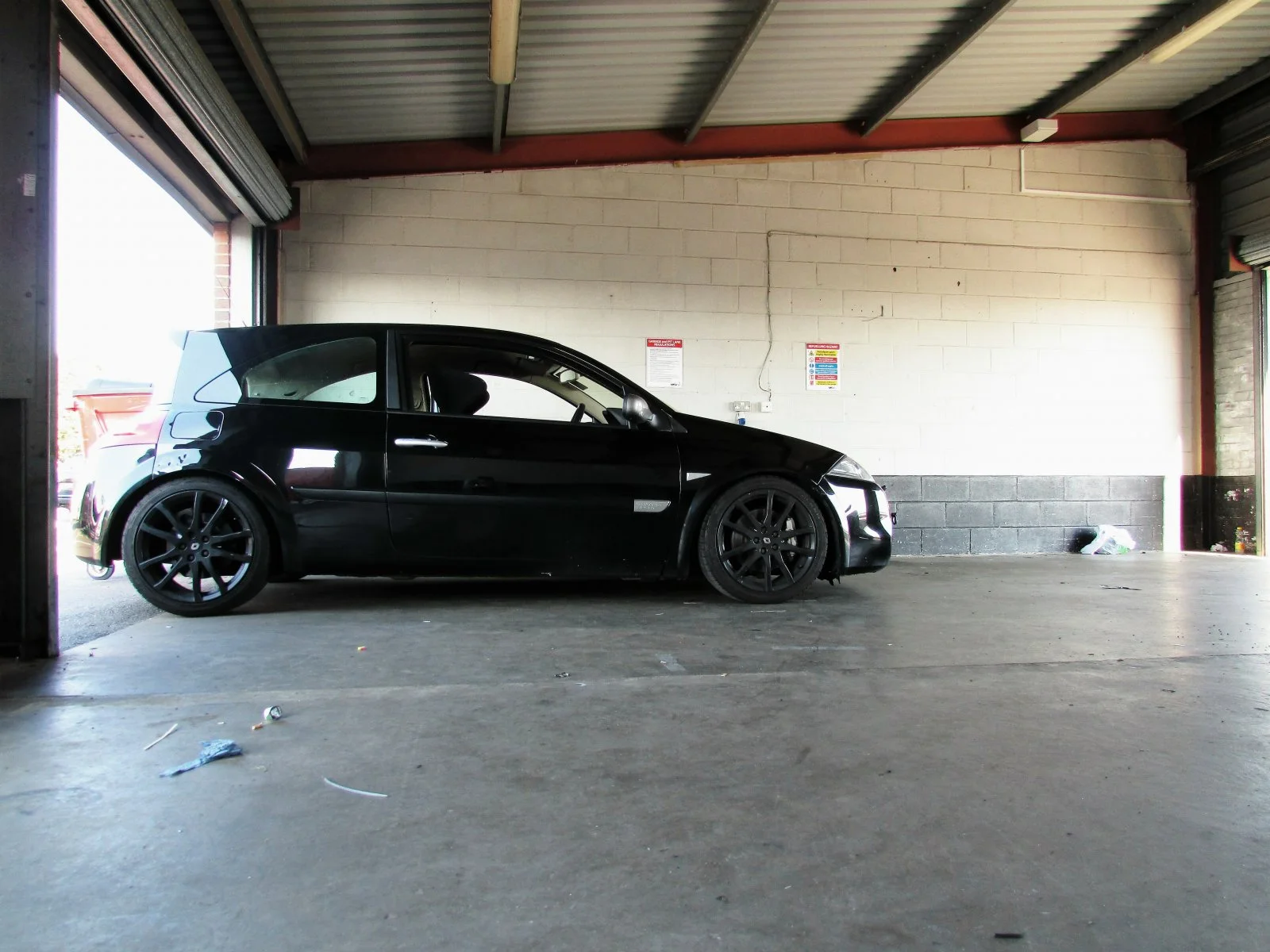

Cheers Mark, was at Snetterton a couple of weeks back and busted out the bridge camera for a few pitlane shots. Attending the Surrey Rolling Road day next Saturday to see what the ol girl is putting out.
Had a right touch with the spoiler, admittedly there's lacquer peel the size of a £2 coin on top but hey its a track car! Having it fitted transformed the look of the car.
