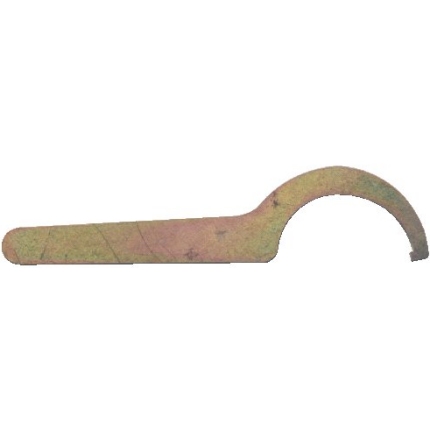

Re adjustment, I would presume you need C Spanners as with most other makes of Coilover.
Thus;
There should be one or two of these and will allow you to rotate the ring at the bottom of the spring;

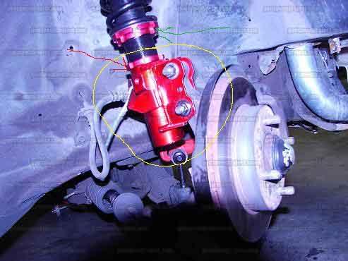

Forget the yellow pointer/circle, copied from Google, its the red adjuster on the spring that goes up and down as you turn it.
Jamie
Edit; just noticed it is pointed using the green arrow.
you should of got 2 'C' spanners?
and as above the 2 adjusting plates that the springs sit on
turn clockwise mate lo lower it mate. undo the botom collar/ring then the top one turning them clockwise. might be a bit stif if theve been on the car long
