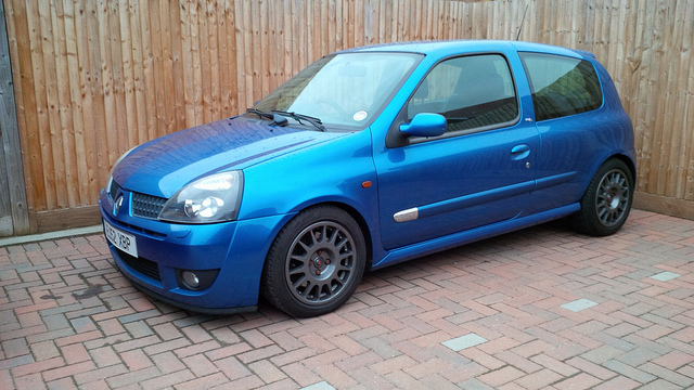

In a perfect world the wishbones need to be sloping down from the subframe to where they locate in the bottom of the hub, as in centreline of the securing bolt to the centreline of the bottom ball joint pivot. You can run them parallel with the ground though. Is your car as low as it is in your avatar or lower?
Nah, avatar is on 16's and Eibachs.
It's now 15's and B14s.
Going to be fitting new wishbones once the weather clears and want to raise the front up, I haven't even looked to see what angle the arms are currently at!
