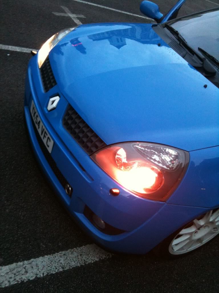

Mine went pink then bye bye :(
Now its turns on pink for a few seconds, flashes then goes off completely.

Is this likely to be the bulb then? Iv been thinking its the starter pack not firing right?

if its the ballast the bulb will be normal colour but will flicker or stay on or off or stop working without warning.if the bulb is changin colour its the bulb nothing else.only know this as ive had a nitemare of a time messing about with mine after buyin a dodgy bulb off here lol and replacing ballasts an all sorts

Pic.

so if i have a pink bulb that goes off i probs need a ballast and a bulb?
put the pink bulb in the other headlight if it is pink but not flickering then you need a ballast and a bulb
