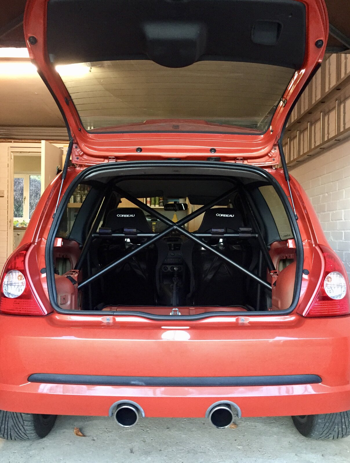

Best place to look at getting a safety device cage for a clip, please?
Search ‘Mark Fish Motorsport’ on Facebook, give him a call as they’re an approved SD supplier 👍
Rear RO17 half cage -
  clio 182
I build roll cages check out my Facebook page Fulcrum Motorsport
All built to racing regulations, front section can be added at a later date if and when required.
