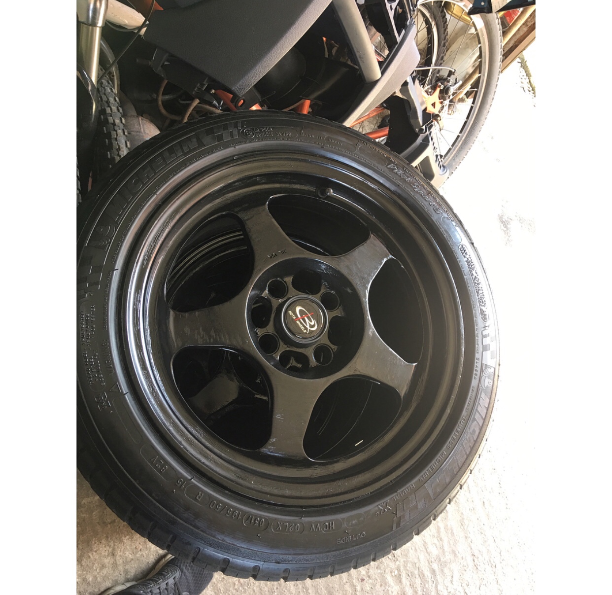

M3dan Car Clio 182 bmw m3 Jul 31, 2018 #1 I have a 172 non cup but just had wheels powder coated and lost the spigot rings anyone know what size spigot rings I need many thanks
BashRacing Jul 31, 2018 #2 They changed the centre bore size of rota’s most are 73.1mm But there was something like a 70mm as well so better off measuring. Clio hubs are 60.1mm
YorkshireKyle Not all gingers stink of piss. But I do. ClioSport Club Member Car 535d & Monaco 172 Jul 31, 2018 #3 My Rota Slipstream 15” are 70.1 CB
