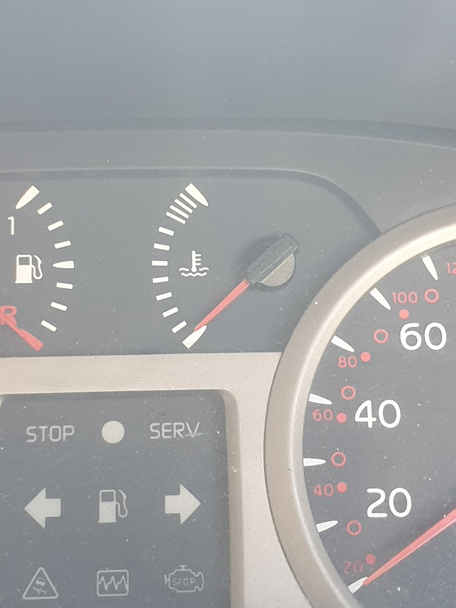

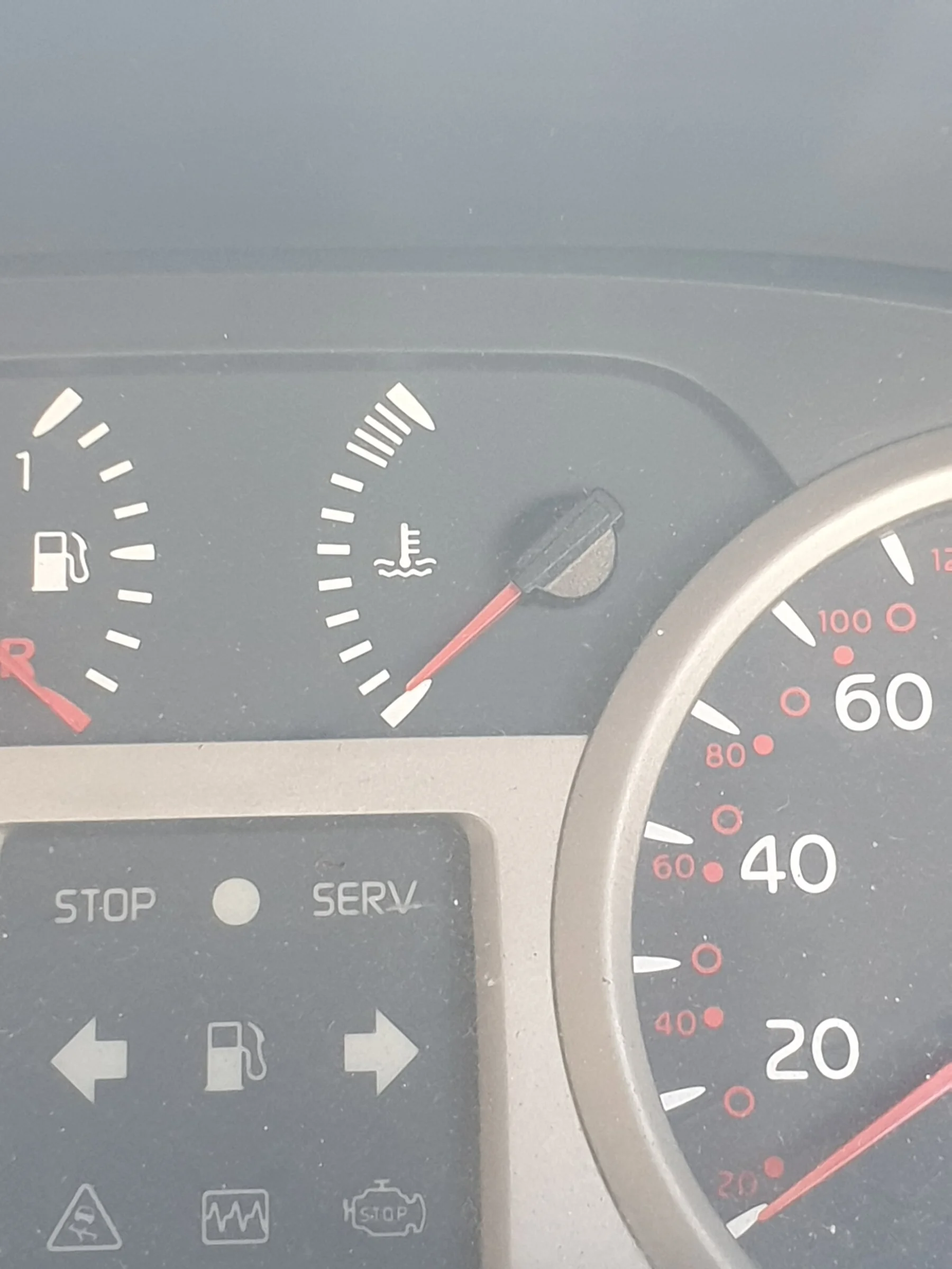

Also noticed my temperature gauge sits above the first notch when stone cold is that normal for these cars (pic attached)
