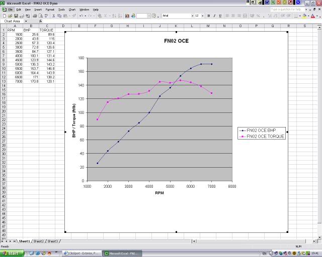

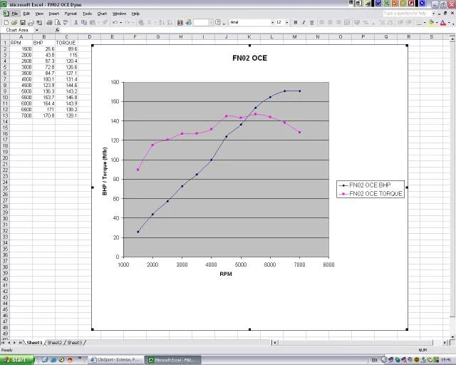

I can post a map of my car before and after my re-map.
Spec before: A stainless Cat back, PiperX panel, Silicone elbow and uprated feed with removal of the acoustic valve.
Spec after: The above plus a Paul Murray re-map.

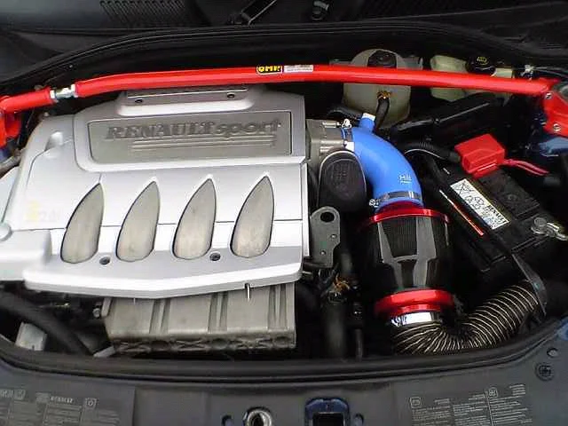

My mods:
Initially had PiperX Viper, K-Tec Sports CAT and stainless exhaust plus superchipped. Think it only made around 170 @ Fly, I'll have to check.

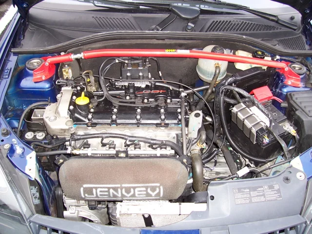

Now has jenvey throttle body set up, Omex 600 ECU, AWT Cams, Larger injectors, 182 Exhaust manifold and the above CAT and exhaust system still. Work was carried out by GDI/AWT, the result 222bhp/178 ft/lbs @ Fly :approve:

I wouldn't really like to disclose prices openly, i'll just say it wasn't cheap. If you want a price you could speak to Andy @ GDI or the guys at Yozzasport.
he had LOTS of work done as well.. Cams TB, OMEX, 182 Exhaust manifold, cam belt kit..... and so on.
