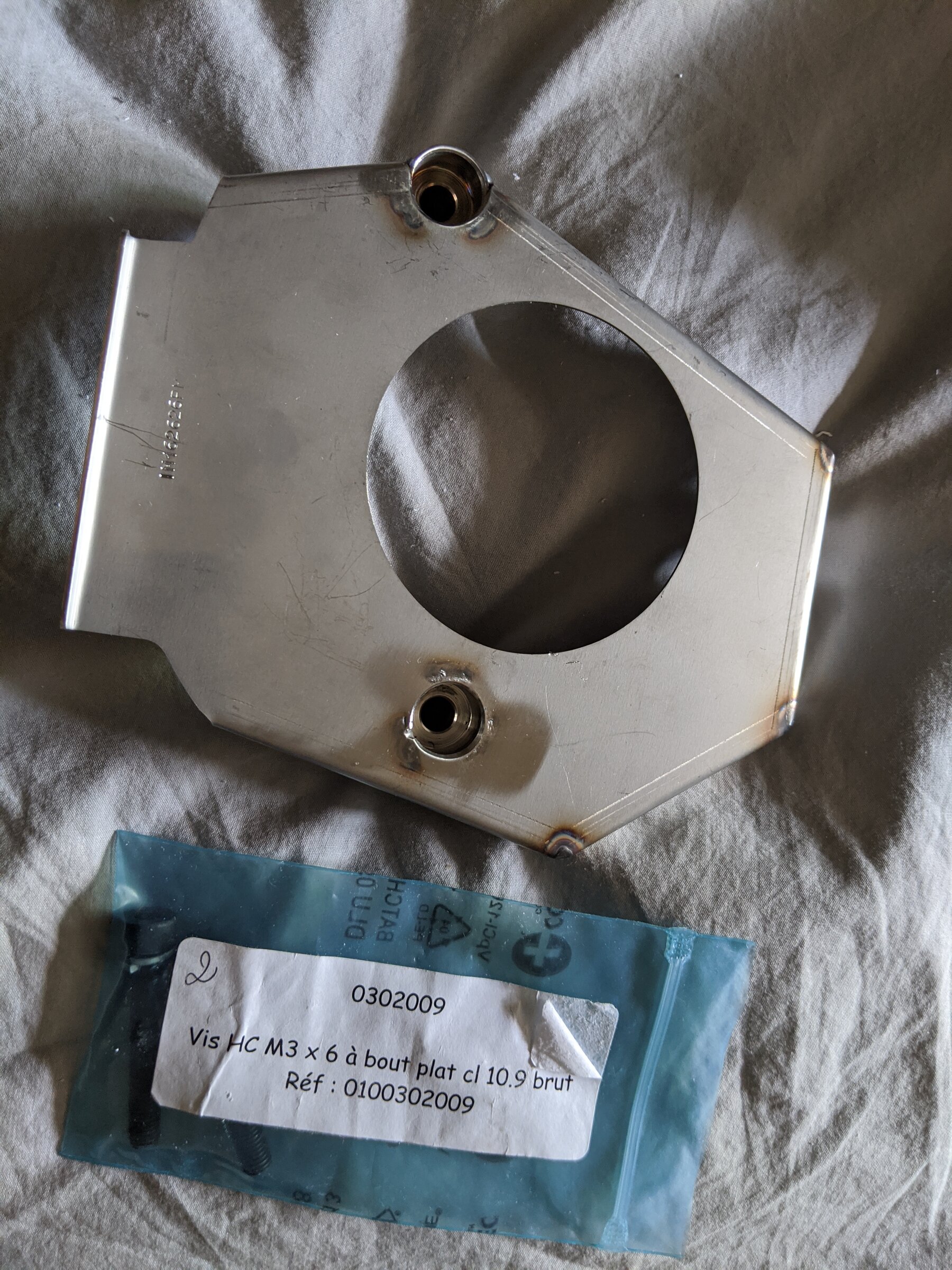

If you're having the belts done, fit one of these to help prevent aux belt failures taking out your cam belt.
For the sake of £105.
JamesBryan
Where's that from?
R-Sport
They supply all the Cup Racer stuff.
These were used on the MK3 Clio racers but they fit the 172/182 as well.
77 11 051 262 £ 1.46 plus vat each
77 03 055 031 £ 1.95 plus vat each
77 11 162 626 £ 70.65 plus vat each
Shipping would be £ 10.00 plus vat.
