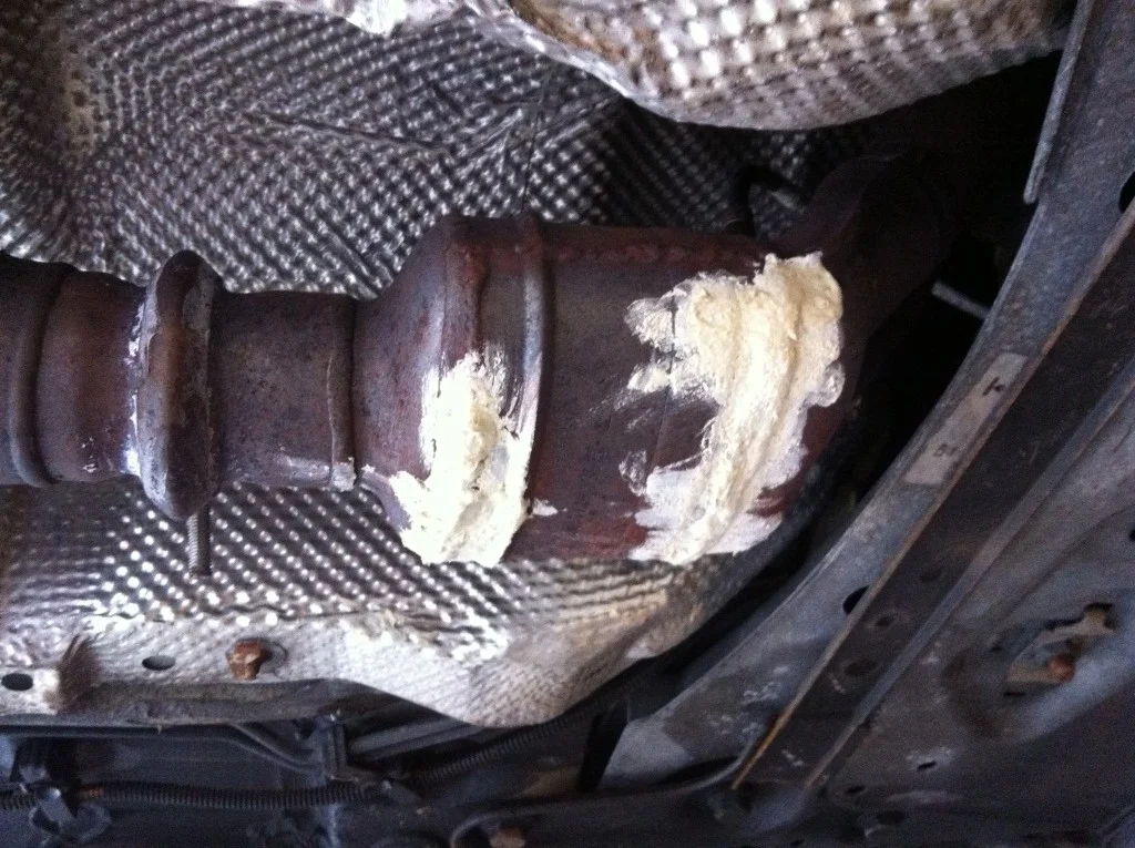

I recently took my car to a local garage is at sounded like the exhaust was blowing. The previous owner had told me the first silencer had been removed (which seemed to be fairly normal for this car). When the car was on the ramps I was horrified to see how it had been done. Looks like he's used some tin snips to open up the first silencer, scraped out the guts then welded it back up (poorly). Its now leaking like a sieve. Is this the normal way of removing a silencer???
I have been informed that the manifold goes straight in to the first silencer so in order to replace it, I need to replace/modify the entire manifold. Other than K-tech's silencer by-pass pipe (which I have already inquired about) does anyone know of an aftermarket manifold without a built in silencer? Trying to avoid lots of welding if possible.
Photo below of what I've done to bodge the holes! Cheers

From my experience all 200's I've driven sound like the exhaust is blowing on a cold start lol. But that is a terrible job, looks like they've just put a load of pug in it.
  Clio RS200 Cup
The pic is just a bodge to stop it from blowing, I stupidly didnt take a picture of the work underneath but the previous owner has cut a square out the bottom, removed the inners then welded it back up. His welding is just full of holes so I could really do with a new silencer.
Biggest issue, first silencer is part of the manifold so to replace with a pipe I need to remove the manifold, cut the current silencer off, then weld a pipe in (Which seems risky) or buy a whole new manifold from renault (costly!)
Just wondering if there is an aftermarket manifold which doesn't come with that silencer? I don't really want it anyway :)

Pre-cat/silencer, I've heard it called both lol. Unfortunately, the way its been removed has ruined it and now it needs replacing as its blowing in a lot of places!
