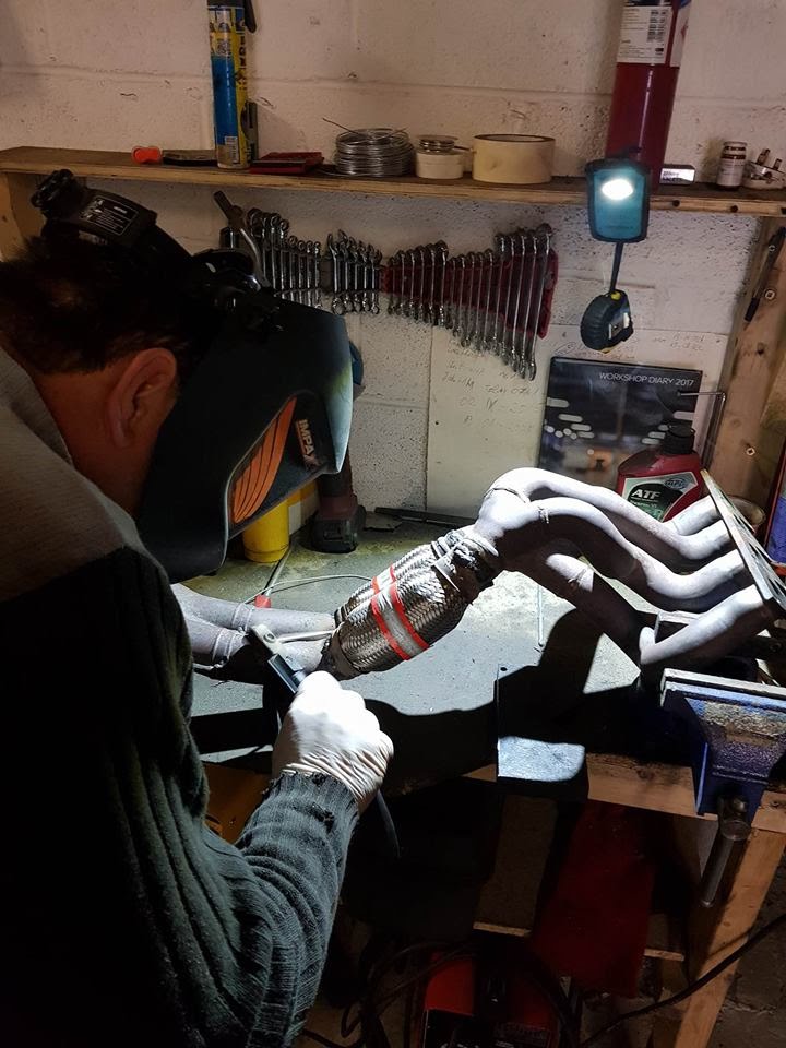

Car had two new flexi's attached to the manifold yesterday, the garage basically cut the old broken ones off and 'welded' new ones on, looked like a very good job on inspection.

Not sure on your coil problem (seems pretty unrelated unless they have done something to the wiring getting the headers out) but welding it with a sick welder is classic!

I can't see too clearly since the pic's not the greatest, but I can see clearly enough to see that those welds look worse than the ones I do 50 metres under water. And they're pretty bad!
