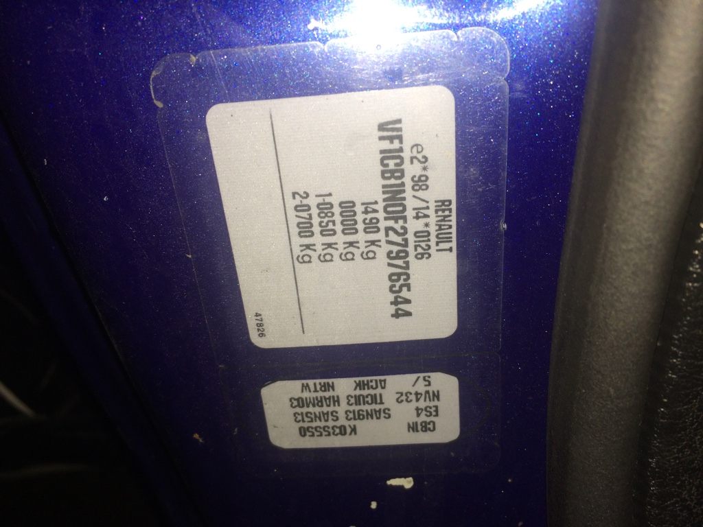

When I did mine years ago the map number had to match the cars vin number, otherwise you'd ruin your ecu, not sure if it's the same these days, what's the code number of your map?
  Stealth 438'd 182
8200_7804 i think is the number on the .rst file i have?
and Clio 182 EL 1890 8200_7804_Decat_Overrun_RON98_0411.cal

The map doesn't match the vin? It has to be the right version for the for your ecu that is all as I understand it. The rs tuner module gets locked to your vin, the ecu firmware number is usually upgraded and then a map /callibration that corresponds/matches to that
