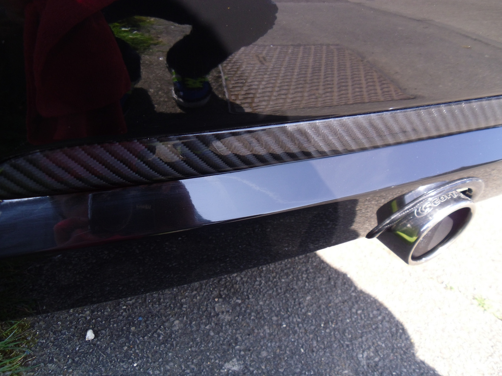

Fitted my rs192 today and it's sitting slightly back in the bumper like it's too short! I will try and get pics up later. Anyone know where I may have gone wrong?

Okay, it's just that it doesn't come out the bumper at all an I thought that surely it's says scorpion on top of the tips so you can see it?

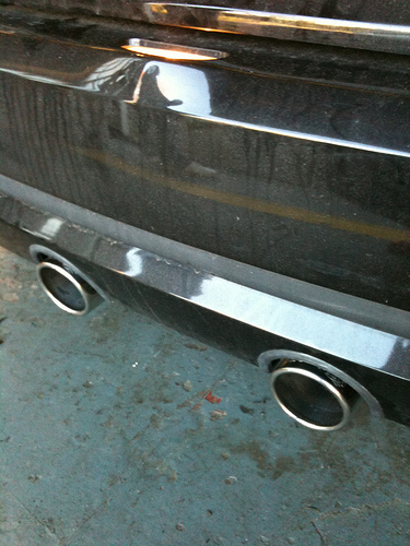

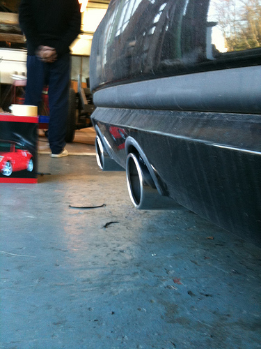

mine sat like that originally but since then ive pushed mine further out by tapping the rear of each back box with a soft mallet while the rear clamp was slightly loose.
before:
RS192 by Dr-Jekyll, on Flickr
after:
ive had a custom decat to fit so cant comment on the extra lenth of that but all pics above was taken with standard cat in.

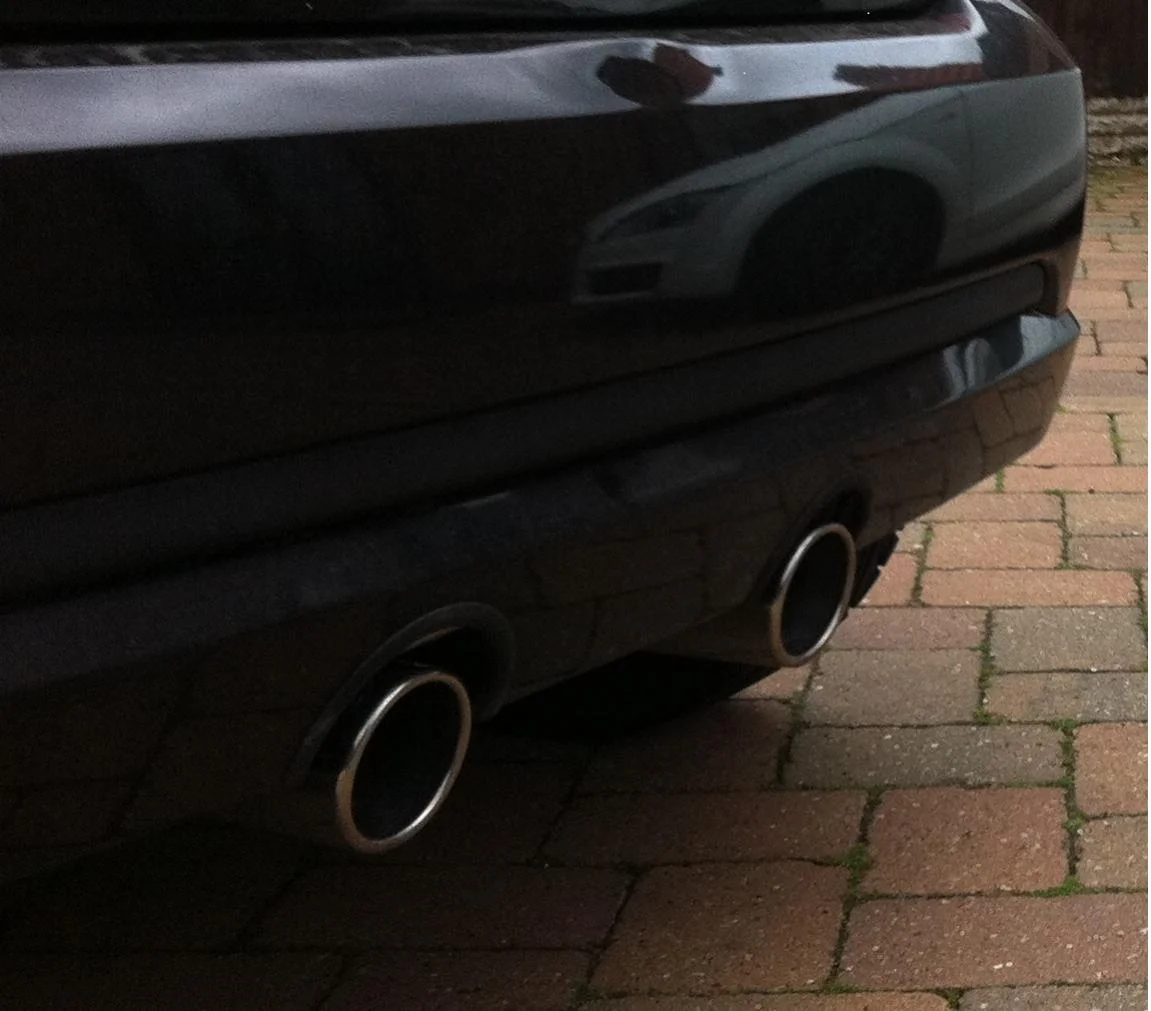

well i had a new set of mounts from renault but still had a slight sagging problem so i just took mine off and covered the mounts back and front in the tiger seal and let it set overnight. one dry and hard i put them back on removing any washers above the mound bolts for it to sit neat and straight.
i dont have before pics but i have a pic of my mount as it currently stands if you want? there was a thread on this a while back
  Clio 182 Black Gold
oh right i see. Ive got old and really saggy mounts so im thinking before i fill it with sealant, i will have to pull the rubber into the top corner because thats where the steel tube ive used to bodge it is pushing the rubber to. Ye pics would be good :) im gonna look for this thread
  Clio 182 Black Gold
Very good idea :) Even if i seal mine in that possition my exhaust would sag tho! mine is pulled right to the top right corner lol. Thanks for the pic!
