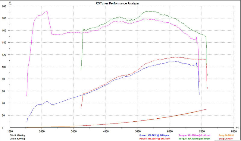

3rd gear, from about 2k rpm, then floor it and keep your foot in until the limiter.
Here are my results from an average of 3 runs, with before and after the map shown on the graph.
Spec is:
ph1 172
matched inlets
simota carbon aeroform
longlife cat-back
running the Group N map.
