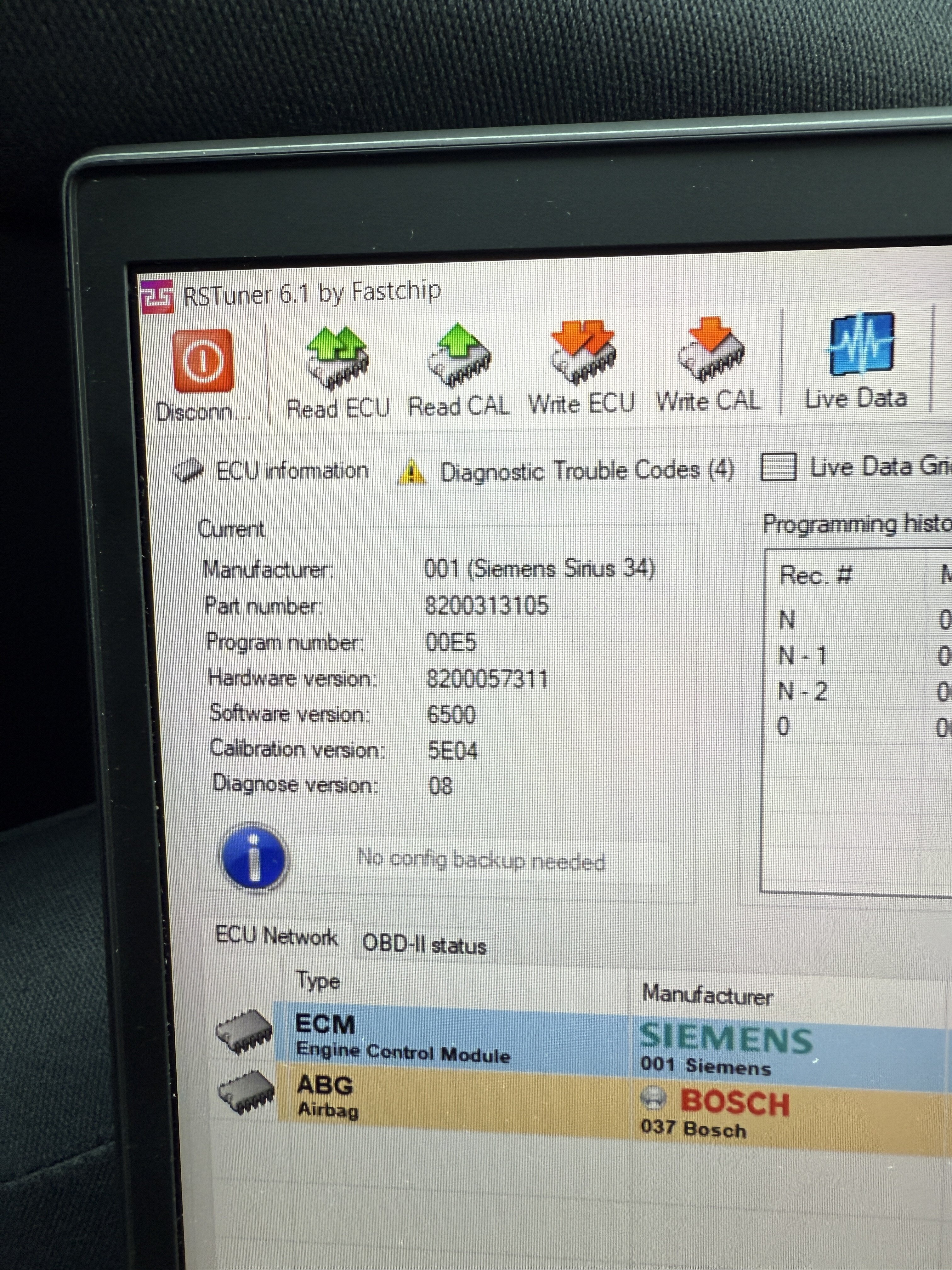

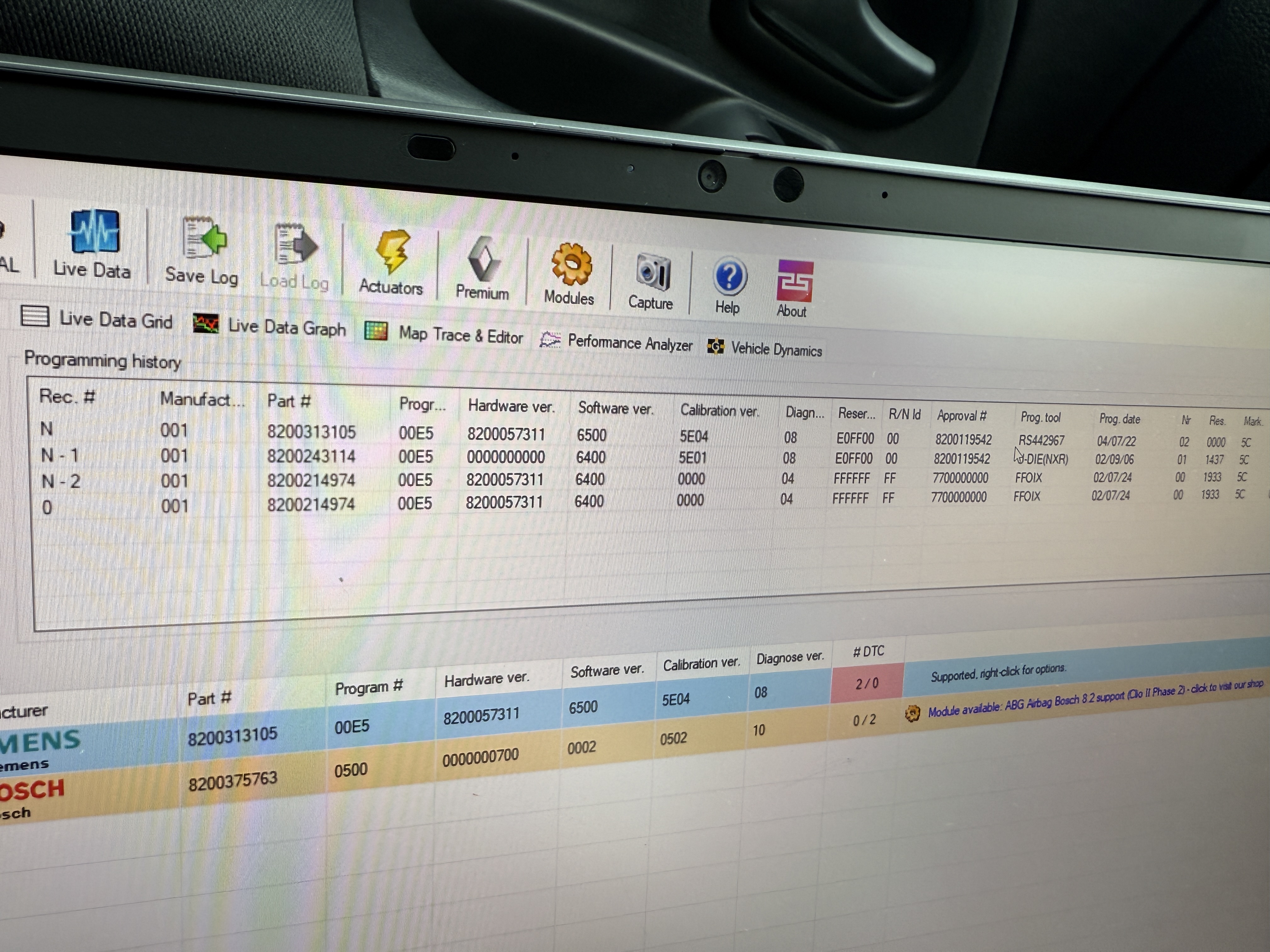

Recentlly got an RSTuner and below is my programming history. Few things are a little confusing:
1. On left band side it states current map is 6500 (software) 5E04 (calibration), yet this has a programming date of 4/7/22, there are later maps 6400 (software) 0000 (calibration) from 2024 when I had my ecu read before elsewhere.
Confused as to how the current map is shown as being from 2022 not the later 2024 map on the programming history?
2. Is a 6500 map the correct one for a 172 Cup (my car) or should it be 6400 or doesn’t it matter?
3. What do the Rec # codes mean N, N-1, N-2 and 0 and also the other column headings?
4. The oldest map in the list is from 2006 but my car is a 2002- shouldn’t the original map be showing here?

Sorted now. The dates of programming are read backwards! Eg 4/7/22 is actually 22nd April 2004 program date not 4th July 2022.
All sorted and 98map successfully loaded on.
Great bit of kit and the map is great!
