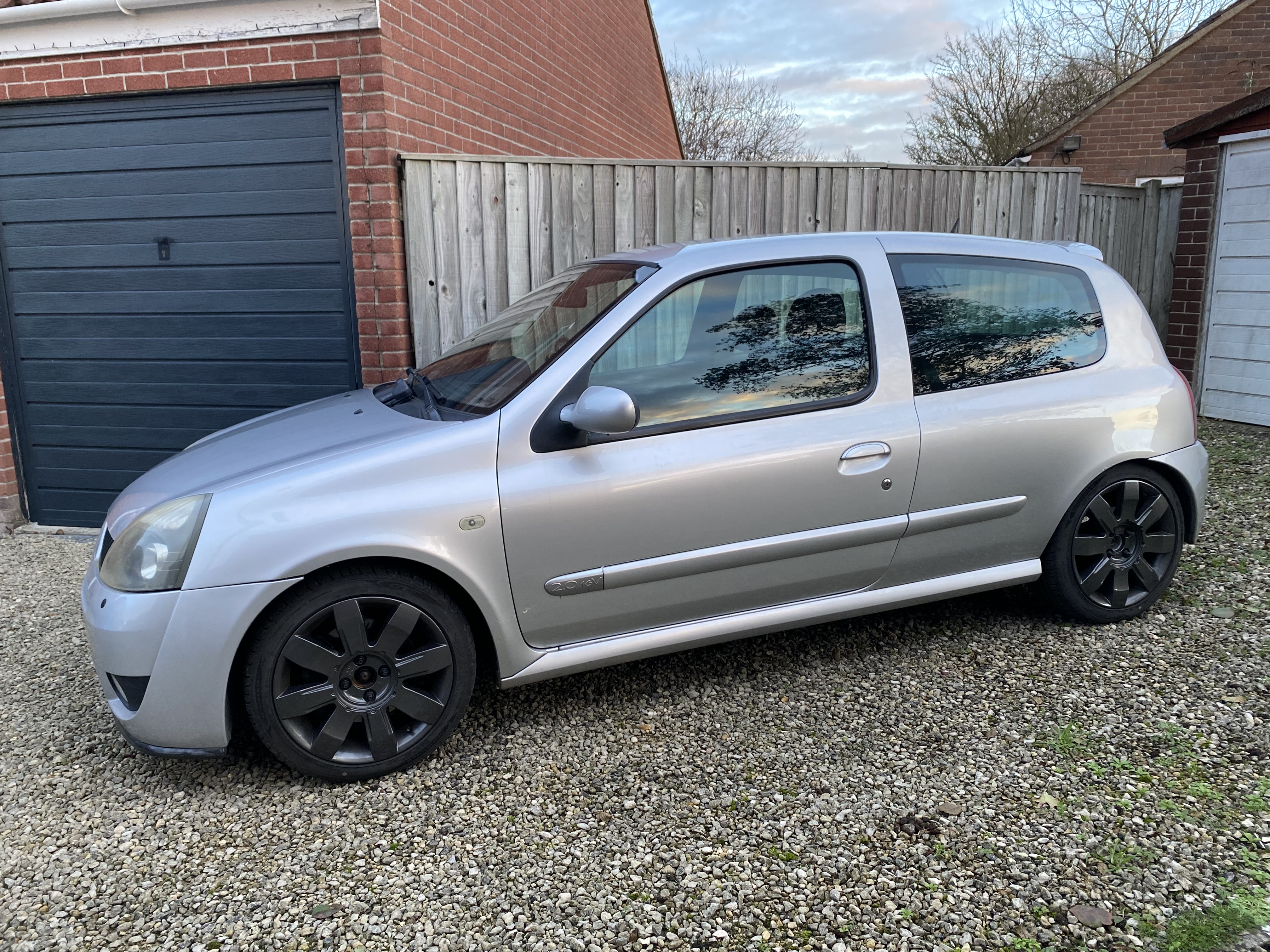

So she's been sat on the drive for a week now and unfortunately its been parked up and untouched what was until today where I managed to peel myself away for family life for a few hours to get this old girl looking a little better.

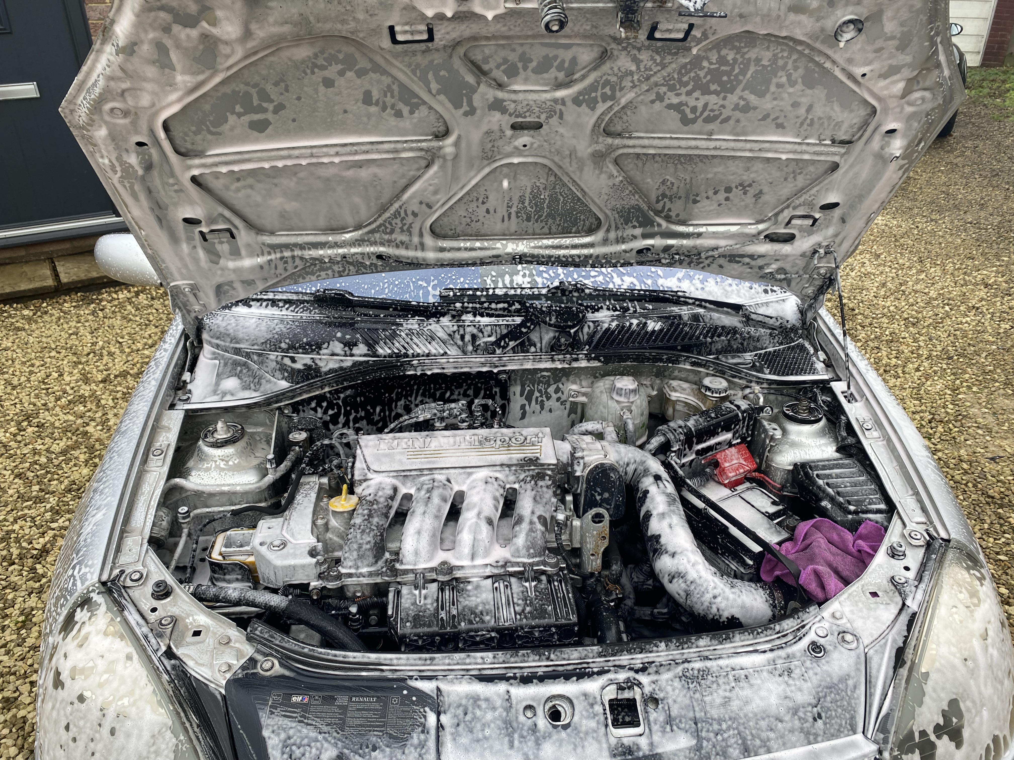

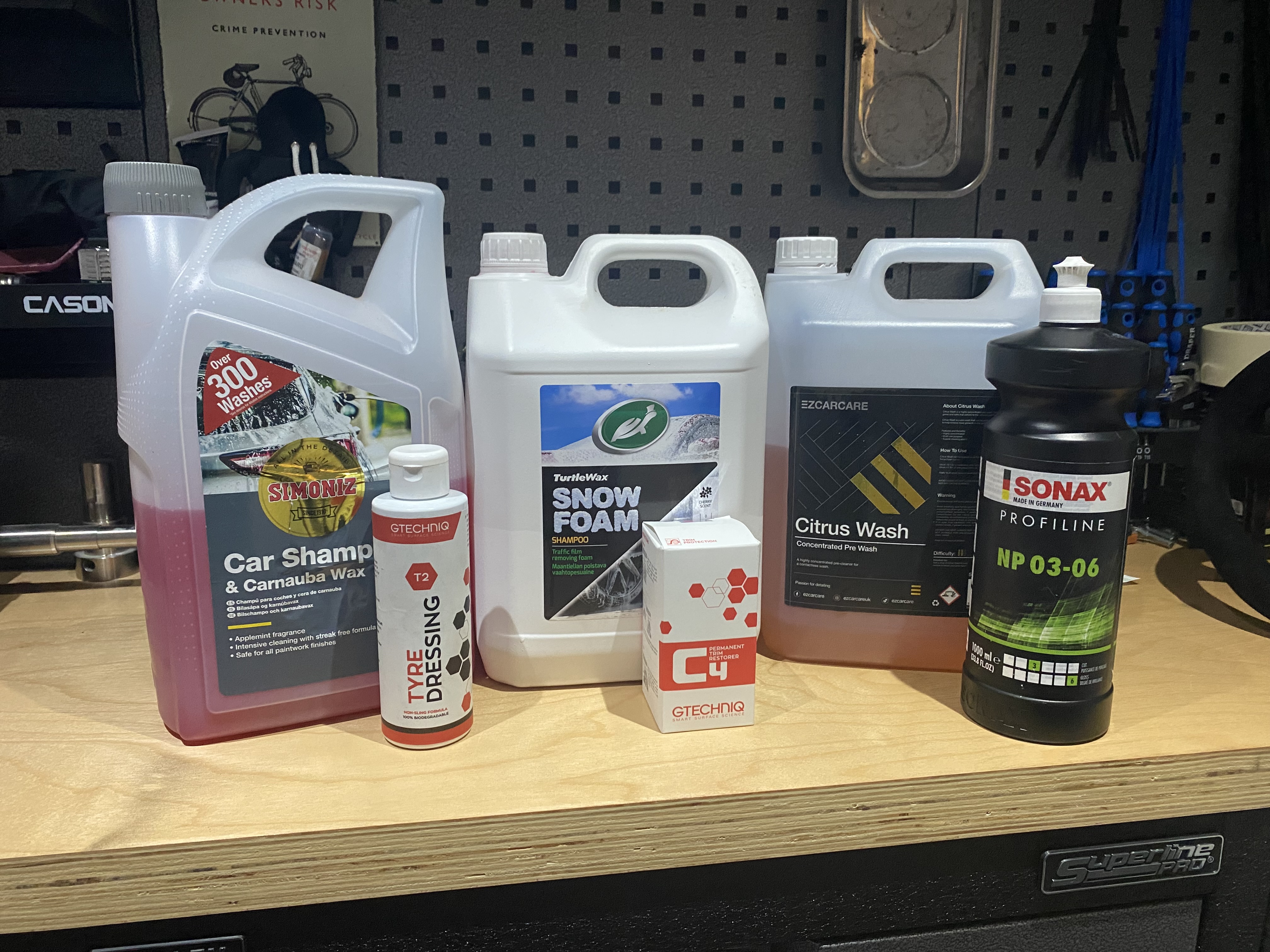

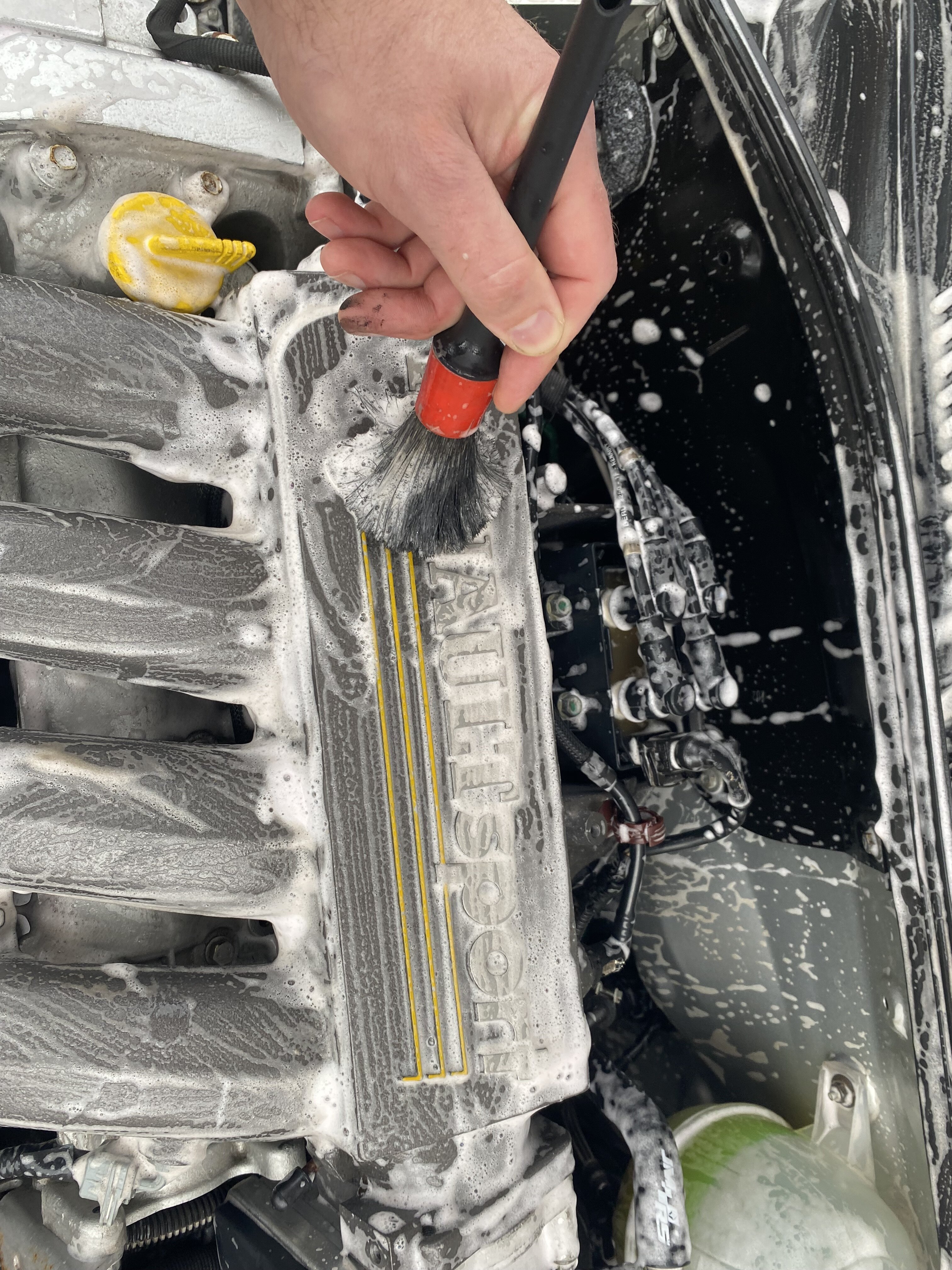

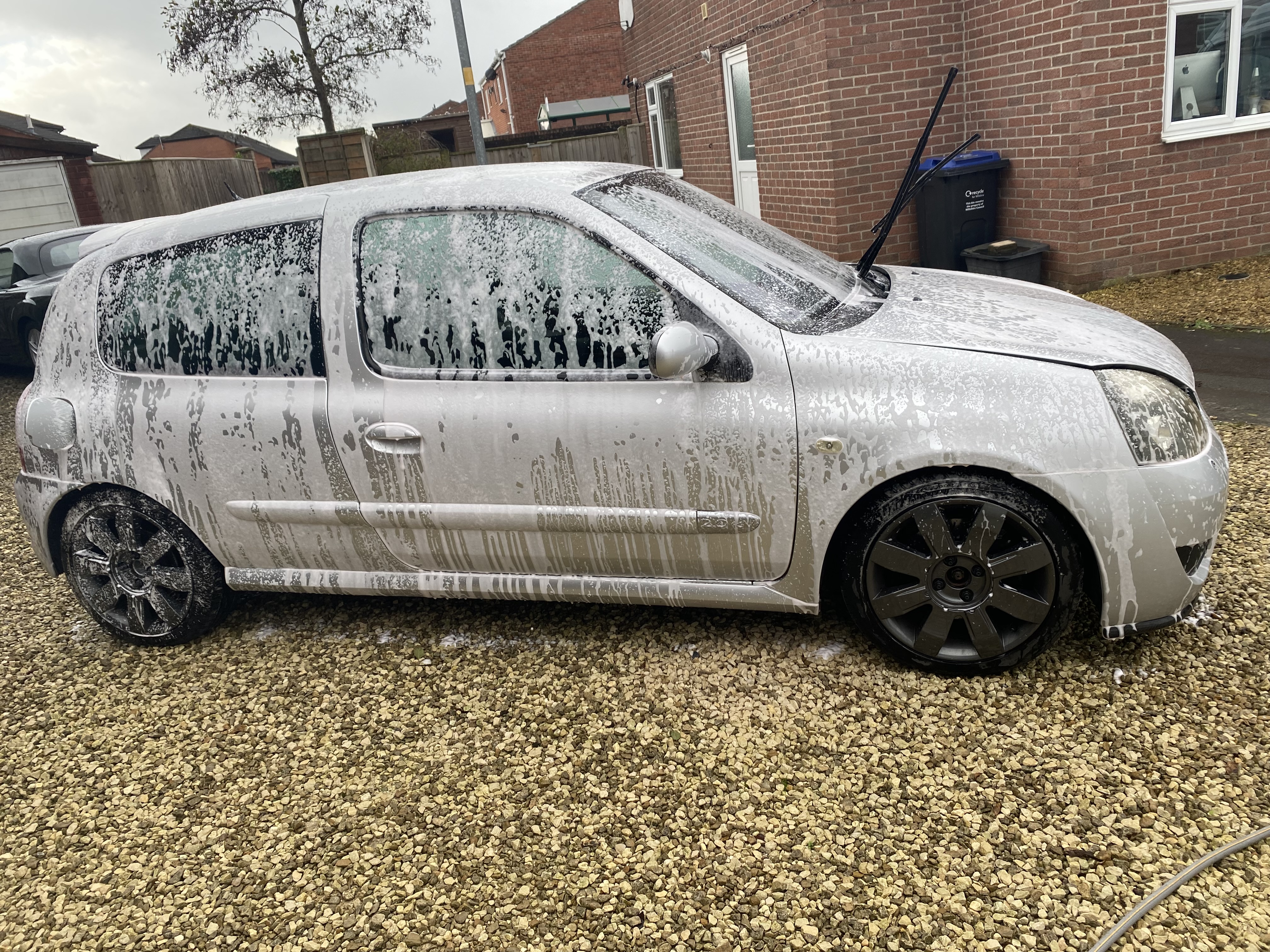

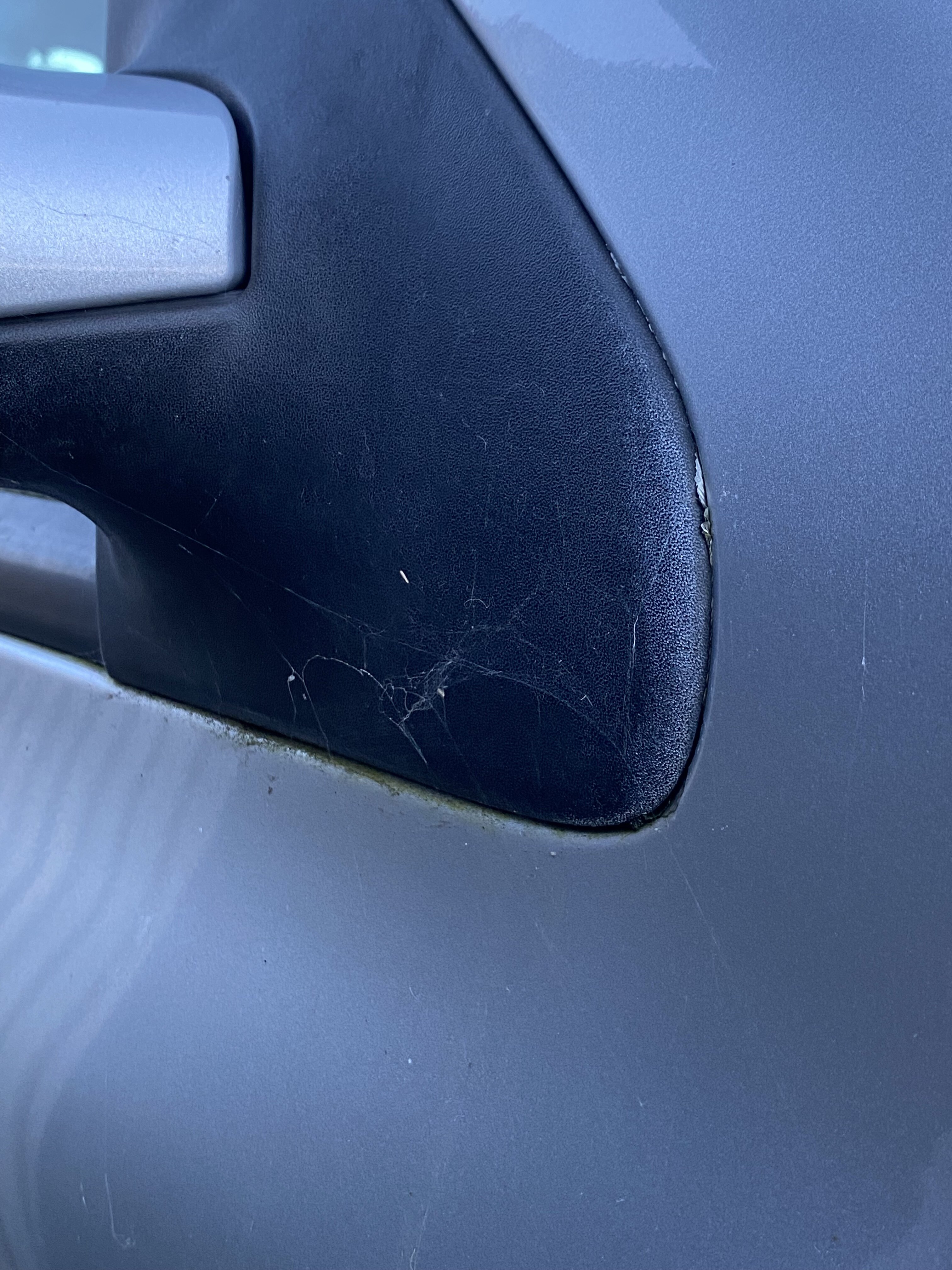

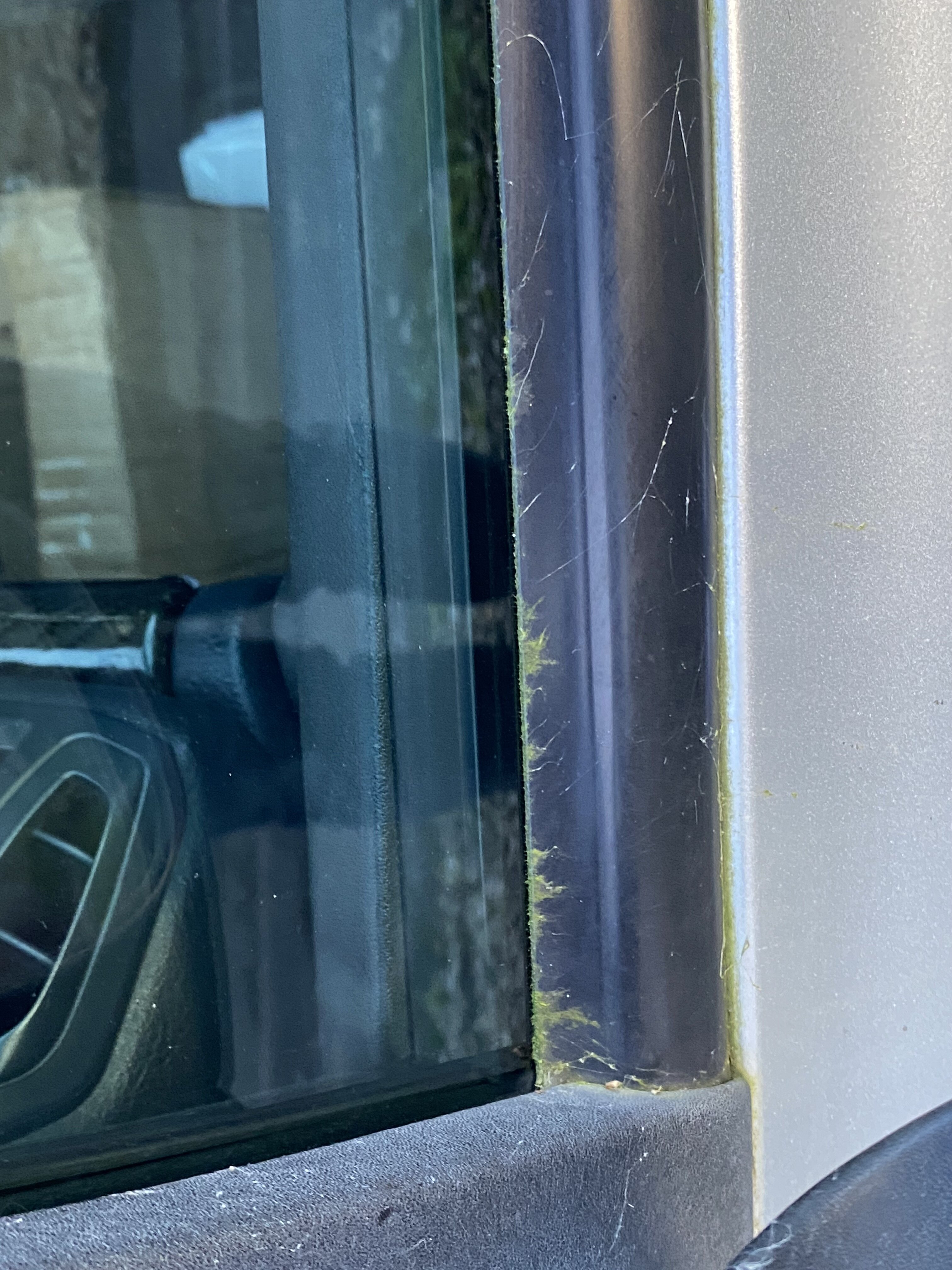

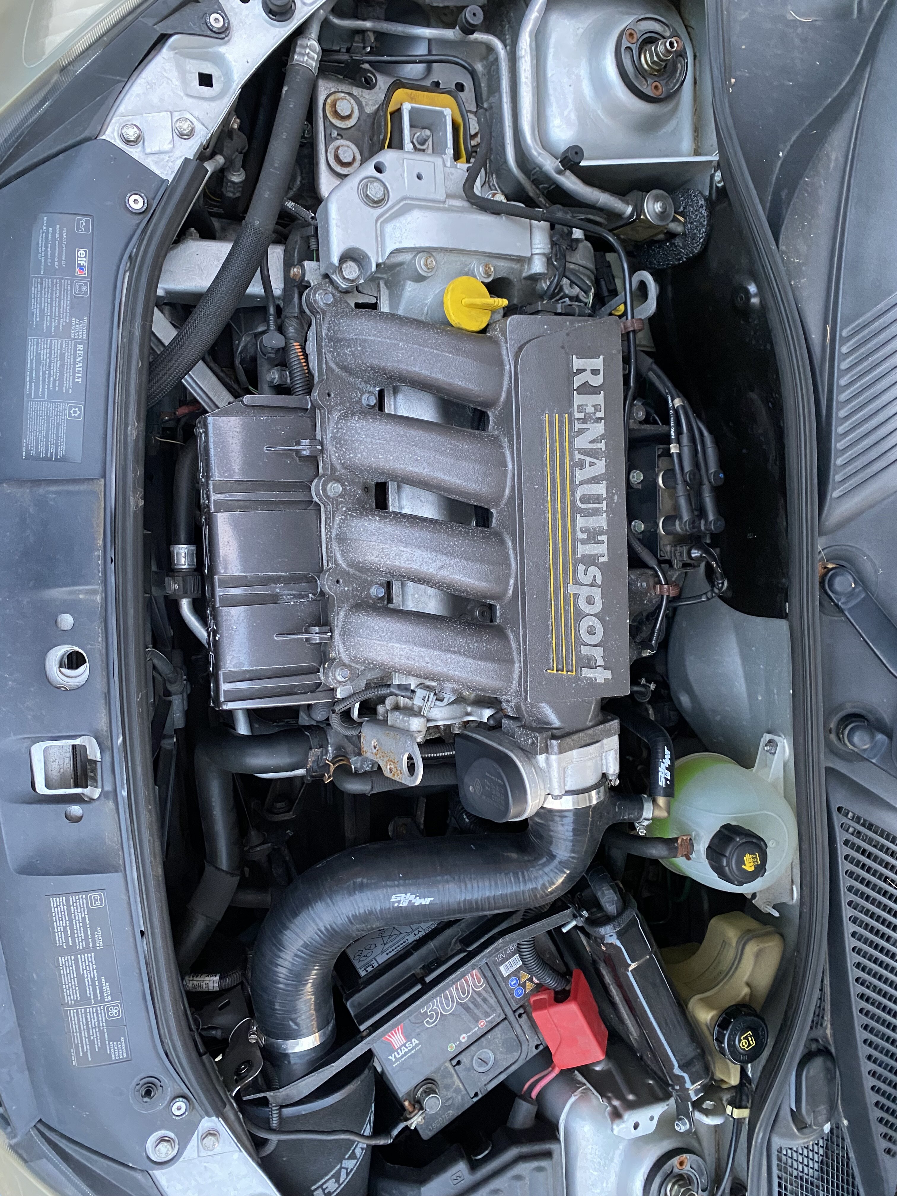

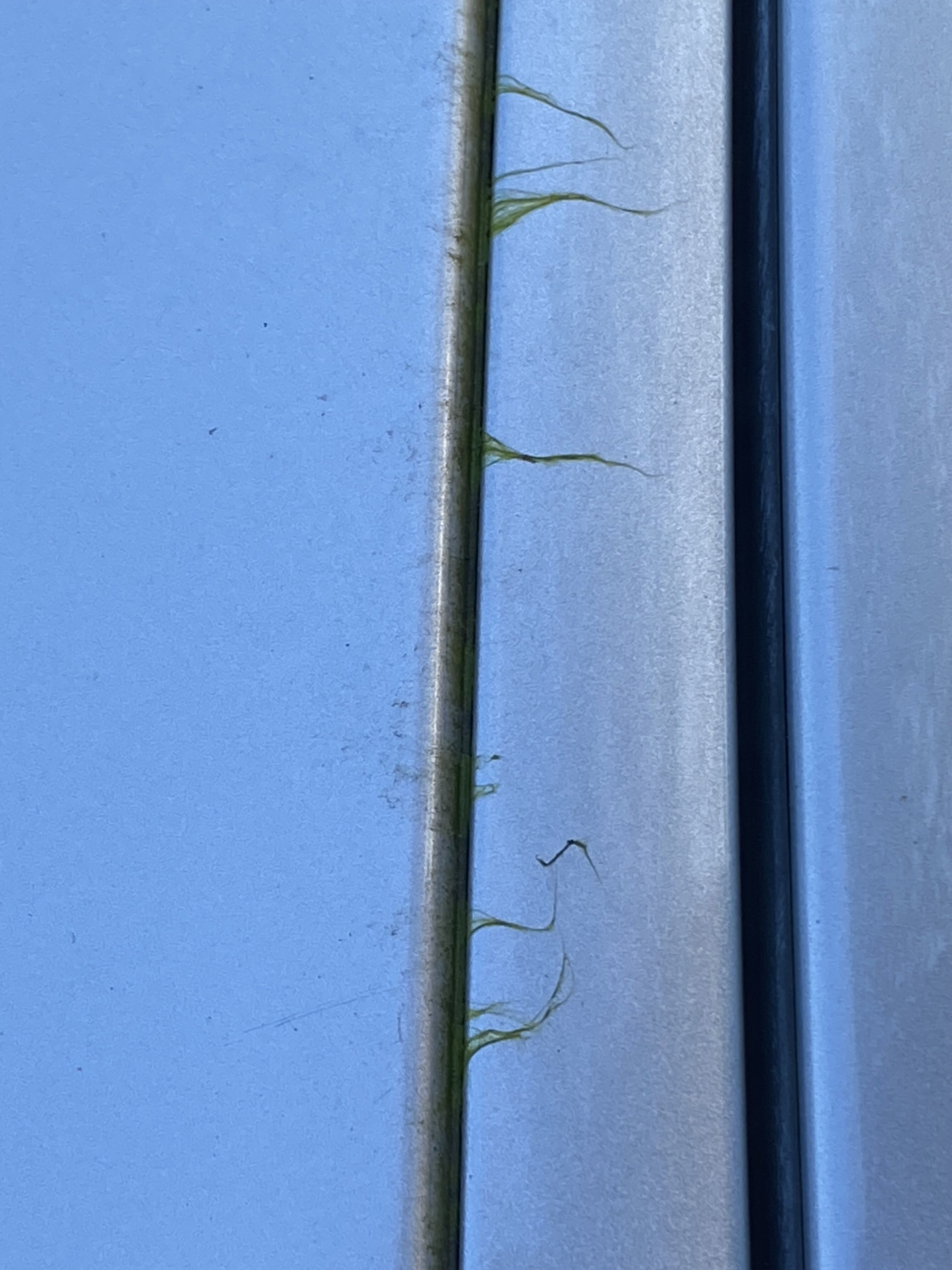

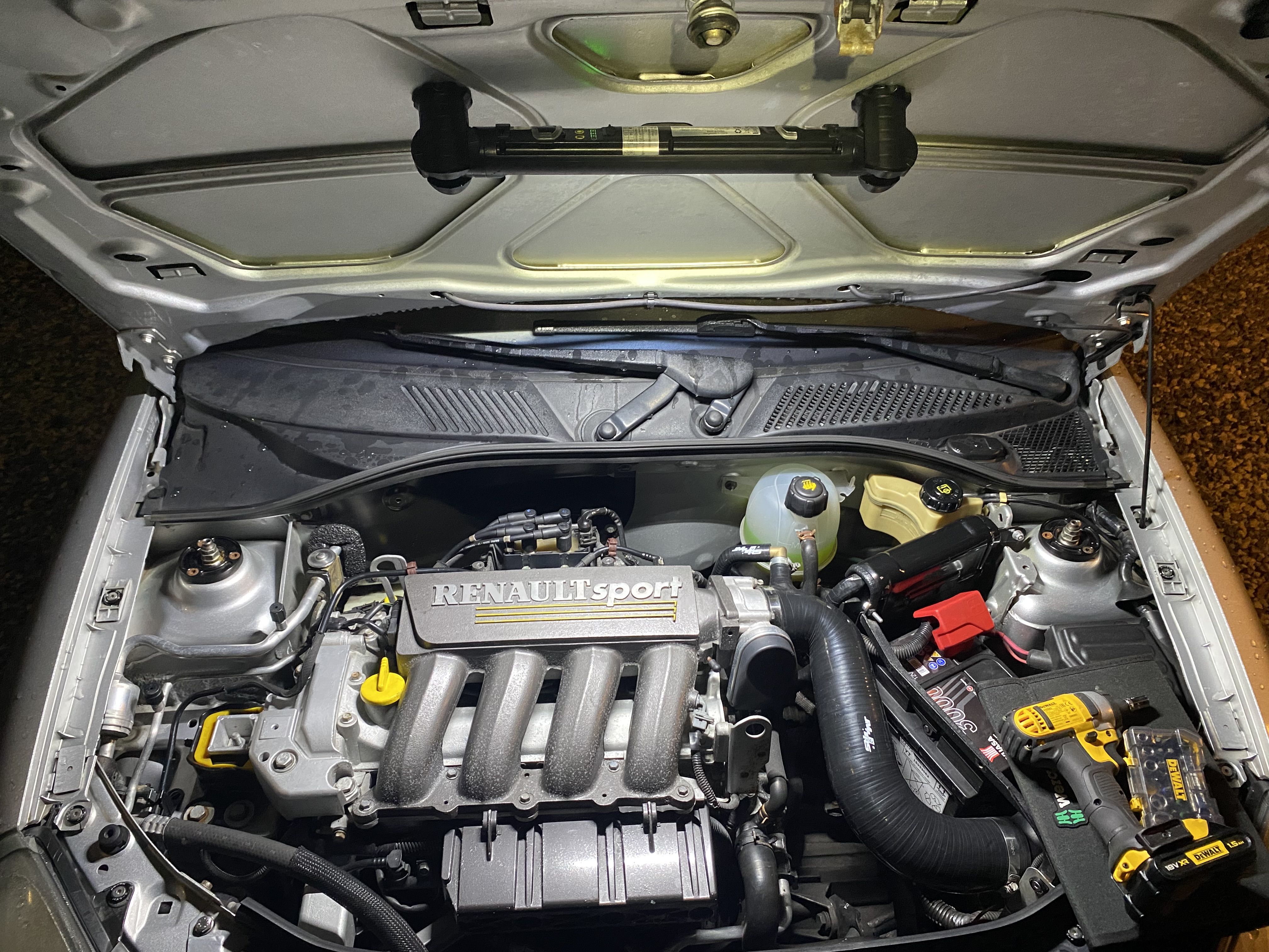

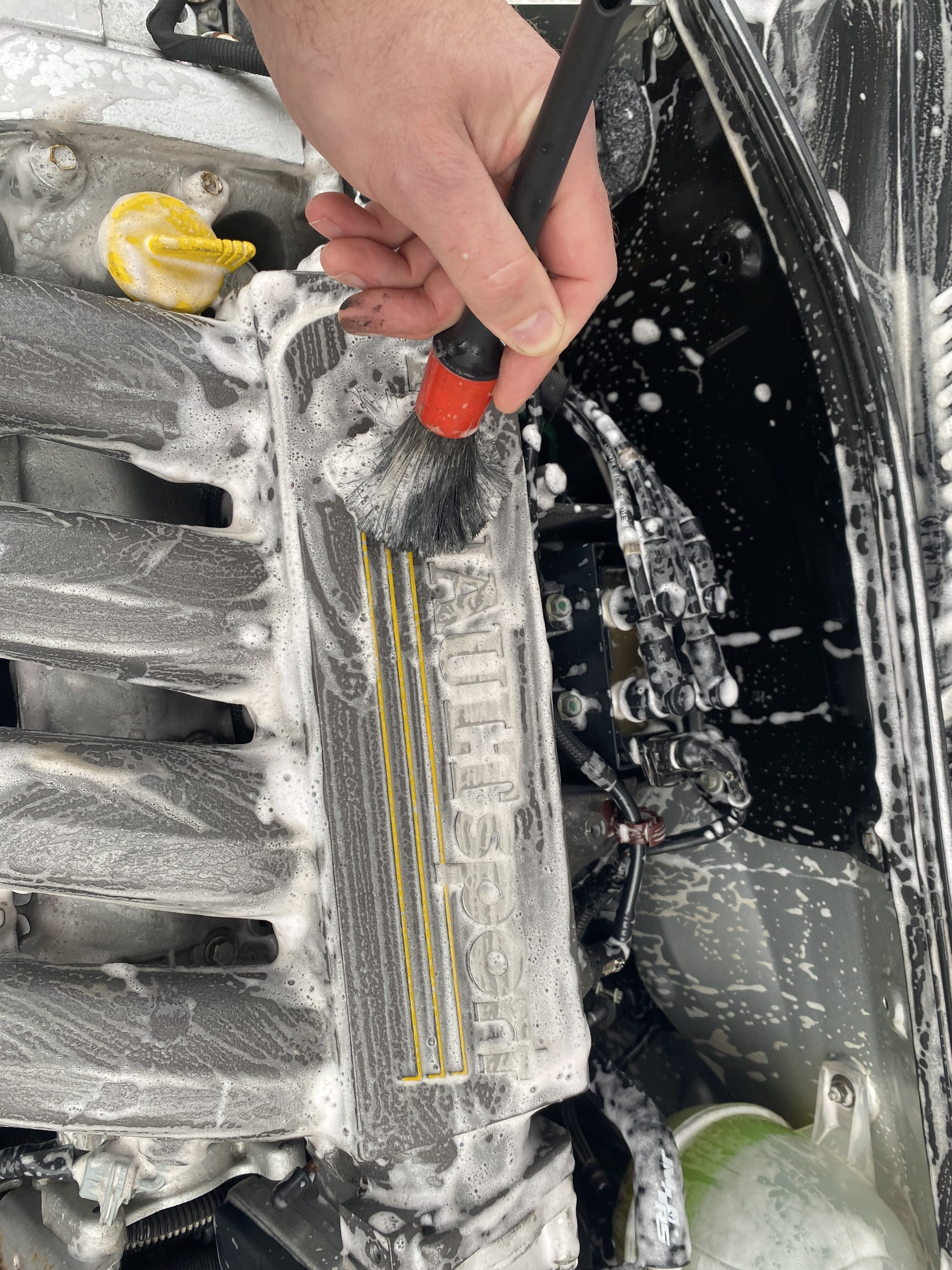

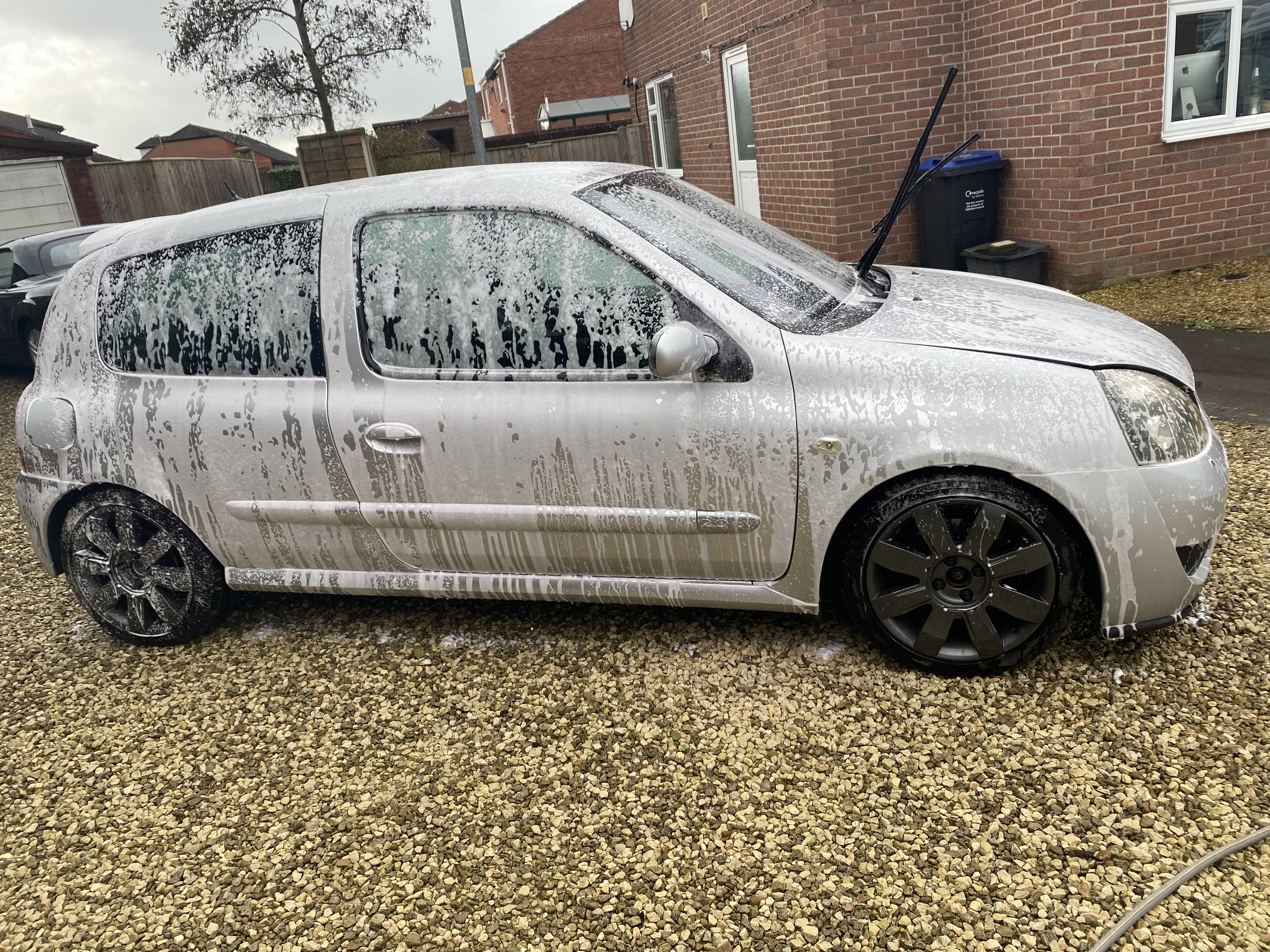

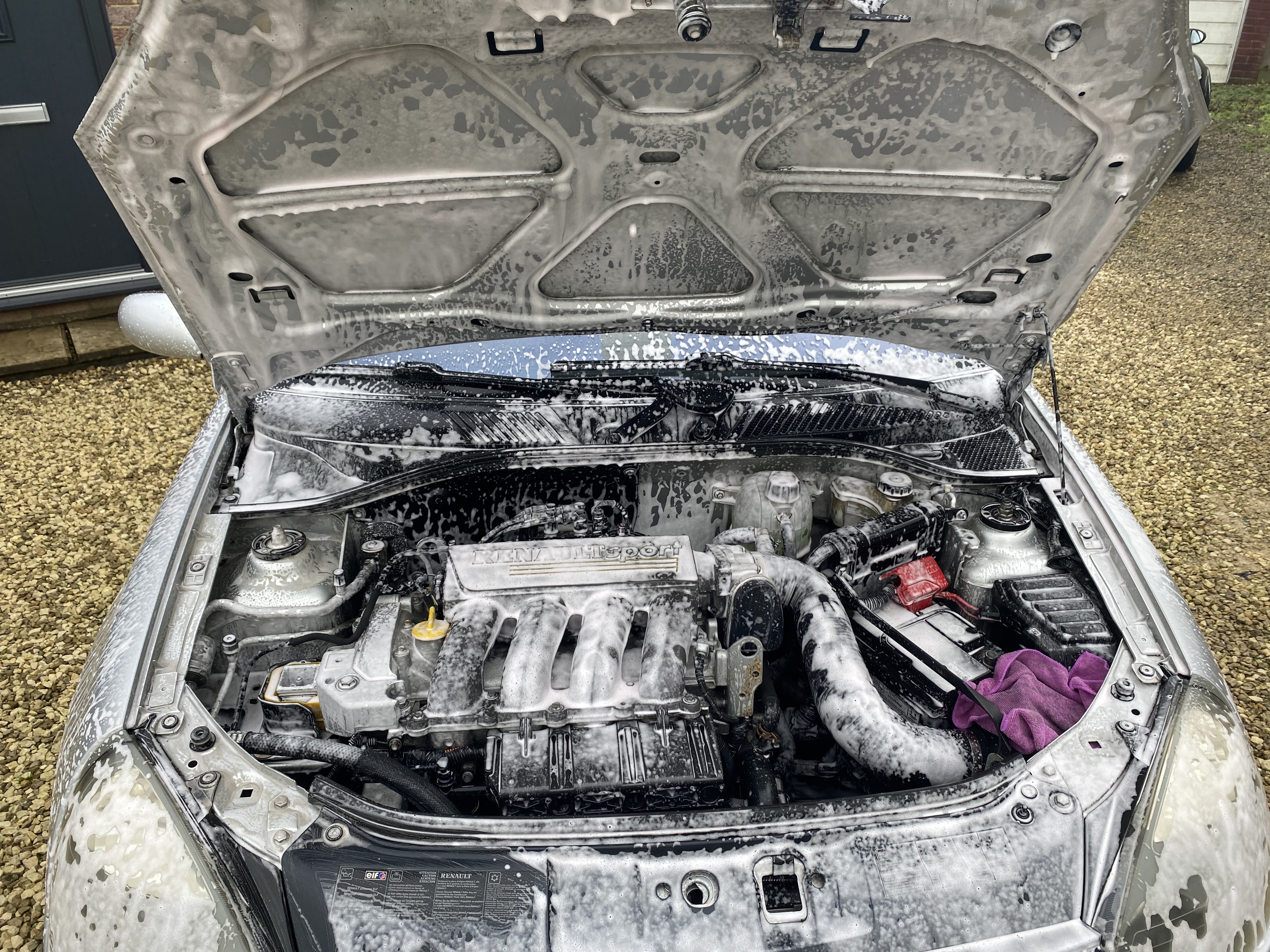

First up - A jolly good bath! The car has been stood up outside for a while and it showed so - Pre-wash, Snowfoam, Shampoo, High gloss wax rinse got the car looking so much better straight away. I vow now not to get it get this bad ever again in my ownership. I must admit I do find cleaning and detailing rather therapeutic.
Outside
Under Bonnet

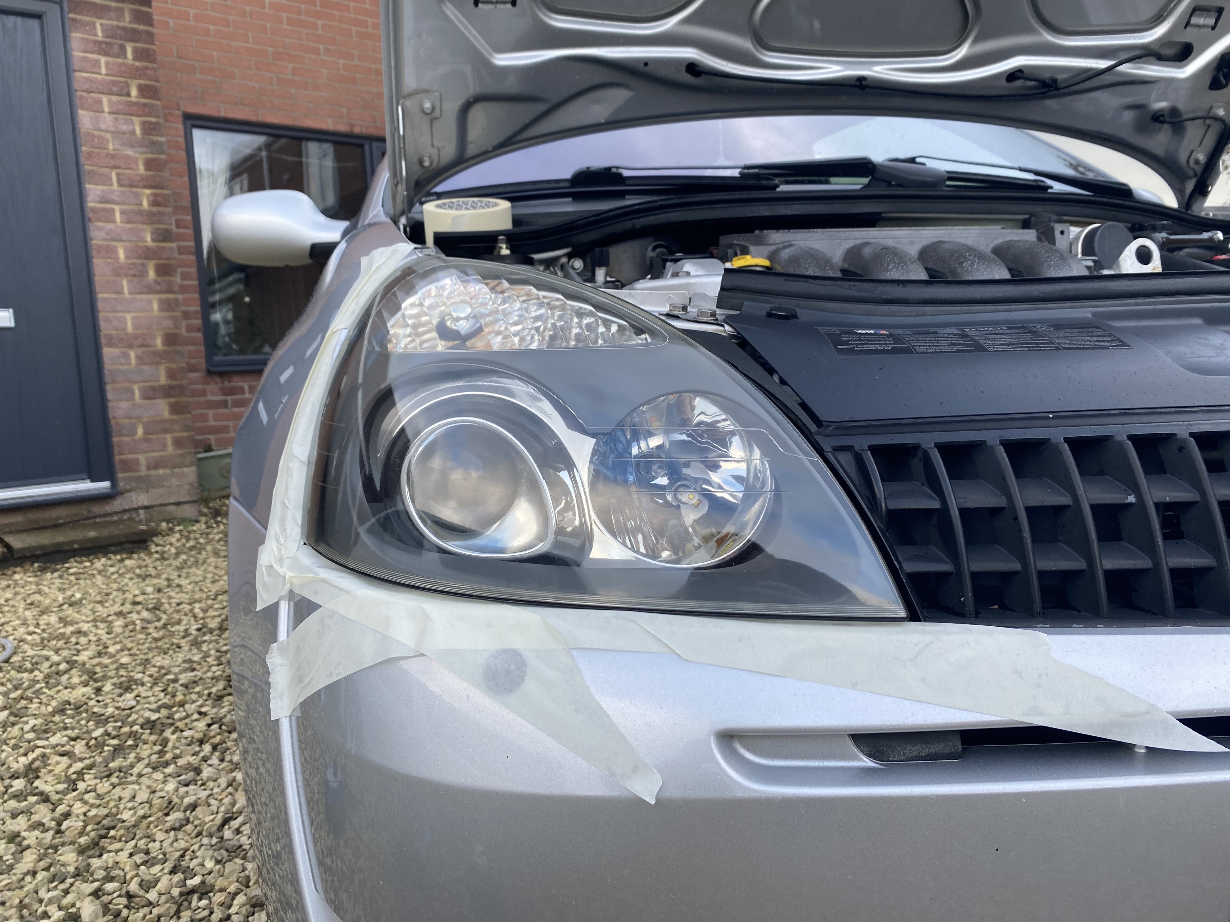

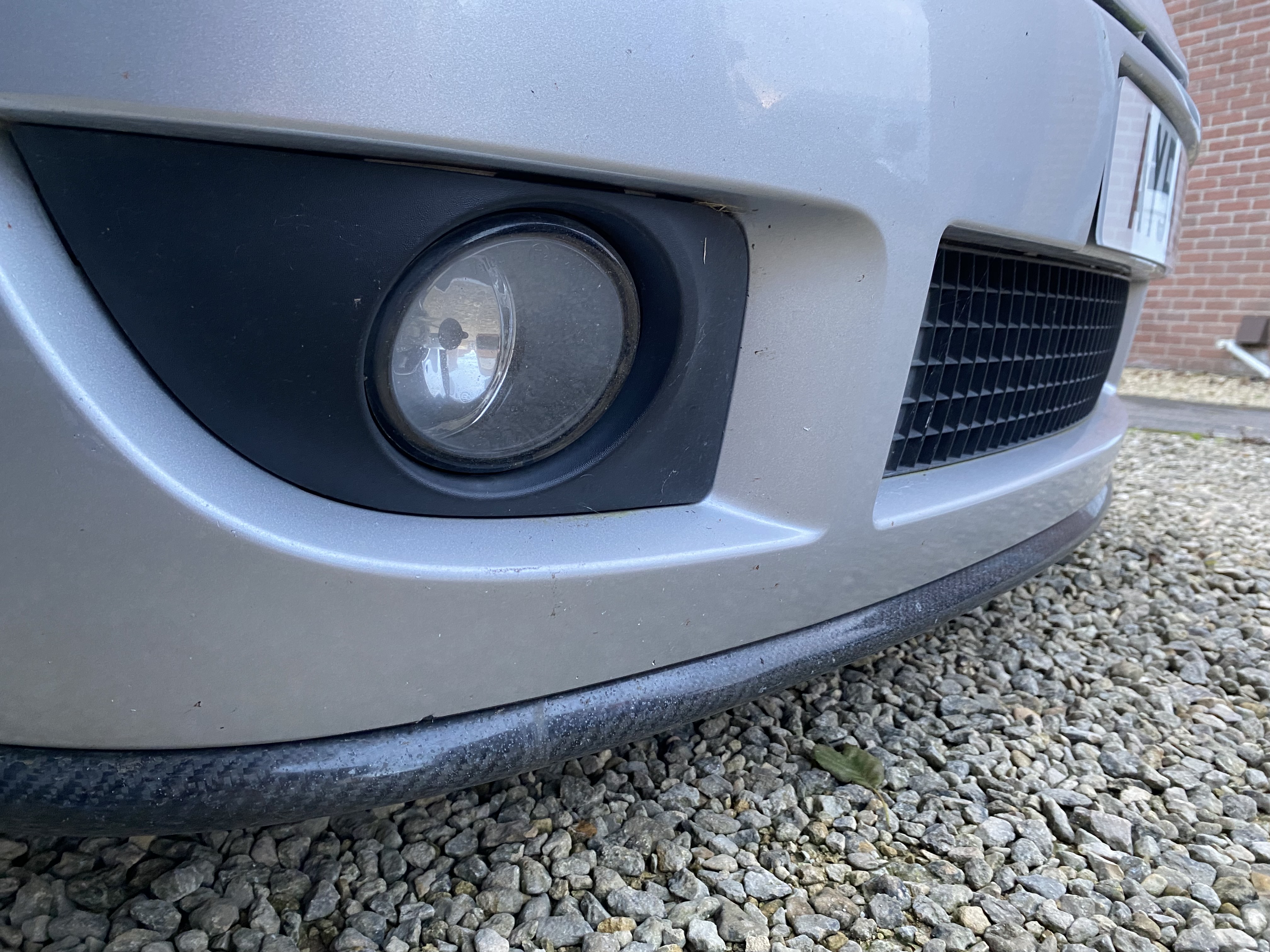

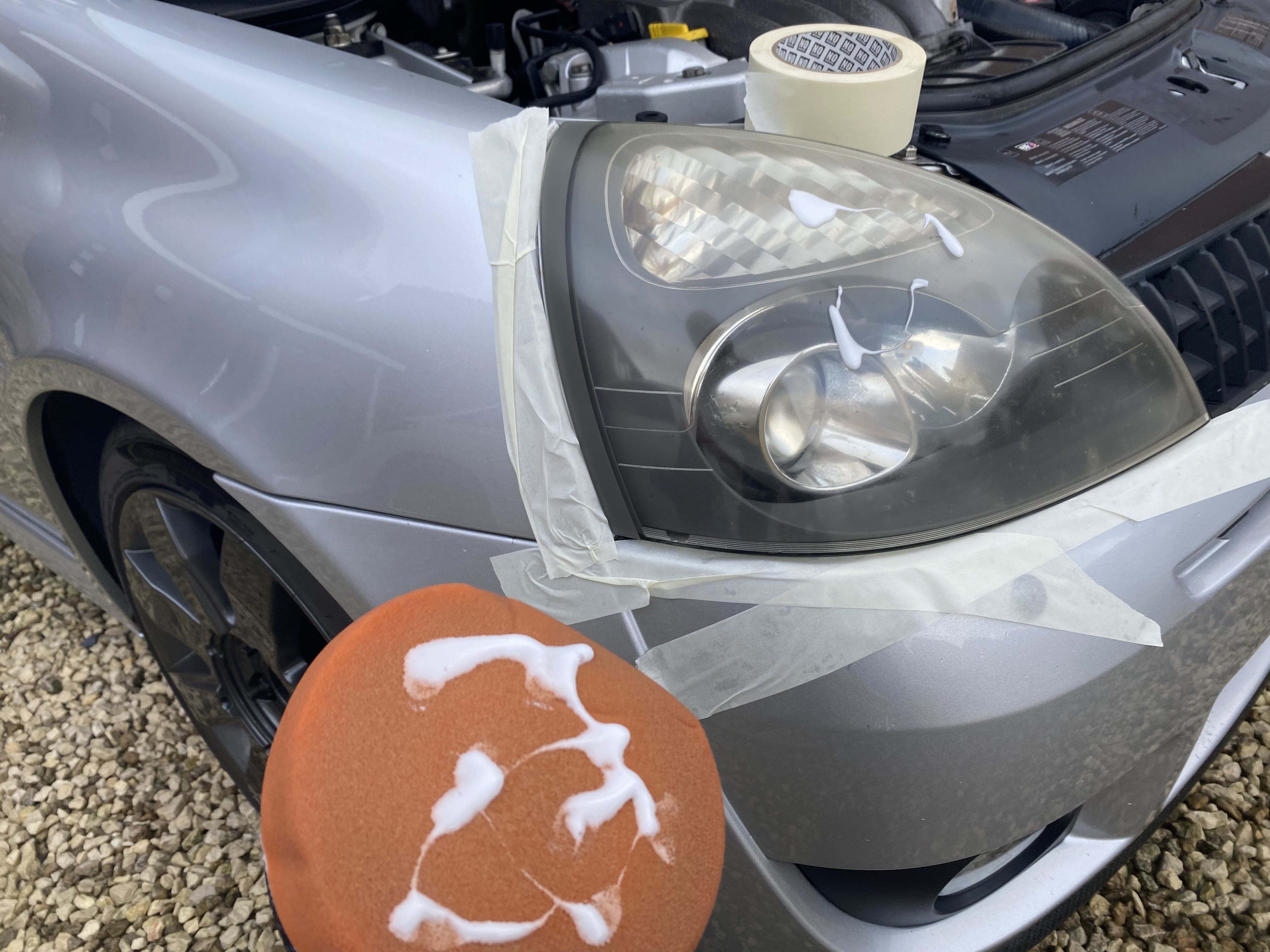

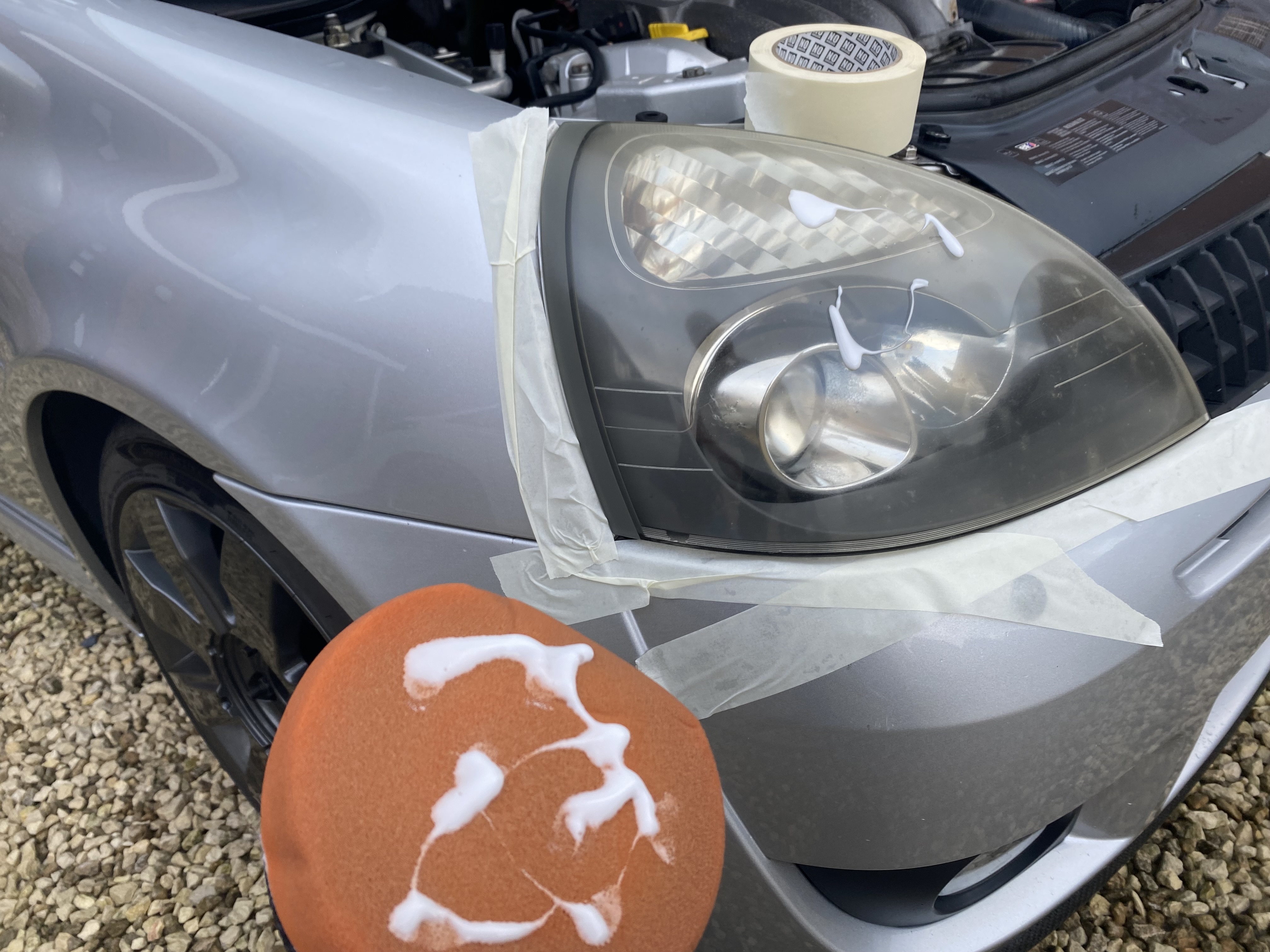

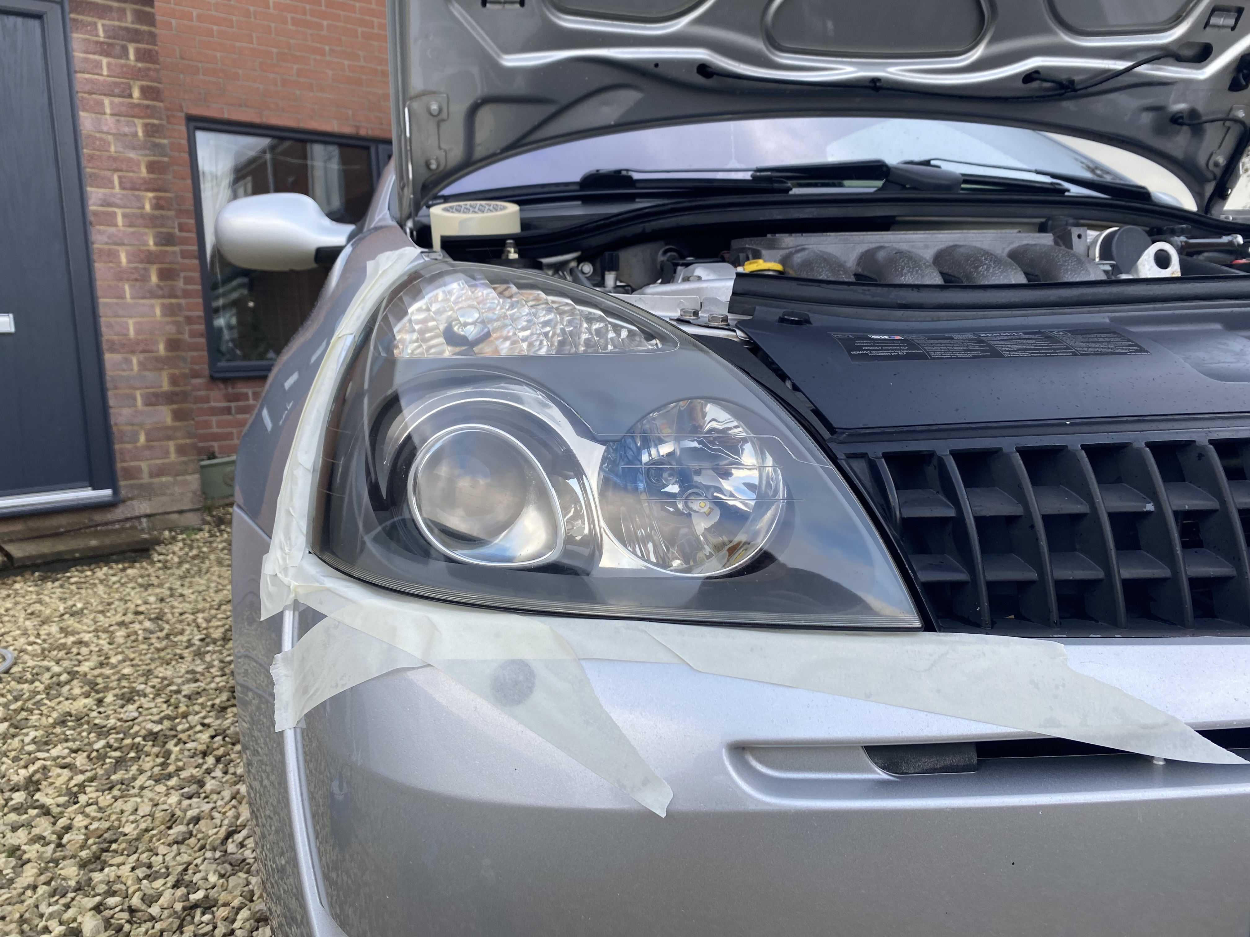

After drying off and getting buffed up next on the list was get the headlights polished up, unfortunately the headlights had really stared to show there age having misted and yellowed out.Luckily for me a quick polish really brought these lights back to life which was great to see.
Before
After

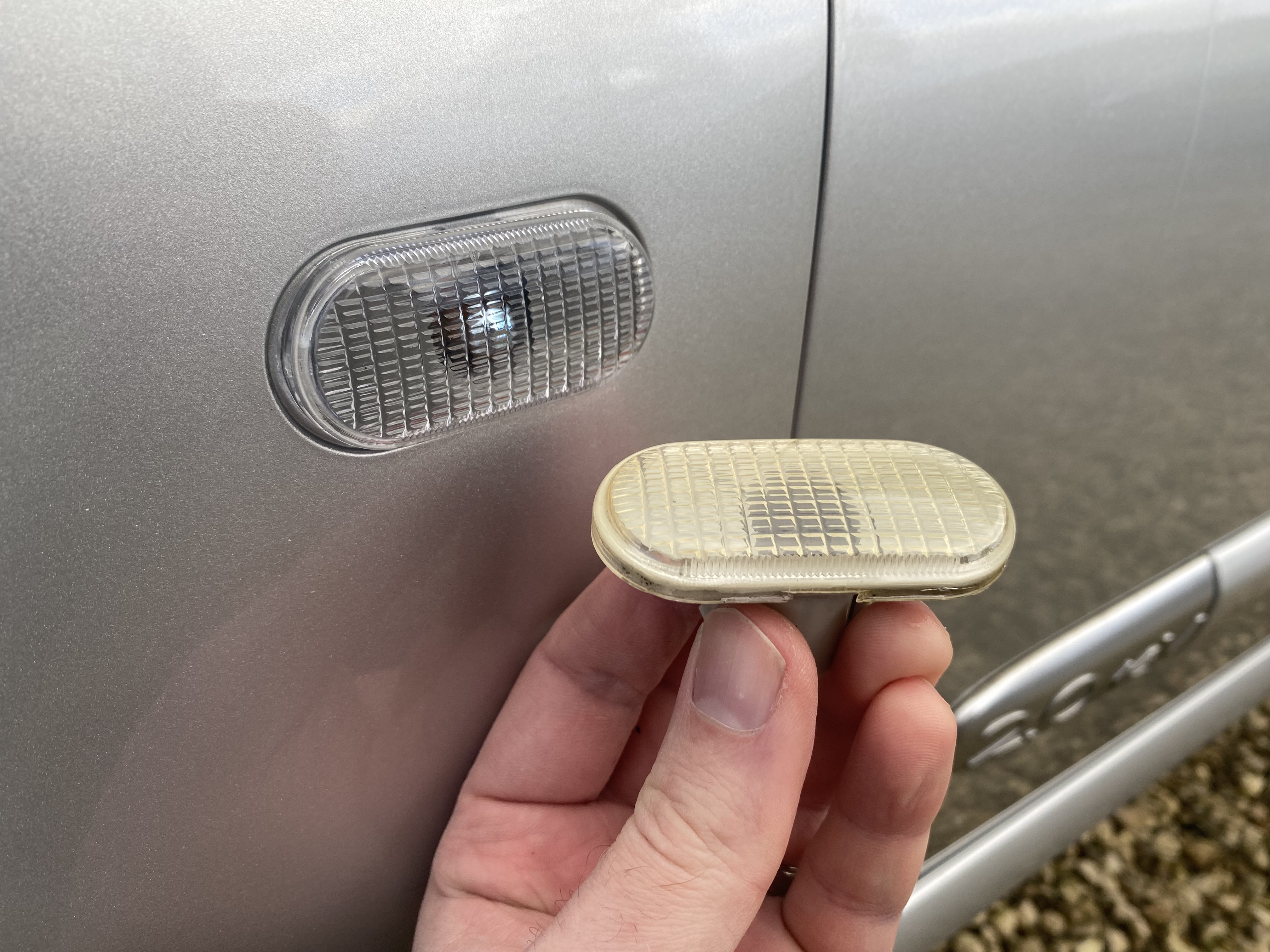

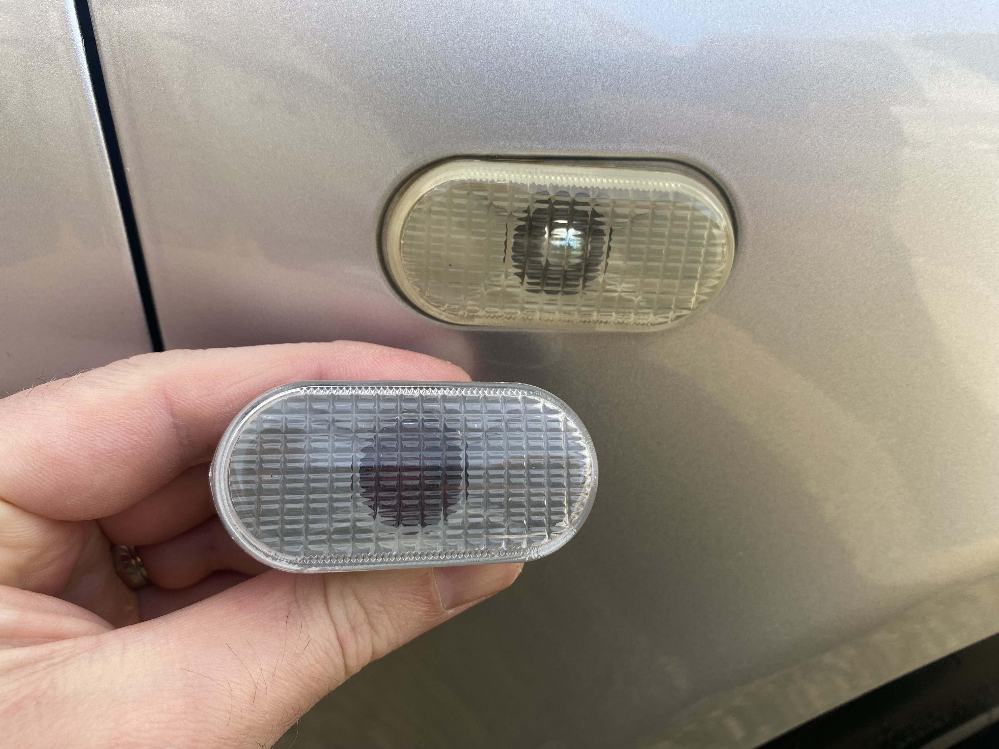

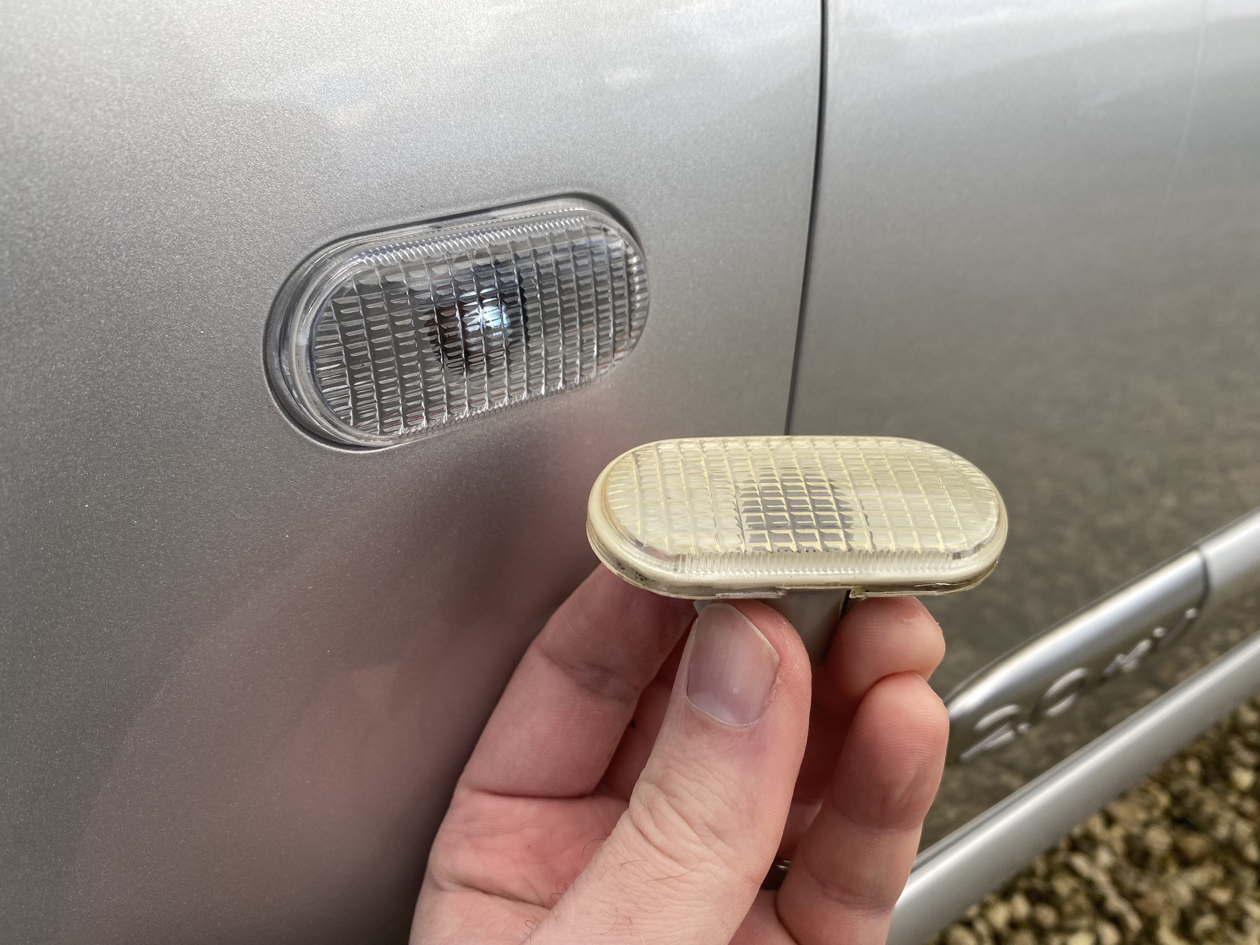

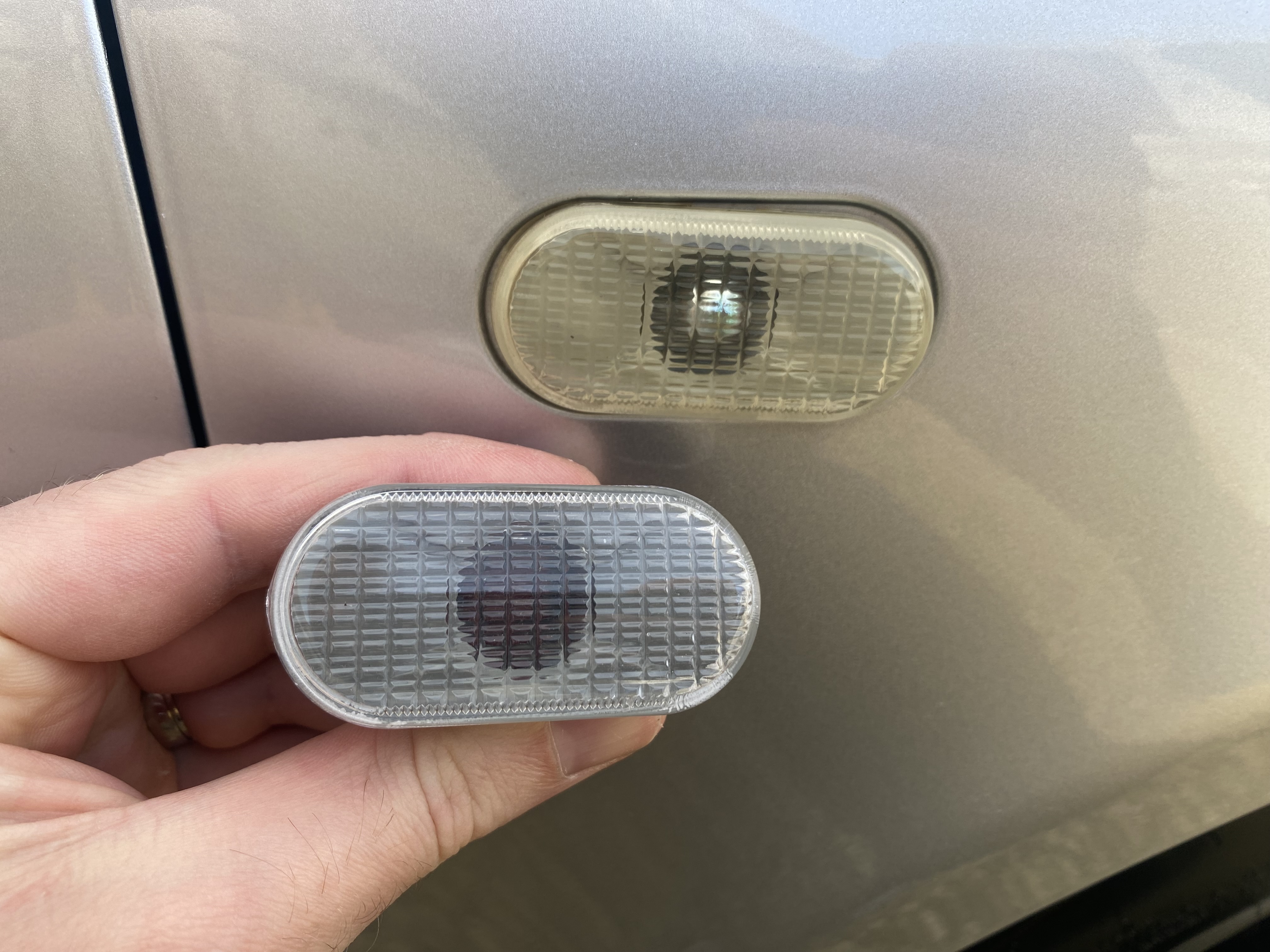

Speaking of yellowing lights the side repeaters had also seen better days, I picked up a pair of new ones from Ebay a few days ago - Quick and easy little job that again, makes a hell of a difference. I can tell someone once loved this car as already had chrome bulbs.

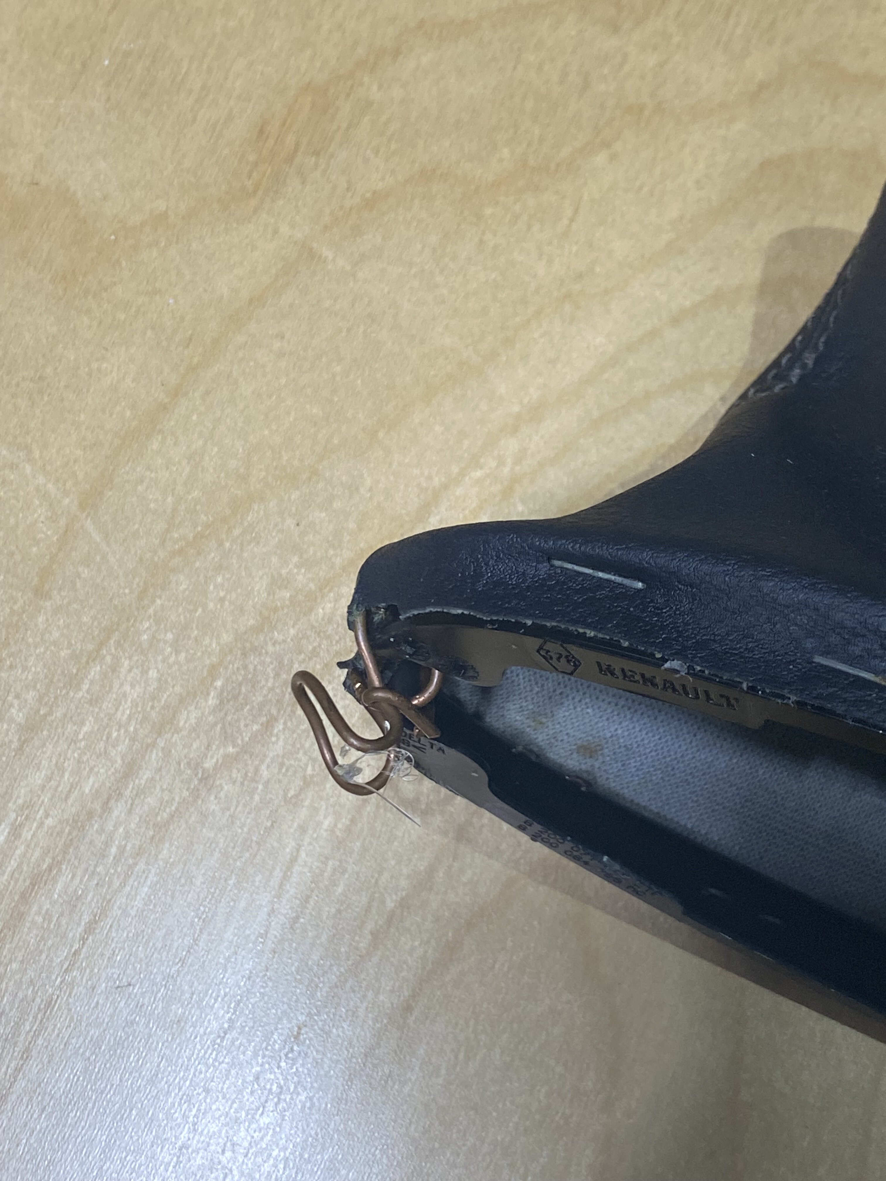

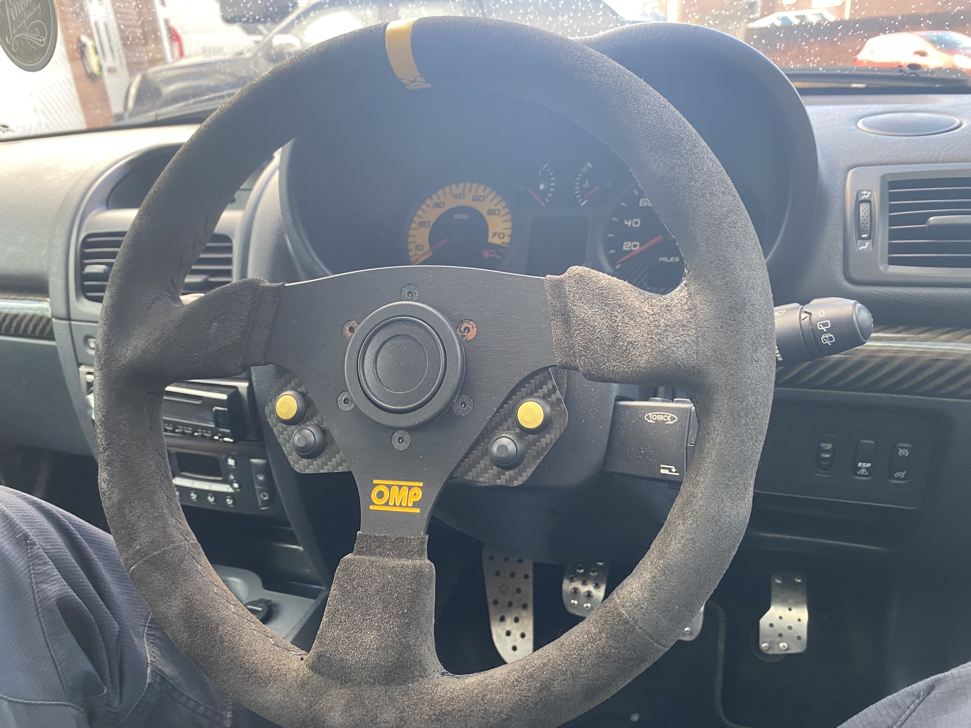

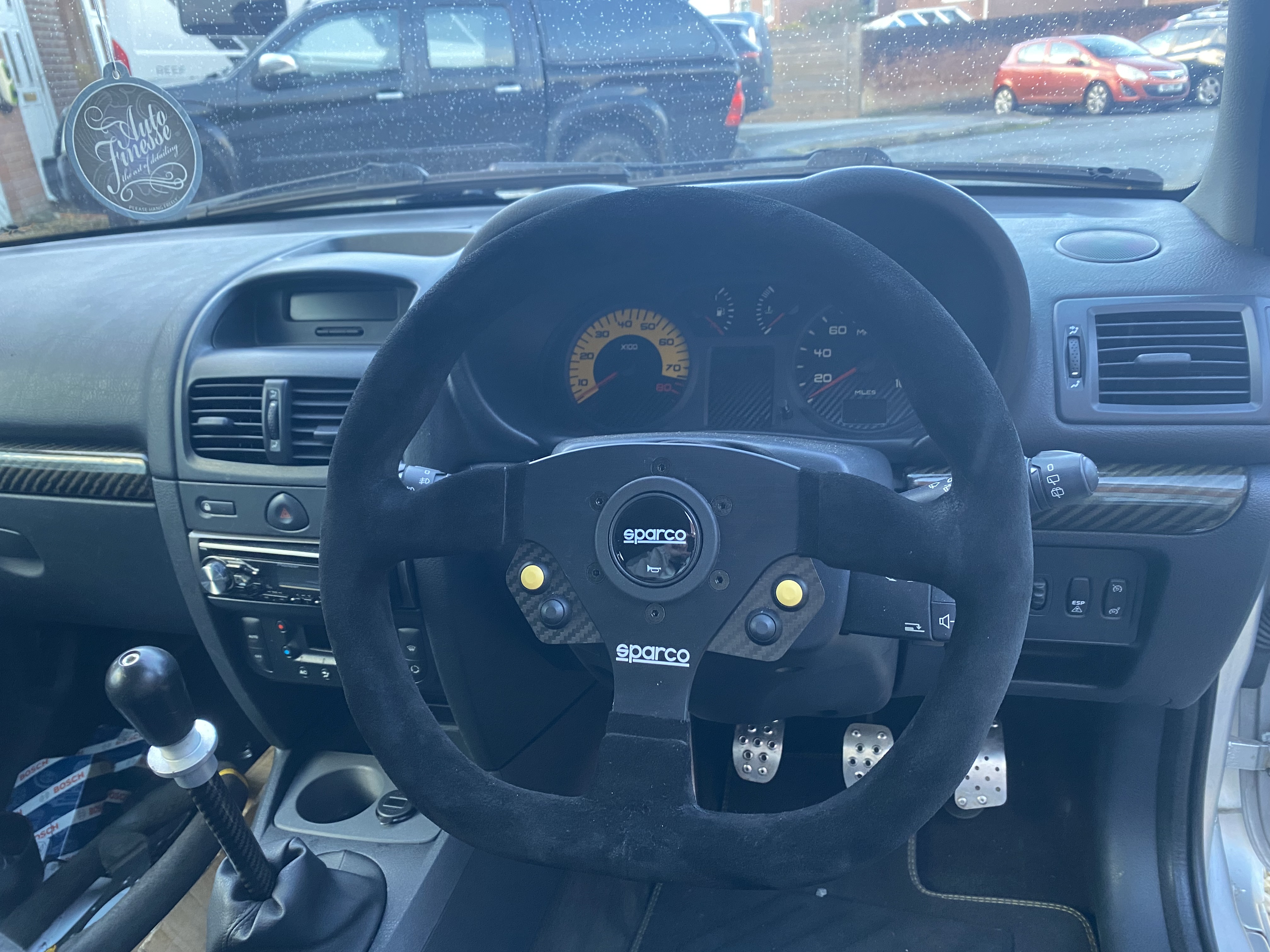

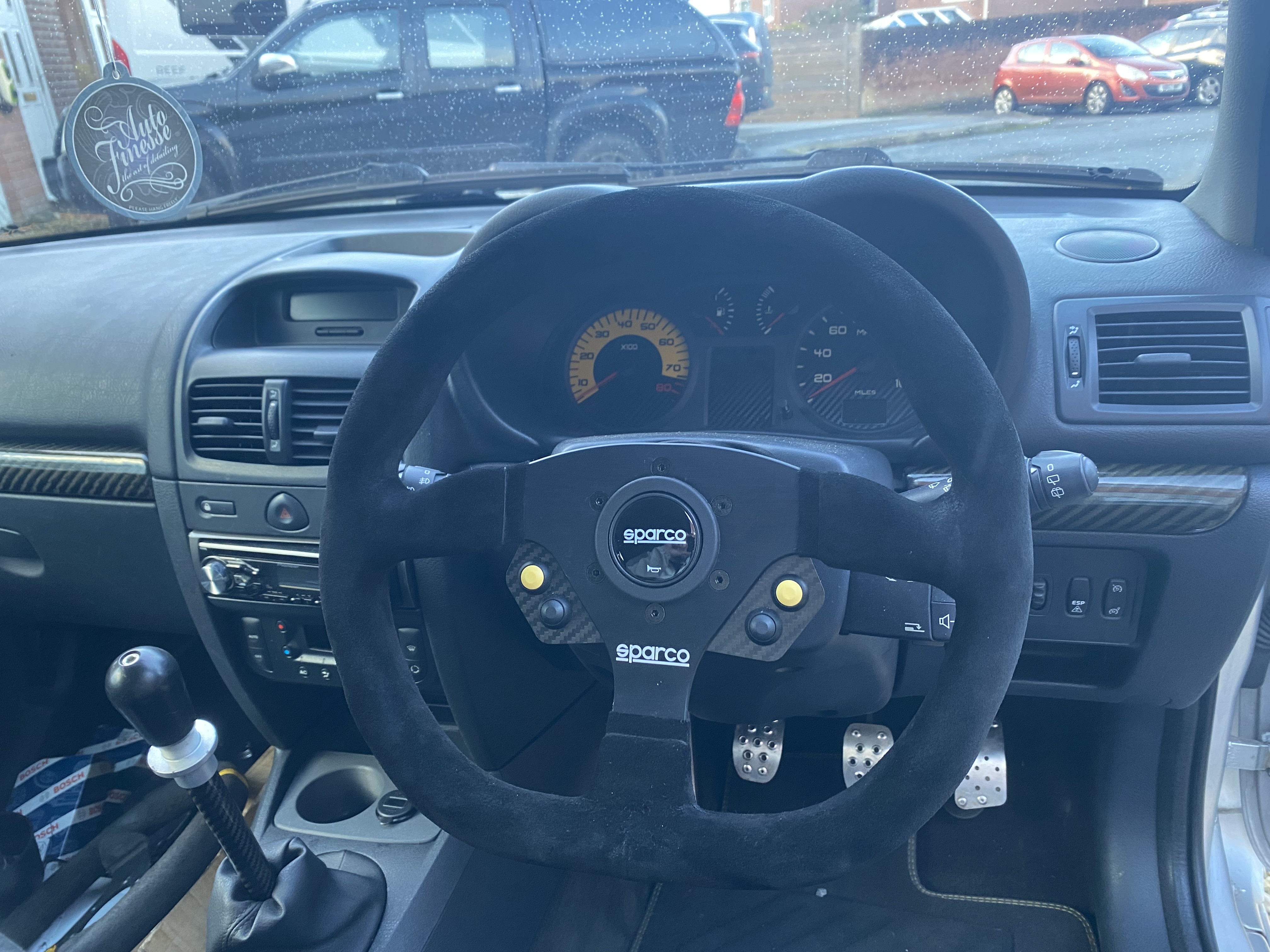

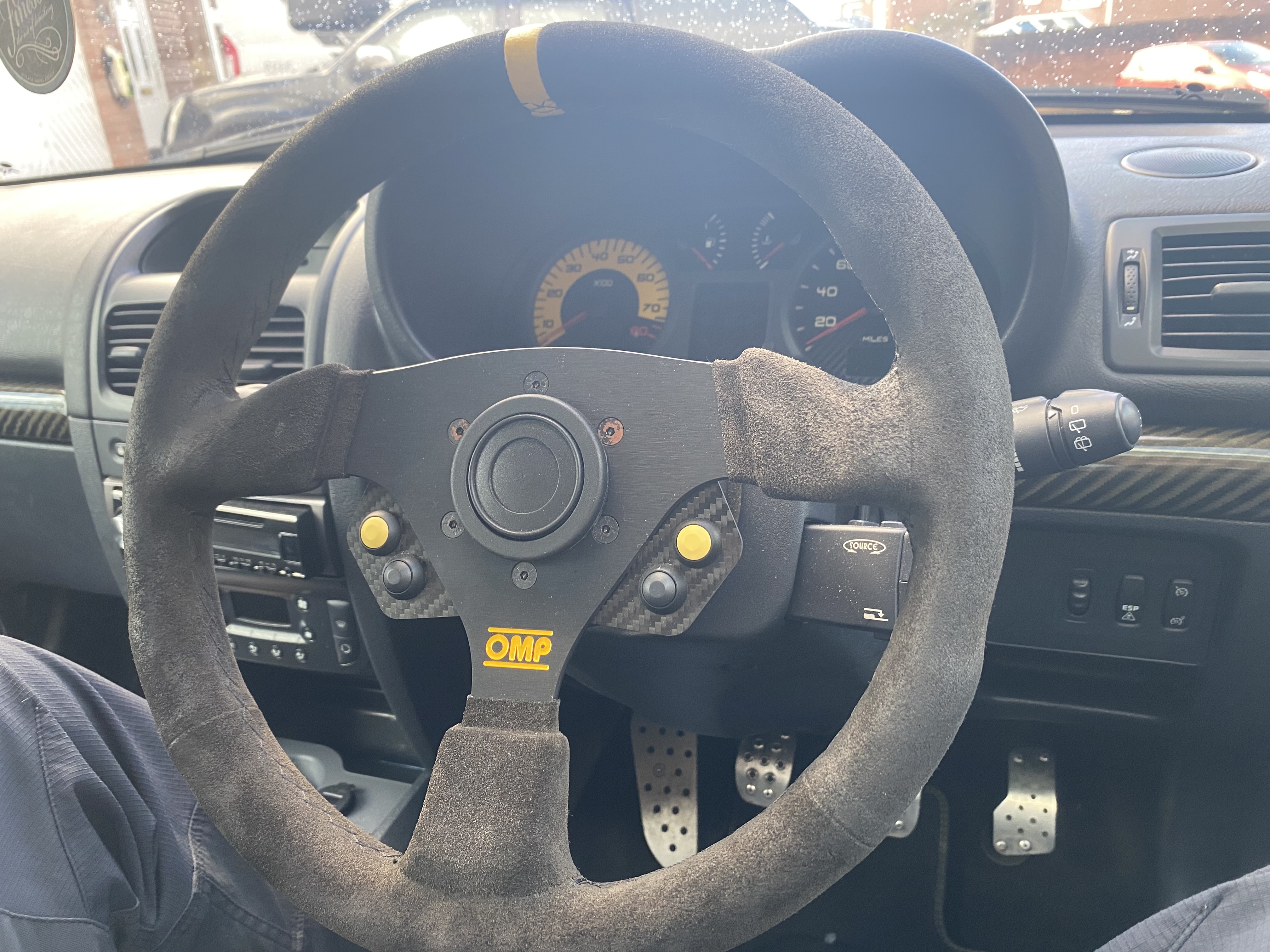

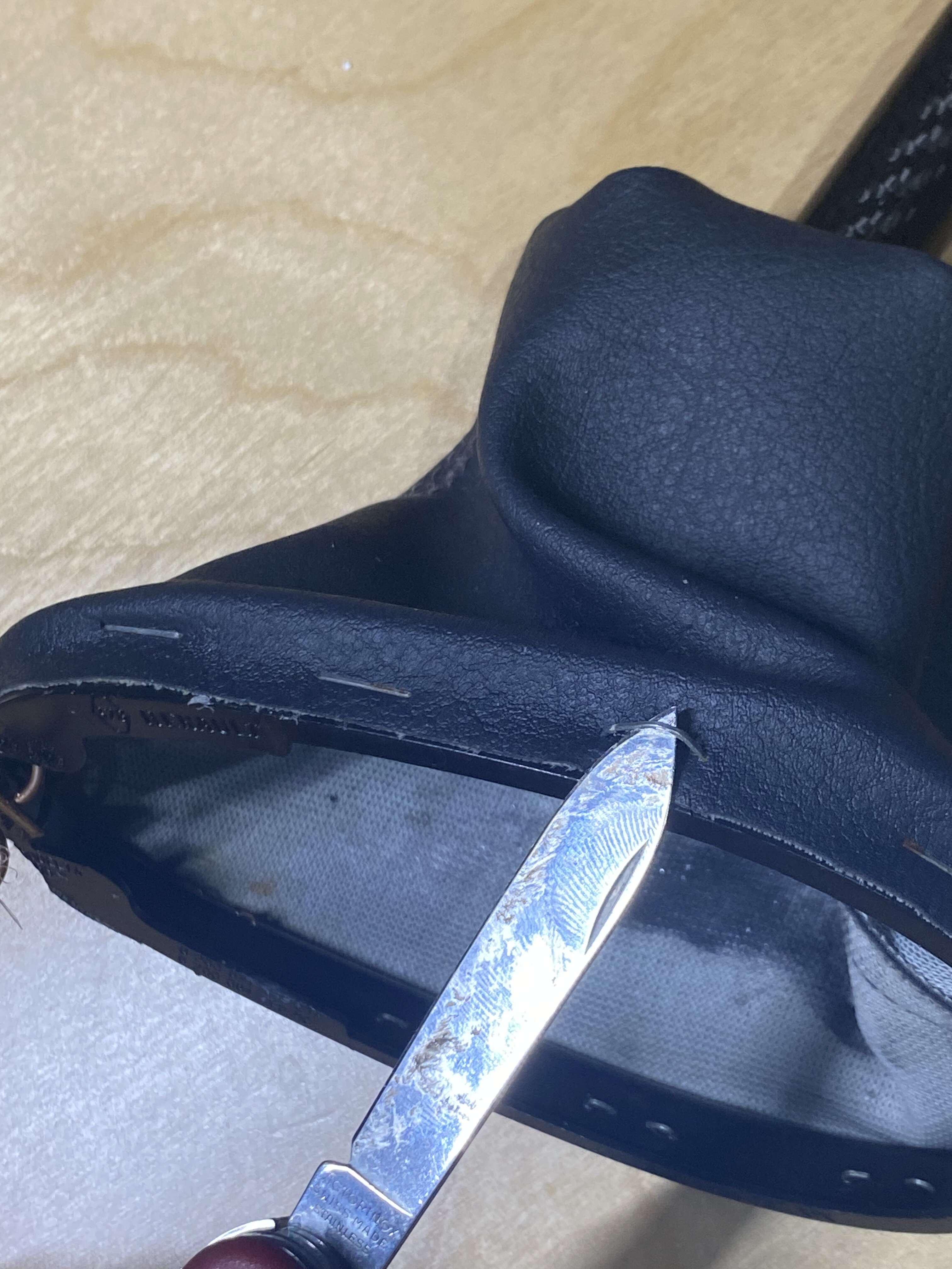

Last up was changing the steering wheel, the one fitted although I preferred style wise, it was very tatty so I changed it for an alternative I already had lying around from another car which is in far better condition.
Before
After

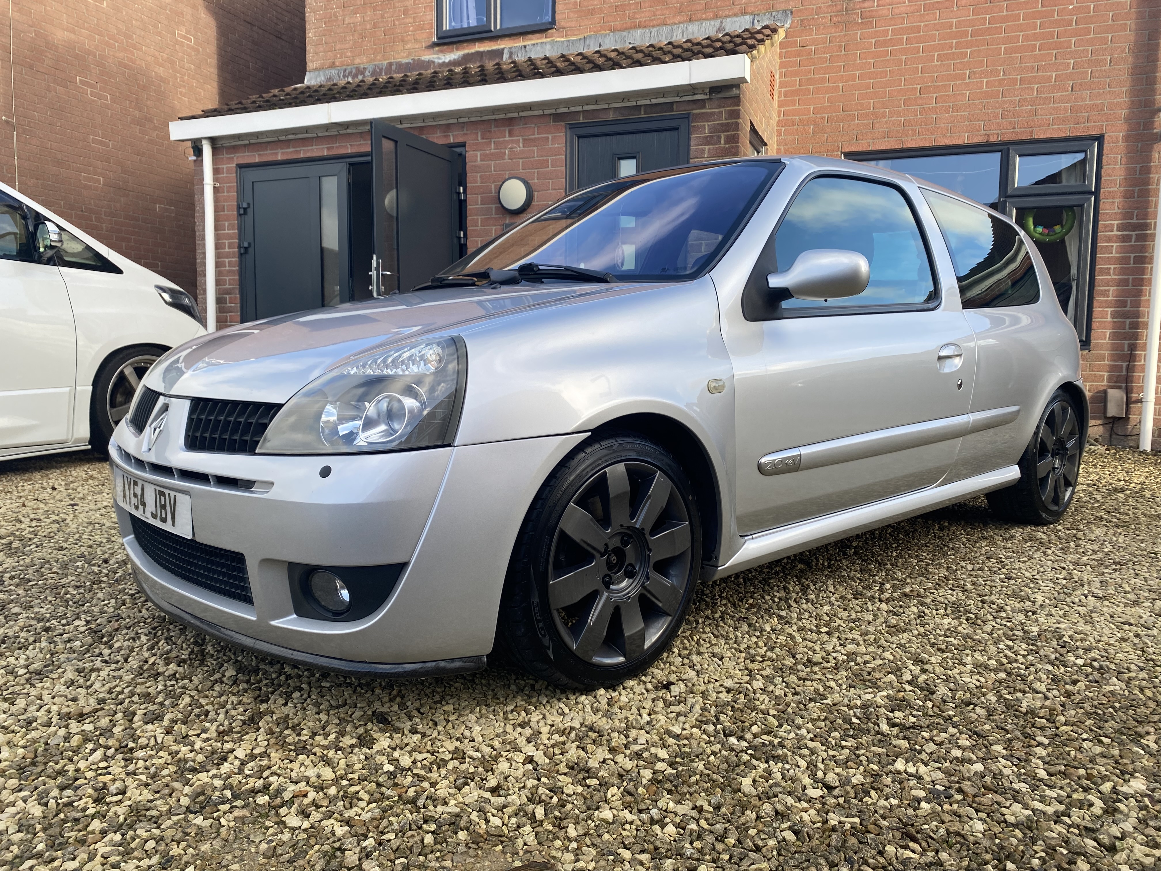

I'm feeling a lot happier now to see the old girl starting to look back at her best - Here are some pictures after a few touring cleaning, polishing and general tinkering.
Today had been a good day getting started
Outside
Under Bonnet
Before
After
Before
After

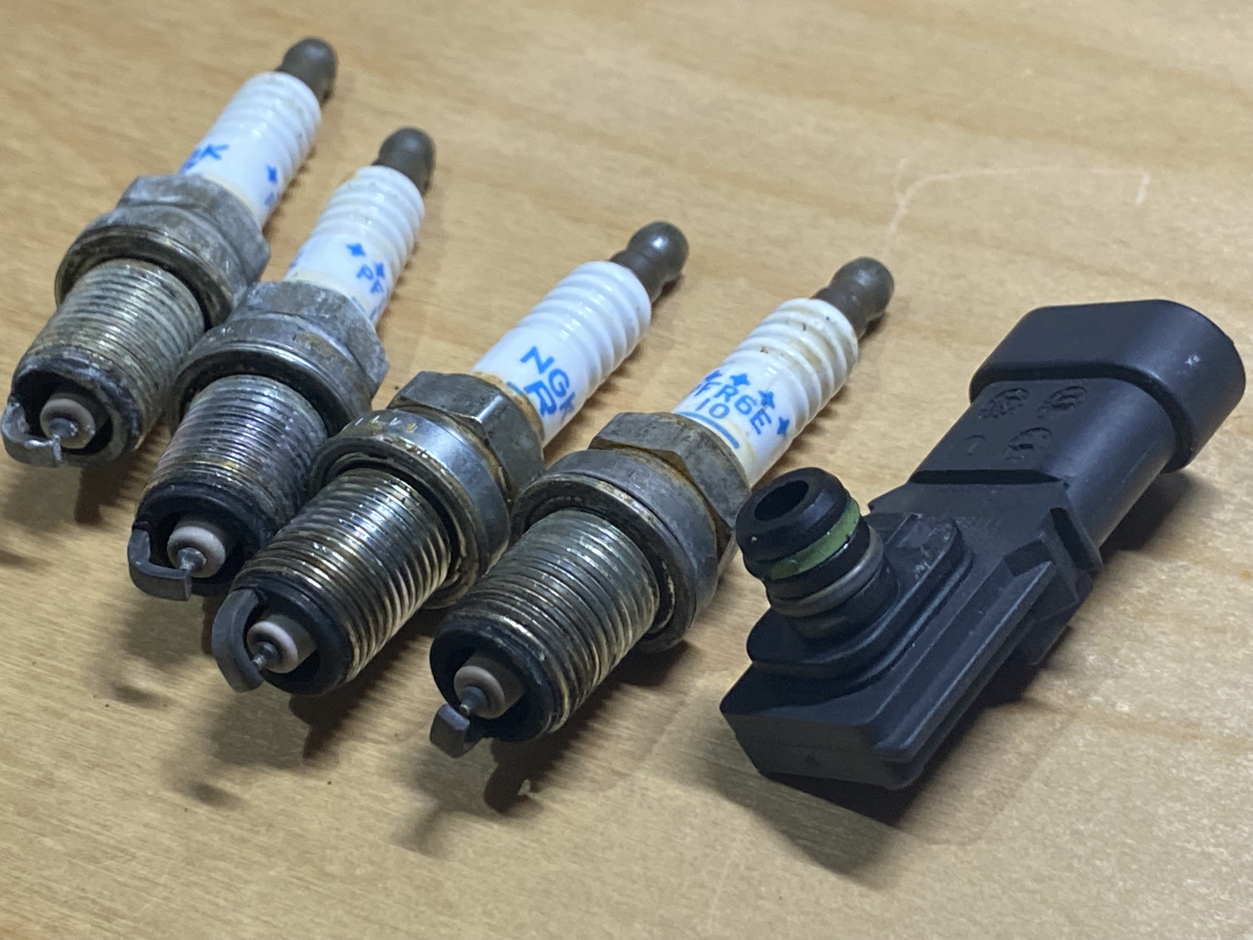

I realised a few weeks ago that since buying the car I’d barely driven it at all — other than the ceremonial “drive it home and grin like an idiot” journey. So, naturally, I decided it deserved a proper outing and took it into work for a slightly longer run last week.
What could possibly go wrong..........?

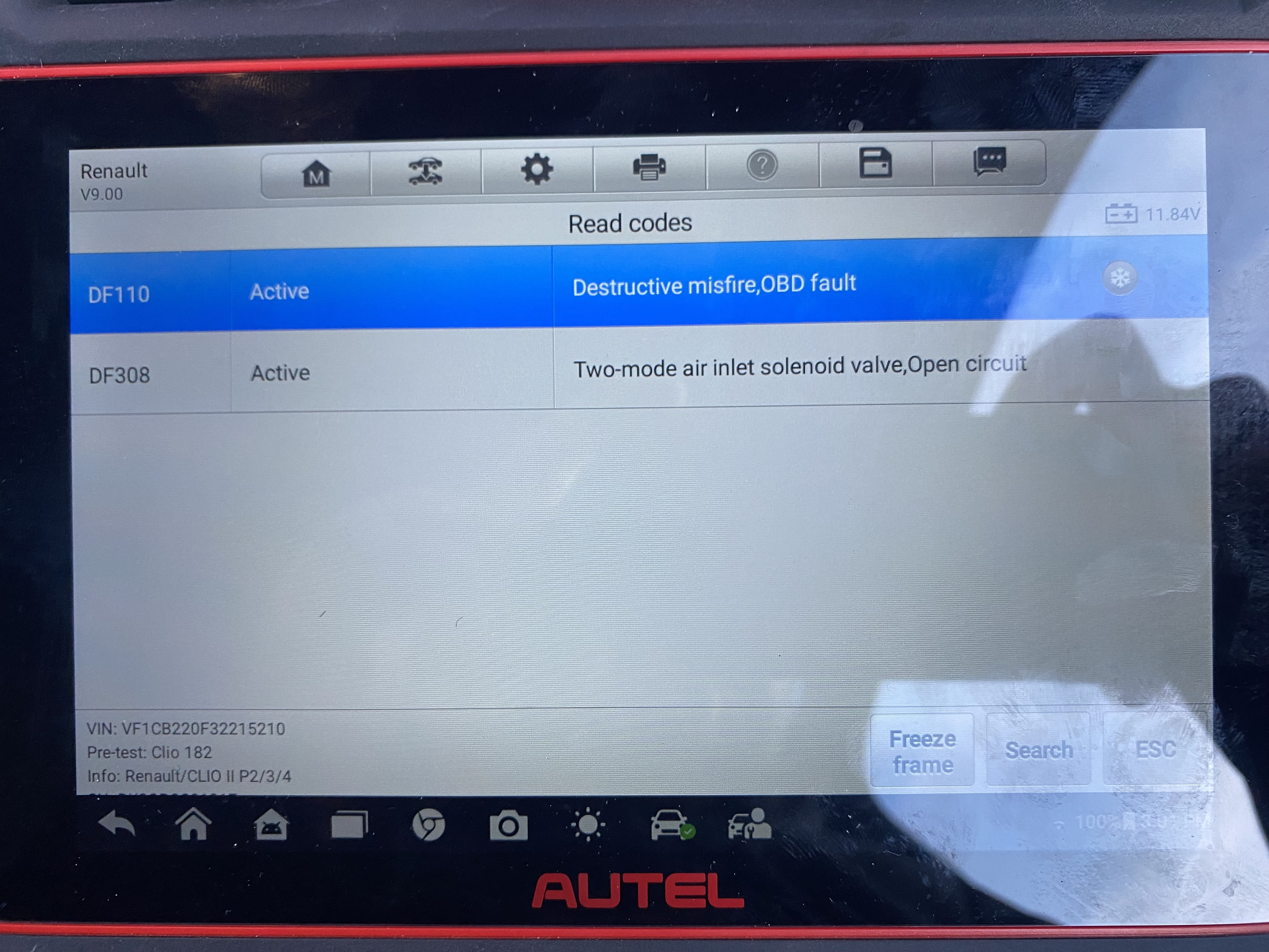

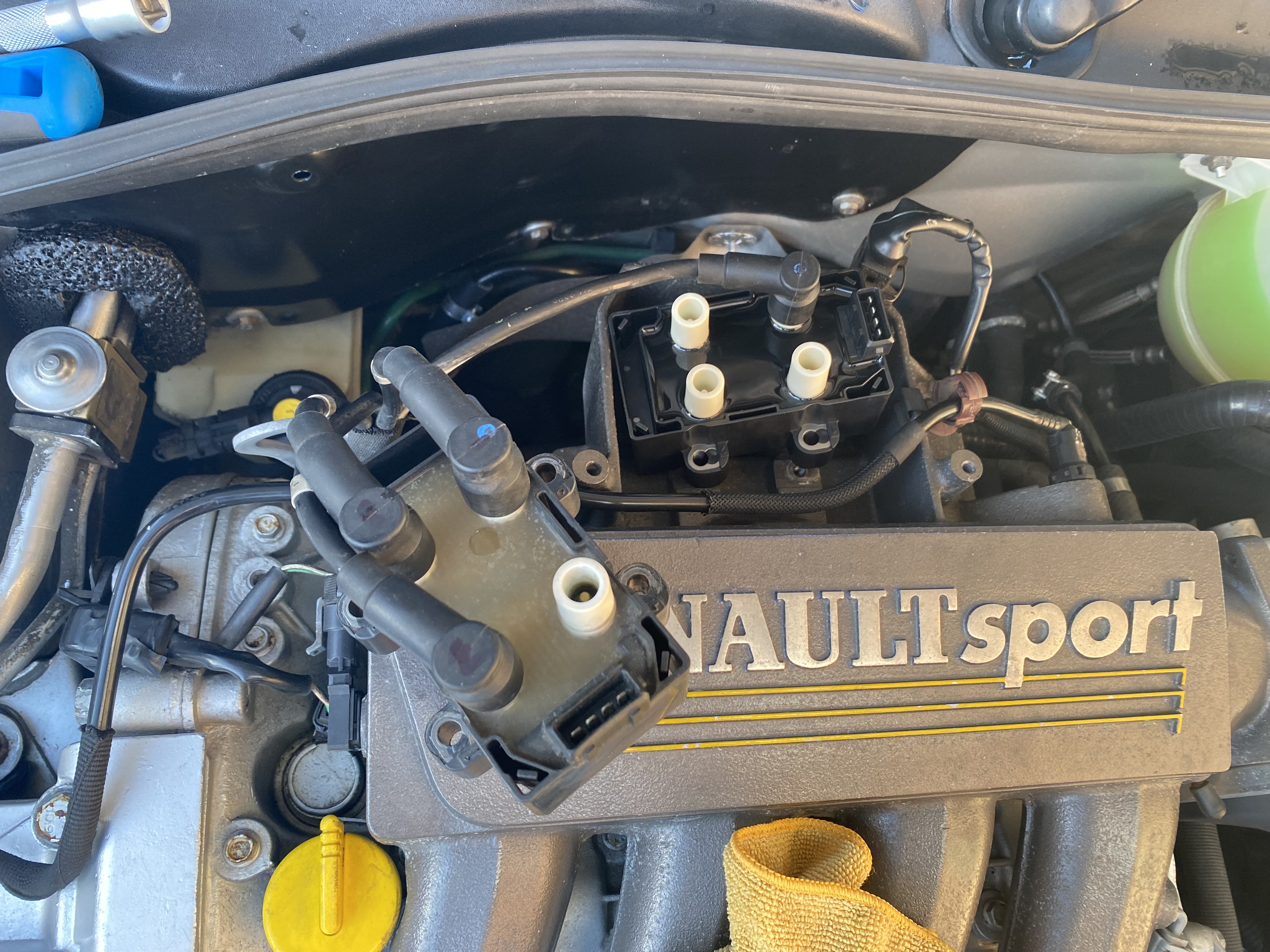

Well… about 7 miles later, while delicately parking up at work, the car started feeling a bit… off. Lumpy. Uneven. Like it had woken up on the wrong side of the bed. Still, I parked it up, went inside, and cracked on with a long day’s work, choosing to ignore the growing sense of impending mechanical doom.
Fast forward to the drive home and the situation escalated. Under acceleration it started bogging down, misfiring, and generally behaving like it had suddenly developed a deep personal hatred for combustion. Not ideal.
No problem though — this is why we own diagnostic tools, right? Time to whip it out and see what horrors awaited me…

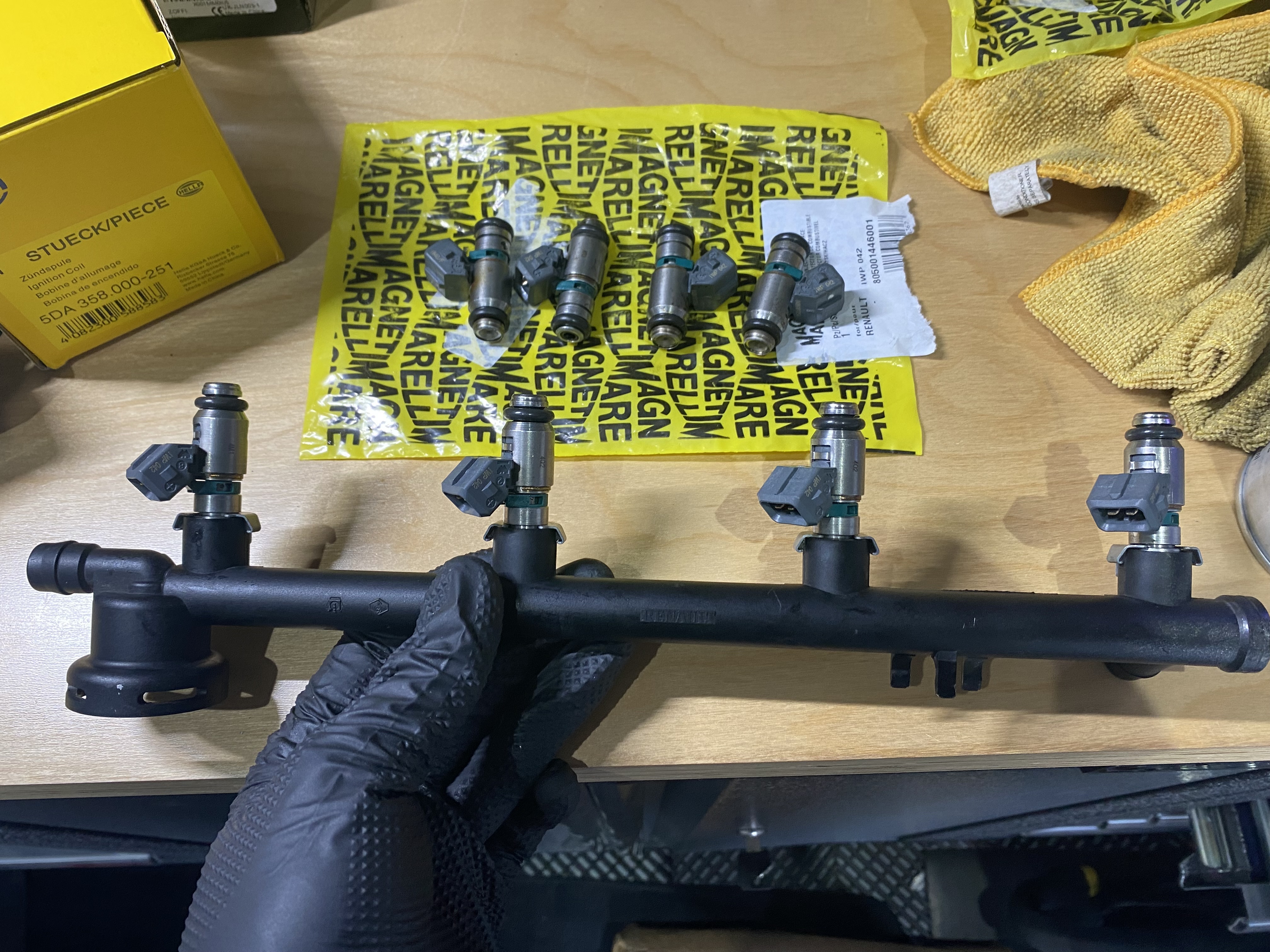

Unfortunately, the Autel greeted me with a wonderfully vague DF110 fault code, which helpfully pointed to… well… something. The DF308 code also popped up, but I’m fairly sure that’s just sulking because of the modified induction kit, so I wasn’t too worried about that one.

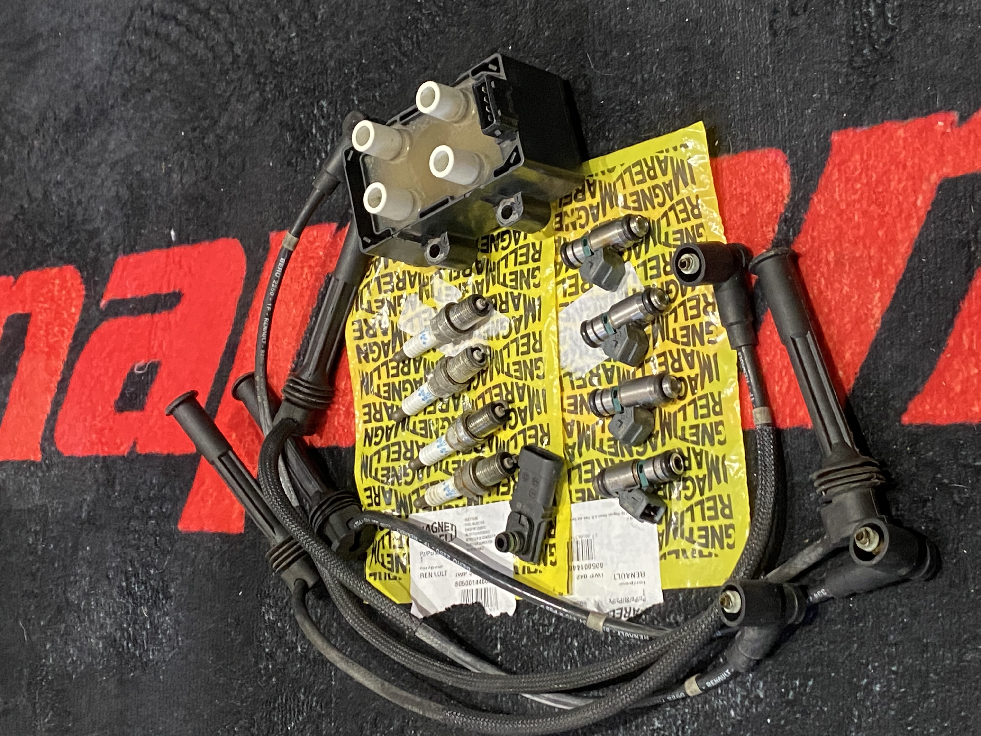

A bit of research later (and by research I mean falling down multiple internet rabbit holes), it turns out misfires on these are commonly caused by ignition components (coils, leads, plugs), MAP sensors, injectors, lambda/O2 sensors… basically everything.
Seeing as my goal is to make this car as reliable as possible — and I have absolutely no self-control when it comes to buying car parts — I did the sensible thing, I loaded up the parts cannon and started firing indiscriminately 🔫💸
Having fitted a new coil, plugs, injectors, MAP sensor I hadn’t made a dramatic difference to how the car actually runs — but it has bought me some valuable peace of mind that these common failure points (hopefully) won’t come back to haunt me later. On the plus side, I’m really enjoying working on the car. These little things are refreshingly simple, easy to access, and a genuine pleasure to tinker with.
And finally… the missing piece of the puzzle arrived today — the long-awaited HT leads!!
Picture the scene: me, behaving exactly like an over-excited child on Christmas morning, sprinting downstairs (well… briskly walking) and straight out to the Clio before common sense could intervene. Tools out, bonnet up, HT leads fitted in record time.
Moment of truth.
The car fired straight up. Good start. I then sat there for a few anxious minutes letting it warm up, listening intently, half convinced it was about to start coughing, spluttering, or reenacting its previous tantrum. Nothing. Just a smooth idle. Promising.
So I gingerly set off around the block and… success! 🎉
She now drives and pulls perfectly. No misfires, no bogging, no drama. Massive weight off my mind, especially as I was rapidly running out of ideas and starting to mentally prepare myself for something far more expensive and inconvenient. Turns out, it really was just the leads all along.
I’m genuinely relieved to have it back running as it should — and even happier knowing that several of the usual failure-prone components have now been refreshed, meaning fewer future headaches (hopefully).

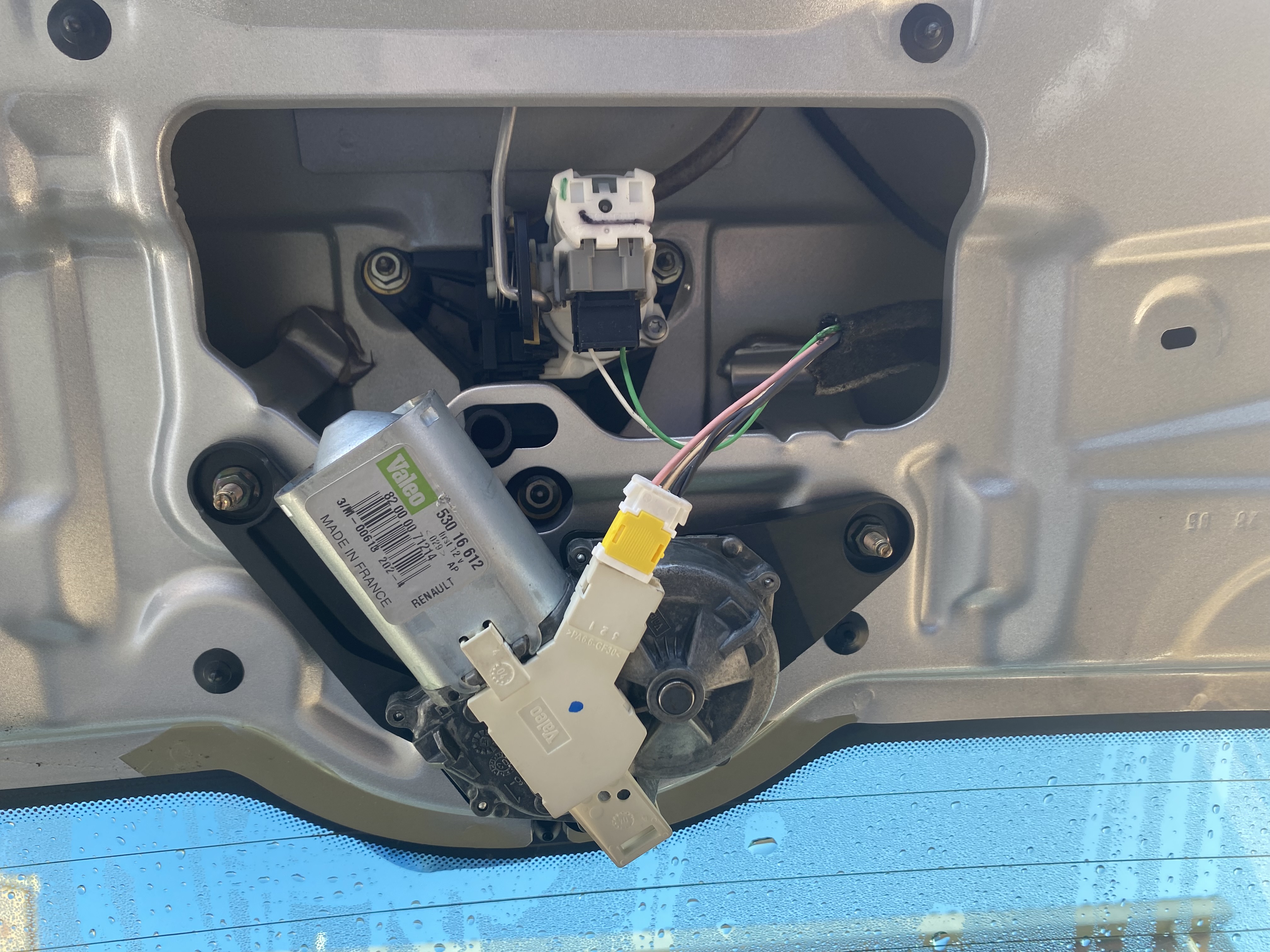

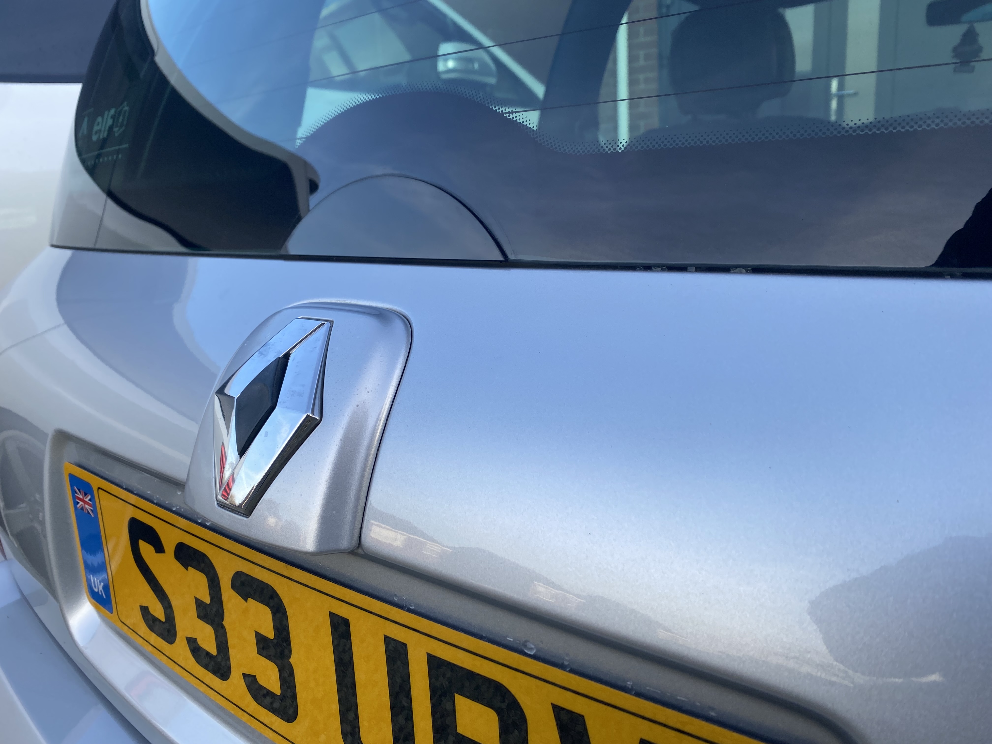

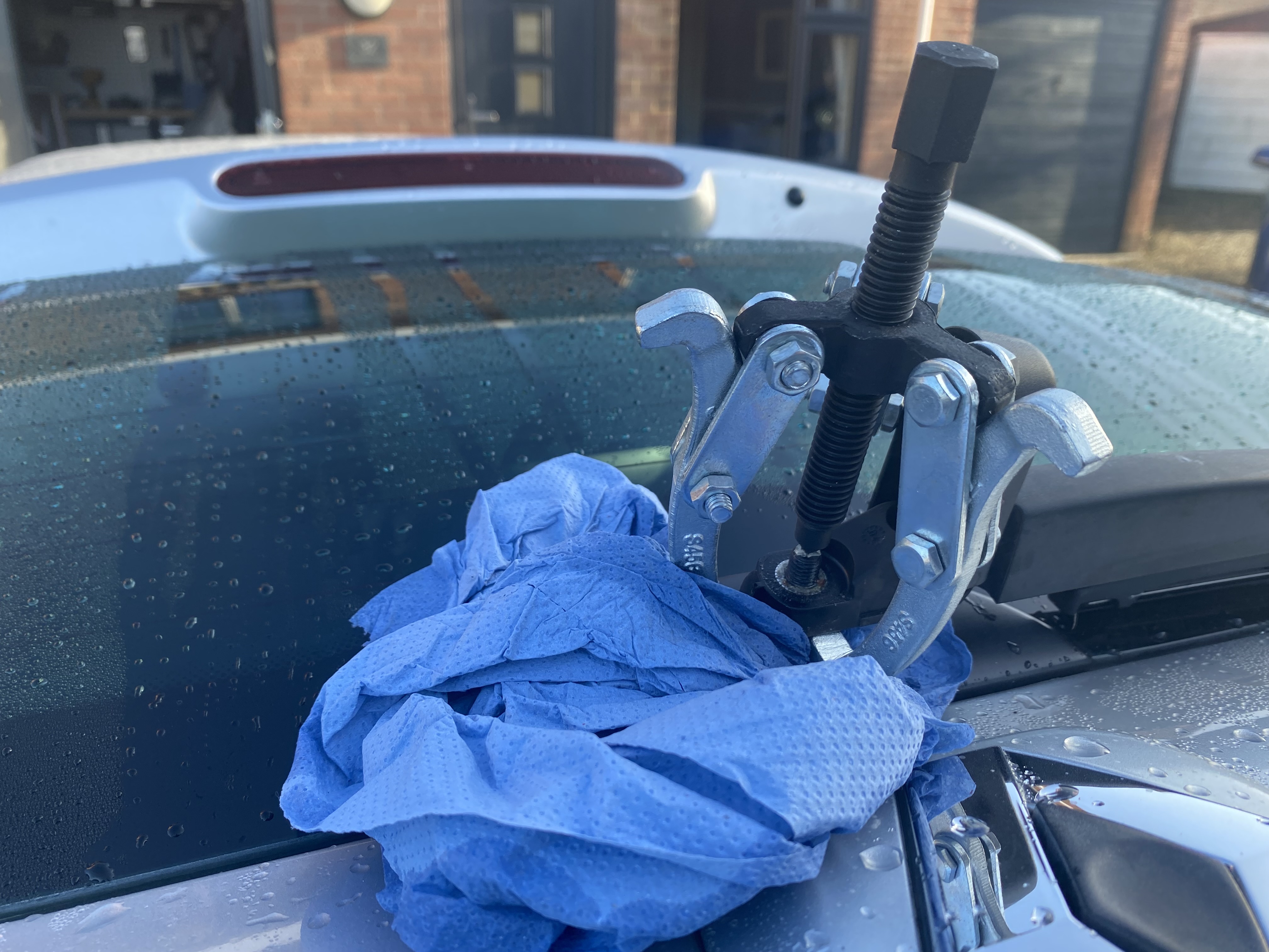

Today - Time for a small job yet like rather controversial one this morning - the rear wiper delete on the Clio 182. I genuinely never use the rear wiper in any car, I can't stand the wiped mark it leaves behind as it makes any car look dirtier instantly, I do like to keep my cars clean so just can't stand it!!

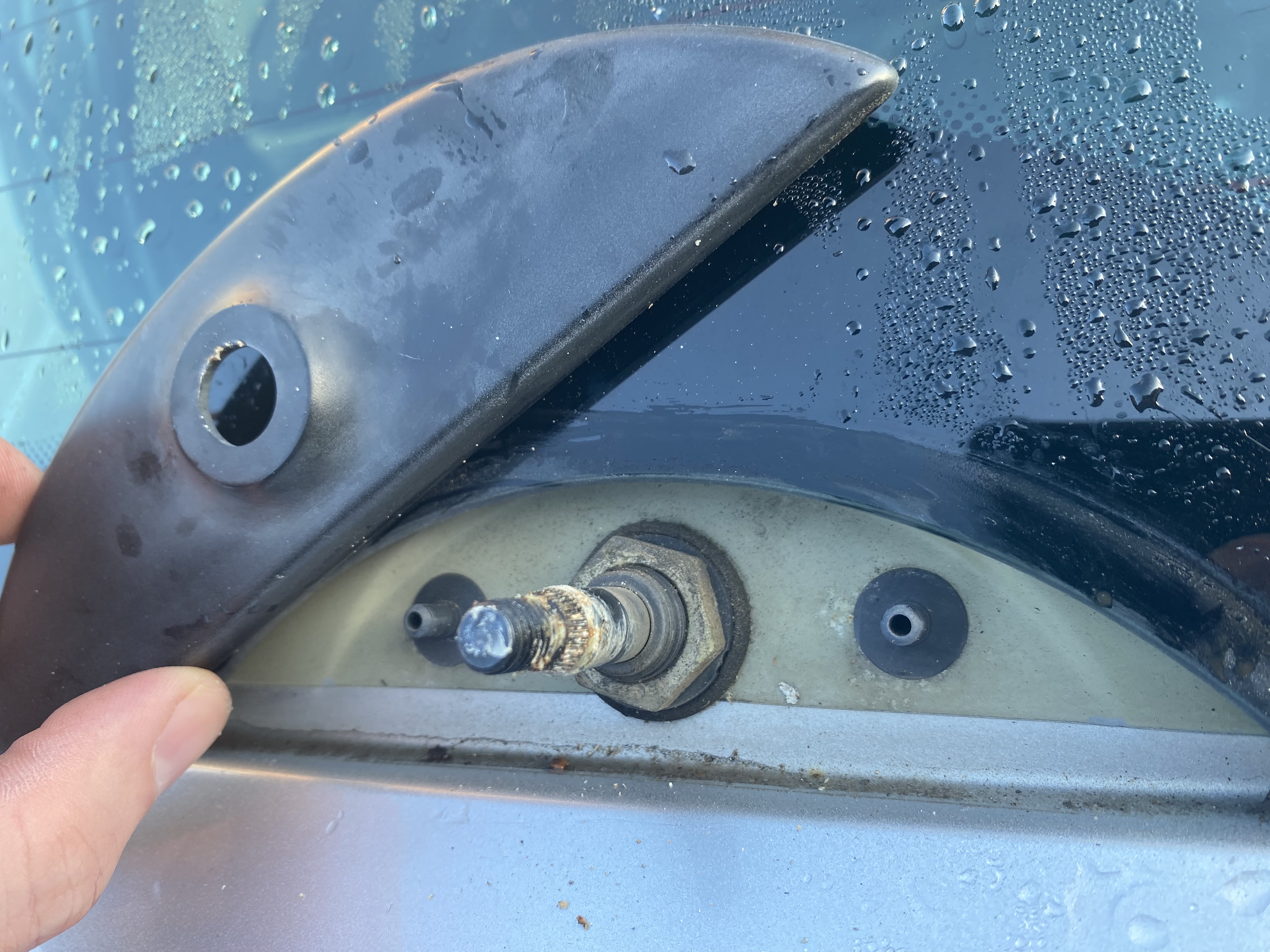

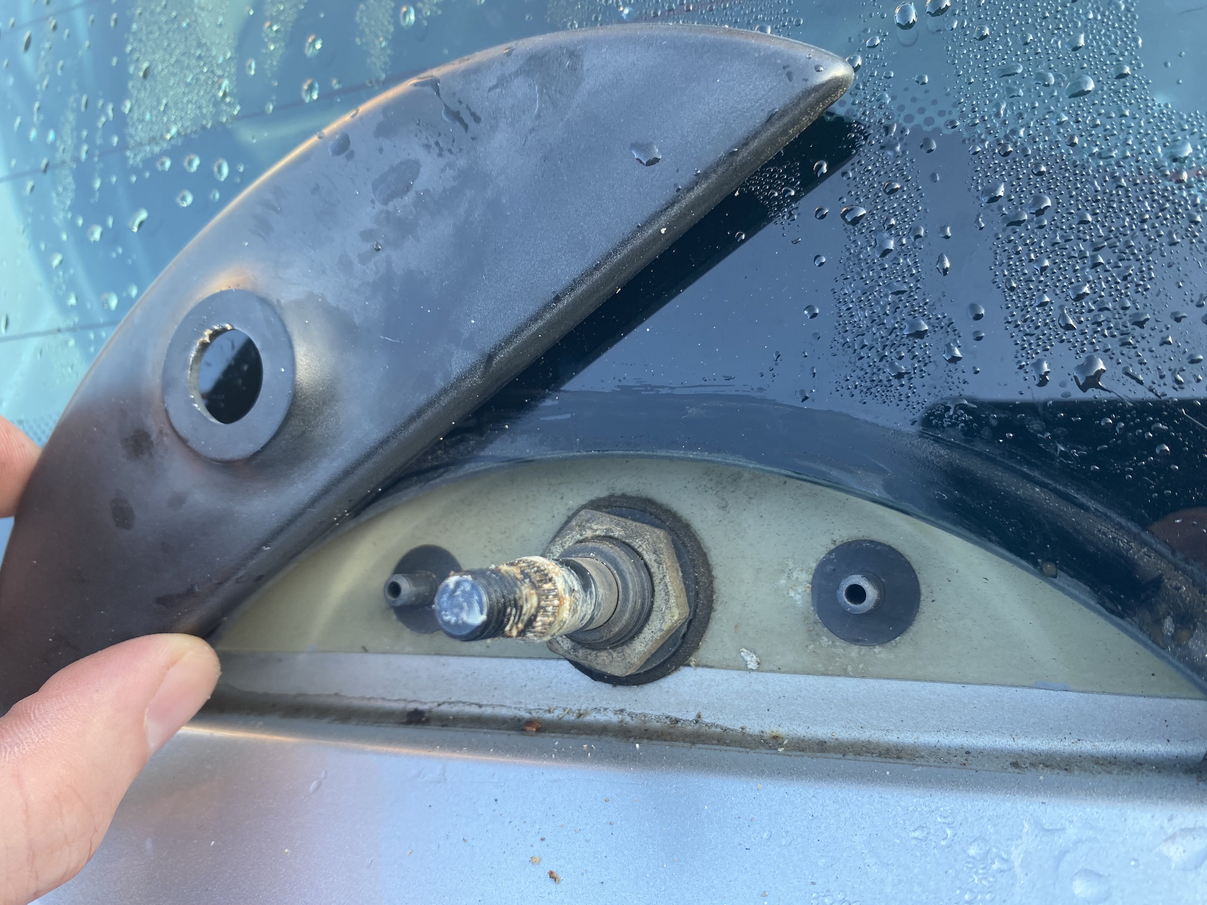

It all started innocently enough. I stood at the back of the car, looked at the rear wiper and thought:
“Do I really need you?” The answer, obviously, was no. Track car vibes don’t include a rear wiper, and weight saving of at least 0.0007kg was surely on the cards.
First up, off comes the wiper arm. A quick wiggle, a little persuasion, and… nothing.
OK, fine. Out comes the puller, because we’re being professional today.
Several turns later, accompanied by noises that sounded suspiciously like the glass protesting, the arm finally surrendered with a crack that briefly made me question all my life choices. Glass and arm survived and heart rate eventually returned to normal.
At this point I removed the motor from inside the tailgate. Surprisingly easy once the outside fight was over — a few bolts, one connector, and the whole lot came out in one lump.
Weight reduction achieved #Motorsport.

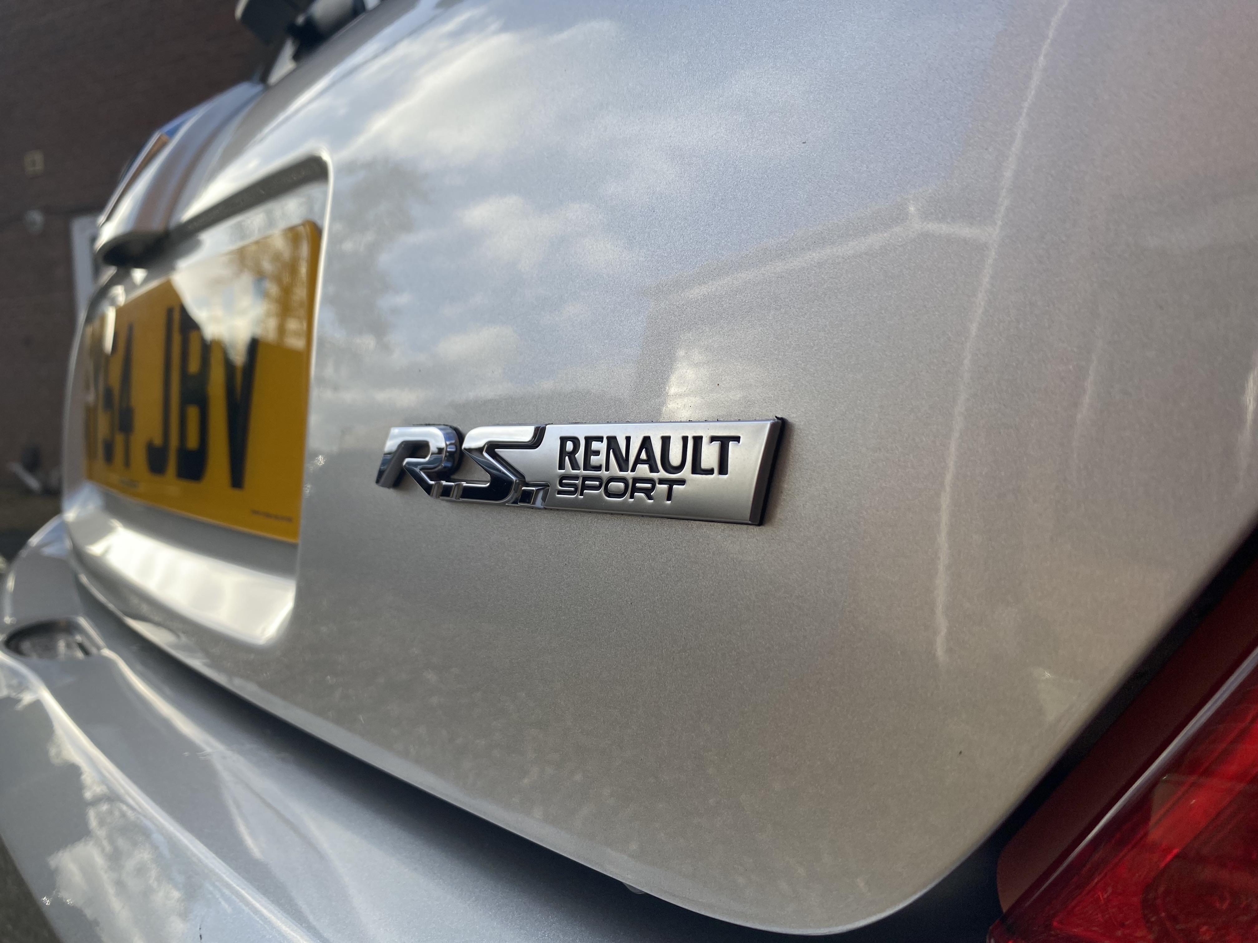

With everything cleaned up, the hole was treated, bunged and sealed then finished with a proper rear wiper delete plate leaving a flush gloss black finish that actually looks OEM+.
Stand back, admire, nod approvingly, go back inside to warm up.
The rear of the Clio now looks cleaner, meaner, and far more “I might go to the Nürburgring” than “I need to reverse in the rain”.

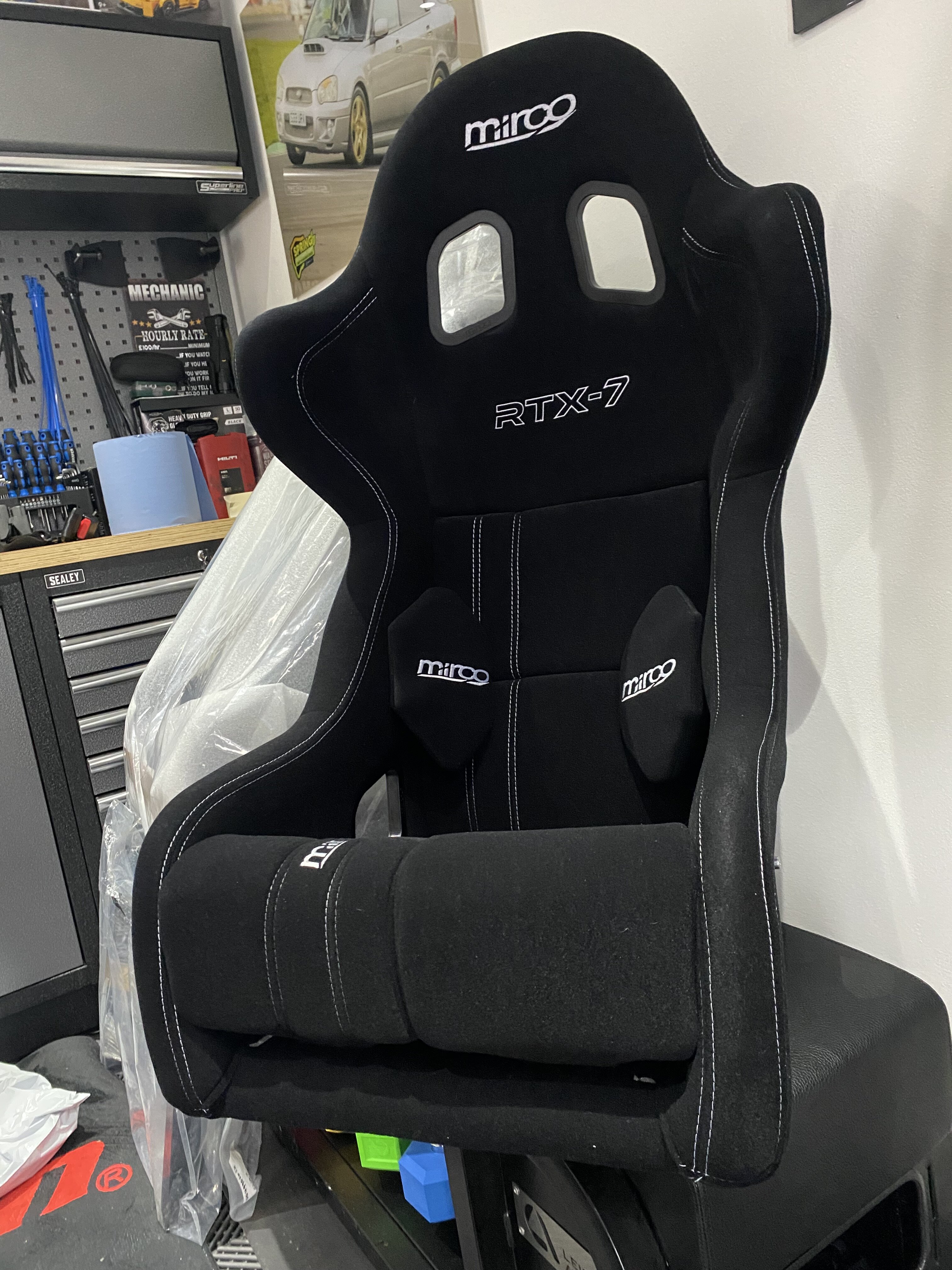

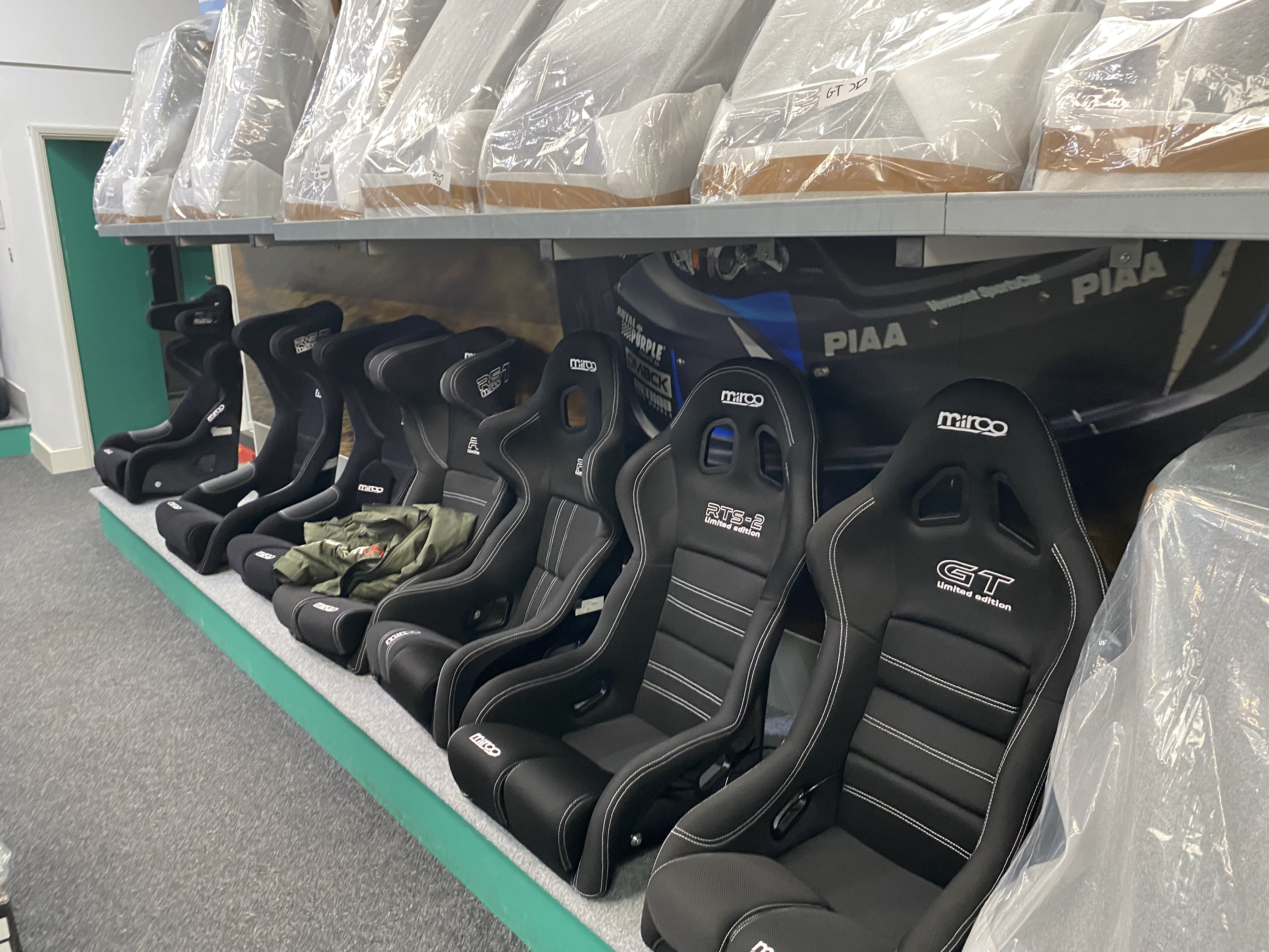

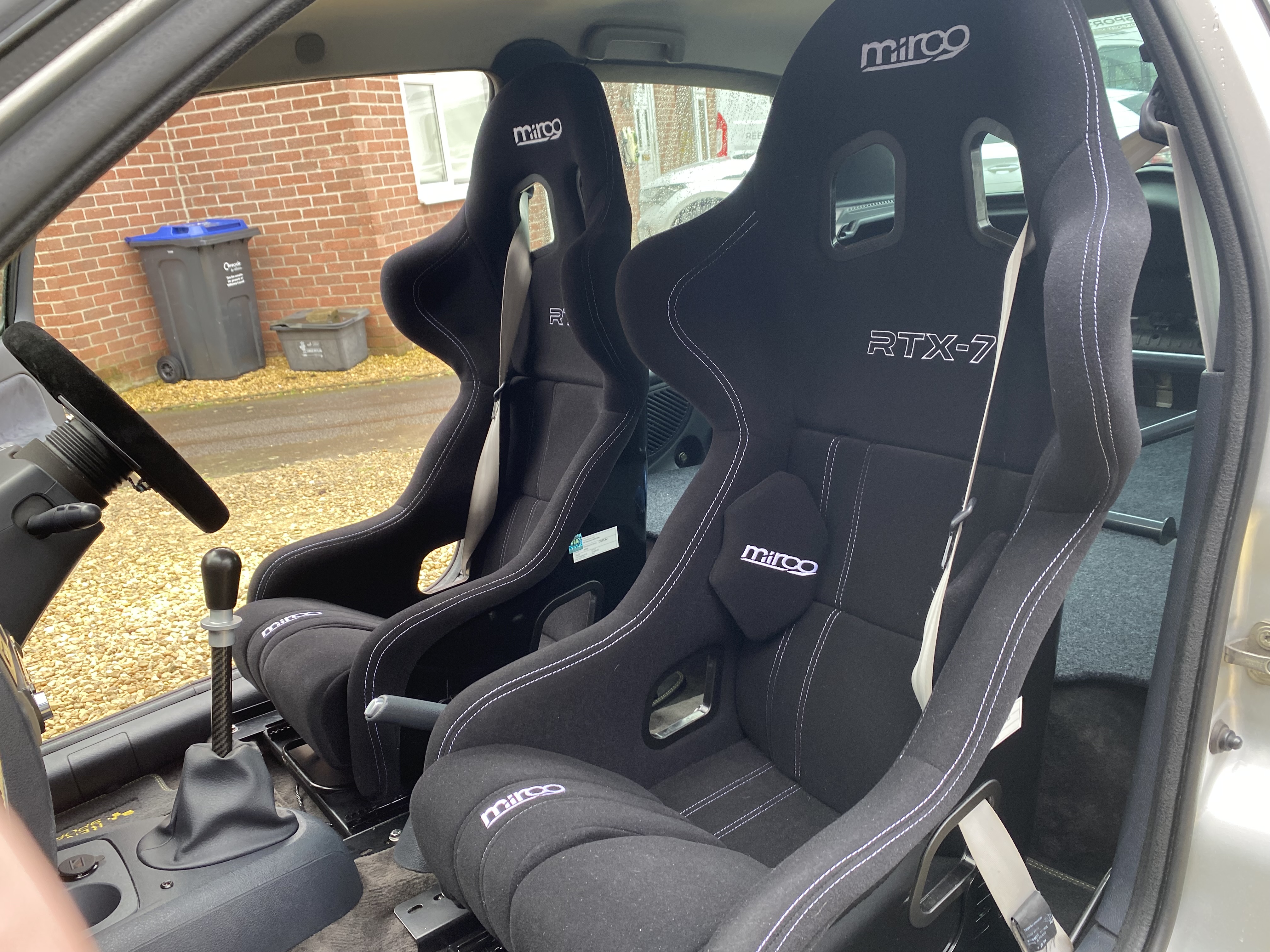

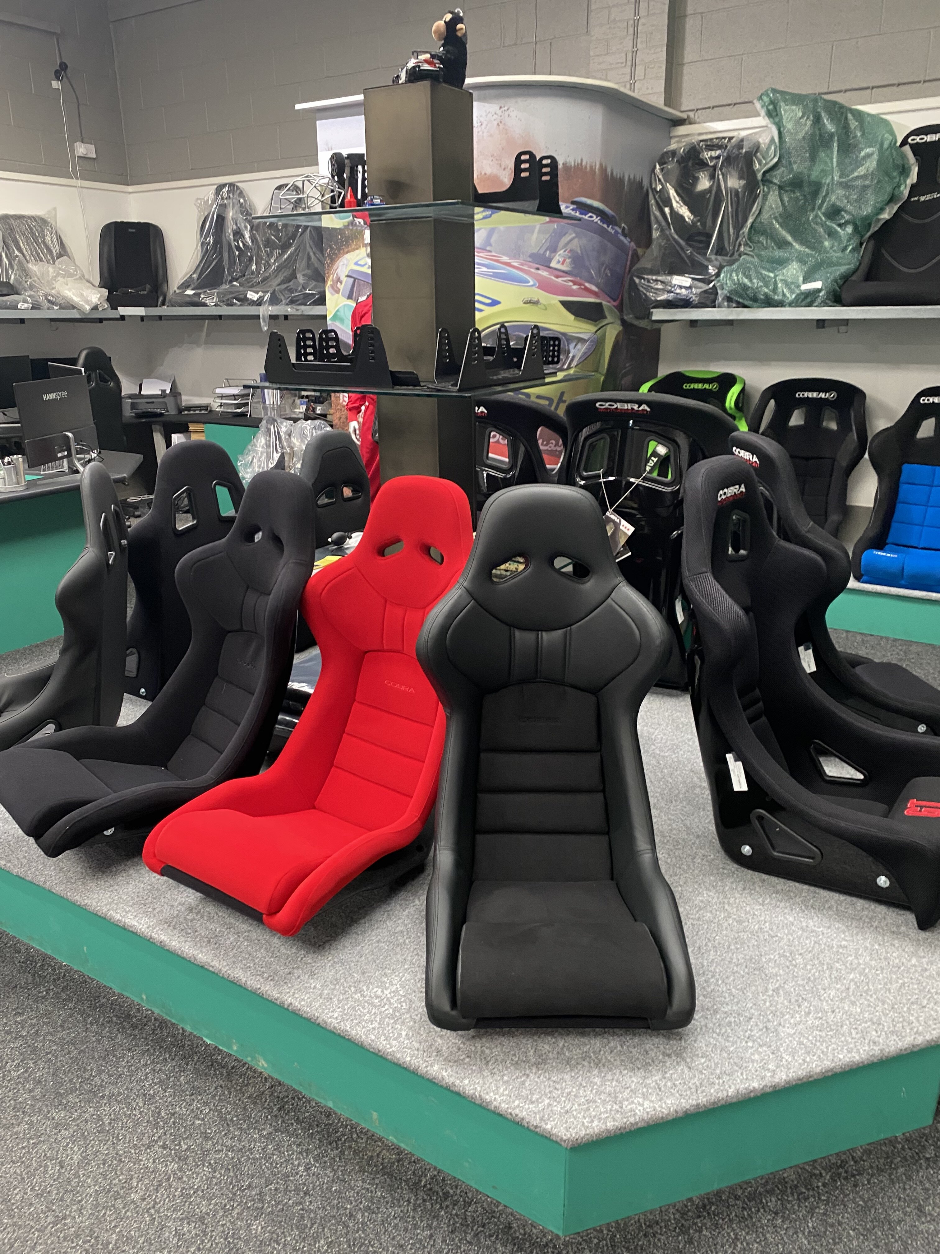

Mirco was not a brand that I have seen much of or would have seriously considered but these velour RTX-7’s really did it for me.
In answer to your question they did have both Corbeau Pro and Sparco seats there. One word of warming with Corbeau seats though if you are tall like me, the backs of them do seem to come up a little shorter than the others. I found I few of them where my shoulders would cover the two back harness holes so not ideal in my particular case. Again something I wouldn’t have known without going to try them all first so do feel it was worth the trip.

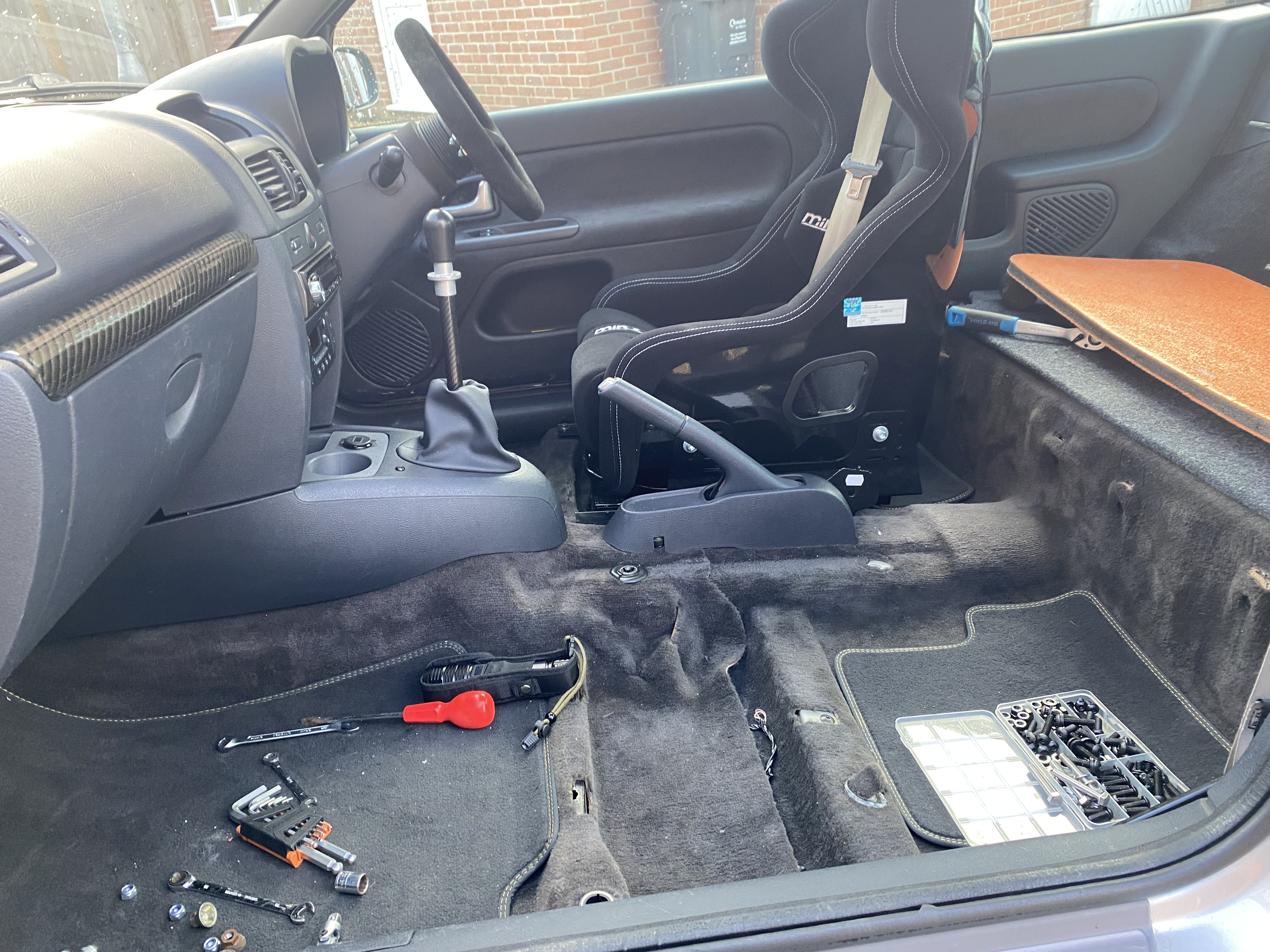

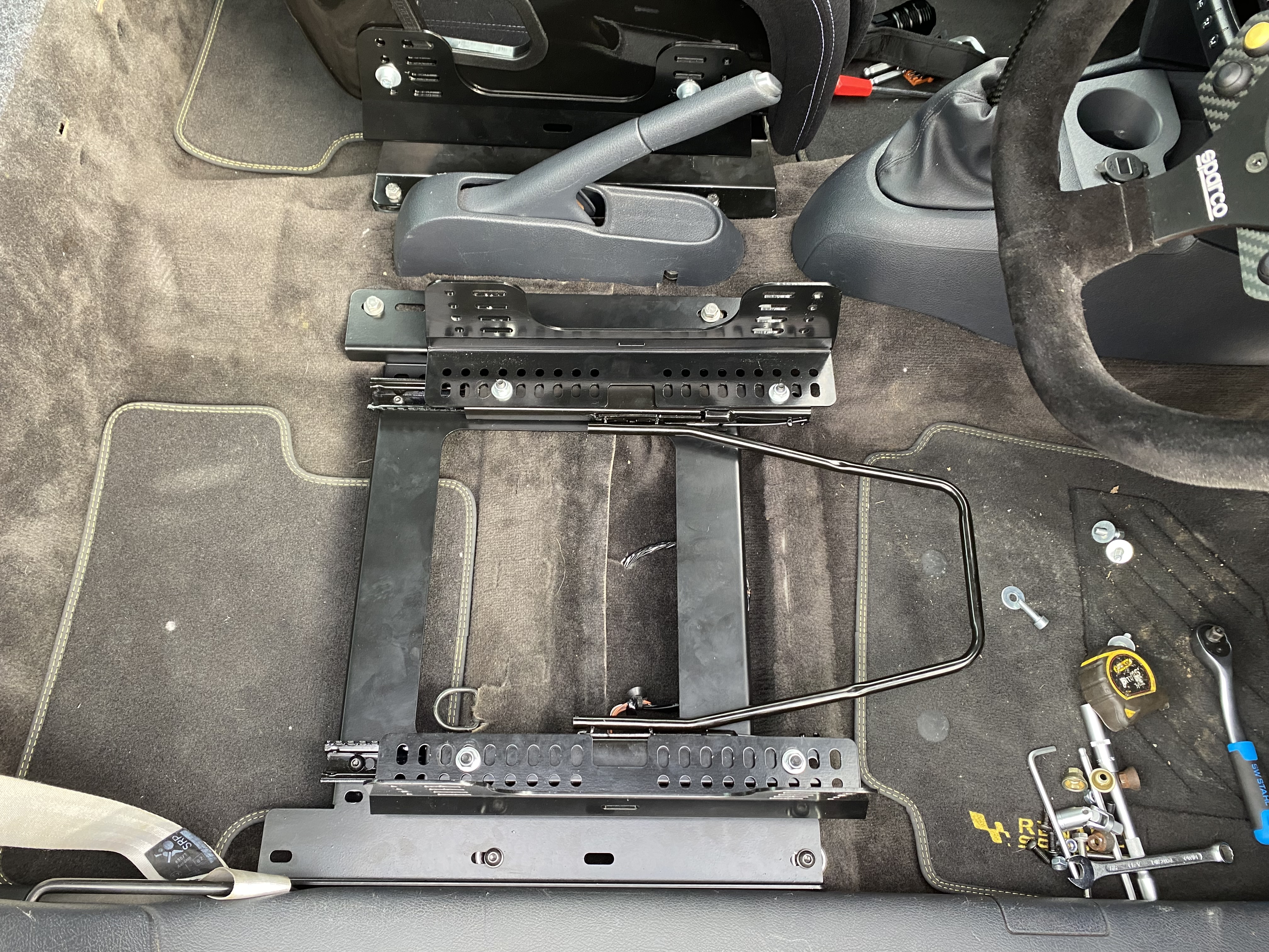

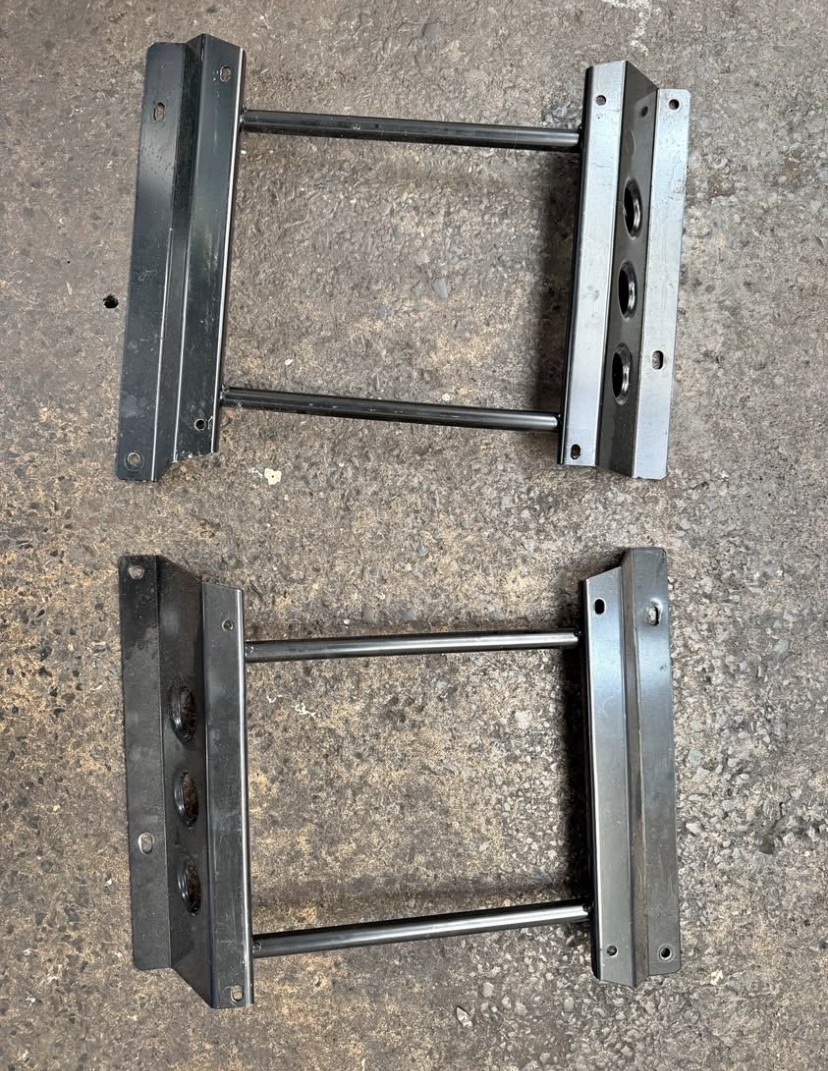

Removing the old seats was pretty straightforward, although why some sadistic French engineer decided they should be bolted from underneath the car is beyond me. Still, quirks like this are part of the joy of old French metal, right?
Fitting the new seats, however, took a few attempts to get them somewhere I was actually happy with. The Sparco bases supplied by GSM at the time had me sitting like I was driving a bar stool — hilariously high and completely useless for my needs. After hours of late-night Googling I got in touch with Jon Fossard, who makes the VBD X-Low subframes. Absolute gent — sorted me out in no time.
Cue several evenings of fitting in the dark, between rain showers, questioning my life choices… but they’re now finally in. I’ll grab some daylight photos soon, I promise.

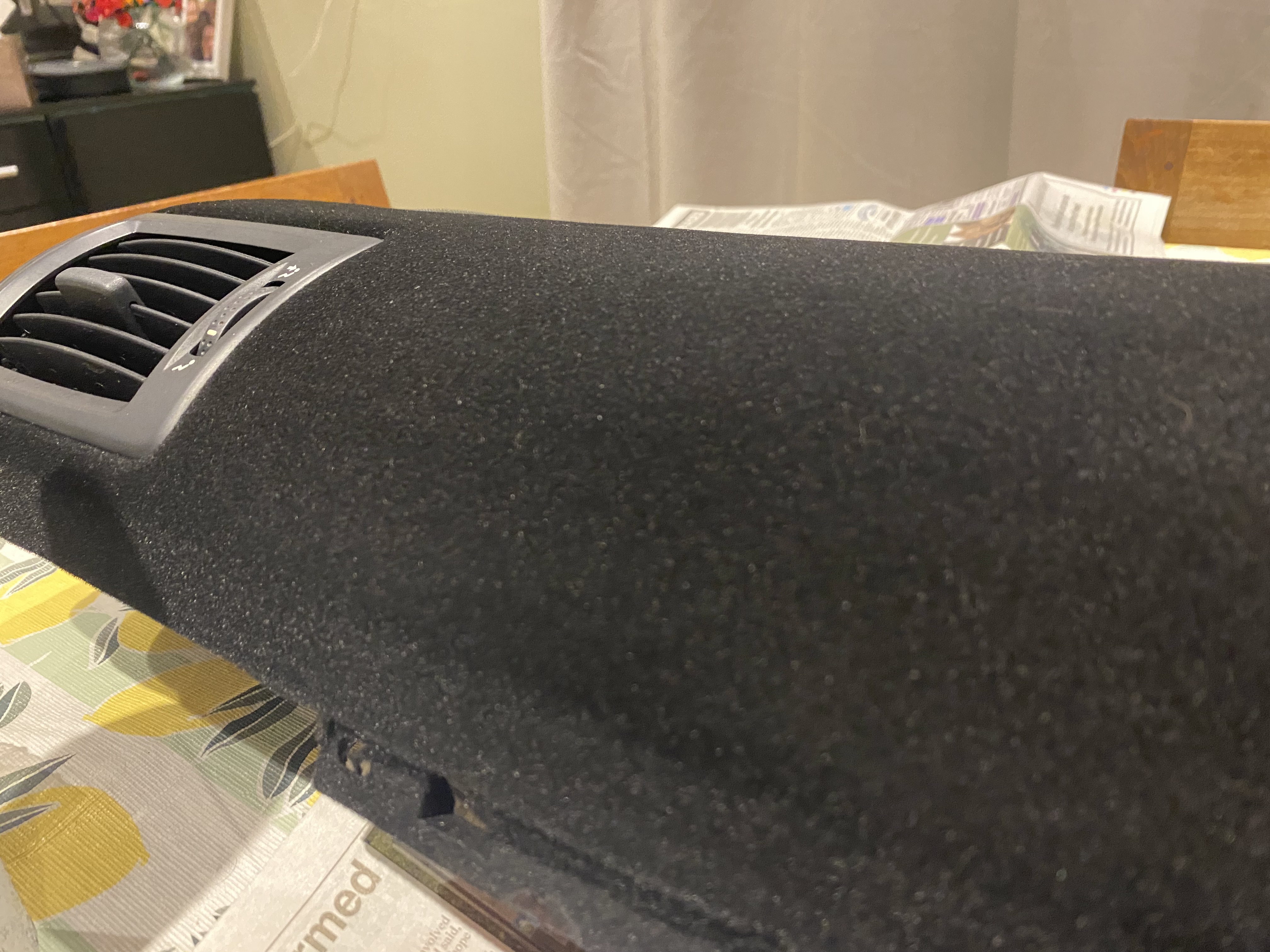

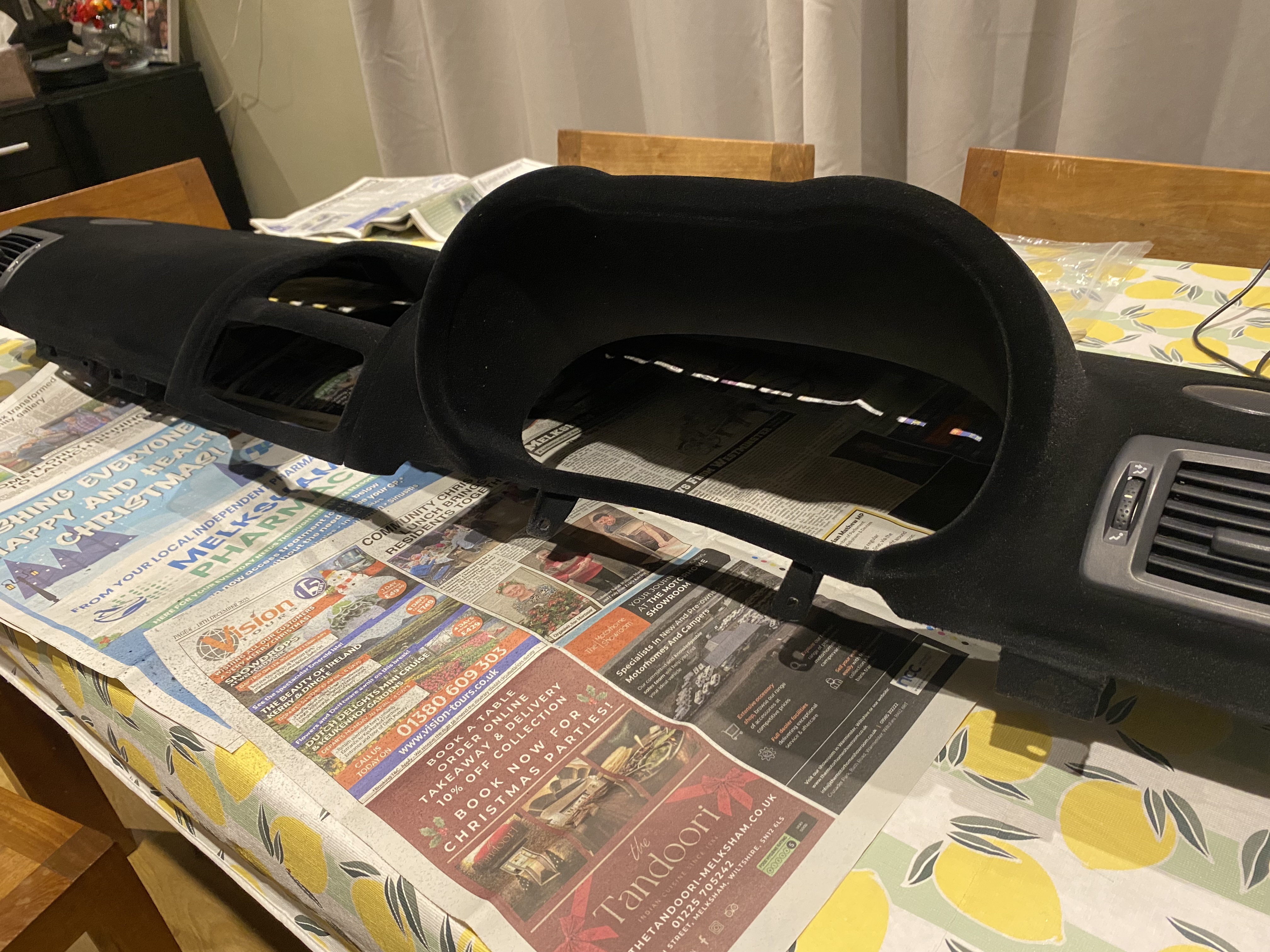

Next up — and this might divide opinion — Dash Flocking.
Why? Three reasons:
  1. Race car.
  2. Let’s be honest, Clio interiors aren’t exactly Bentley-level.
  3. I love the look, and I’ve never done it before — learning new things is half the fun.
Flocking kits are cheap and easy to get hold of; everything I needed came from the imaginatively named Flocking Ltd. After researching the hell out of it, I noticed a lot of people struggle to get a decent finish — and having done it myself, I can see why. There are a few not-so-obvious steps that make all the difference:
  • Prep is everything – Clean, panel wipe, dust-free workspace. Same rules as paint.
  • Warm & dry – Cold or damp conditions will absolutely ruin your day.
  • Sieve the flock – Sounds daft, but if you don’t, it clumps and goes on patchy.
  • Be organised – The adhesive skins over quickly. Once that happens, game over. Have everything ready and move fast, grab a friend to lend a helping hand
Overall, I’m really pleased with the result. It is a slightly terrifying job because if you mess it up, there’s no easy undo button — but dashboards for these aren’t exactly unicorn parts, worst case.
The dash is currently still living on the dining room table (yes, I have a very understanding wife). It’ll be going back in over the next few days, so I’ll get some photos up once it’s fitted and looking like it belongs there.
More updates soon… assuming the weather allows it :-)

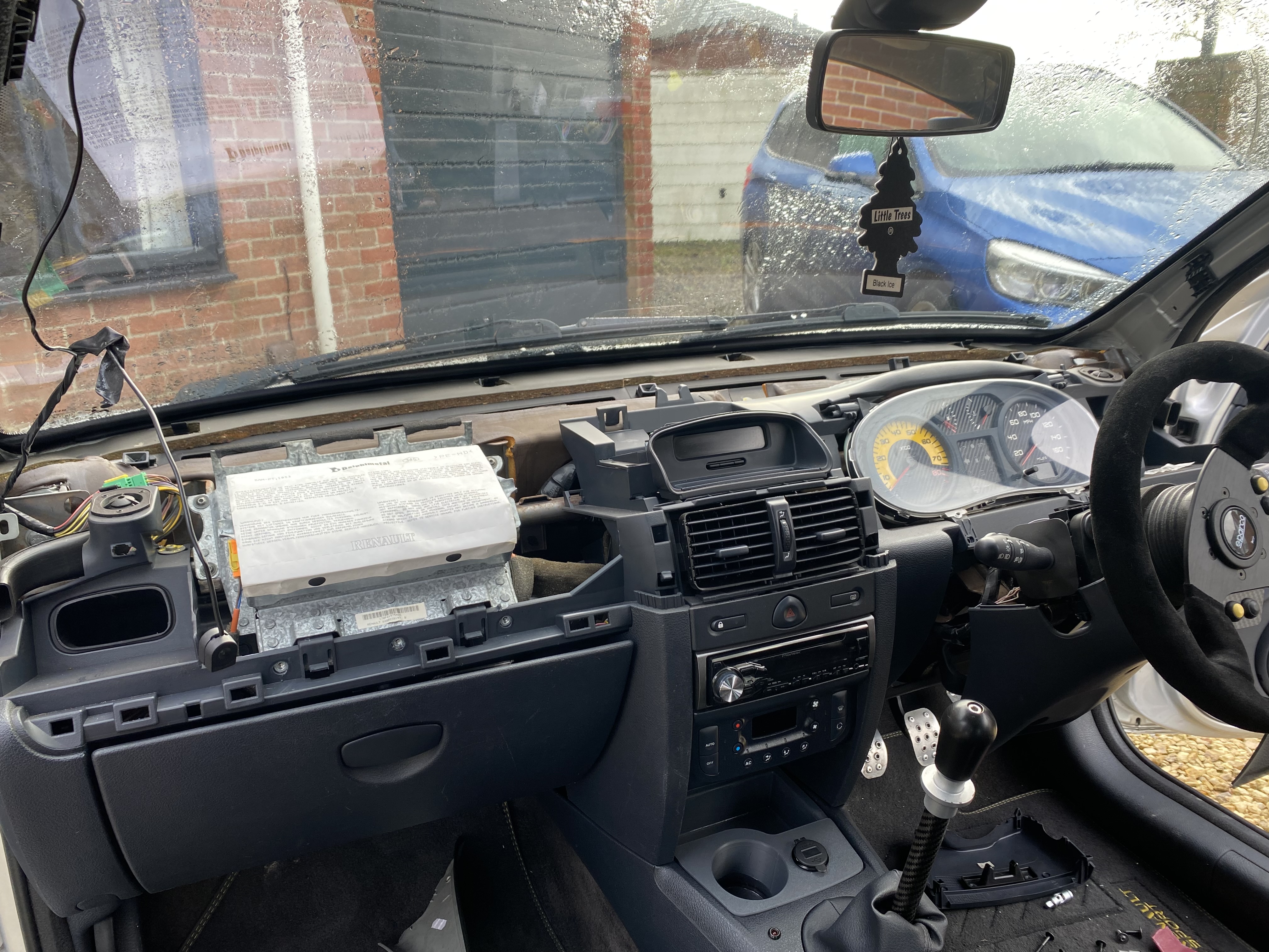

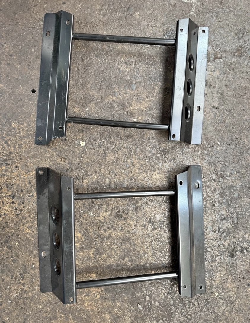

Second set of Jon Foz lowered subframes that car has had! Still gutted some whopper sold the seats out of that car!
BTW it should still have the lowered steering column which works well with the seats subframes
The Jon Foz frames are definitely the way to go, the Sparco ones had the seats sat in a ridiculously high position.
As it stands currently I could go a little lower on the side frames but I’ll live with it of a while and see how I get on. I need to remember that I’m fat and old now, getting in and out of this thing now isn’t a particulary glamorous affair 😂

Today I once more said "I don't care if it's raining or not today is going to be the day" So after much huffing and puffing and complaining about the weather, there was a very breakfast break in the weather so I set too it - fitting the dashboard was actually remarkably straightforward. I know. I’m as shocked as you are.
Before it ever made it back into the car though, the dashboard spent over a week proudly sat on my dining room table, serving as a centrepiece that absolutely no one asked for. It did give me plenty of time to admire the flocking — which looks spot on. Zero glare, proper motorsport vibes, and a massive upgrade over the standard shiny plastic.
I’m pleased to report that the dash has now vacated the dining room and the wife is once again able to eat at the table, restoring peace to the household and significantly improving my long-term survival prospects.
The flocked dashboard went back in with far less drama than anticipated. No wrestling, no mysterious leftover fixings, no existential crisis halfway through. It almost felt suspiciously easy — like the car was lulling me into a false sense of security for future jobs.
While the interior was still in bits, I also took the chance to finalise the fitment of the new seats. A bit of fine-tuning with the rails, a lot of sitting in the car making sure everything felt right, and they’re now spot on, seating position is good, and holds me in place incredibly well.
With everything back together, the cabin feels completely transformed. Between the flocked dash and the buckets, it’s gone from “quick Clio” to something that feels genuinely purposeful and track-focused. One of those upgrades that makes the whole car feel special every time you open the door.
As always, it’s never truly finished — but for now I’m calling this a successful chapter. Dash fitted, buckets sorted, dining table returned to normal service.

I have the same Jon Fos seat mounts and I have to have my Sparcos on the highest side mount option, there’s no way to get the bolts in underneath the rear of the seat otherwise. And I don’t want them lower at the front.

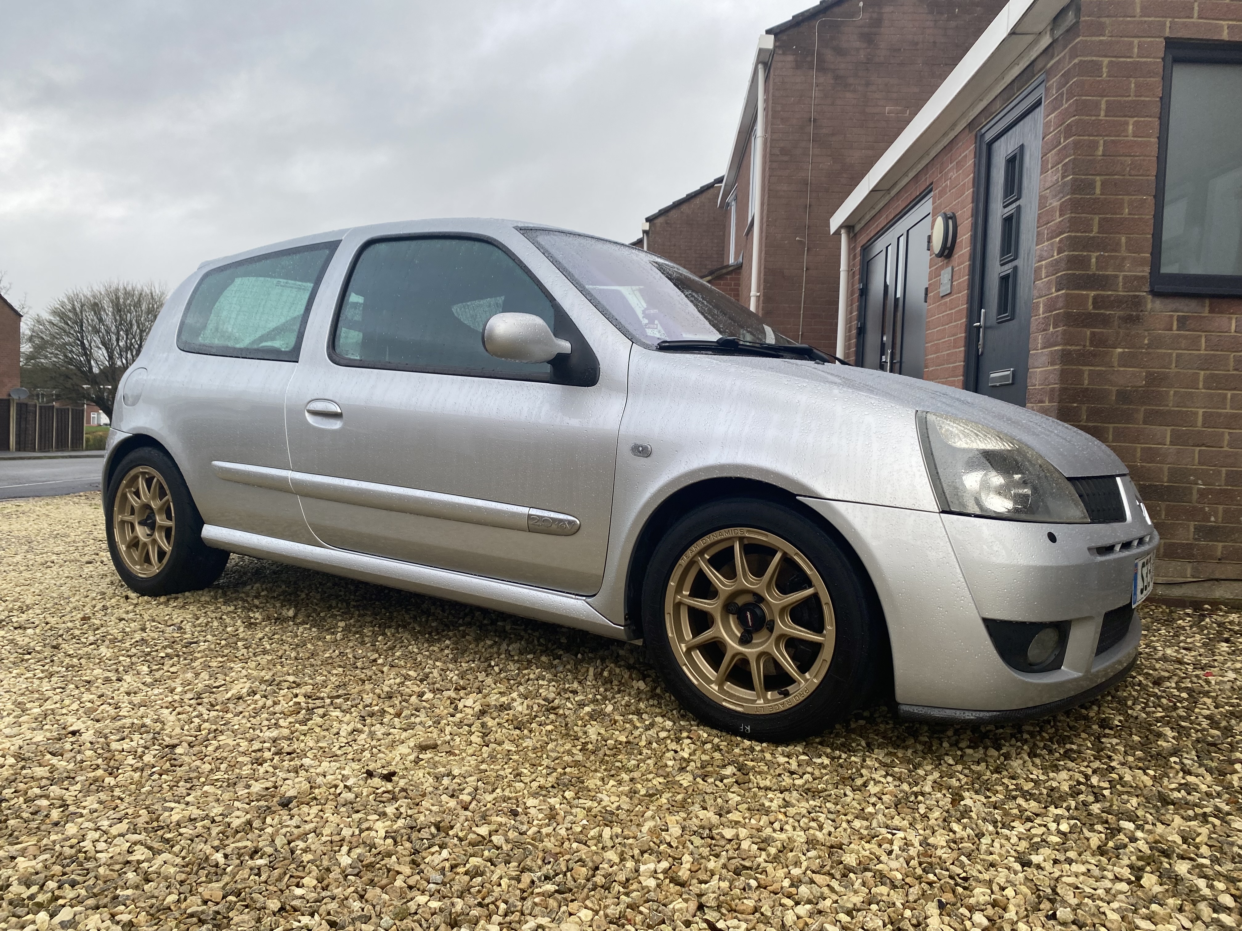

A couple of small but satisfying updates over the last week. Sadly I haven’t managed to grab any proper internet-worthy photos yet, but I’m really pleased with the progress being made — so, what have I been up to?
First up… wheels!
After previously falling hard for my old Scooby colour scheme, and now finding myself the owner of a Titanium Clio, gold wheels were pretty much inevitable. I know it won’t be everyone’s cup of tea, but I’m a big fan — it gives the Titanium a bit of much-needed spice and lifts what can otherwise be a fairly subtle colour. Sometimes you’ve just got to build the car for yourself.

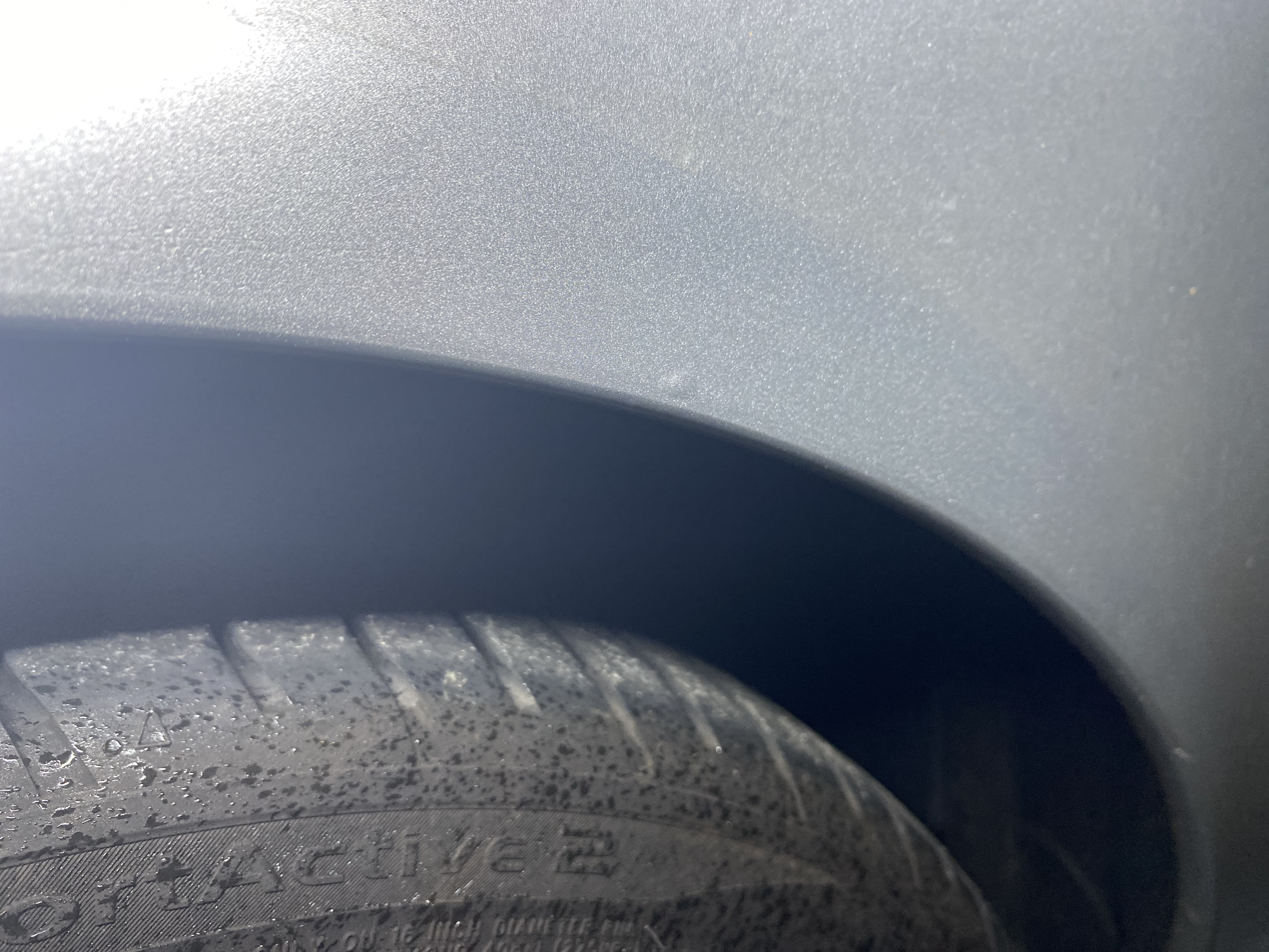

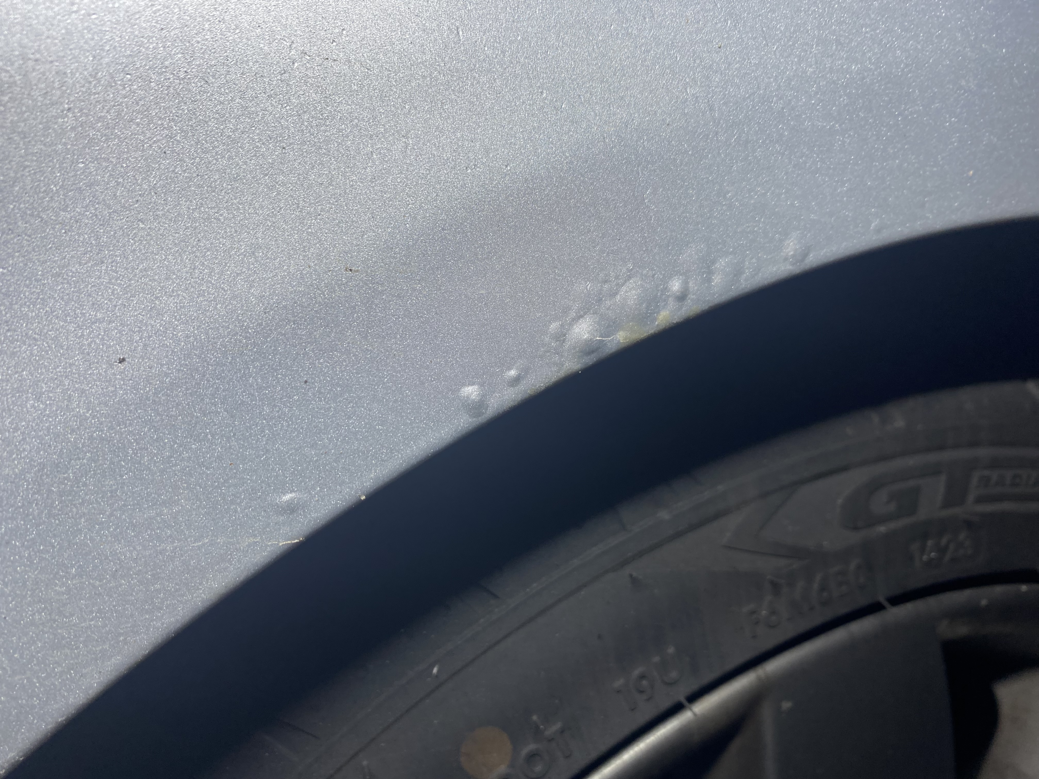

Next on the list was a small but annoying issue with the rear arches. A couple of very minor paint bubbles had started to appear, and once I’d seen them… well, that was that. Not something I could ignore long-term, and definitely one of the few jobs I won’t attempt myself. My trusted local paint guy popped over, prepped and painted both sides, and I have to say he’s done a cracking job — you’d never know there was an issue there in the first place.
Lastly, and continuing my slow mission to make the interior feel a little more premium, I swapped out the gearstick for an Alcantara replacement. While doing so I did uncover a slightly nasty surprise left behind by a previous owner… but nothing terminal. The gaiter retaining ring clips are well known for being made of cheese, hopes and dreams, so if it’s holding together and doing its job, I’m calling that a win.
As soon as the weather decides to play ball and we get a bit of sunshine, I’ll get out and grab some proper photos so it can be appreciated in all its glory for anyone that still following ☀️🚗
