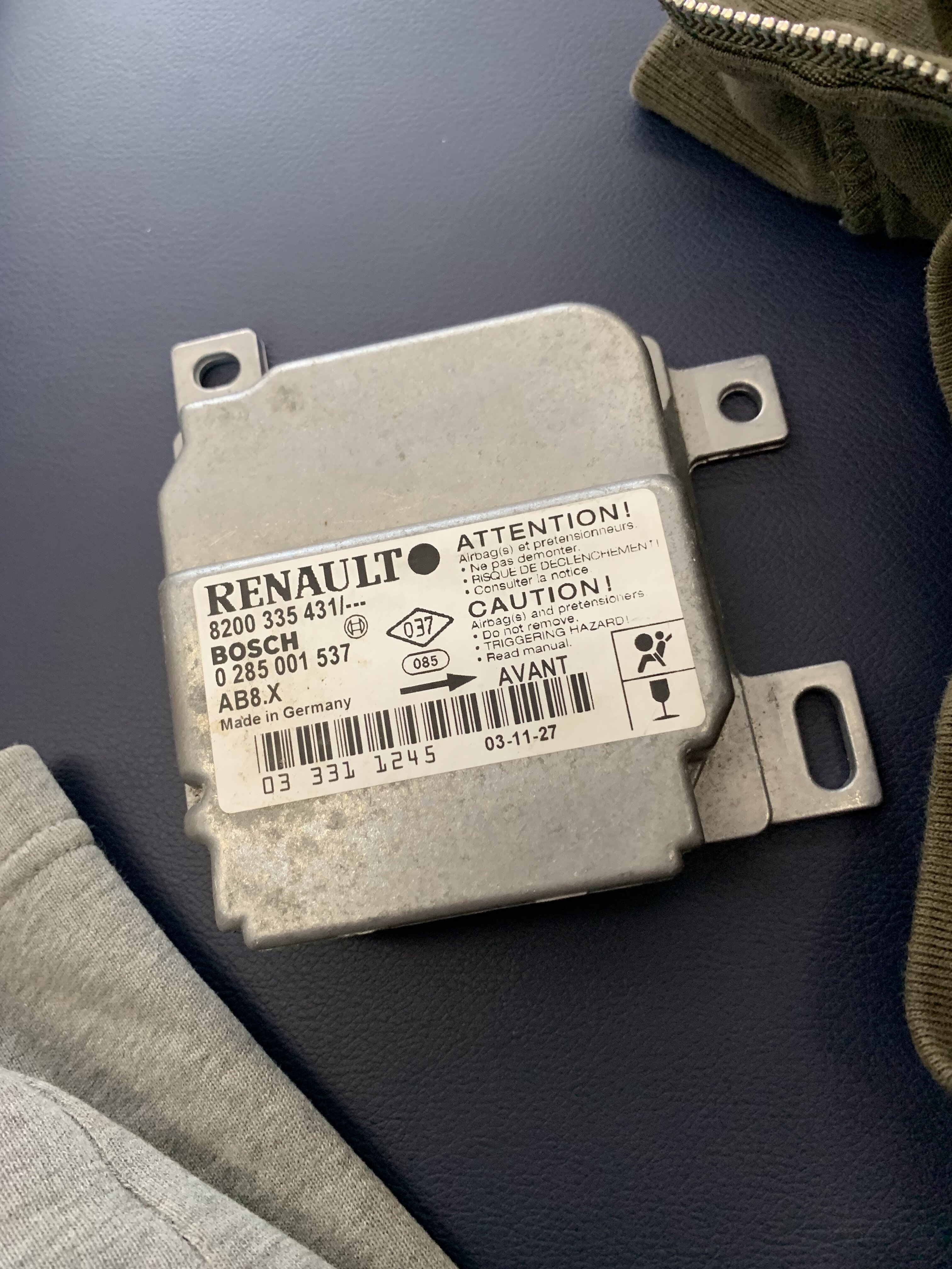

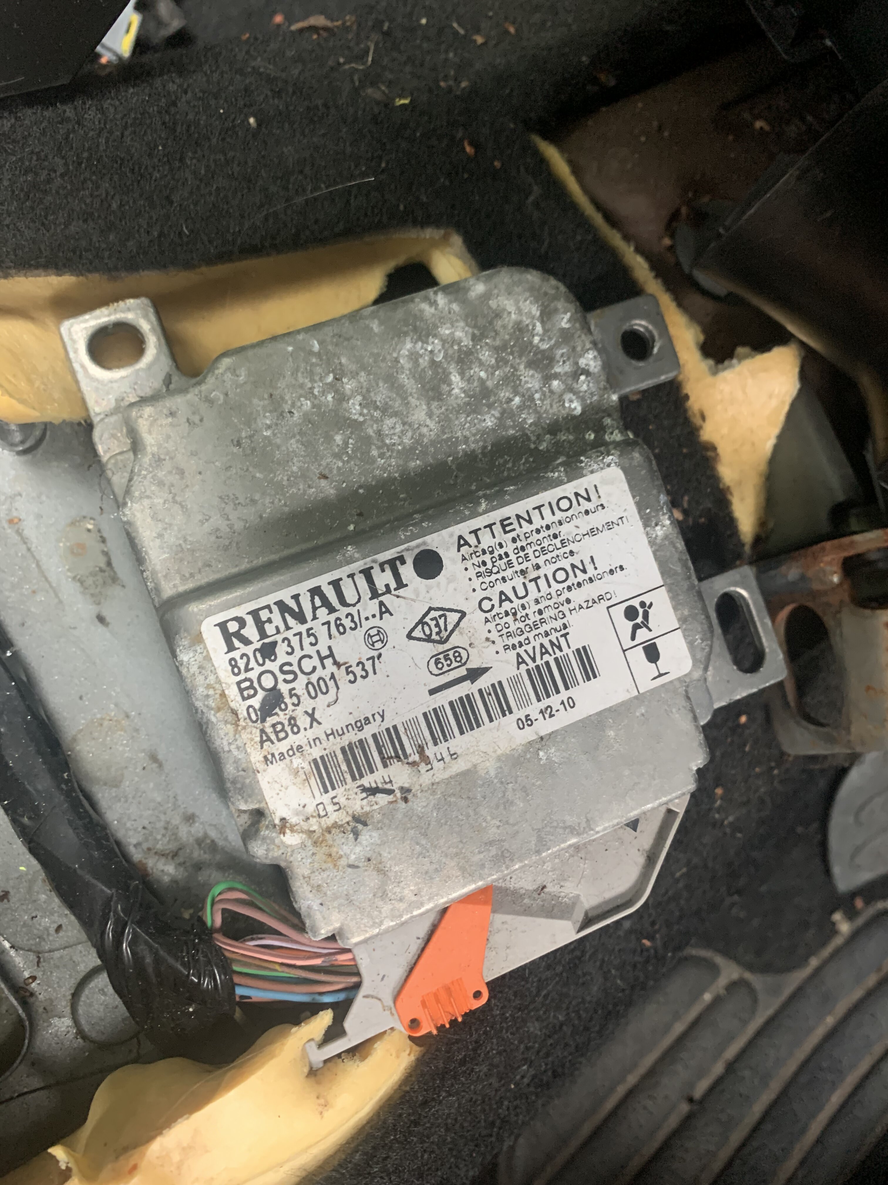

Hi all,
Got a persistent airbag light on my ‘06 Campus Sport despite fiddling/bypassing connectors, replacing passenger sensor etc.
Now bought a replacement clock spring and also this airbag ecu off a 2003 5dr automatic Clío (maybe Privilege model) in the scrappy.
Does anyone know if this new ecu will fit my car? Or will it pop the airbags… I’m scared honestly!
I’m thinking the difference might lie in the new ecu being made for seat airbags (that ‘03 model seemed quite posh but I forgot to check).
The first pic will be my original ecu and the second, the new one.
Thanks all,
Danny

*the first pic is ‘new’ ecu off the ‘03 Privilege from the scrappy and second is my original (‘06 Campus Sport)
I'm sure all mk2 airbag ECUs are functionally the same, but just programmed for the airbags present in each car. I highly doubt it'll set any airbags off, but in the event of a crash, if your car has an airbag the scrappy car didn't it probably won't go off. If the opposite, you'll probably get an airbag light on the dash.
Nice one! Thanks mate. I’ll plug it in tonight and post the results.
Swapped the airbag ecu and nothing exciting happened, the airbag light still came on but I found my fault— the driver’s side sensor (under seat, by door) had oxidised pins so presume some liquid spilled onto that… I cleaned the plug with contact cleaner and swapped it out for the old passenger’s side one (as that was spare after getting another sensor off a different scrapped car).

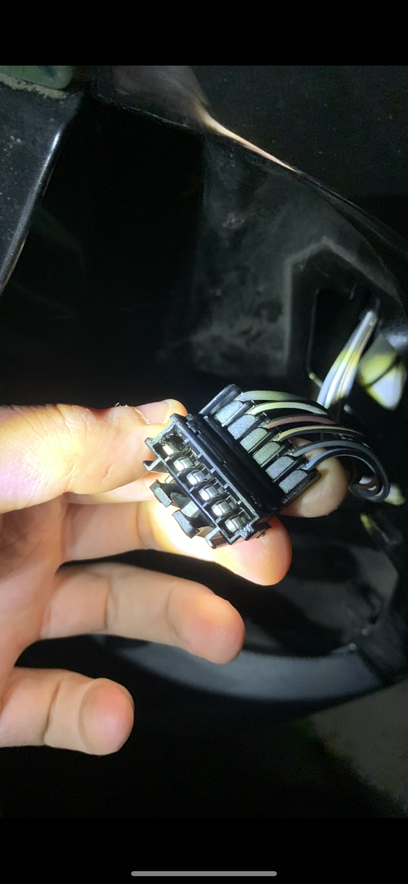

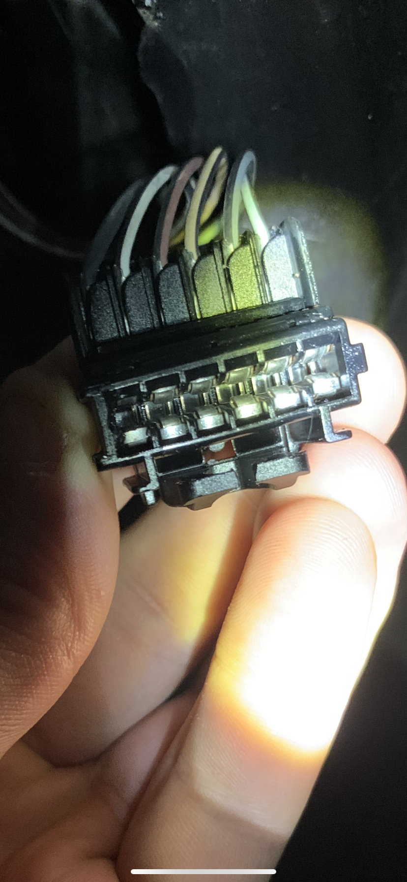

Do you mean the plugs to the bulb holders? I’ve cleaned them a few times and there’s no rust/corrosion but the pins associated with the brake/fog lights (same bulb?) have plastic slightly melted around them and the top contact seems more tucked away than the other pins.
I’ve put 2 pics there, apologies for the quality it’s dark out.
Seems too much current is flowing out that pathway to earth?
For me both times it was just a bit of light corrosion on one of the pins on that connector. That slightly melted one seems very suspicious, plus like you say it does seem bent weirdly. Most likely culprit IMO.

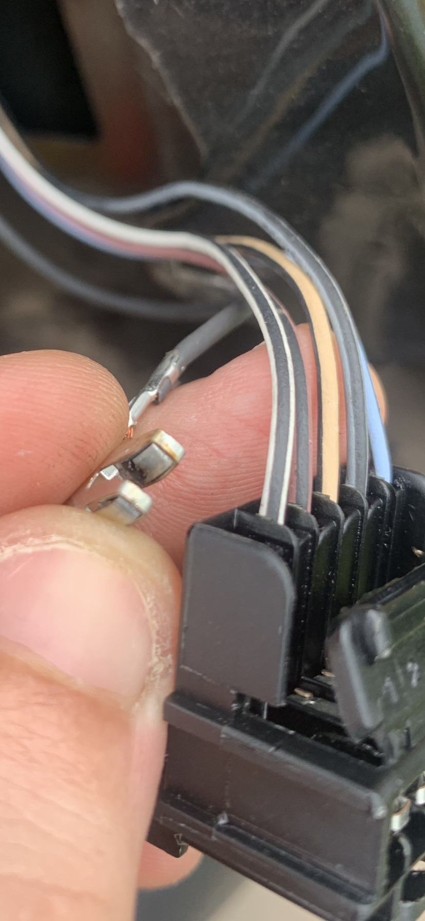

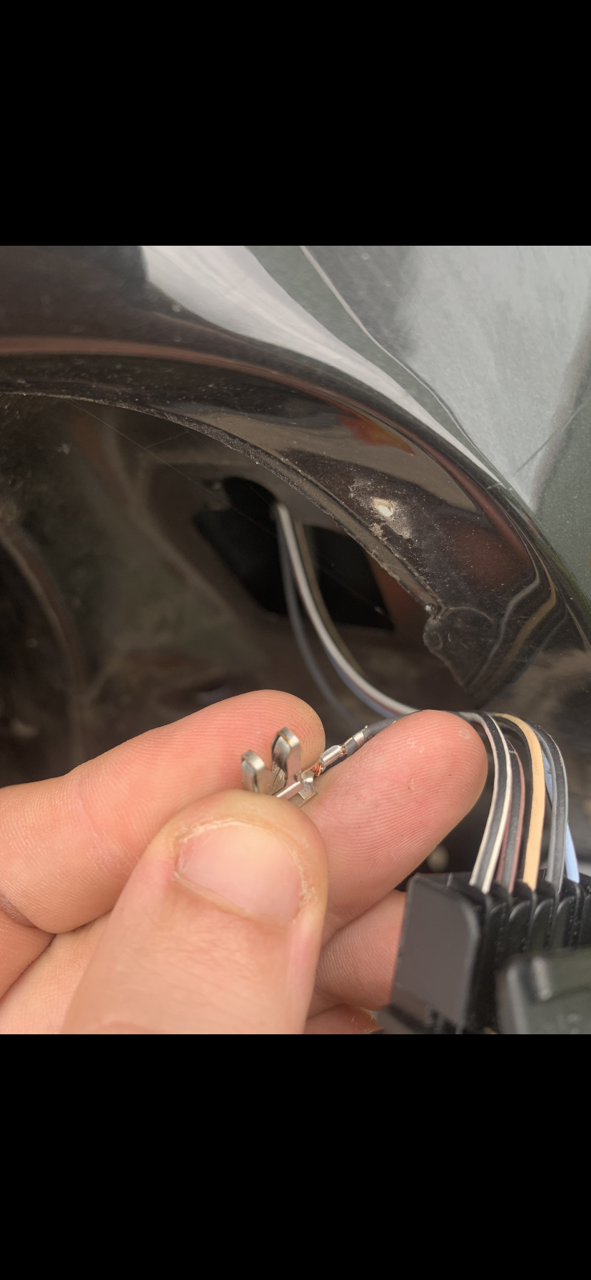

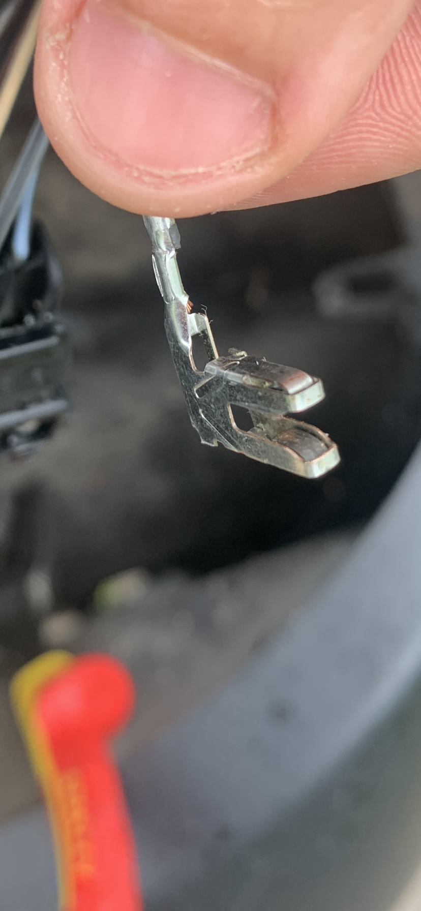

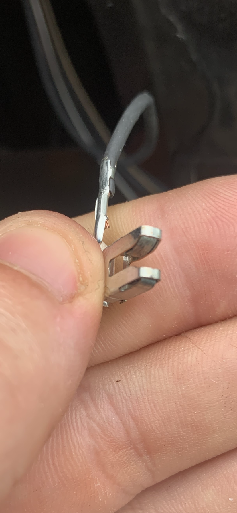

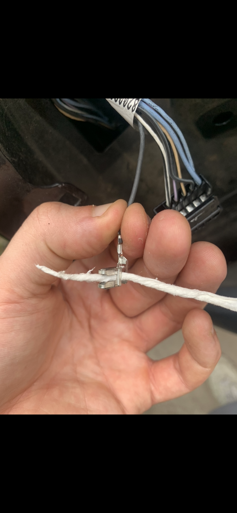

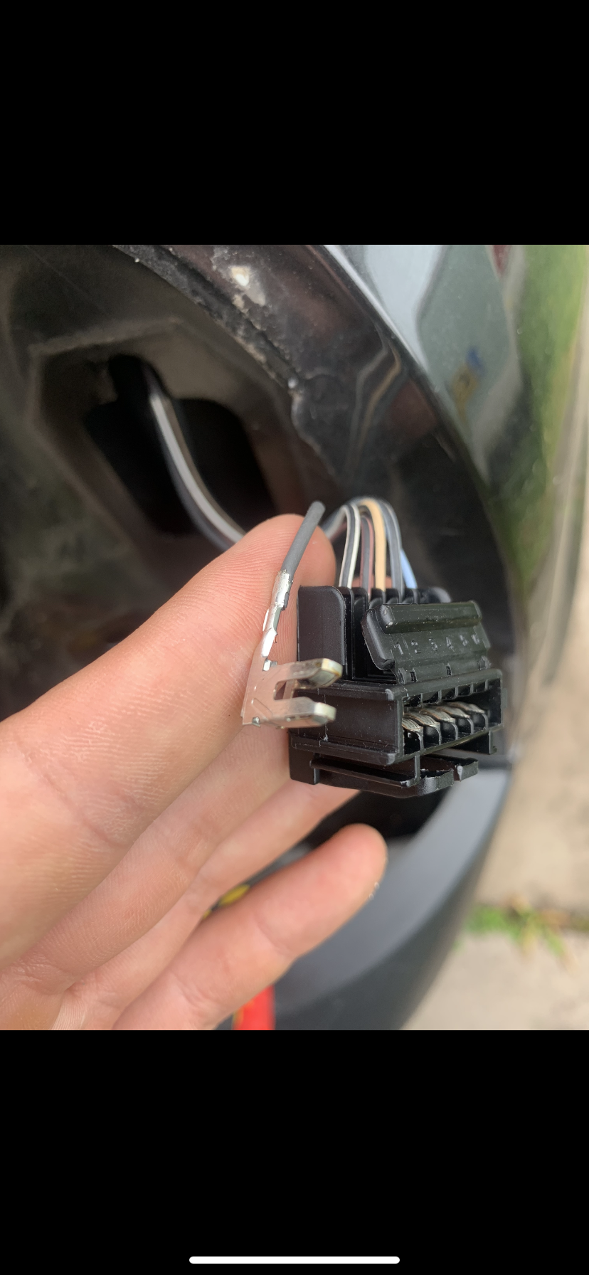

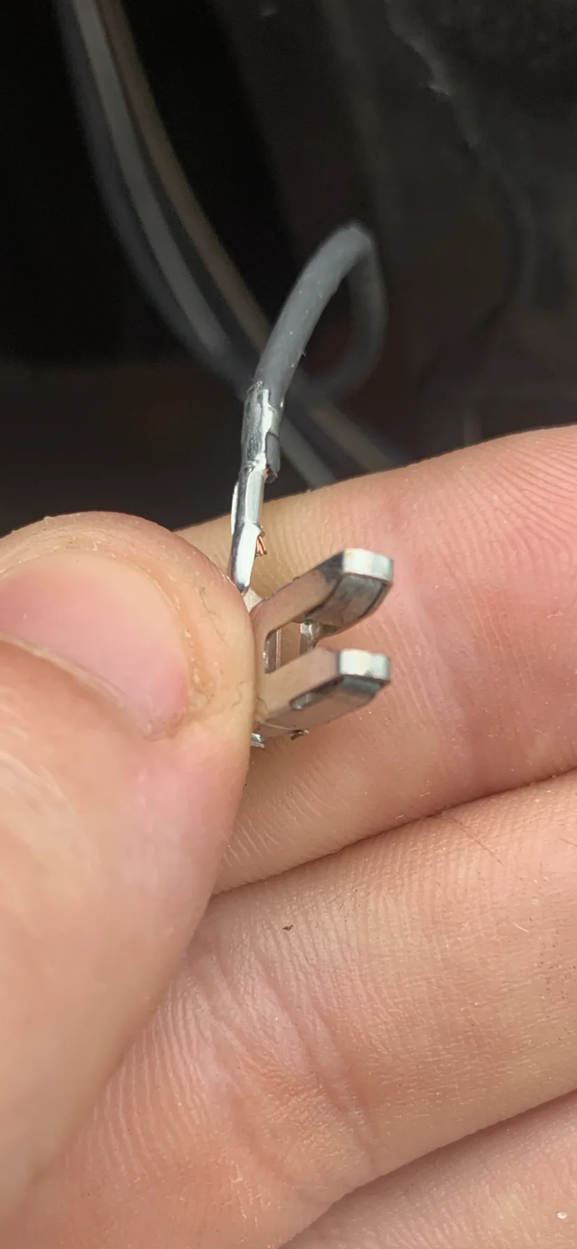

All sorted!!
Bodged the connector out the plug using the guide above (small flat head) then just scraped out burnt stuff with a flat head, sanded with 240 grit, cleaned with some WD40 and wiped with rolled up kitchen roll lol.
Thanks both of you for your help, last day for MOT retest is tomorrow so over the moon!
Just flushing the brakes out now before putting the wheels back on and she’s good.
Ecstatic. Thanks again!
Danny
(Hard to see the burnt contacts before cleaning in the photos but it was definitely there… pinching myself it actually worked)

All sorted!!
Danny
Forgot to say, I squashed the connector jaws together a little with a pair of combi pliers— they twisted a bit but bodged back into the plug just fine with a bit of force
