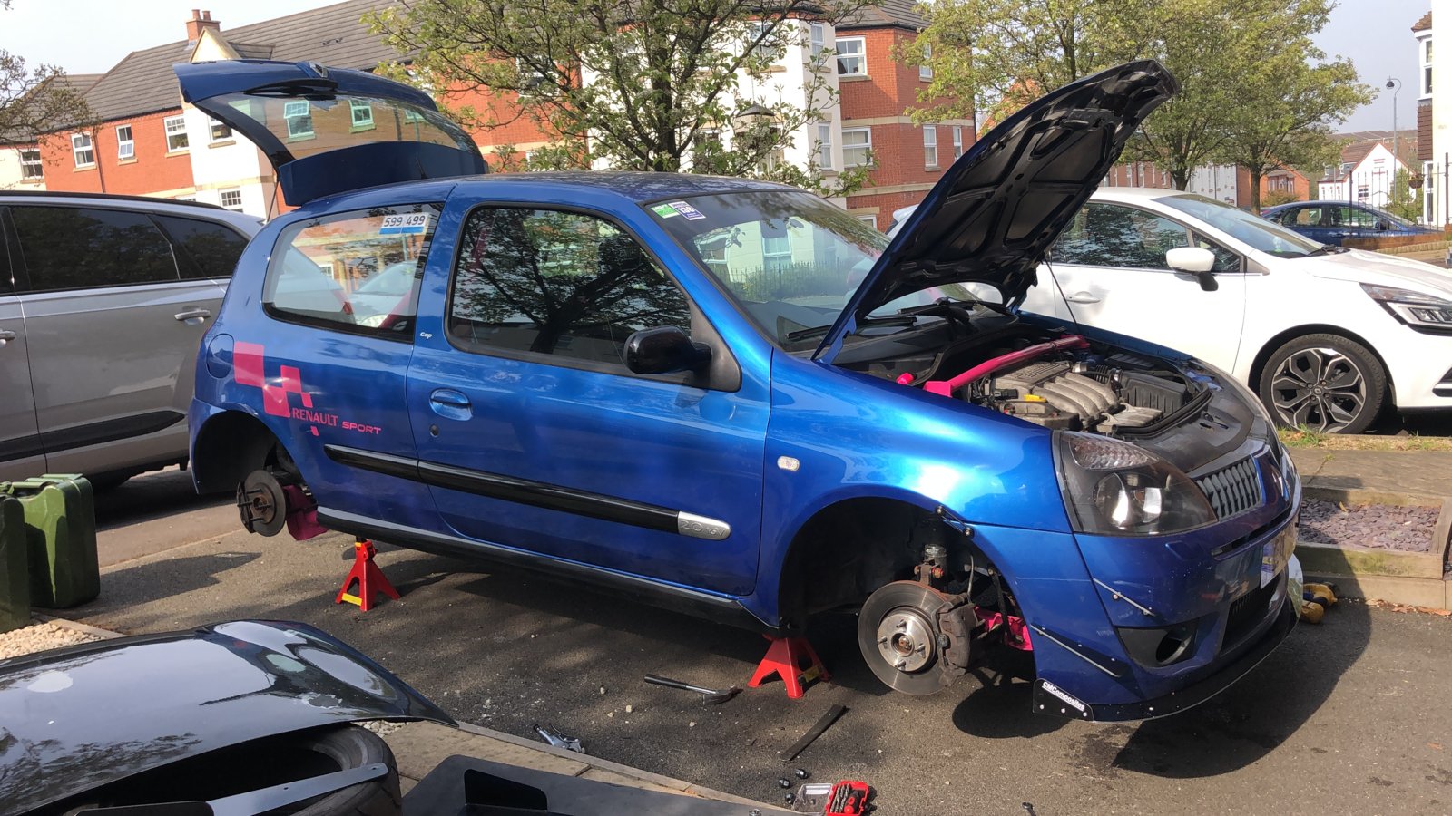

What I tend to do is whip the front bumper off first then drive the car up my car ramps. I then jack the rear up in the centre of the rear beam as high as my jack will go and place 2 axels stands under each side of the beam. I then place a piece of wood under the subframe just underneath by the wishbones and jack each side up at a time and place an axel stand just at the triple bracket on the chassis rail and take away the car ramps. As said just keep an eye on the rear stands as you are jacking the front. I also find placing my spare wheels in the boot helps with equalising the weight of the car cause it can be nose heavy. Depending on how high you want to go then I have used old paving slabs under the jack to get the front higher. The bumper is on in this picture cause I was test fitting the splitter
