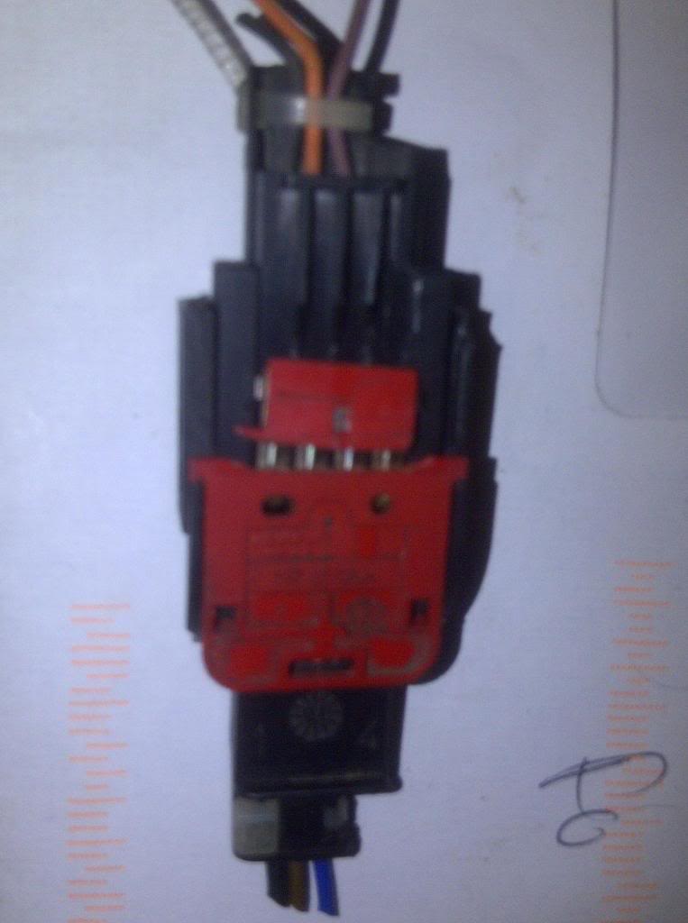

One thing which has me beat so far though is the serv/airbag light. Following the masses of info on this forum and elsewhere. I chopped the plug off under the drivers seat and soldered the wires. Closer reading of the forum posts and some youtube videos and I realised, the wires from the grey plugs had allready been cut and soldered (well) so the wires I did were the drivers seat airbag wires (a black plug with a red plastic locking gizmo in it) three wires comming from each side of the plug. I soldered them exactly as the came from the black plug Through the plug it goes black brown and blue one side, greyishblack orange and purpleishbrown the other side
so the connections are starting on the purpleishbrown orange greyishblack side: purpleishbrown to blue. orange to brown and greyishblack to black. Hope this makes sense. I took the car to a friends garage where he has a clip diagnostic set up. He cleared the airbag ECU which was showing lots of historic faults and reset it. the serv/airbag light came straight back on with drivers seat airbag short circuit as the only fault.
A few questions: Can anyone throw any light on this one? is there another plug from the bag igniter to the seat loom which could be causing the short. The car was full of water from the sunroof and airial leak so is it more likely to be the ECU faulty? There is no short in any of the wires which have been soldered, they've all been done quite throughly (Renault dealer at a guess)

Seems the problem was the wet interior from the leaking sunroof. Since curing the leak, the car has dried out and the airbag light has gone out. Glow plug light has come on though and is staying on. I've fitted new plugs which made no difference, checked the old plugs; all four working. glow plug relay is cycling correctly. I now have an ELM 326 which seems to connect ok to the engine ECU so I will see what it says. Car is running fine though. Perhaps a little hesitant to fire up but then it is wicked cold!

The damp can get in at multiple places and cause problems not just under the seats. It is also pretty common for the line to the pre-tensioner unit itself to need replacing after a deployment and the result of not changing the wires is an open or short circuit... not that I'm saying your car had had a deployment at some point but it may be worth checking the vin numbers match in the various systems.
Finding a general code reader that can do what you want will be difficult as they just don't exist. The RSTuner can, with the purchase of the additional srs module, can indeed read/clear/configure it but I've never used it so can't really give you any advice. Then there's a CLIP clone from Ebay; I don't normally advise the purchase of these as some are better than others but if you're not planning on any serious config work it'll do you right.

I have a similar problem with this plug. I'm pretty sure when I had the seat out I may have broke it. Can the wires be joined by using spade connectors? Or is there something inside the plug that's crucial?
if I got another plug and swooped them over would that work?

The sunnroof leaked on my lad's clio, it was the side impact sensor that was faulty-you can't wire them out with a resistor, but they're a tenner posted from ebay!

You need to diagnose the problem before you start throwing money at it-are you any good witha multimeter?
Can be yeah.
I broke the red/black clip when removing my seat. So I'm guessing this is why the light is on
