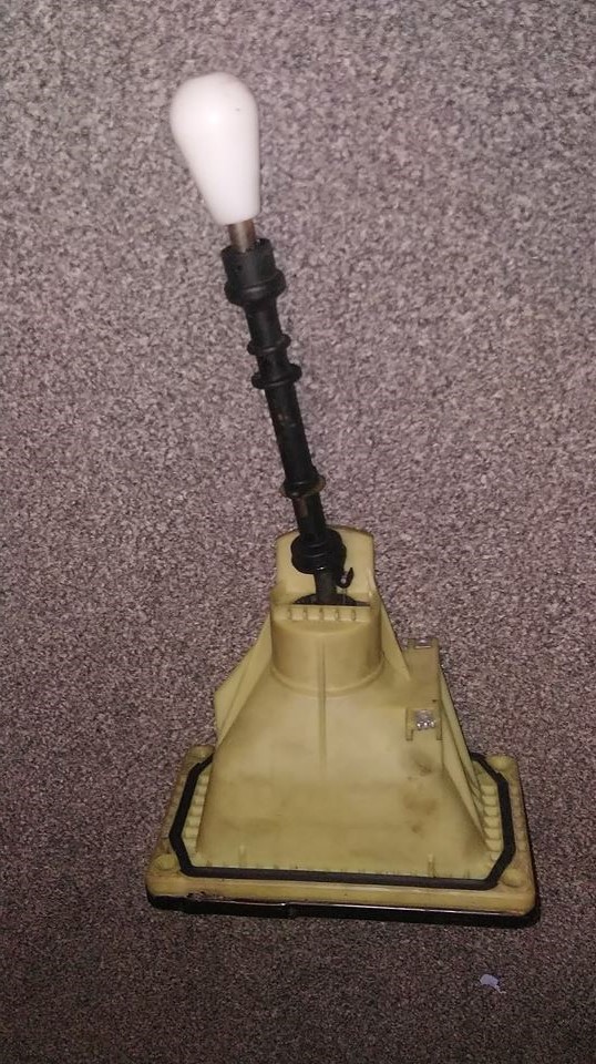

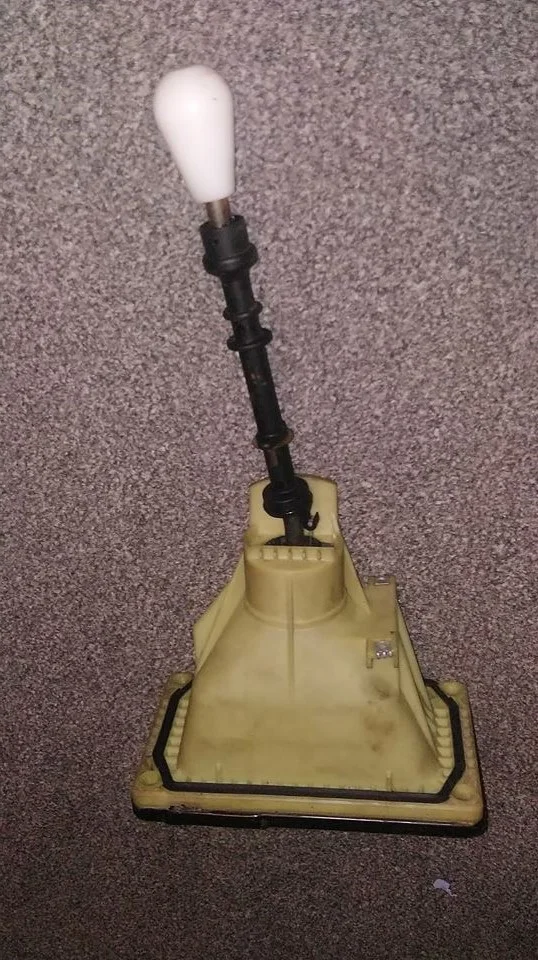

Ive got one thats been extended and has a poly gearknob fitted , not sure if its one of Ash's earlier ones or not.

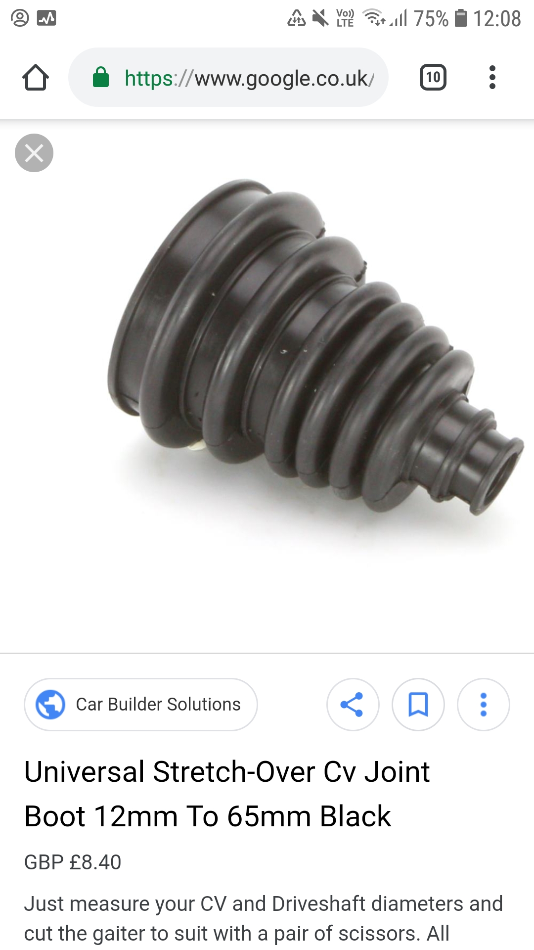

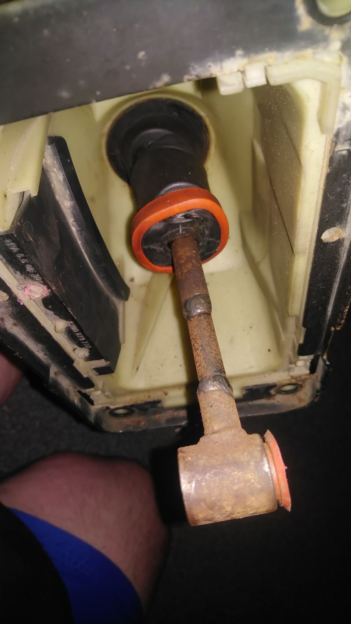

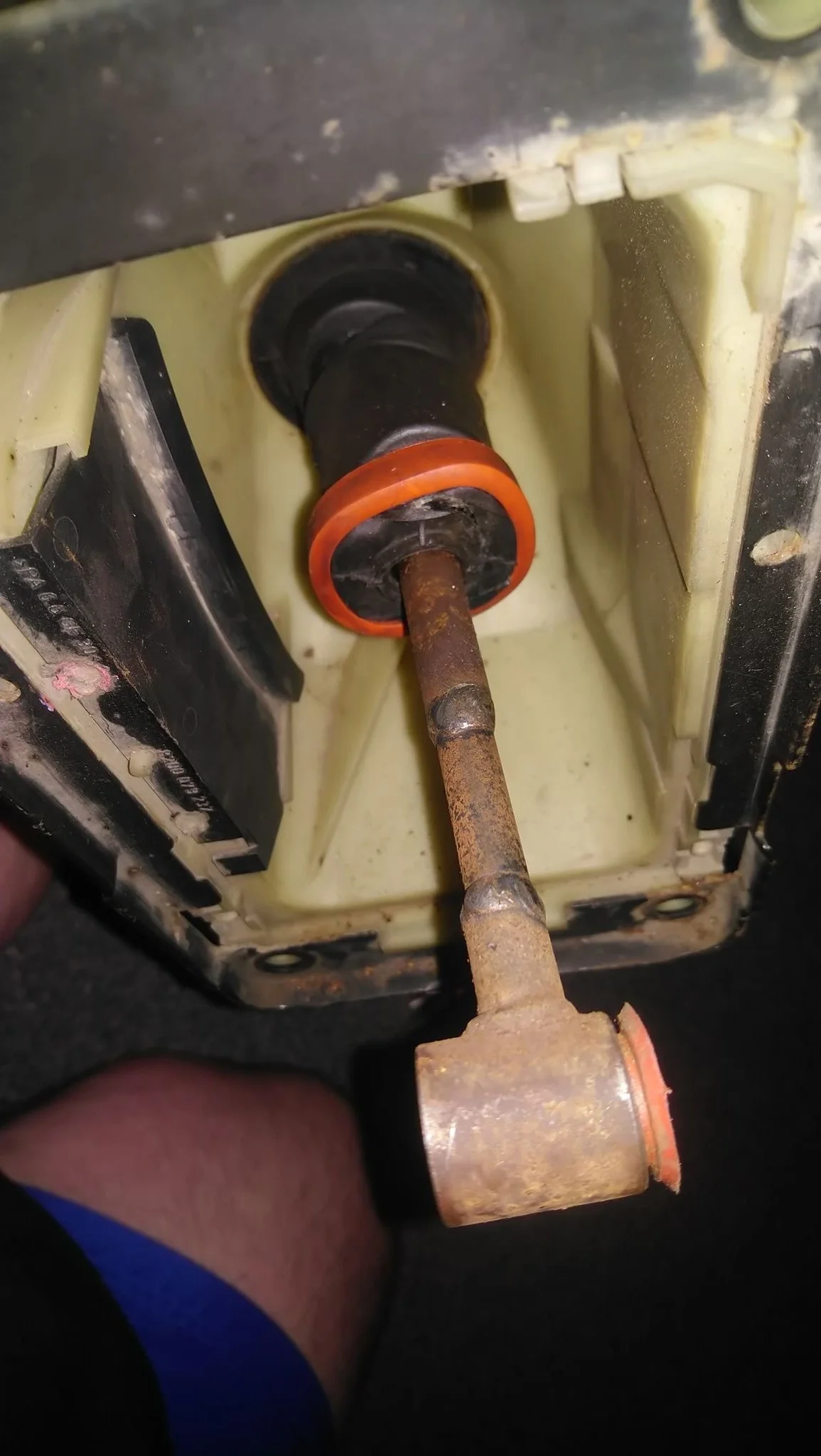

So.. next question... where can i get a non buggered gaiter for underneath? Or should i just buy a CV boot and bodge it?
You get a similar seal in with the rebuild kit that you are able to use but it's not as large, not that it matters. I'll grab a photo later

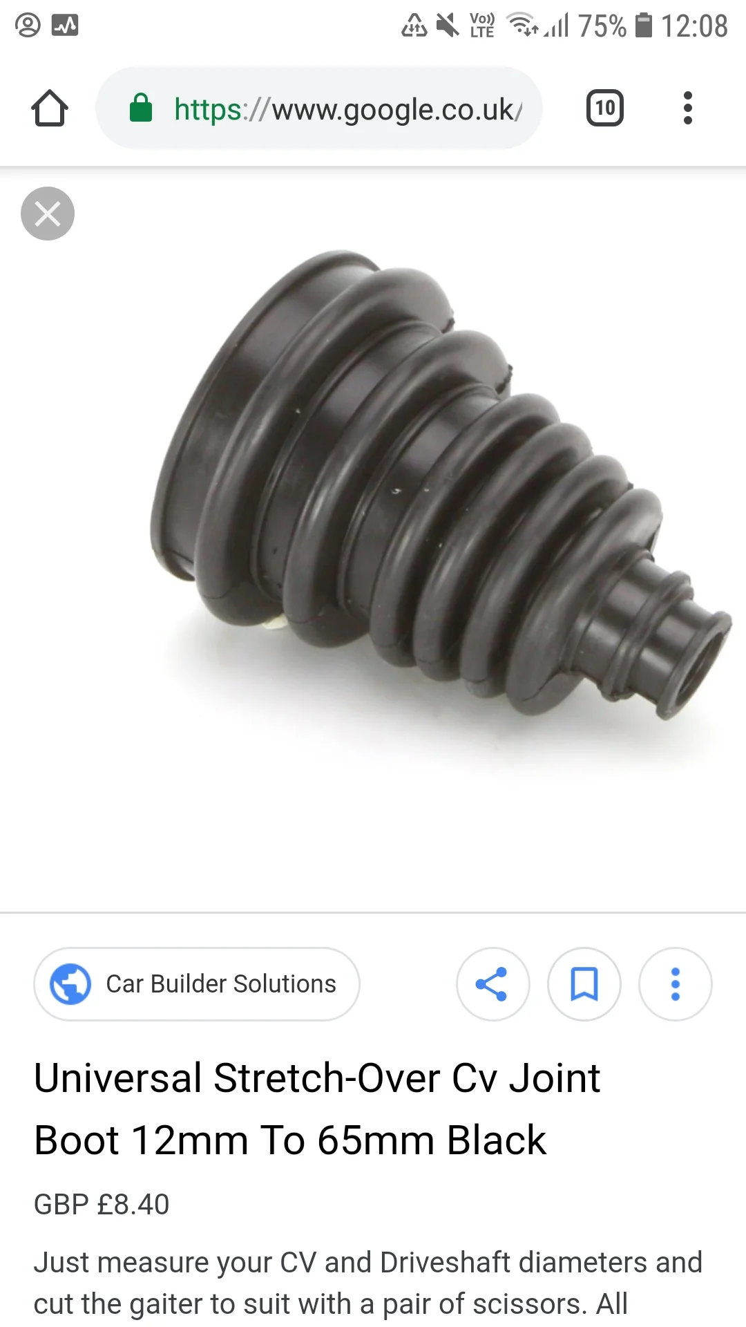

Cheers mate! Was just going to bodge something like this on..
