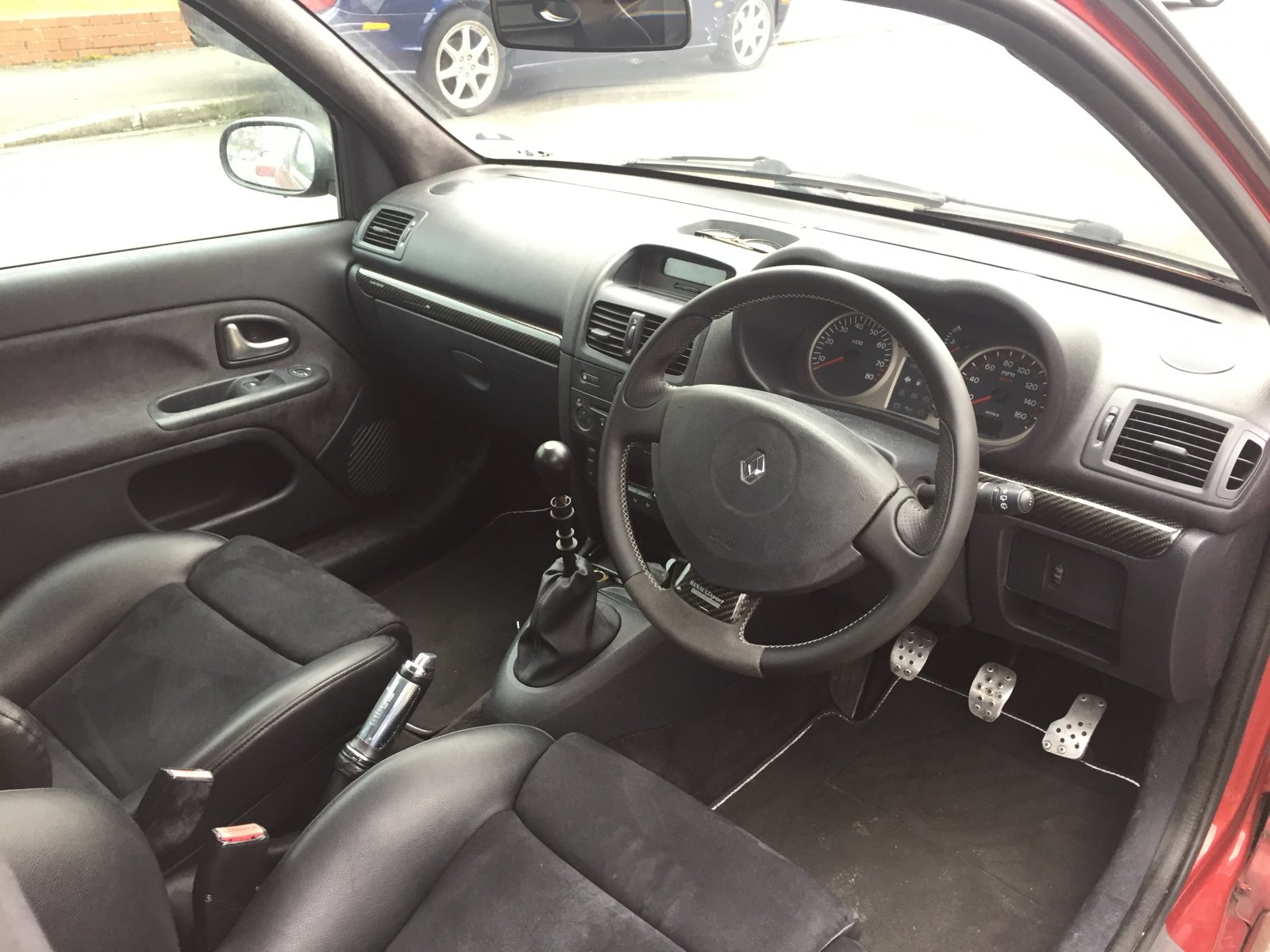

Ive seen these pop up a few times now and was thinking about giving this a go...
question is.. is there any sort of guide about for this? need some info on what parts are required (what year scenic etc) and also modifications required.
cheers
Ex-User (72296)
  Clio 172
Screnic shifter is a straight swap, but people usually add a stiff shift, i've got a yanoo 3.0 and it's great.
  Clio ph2 172
nice one, do you know what year scenic it is? I imagine a similar year to then clios? also where did get the yanoo 3.0?
Radugns
  Clio 172 ph2
I've installed a scenic shifter from a 2002 car. Is the one that has the insert on the ball. If you could find one that is ball is injected there, would be great.
@Yanoo has the stiff 3.0 kits.
