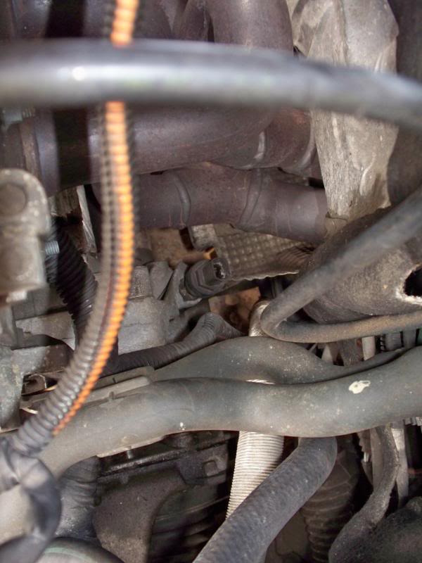

While fitting my airbox i spyed an un-used sensor that didn't seem right. Im having troubles with my reverse light not working and after asking on here ive been adviced it could be the reverse switch.
Is this it thats un plugged with no plug insight?
Thanks
Speedo work fine tho......
the ABS box will be driving your speedo, don't worry, you just have an unused speed sensor there. The reverse switch is sort of on the end of the box underneath, it has a small cable running to it that wraps around the the big pressed tin cover on the end of your gearbox
Thanks everyone, i will have a look at the gearbox for the reverse sensor and get it changed.
