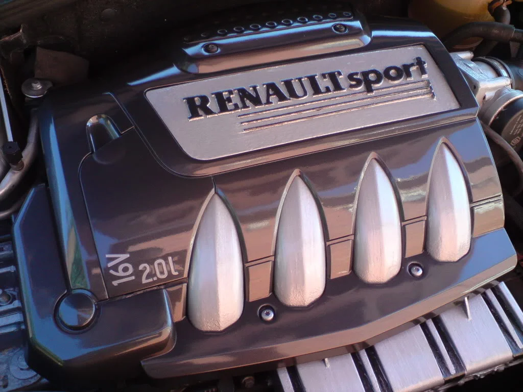

mine after i waxed it, do it every time a wax the car
