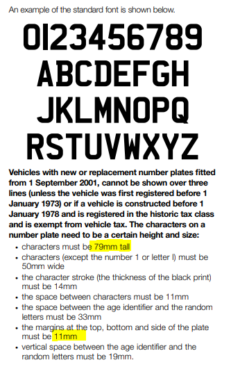

The law is the characters must be 79mm tall and then have an 11mm border top and bottom - so the smallest it can legally be is 101mm - So you can take 10mm off the standard 111mm plate height and still be legal.
