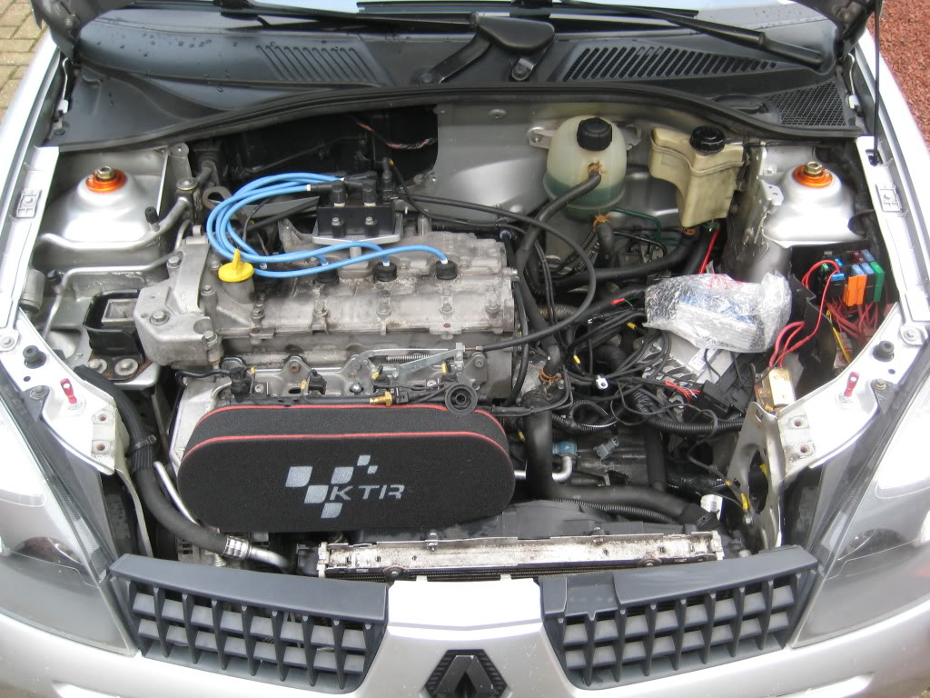

As you can see from the picture the plastic fan is touching the sausage filter.
Can i run a smaller more powerfull fan so it wont touch the filter. I will eventually get a smaller rad to do with the fan but for now i just wanted to no if it can be done this way.
Where can you get smaller rans from too, and will it have the same connector?

Speak to Benp
He had a custom one made iirc....
Maybe others aswell but not to sure tbh matey. I trimmed the plastic on the fan down to stop any friction :)

I have 2 6" Ken Lowe ones for sale dude....
Were fitted to my standard rad on the 1600 and worked a treat :)
PM me if you;re interested. Literally done about 6k.

you should be able to fit a 12" single there, many brands and suppliers are available for these... shop about and read the spec as some of the cheap ones are poor.

I had a 10" Pacet, you need to watch the CFM though..standard is like 1400 iirc my pacet was only 1100 but never had any issues.
