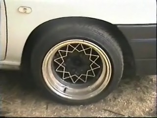

I saw that video of the Old Skool Valver (with the sick, funky old skool german hip hop stylee music) That had 14 x 10 wheels!
That car looked fine... Anyone know the widest that will fit standard.. Also the tyre size for it to be legal..

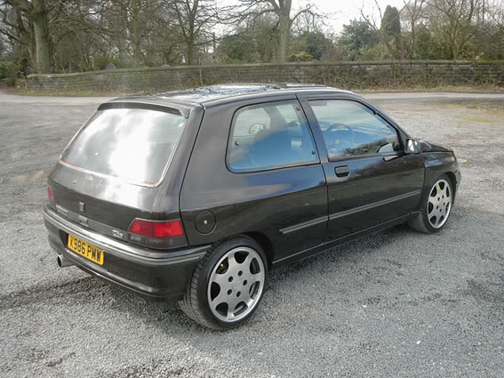

Ive had 16x9 ET35 porsche wheels on the back of my valver....with no probs

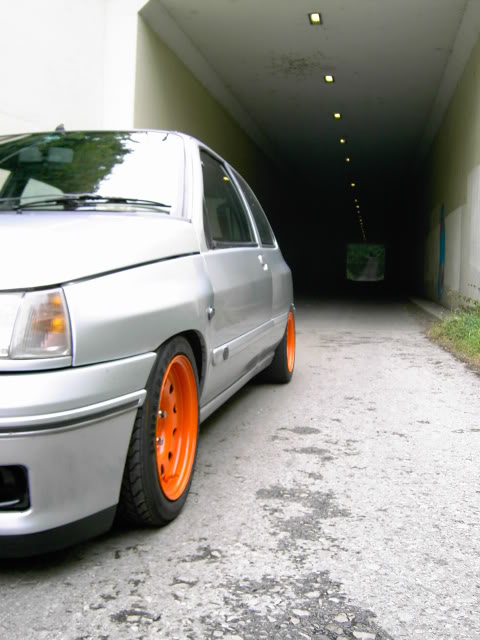

He's my old valver runing 7x13's ET23 ....running 5 turbo carriers and discs....it's lowered about 70mm and is dangerous to drive lol
Id go for 14x8's fronts .....14x10's rear........well i would run 13's ;)
That looks sick!! I'm loving the orange wheels!! thats gotta be one of my favourite valvers...

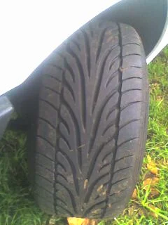

i got some
14x8 on my mk1 clio they stick out 2 inchs :) there so euro /go -kart there coning off soon tho
