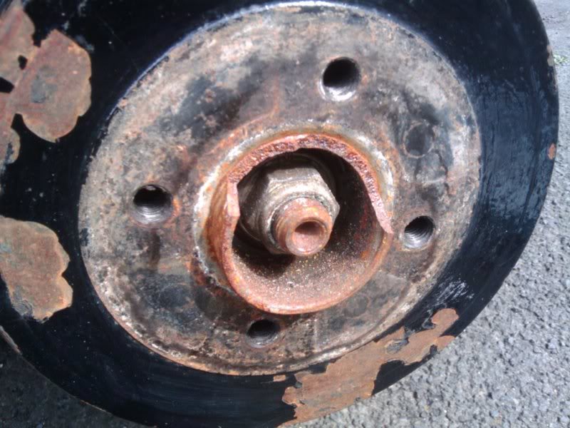

I had a couple of bearings changed last month for the MOT. I was told that the hub had been damaged slightly when removing the bearing but it was ok to drive. Couldn't see any damage when i picked the car up so thought nothing of it. Removed the wheels today to repaint the rear drums and discovered this:
I'm guessing I need a new hub? The tyre which was on that side has worn quite quickly over the last month. I'm guessing its because the balance will be all over now?

Yeah, I would get that changed.
Coincidentally I think I have a few in the garage ;) Is that rear passenger side?

I wouldn't be driving on that IMO.
I can't believe the garage let me drive away with it like that. Is it a common thing to happen t hubs when removing bearings or should I take it back and tell them to sort it?

When I picked it up he said i was lucky that it didn't smash the whole drum and that this can happen sometimes. With me not being mechanically minded I believed him. Have I been filled with s**t?

I don't get how they managed to do that unless they are retarded and trying to undo a nut with a hammer?!
I would get it changed asap and go and give the div in the garage a kicking.

Take it when he said i was lucky my hub didn't smash he was talking s**t then?
Kinda, what he was actually saying was "Your lucky I didn't smash it to bits!" Drums are pretty durable unless they have a crack, found that when my neighbour used a blow torch to heat the barrel and remove the bearing and it exploded, quite literally.
