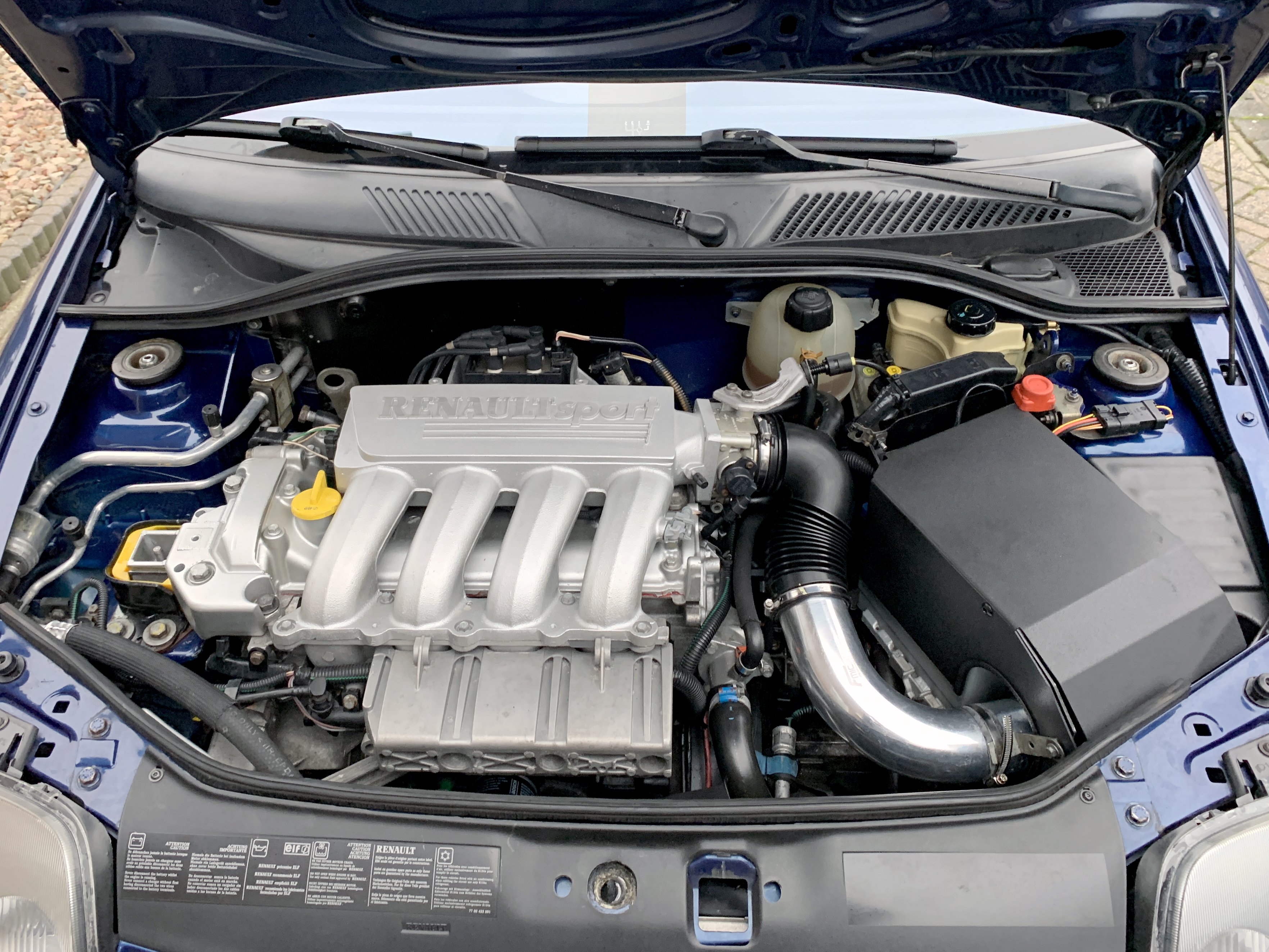

Okay so I was installing a battery cover and decided to paint the ECU bracket. While working in the engine bay I leaned over the engine with my hand on the Renault Sport letters of the intake manifold. I heard a little sound which almost sounded like a crack or something but it didnt sound like anything bad or a sound that aluminium usually wouldn't make when there's some weight on it. Ever since then it idles at like 2000 rpm. When driving and pressing the clutch the idle will jump up and down from around 1200 to 1900/2000 rpm. There's also a very very slight hesitation when opening the throttle body by hand. It sounds like the revs drop a little bit and then it picks it up.
I've had the ICV replaced about 2 years ago with one from VDO so I doubt it could be that.
Stuff I had disconnected while leaning on the intake:
Battery
Intake before throttle body
ECU connector
I honestly doubt there's anything wrong with the connector on the ecu as there's no lights on the dash and the car runs great.
So I've checked the following:
ICV to intake elbow
Throttle body to valve cover breather
Inlet manifold to brake booster
All the hoses and hose clamps seemed fine.
So does this sound like a possible crack in the inlet manifold? Or should I be looking elsewhere.
