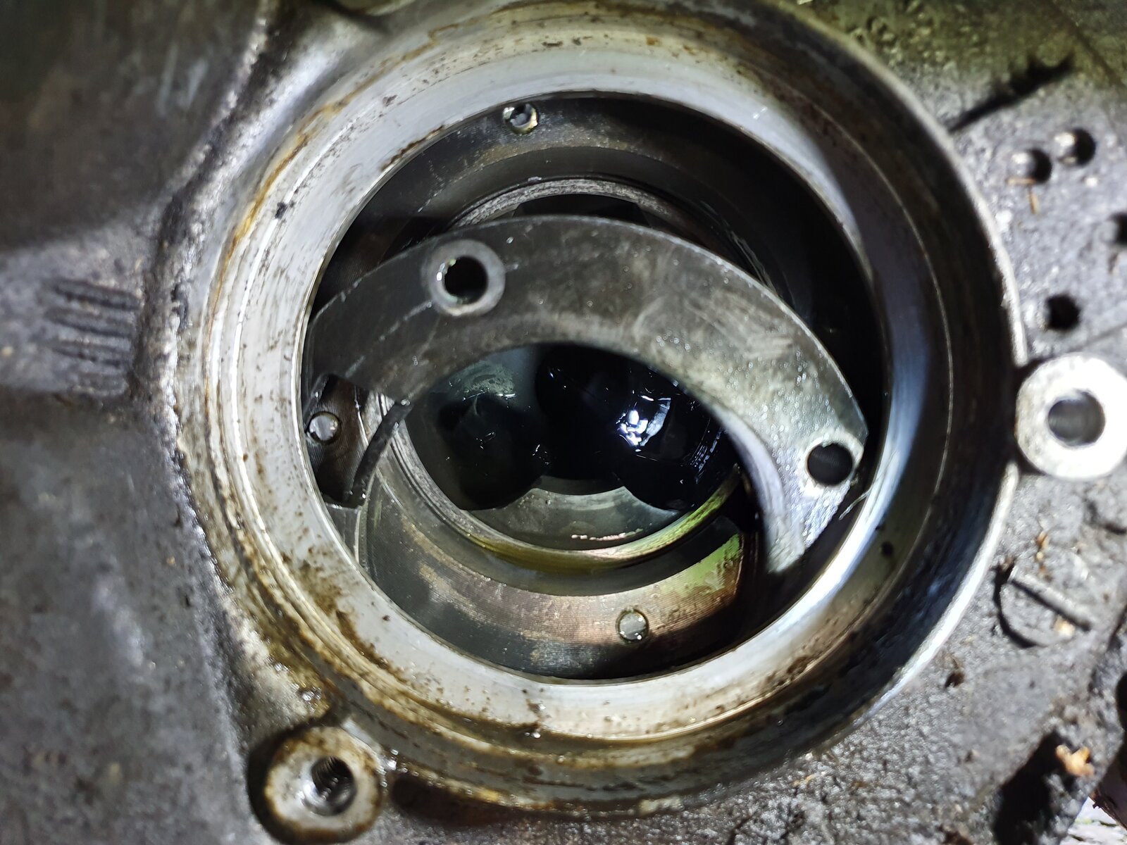

Something let go this morning
  2003 Clio 172
Found one in the driveshaft boot
  2003 Clio 172
One query.
I was of the opinion that the 182 style diff setup was supposed to be more robust than the 172........is this a normal failure as far as you guys are concerned?
@NorthloopCup when you build these, do you use this 4 bolt system or do you use the renfort plate with more bolts?
I guess I was hoping to see the old run of the mill type failure and was happy with the notion of going to the bolted style so this has spooked me a bit.
I also guess that these would probably not all have failed at once and was wondering, could this have been the cause for my grumbling gearbox under load in higher gears lower rpm (think i posted a vid a while ago)

NorthloopCup
One query.
J
I have NEVER seen one of these fail mate, so I would suggest something else has been the cause of this failure. The bolts aren’t high tensile bolts either - just 8.8’s.
When I convert them I use the Renault bolt on plate and bolts mate.
Yeah it certainly sounds like it, but once one had gone, there’s quite a lot of load running through the diff, so the drive cup would’ve been under increased loading.
