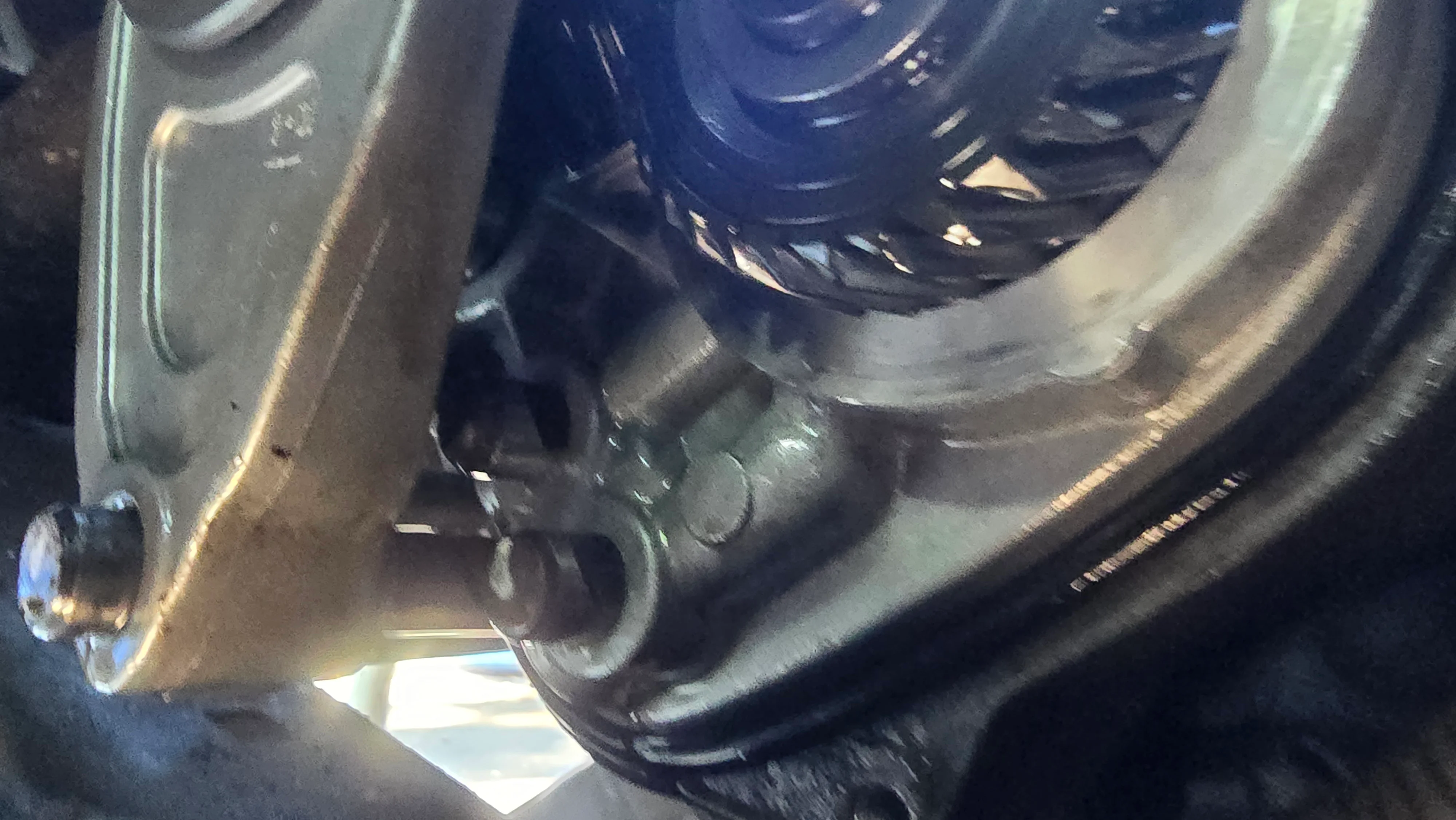

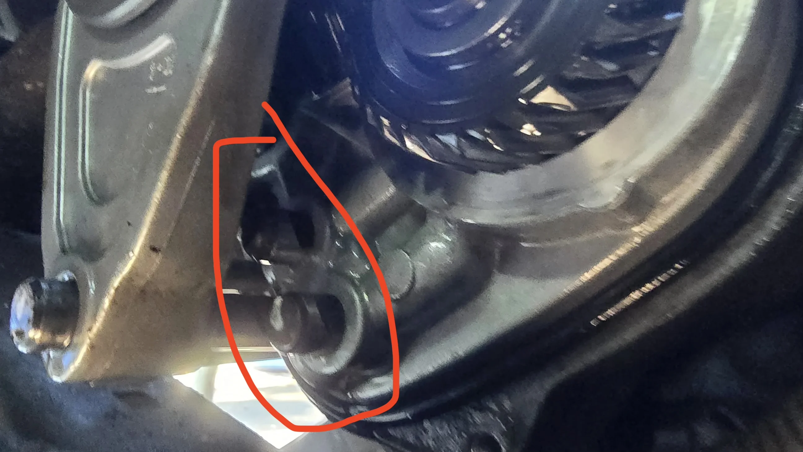

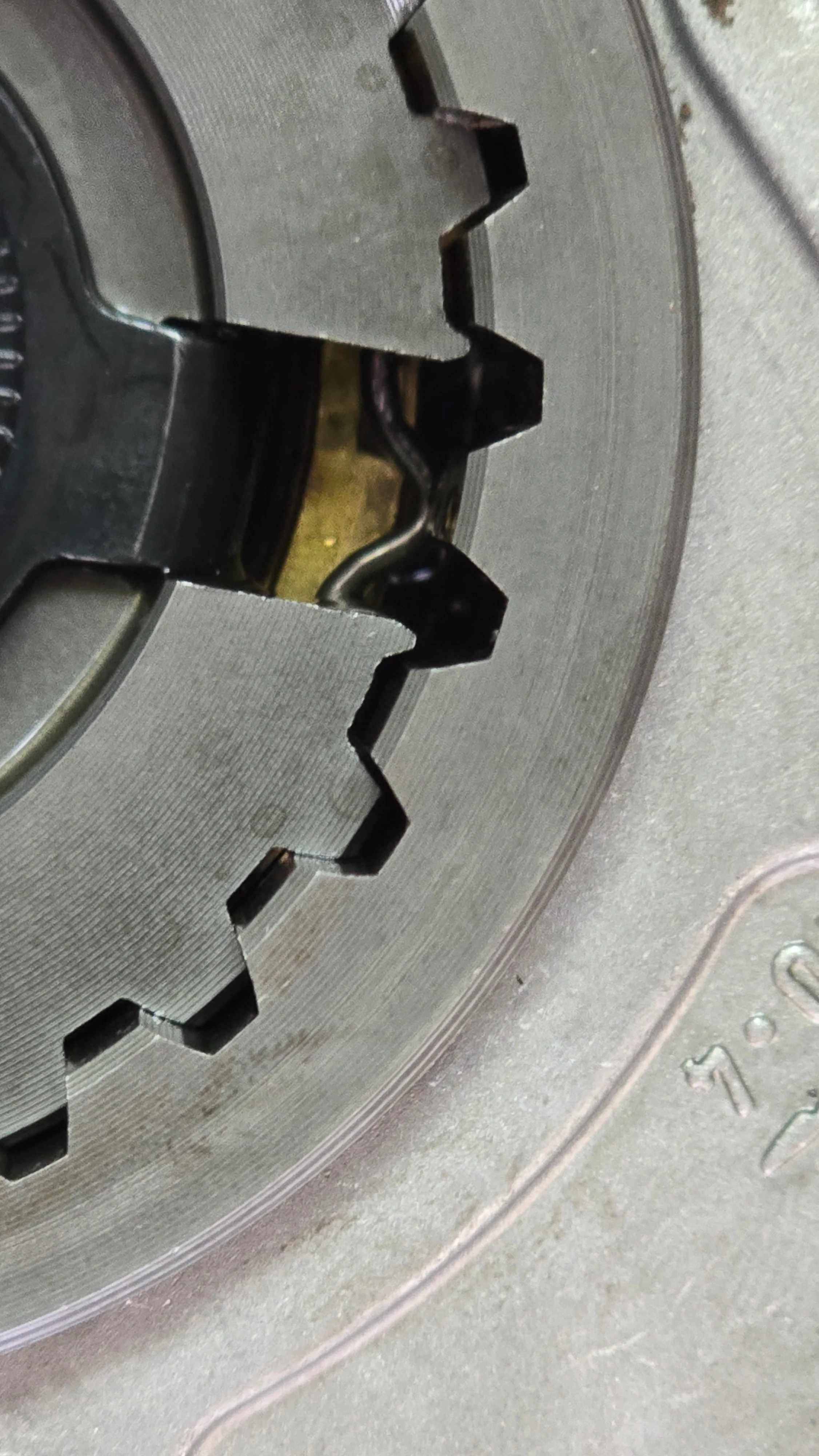

Got it off this is how it found it. Im no expert but the selector trying to fall off is i guess not how its supposed to be. There appears to be a spring clip in there thats somehow gone outta line. Im hopeing re aligning and getting it back into 5th is gonna be the game plan here
Yeah that’s the issue mate. Small screwdriver to manipulate the clip so the hub slides down, and you’re golden mate. The hub just needs to be level. 👍🏻

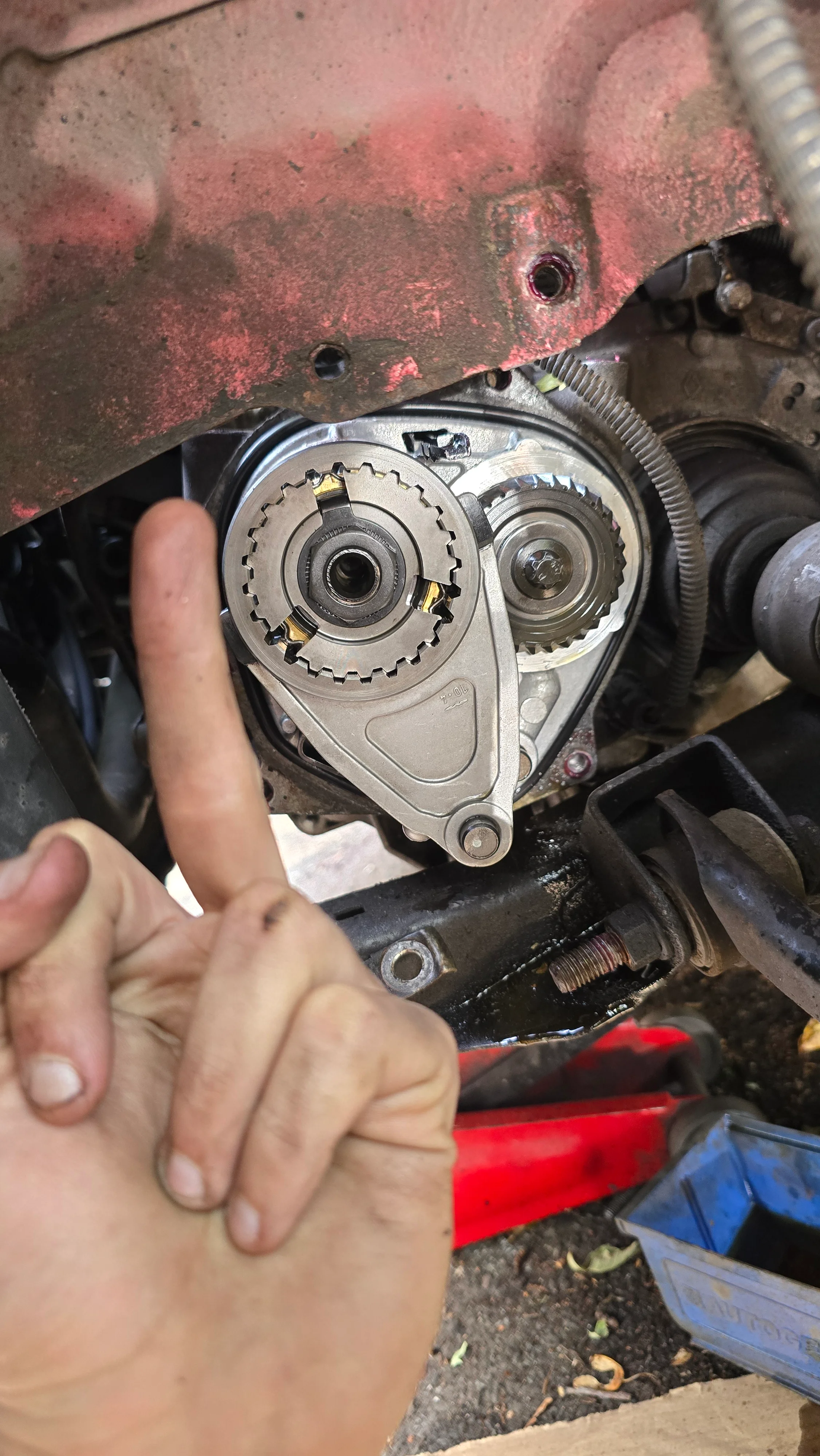

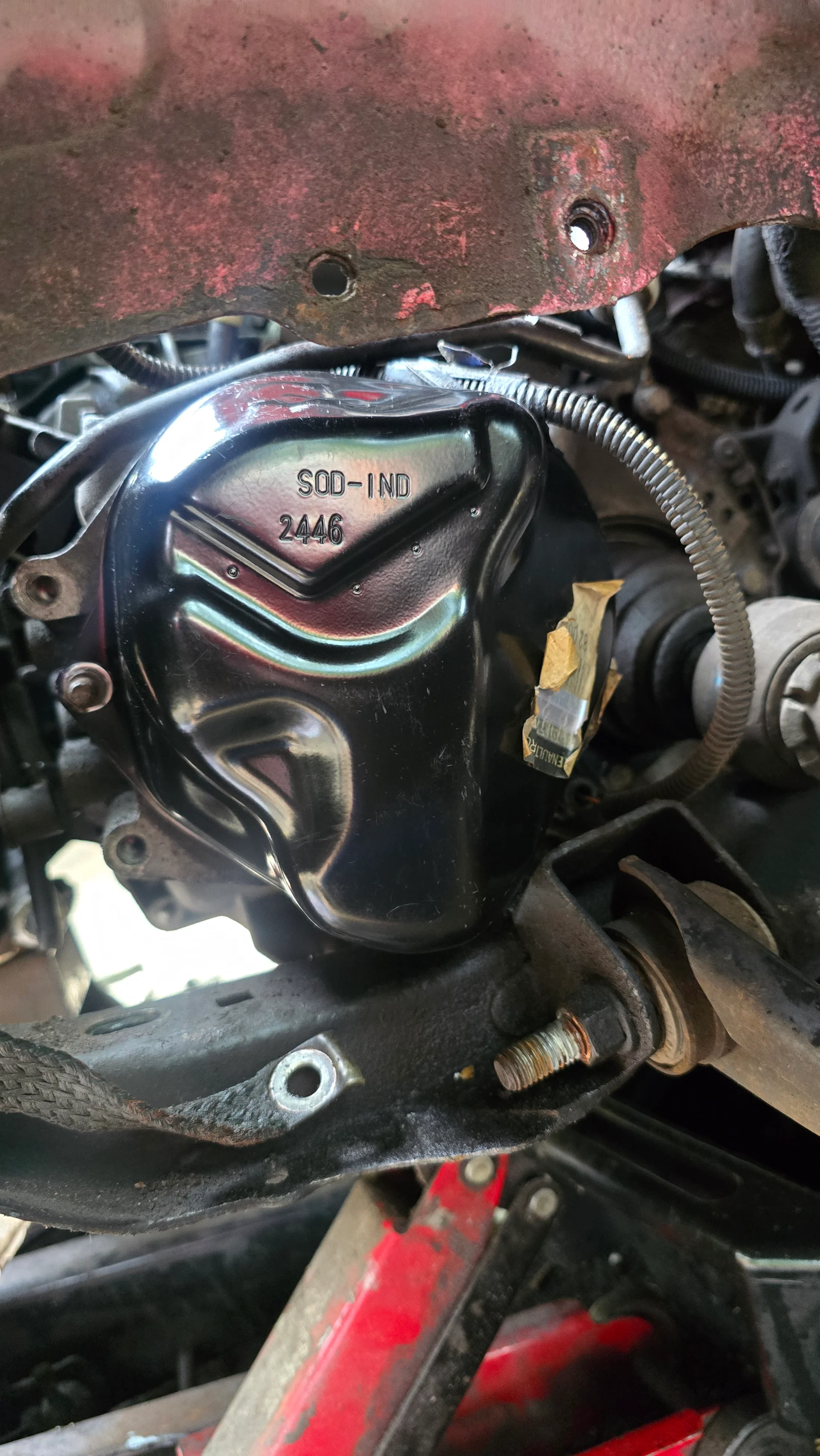

This was just before I put everything back together. Re draining the oil now. Hindsight being 60/22 or whatever they say. I should've not re filled it with oil

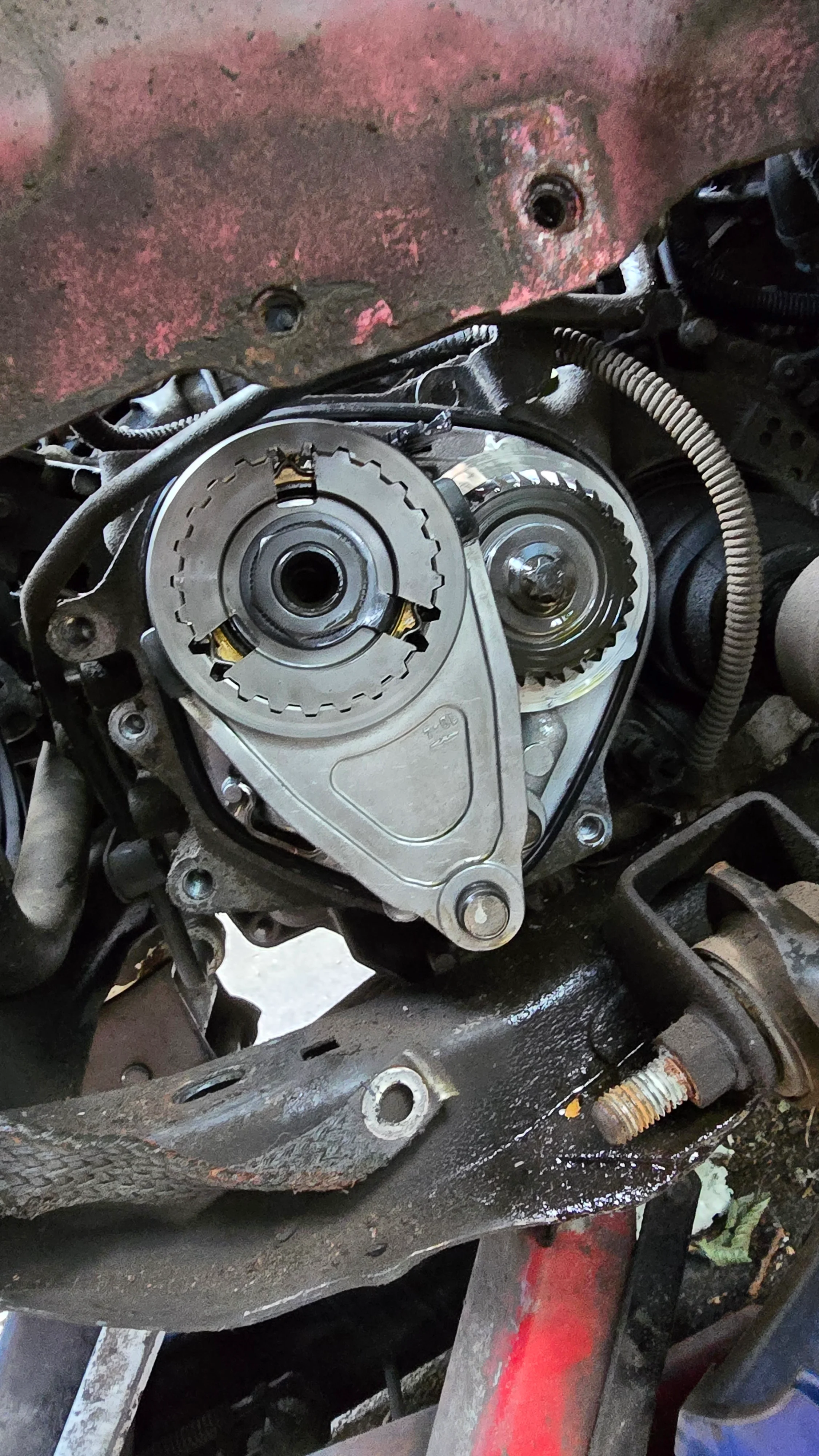

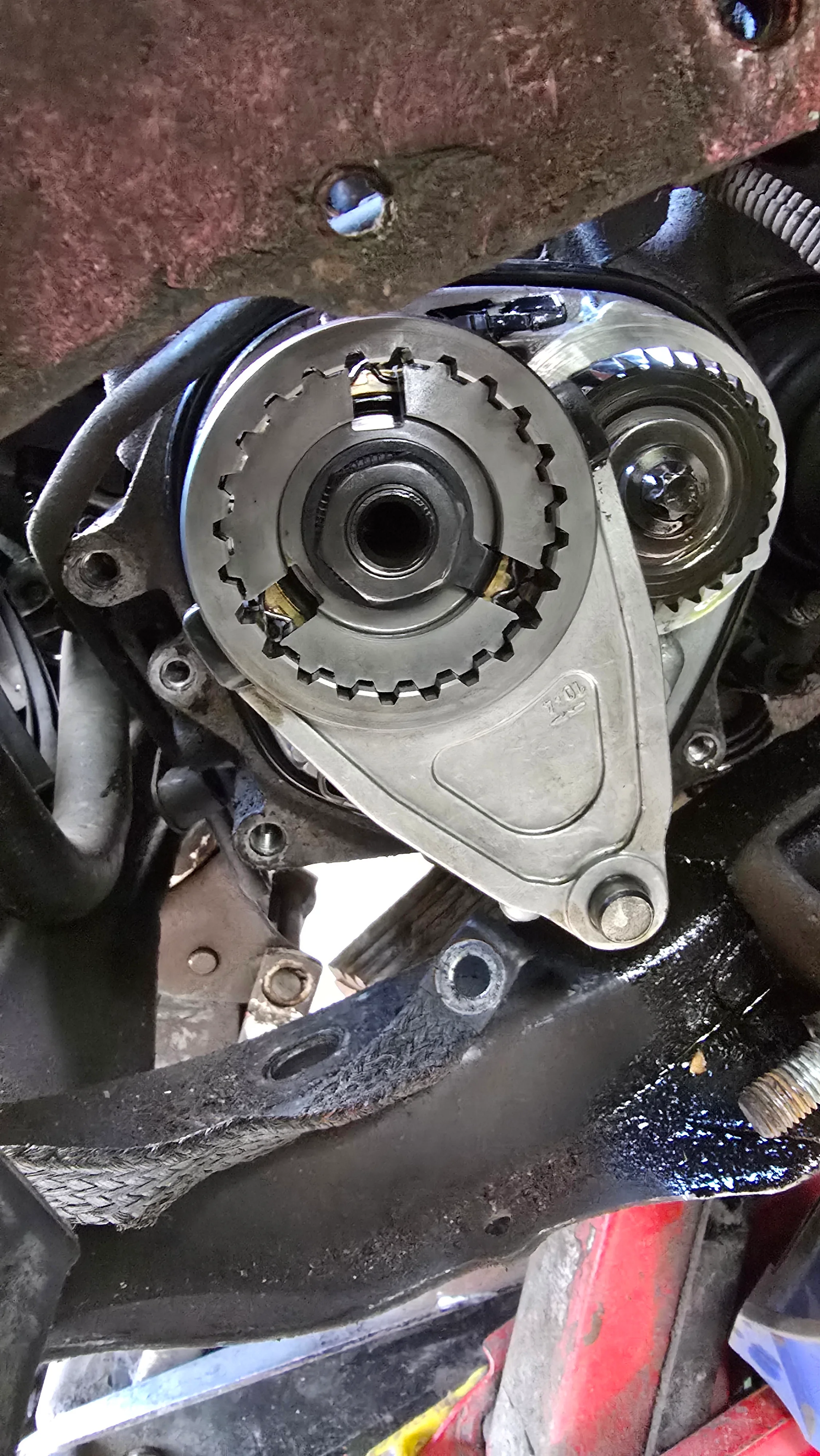

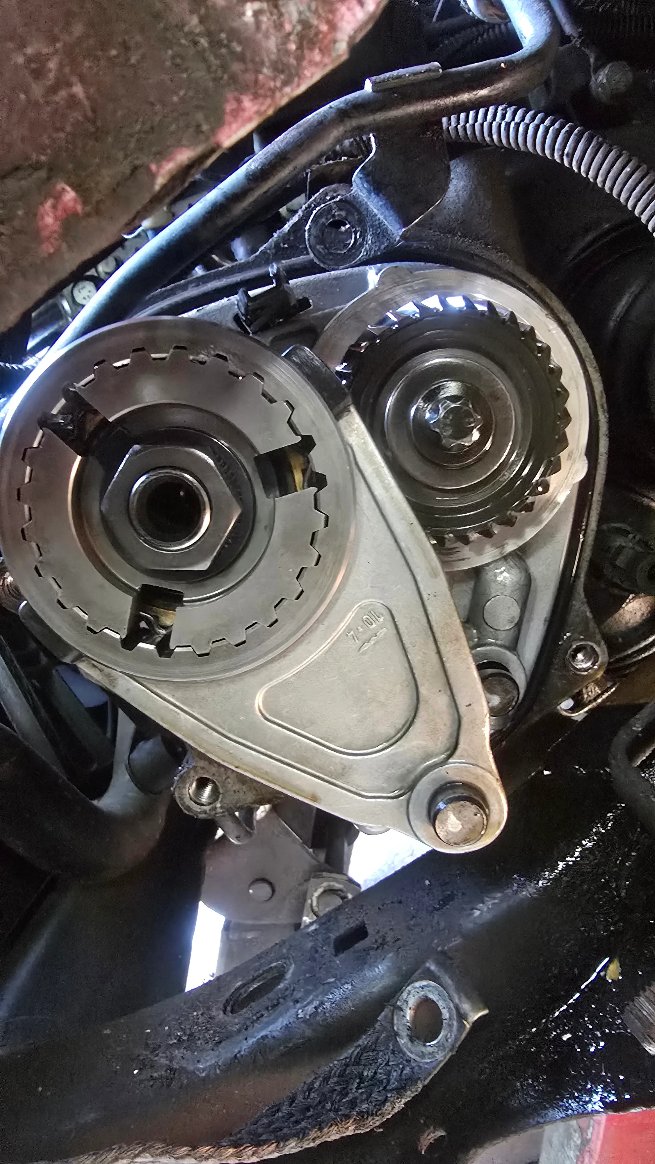

As it sits. The main box body is still acting like its in neutral with the selector free but try move the wheels theyre locked by 5th somehow

Right ok. In that case, try and push the selector fork for 5th down all the way so it engages 5th, then manually lift it up. The selector lever under the box SHOULDN’T move. Let me know 👍🏻
Will give it a shot in the morning as I feel like ill be sleeping in the thing if I dont give people attention inside 😂 im still a bit baffled how its managed this at all. And why its now managed to get itself so out of whack.
Right. it was a bit of a faf but I did get it to go into 5th and back out and we APPEAR to have all the gears now. Im not re attaching that shifter untill the new mount arrives but huge thanks. We might just drive again

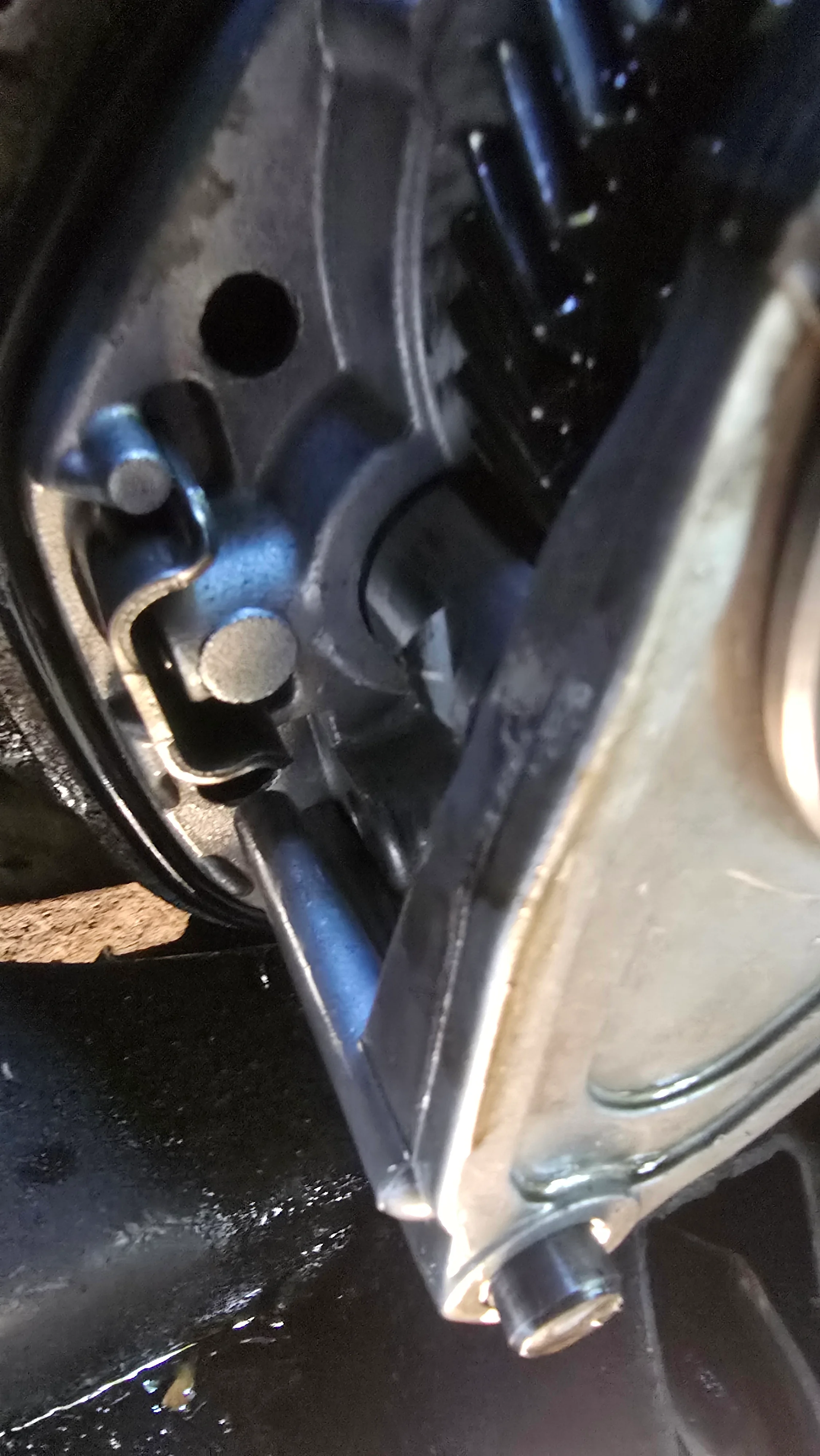

Dejavu here. 5th has popped off again the sodding frog eating b*****d.
Well reset and then throw the short shifter over the hills and fit scenic parts.
But yeah im in process of bending it now as I did read that unless you fancy a fist fight for 1st 3rd and reverse its needed
You want to extend it aswell ideally otherwise it'll feel dog awful. You're then in short shift realms again.
And PMS/Scenic combo would be the one. PMS 5th feels dogshit
