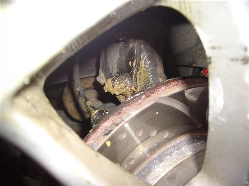

Noticed the other day something was allover my wheels but thought nothing of it as it was raining hard and looked like mud, but now i can see that it isnt, heres a picture
What is it :S

Might need a new CV clip, mine did the same thing and coverd the wheels in grease. Cost about 50p for the clip and not much to ft it.
Or it could be dog s**t, looks a lot like it??

lol, £30 for a new one fitted
is it ok to drive on for the next couple days? getting it fixed tuesday

make sure they use a genuine renault kit and not a glue together gaitor!!
the glue together ones ALWAYS fail

Yup, prob CV boot either split or clip busted.
I had both my clips on the cv boot snap on my 172 a couple of months apart , grease all over the alloys . Is this a common problem ?
I'm gonna put some cable ties over the clips on my 182 hopefully it will help to stop it happening .

i think mines just about to do that lol. its gettig a tiny split in it...
you can get new boots that dont even require you to take the disc brake off btw...

i will watch them do it lol, is it ok to drive on for about 50 miles? thanks for the tip guys

yeah will be the cv boot...mines like that..
getting a new driveshaft on wednesday.....:)

no idea as i havent checked and not too sure what i'm looking for either, how would i glue it? be good to have a temp fix until i get it fixed properly

ok will be the 1st thing i do then, should i seal it though to stop it going everywhere again?

right had a look at it today and it doesnt seem split, however the boot thing has come away and thats why its leaking, the metal jubile clip thing has come loose, i stuck a cable tie on it to keep it in place til tuesday

na, just try and clean the disc pads and caliper
YUP!!!!!!! mine went on the way home from Scotland this weekend! been making progress down the motorway for 200 miles.......... pulled off and hit the brakes............fook........front end was ALL OVER!!!! inside of the drivers side front disk feels all smeggy and horrible........so my brakes were only working on one side........i assume thats why the car was all over the shop anyway!!! All my lovely new suspension / wheel etc it minging!
