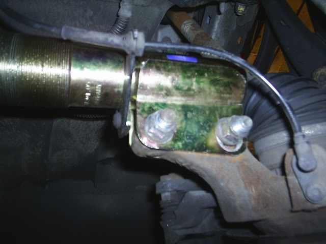

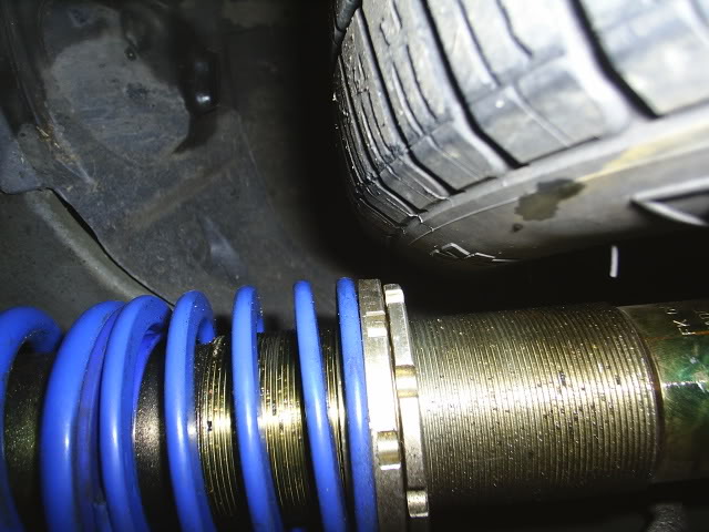

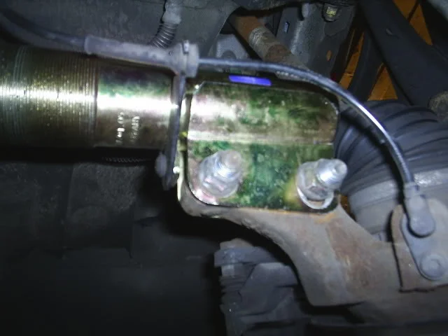

well iv got stander 15 and tryin to set the camber but when i try to set it to - camber the wheel hits the strut . i know its stupid you think they would of though of this so i need spacer to push the wheels out to give me more room to set the camber up this gap is bout 5mm so i cant set the camber so it - camber now

Surely you need to adjust the wheel AWAY from the strut. I,e bottom of the wheels towards each other.......
  Chocolate Bar™
gotya! was going to say that spacers dont allow you to adjust the camber, when in fact you just need a bit of clearance ;)
